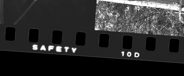

and to be honest this is not looking too good...why some films have ferrania and frame numbers and some don't?
Oh Berri, nothing ever seems to look good to you where we are concerned...
We explained in a post a while back that because we were using the cinema perforator, there were no frame numbers on the ALPHA run of P30.
We have recently, however, set up and tested a proper signature and frame-numbering perforator. This film is being finished now and will begin shipping in a week or two.
