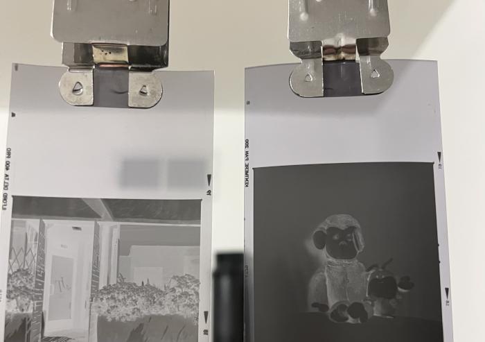

Can I ask a quick question, how does the base colour/density compare to Delta 100?
I would say it's very slightly denser and exactly the same color. I don't have a side by side photo with Delta 100 at hand, but here is the Kentmere next to Delta 400 -- please ignore the wild exposures, but you can see the film base at least. Both developed in DD-X 1+4, but not together.

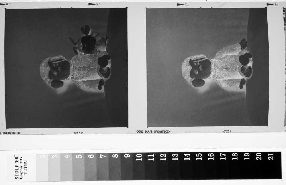

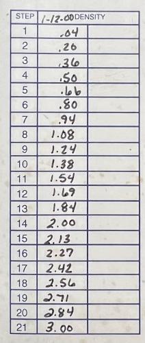

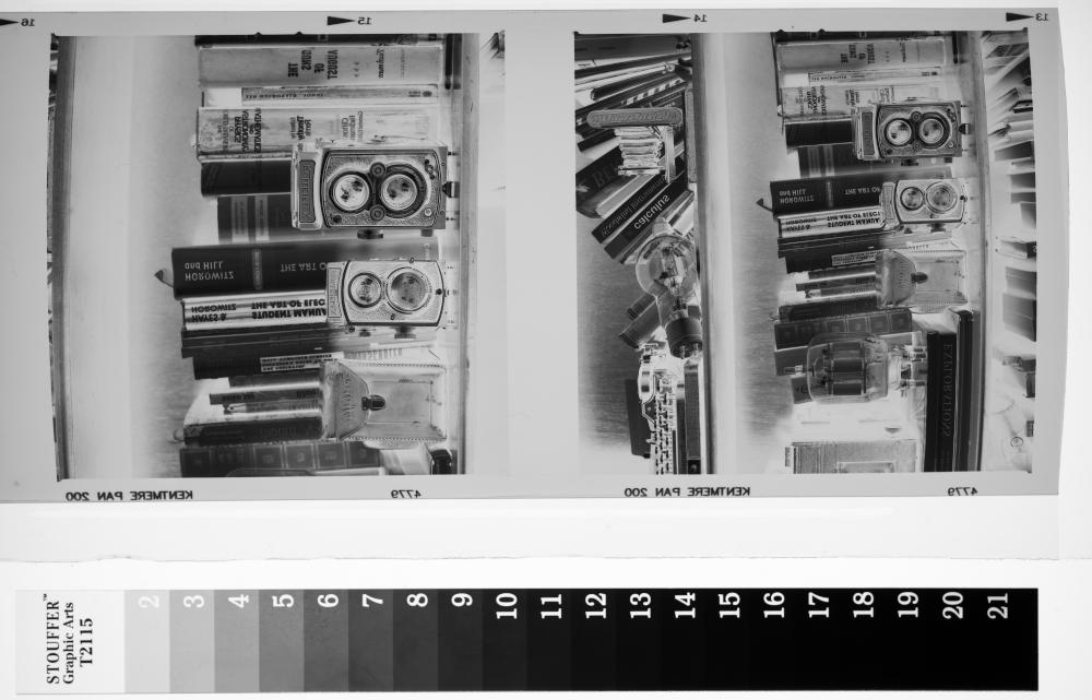

Anyway, if you want more concrete samples, here you go. I've included a pair of more high-key, denser negatives too.
