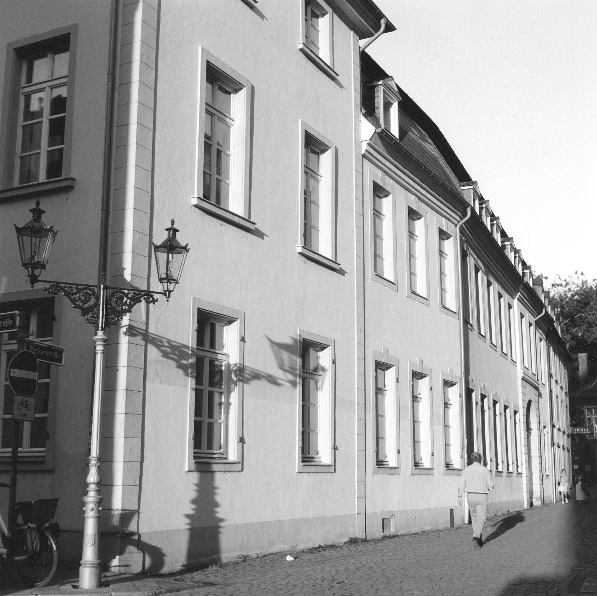

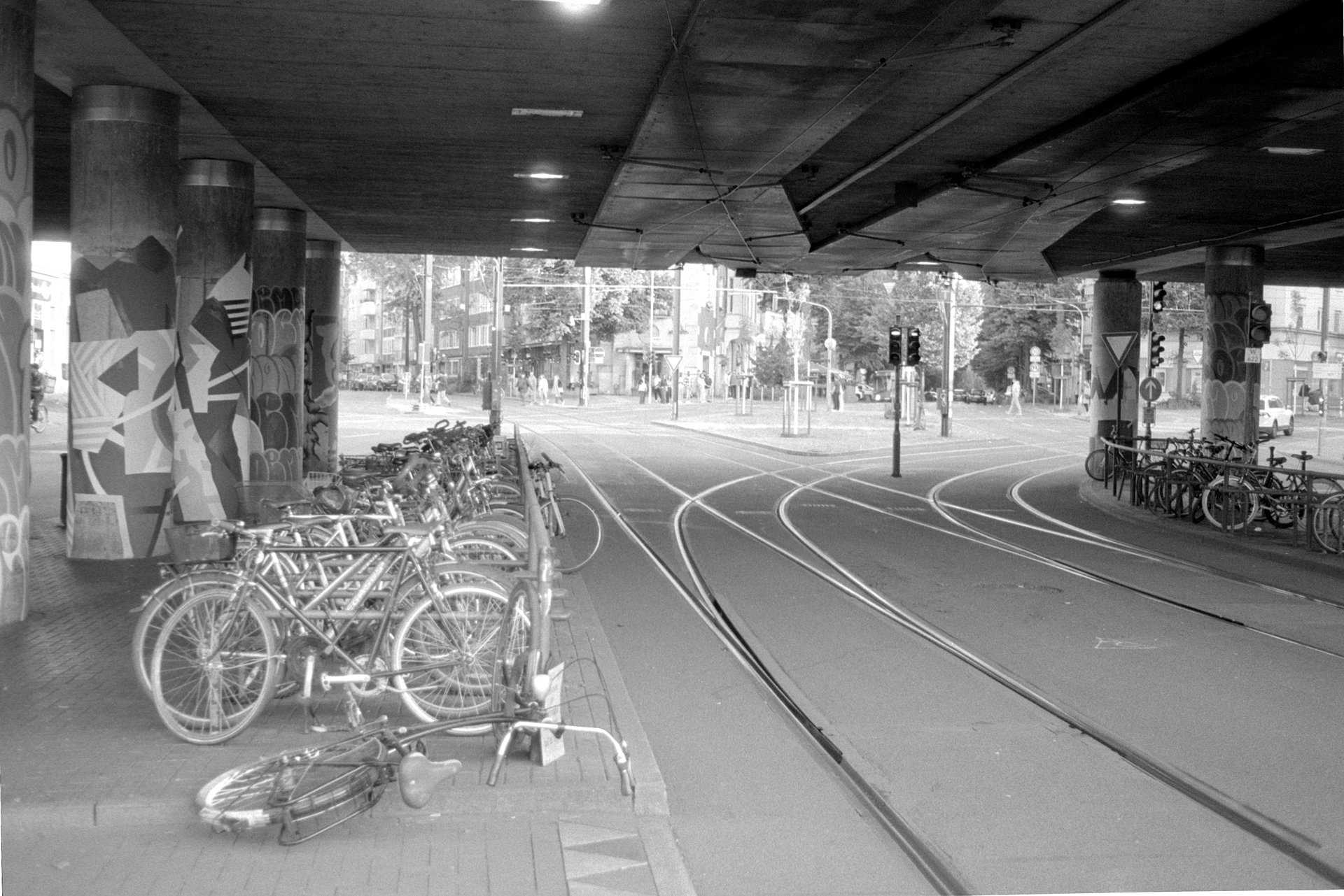

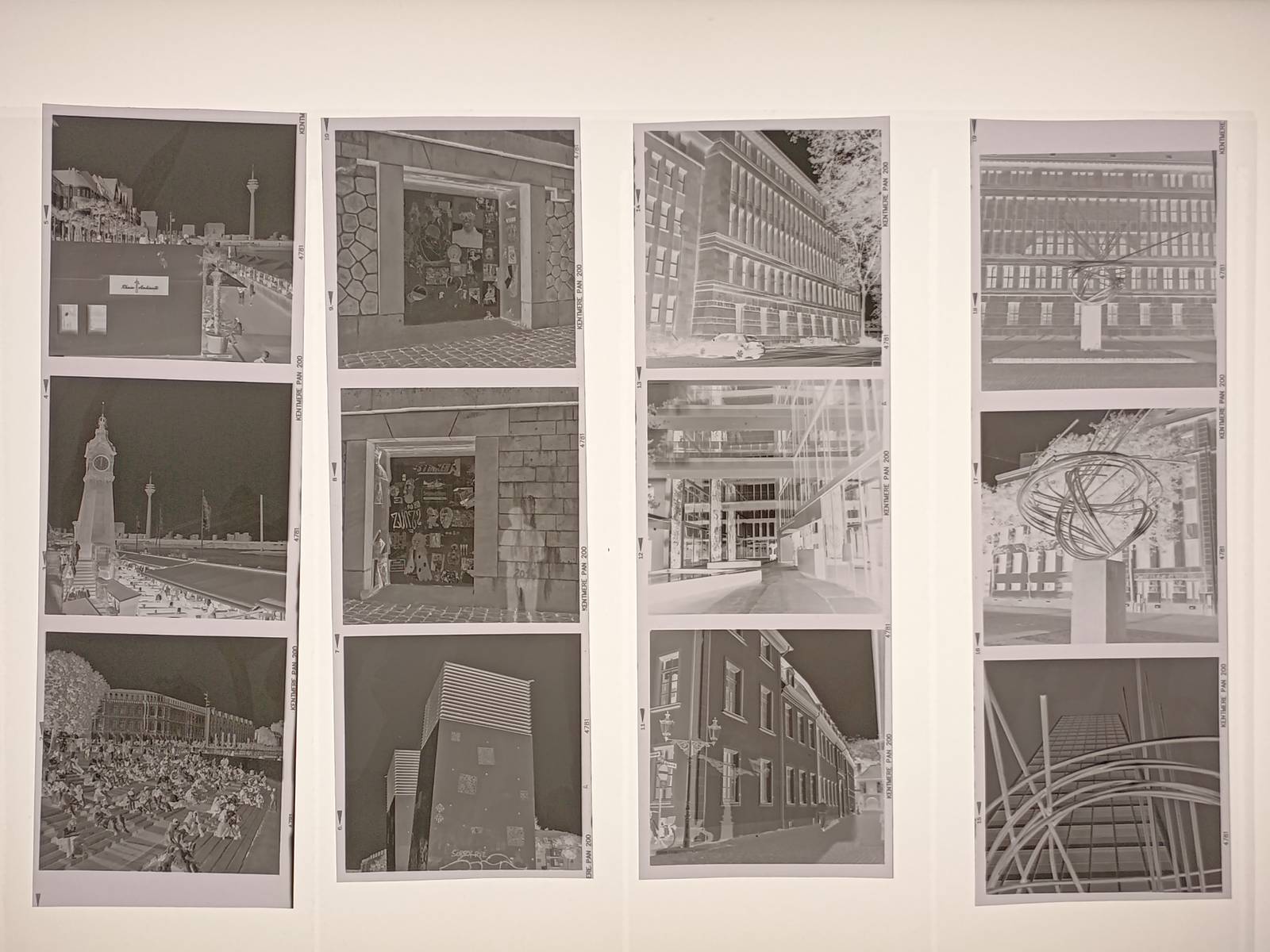

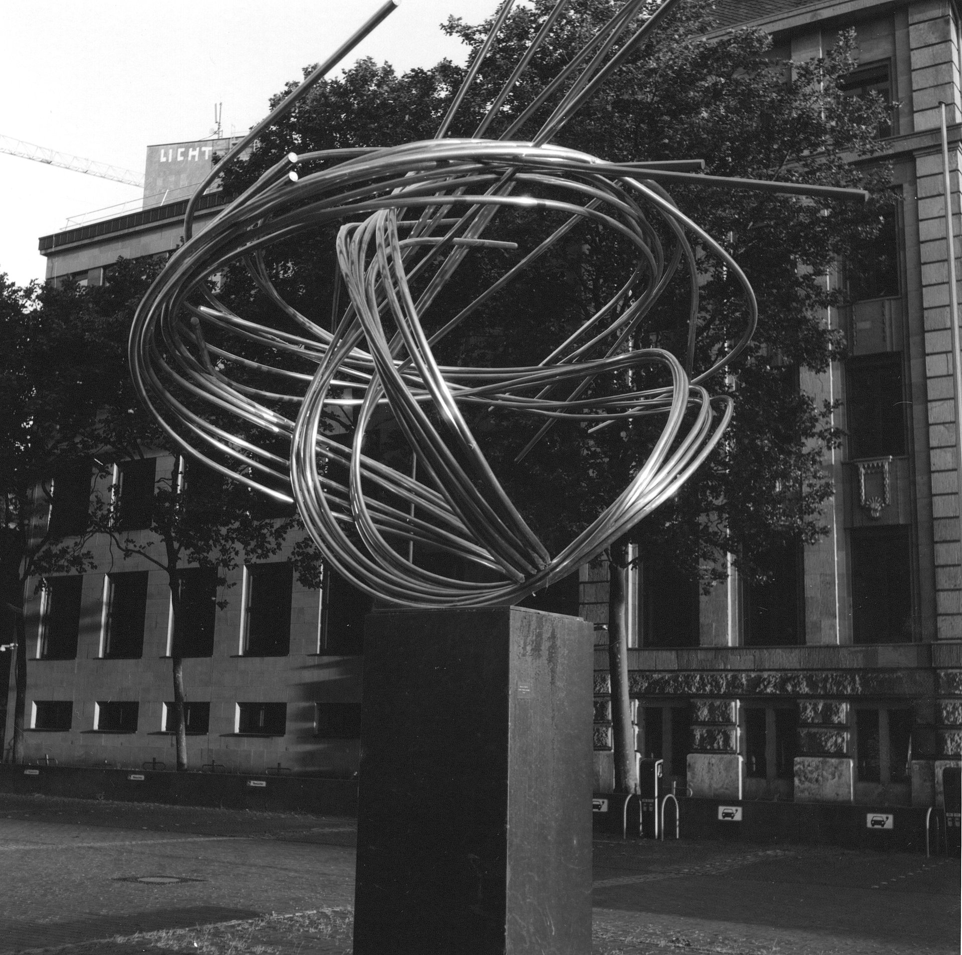

I developed successfully a Kentmere 200-120 in Adox XT-3, 1+2, 13 Min.. The image looks flat, but the negatives are more contrasty than the poor image shows.
The negatives look good, pity about the city...
Couldn't you have run your tests somewhere more photogenic, e.g. Cologne? 😄
Those look like excellent negatives - eminently printable.

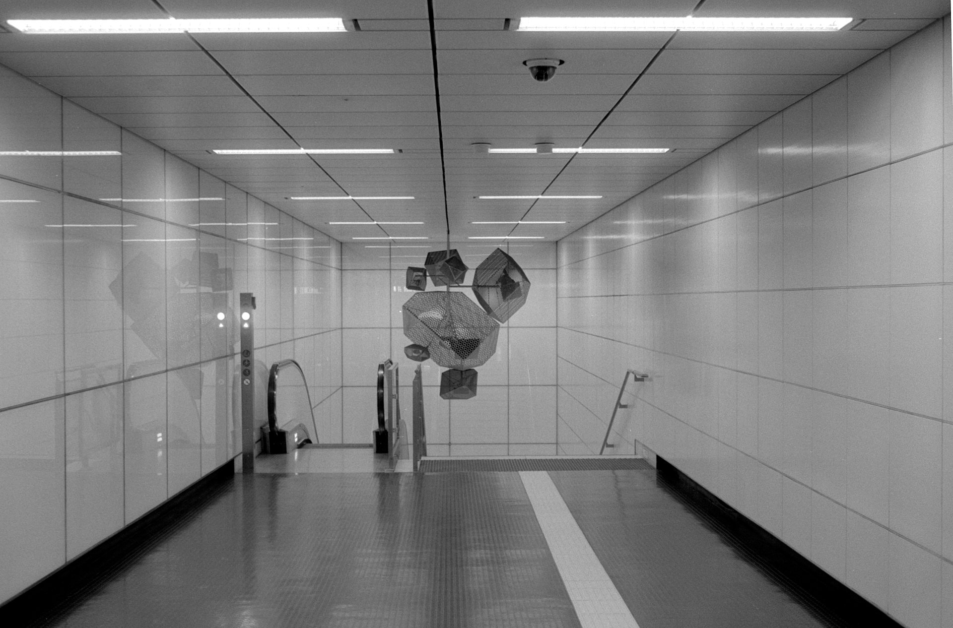

Thanks for sharing these negatives. Contrary to what is mentioned on Ilford's website, the base appears to have a tint in the above picture. Can you confirm? Clear base would have made this film a potentially good choice for reversal processing.
You'll see a degree of base fog on many B&W 120 films that are coated on clear bases unless you use something like PQ Universal that is ultra low fog when used for film development. This is not a fault, but a feature of certain side-effects of developers chosen to be finer grained and sharper, especially with specific emulsion structures.

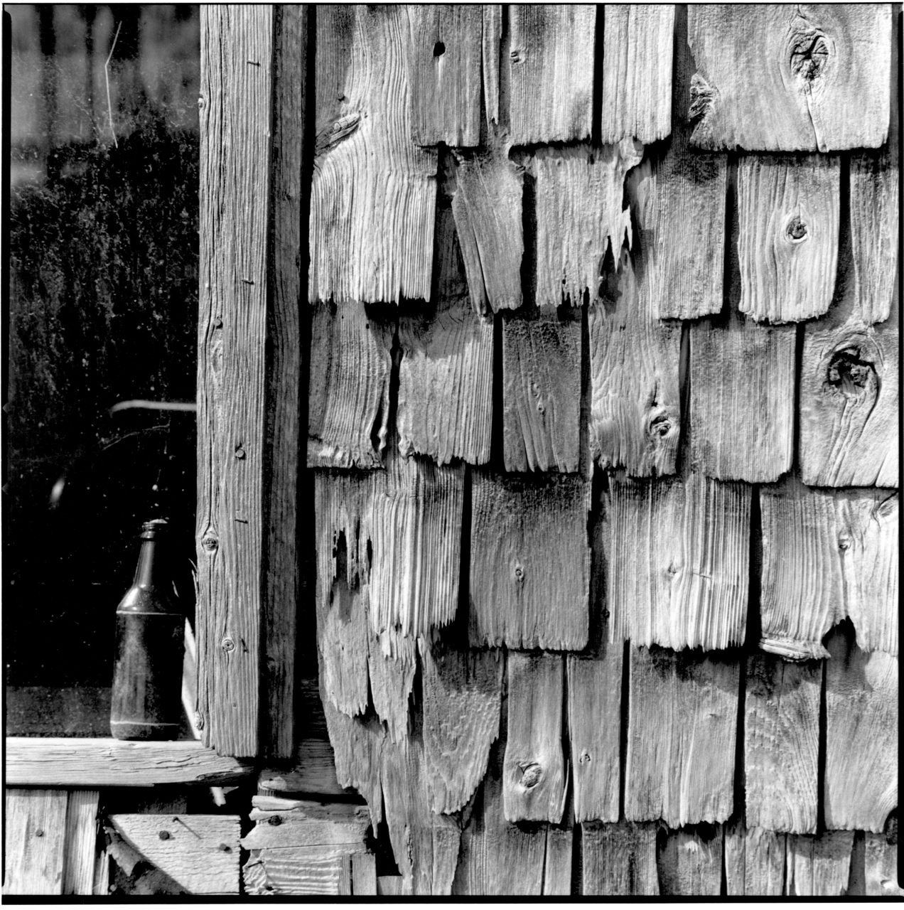

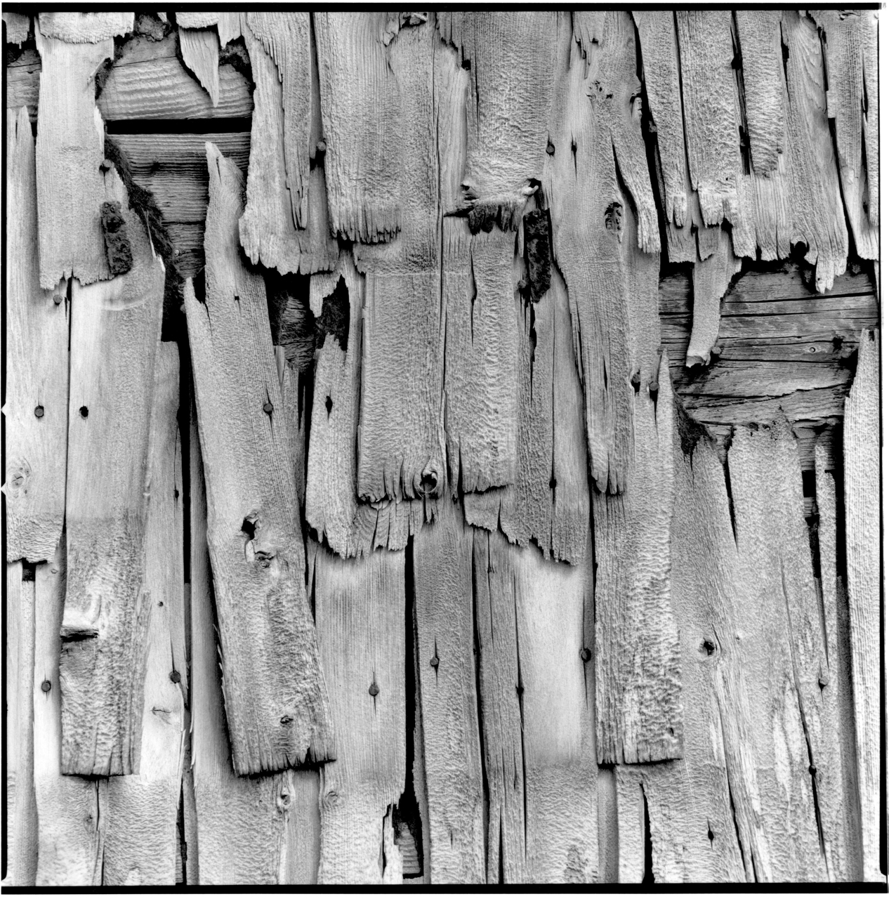

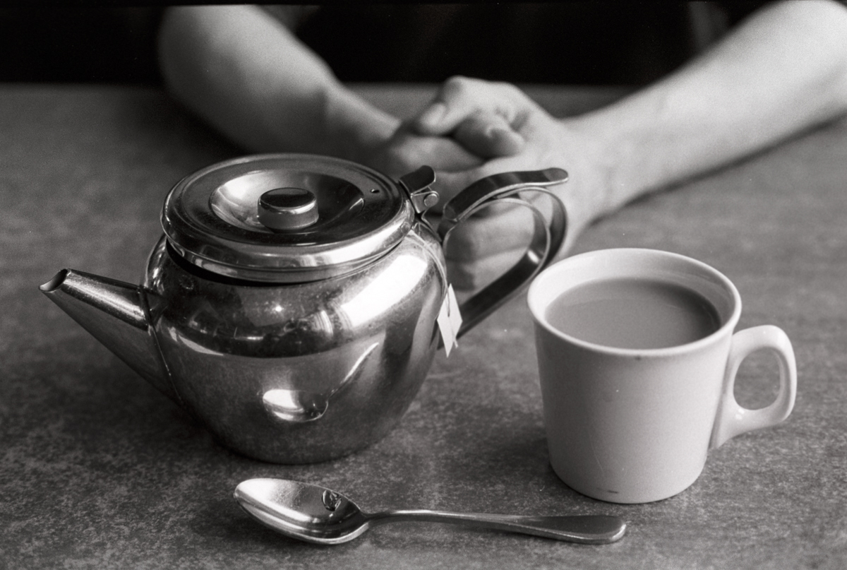

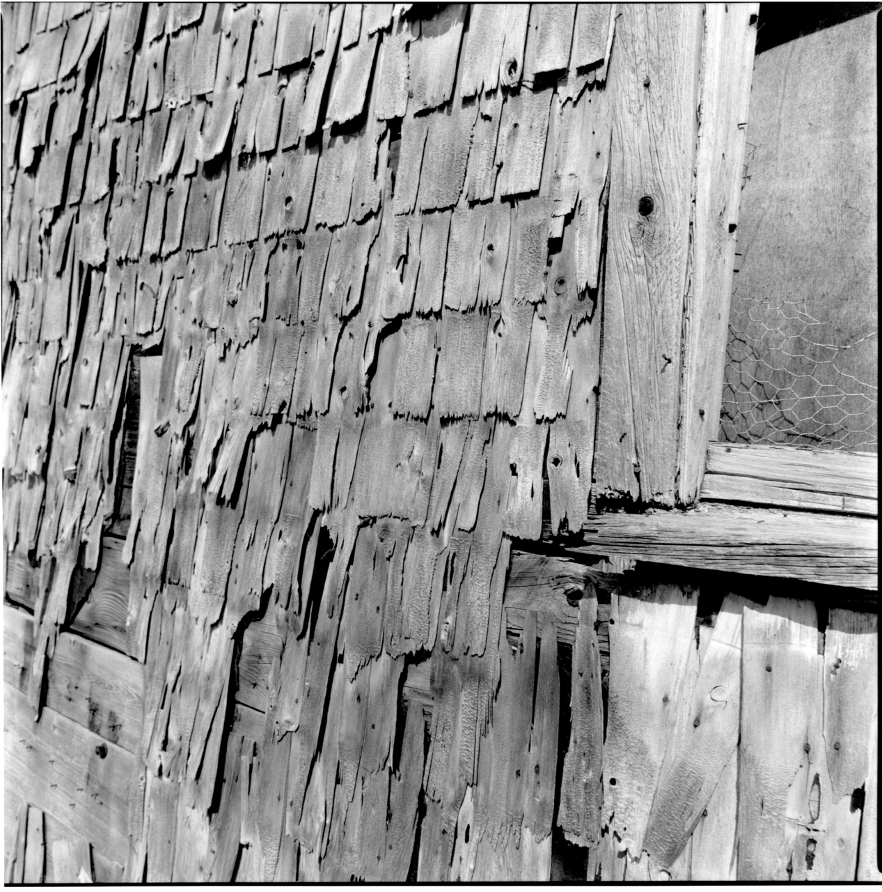

I've had a chance to shoot a roll of the new film.
I've included a link to a video I posted regarding the results. If you're interested you can find the video here.

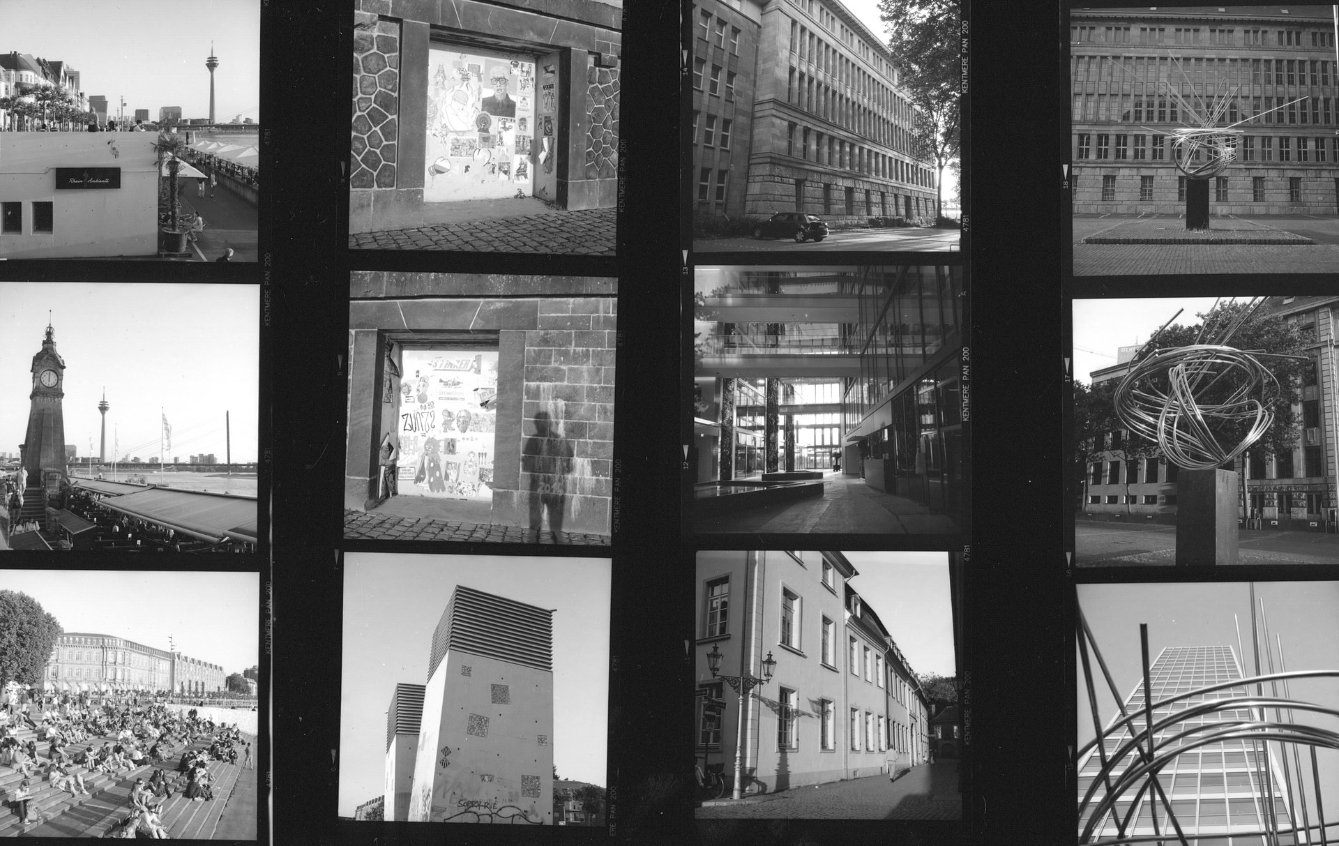

Here are the wet prints from the Kentmere 200-120 and the contact sheet. Camera was a Rolleicord V.

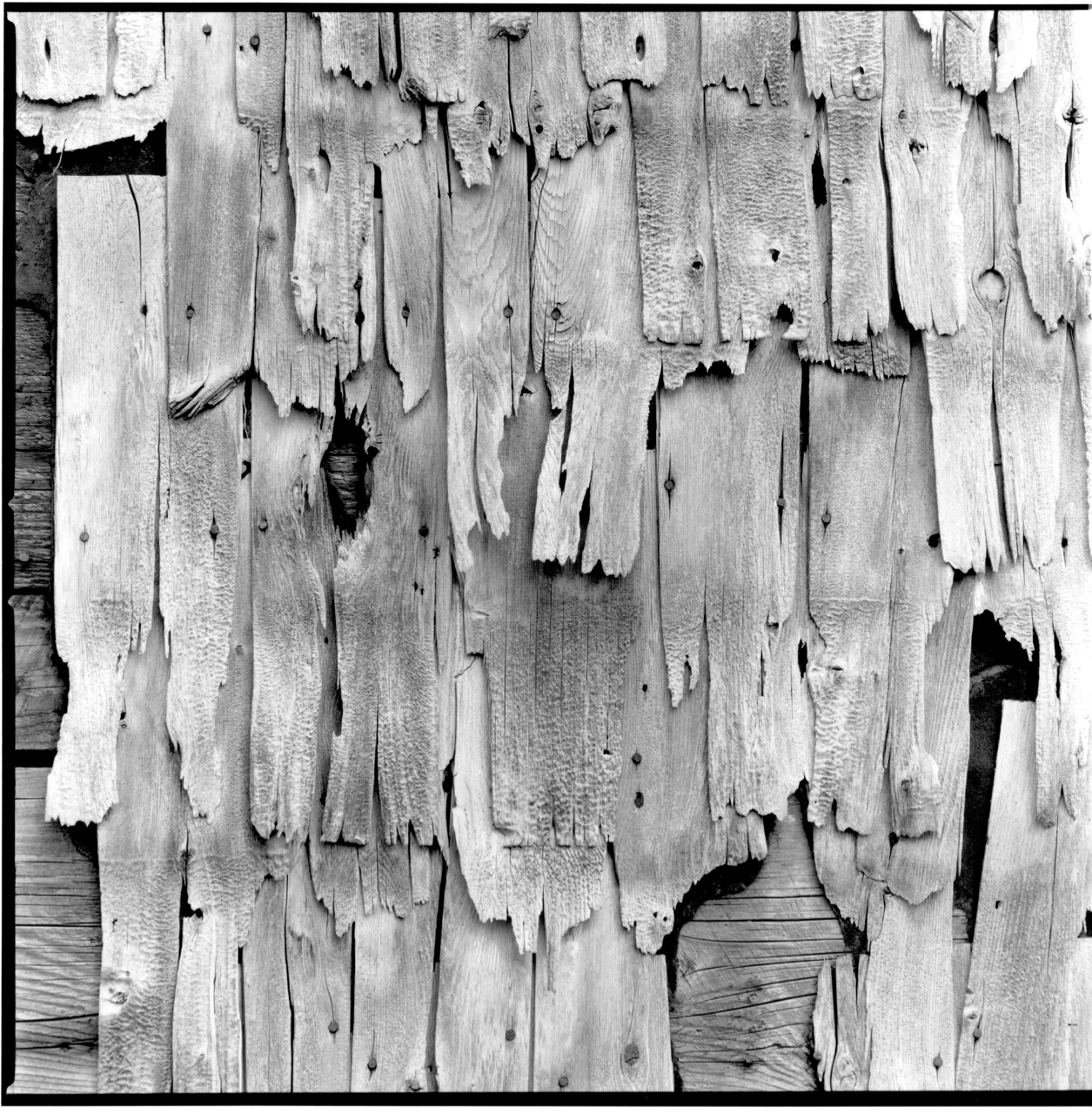

I shot a roll of this, today. Slightly hazy afternoon sunlight. Incident meter, indicated 1/250, f 11.2. Took 4 6x17 images with my Fujica G617. 1/250 @ f11. Developed in XTOL stock, 68°F for my default 8 minutes (my standard for Tri-X) constant agitation with Jobo. Negatives are drying look like my other negatives. Which is good IMHO. The old Kodak books would call the negatives "brilliant" nice snappy images.
BTW no prewash
(Of course the camera is 40 years old, at least, not absolutely sure of the shutter but makes lovely Fujichrome images)
Looks good! Do you already know if you can detect any obvious differences between this and Kentmere 100 or 400?
I don't mean contrast of course, as you can match that across the three. Anything else that made you go 'wow, this is something I didn't get with 100 or 400'

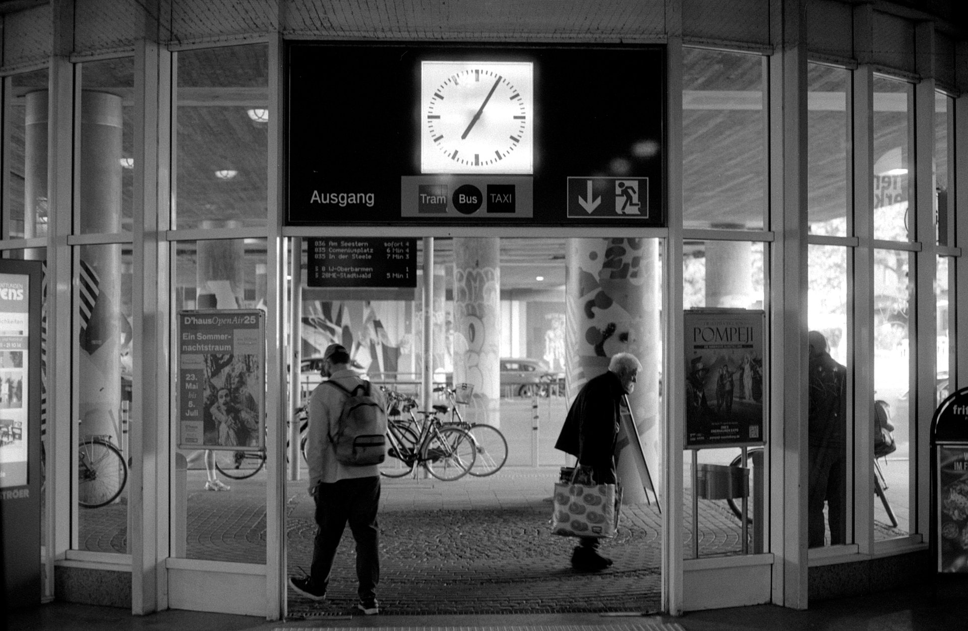

The K200 has more halations than K100 or even K400. It is not an issue with 120, but the effect is strong in 135. I will show some scans soon.
The halation may look nice if you have high contrast and intend to have a glow around the lights with a still sharp image. At low contrast scenes you may not see any halation at all. For night scenes with lamps in the field it may become annoying.
This is what I have found also, the halation is definitely more pronounced than many other black and white films. I don’t mind halation much of the time, but it could be a problem now and then. I suspect though that it will be seen as a feature, much like the Cinestill films.
BTW, so far I like how Kentmere 200 handles people pictures. I would use it specifically for this purpose.

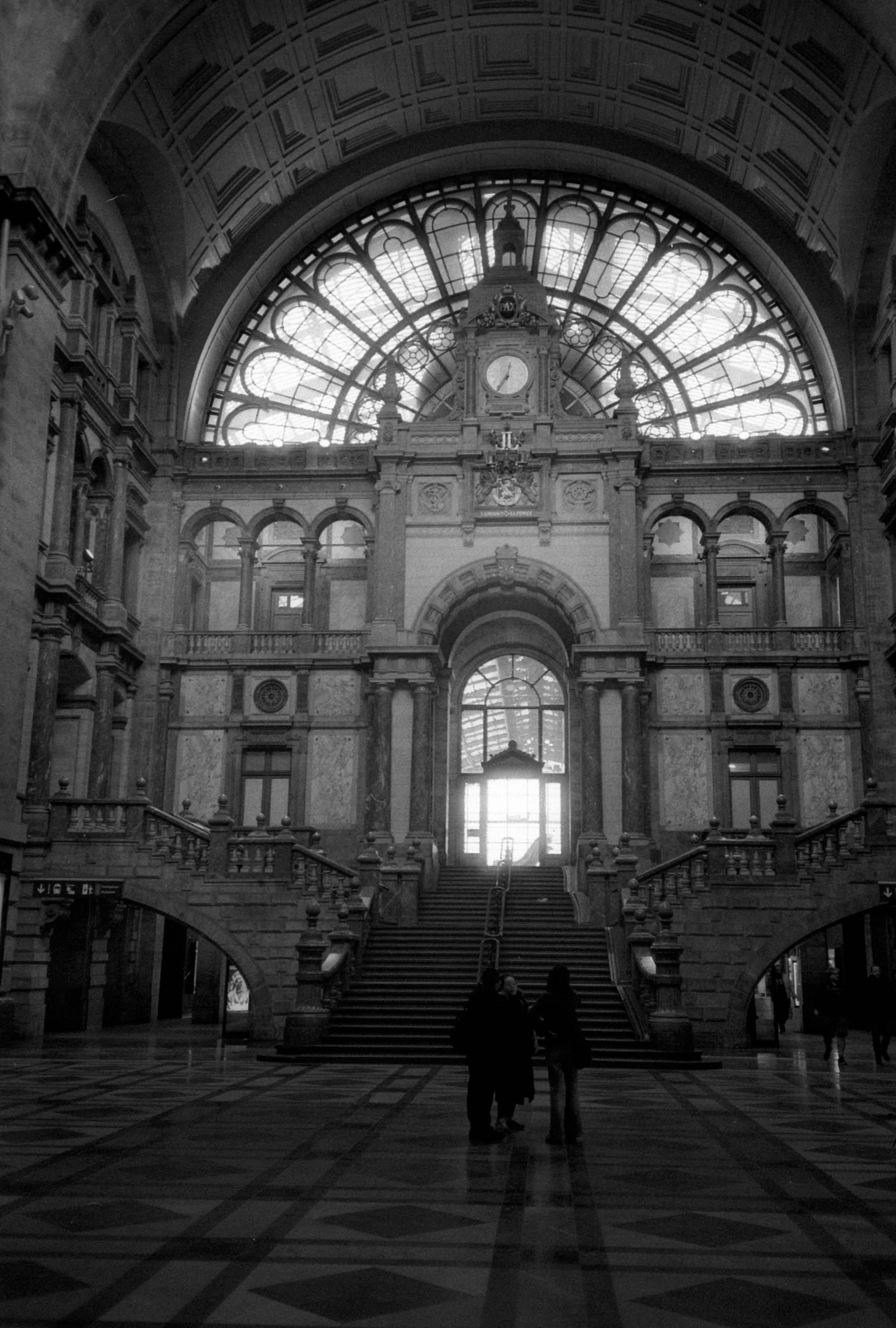

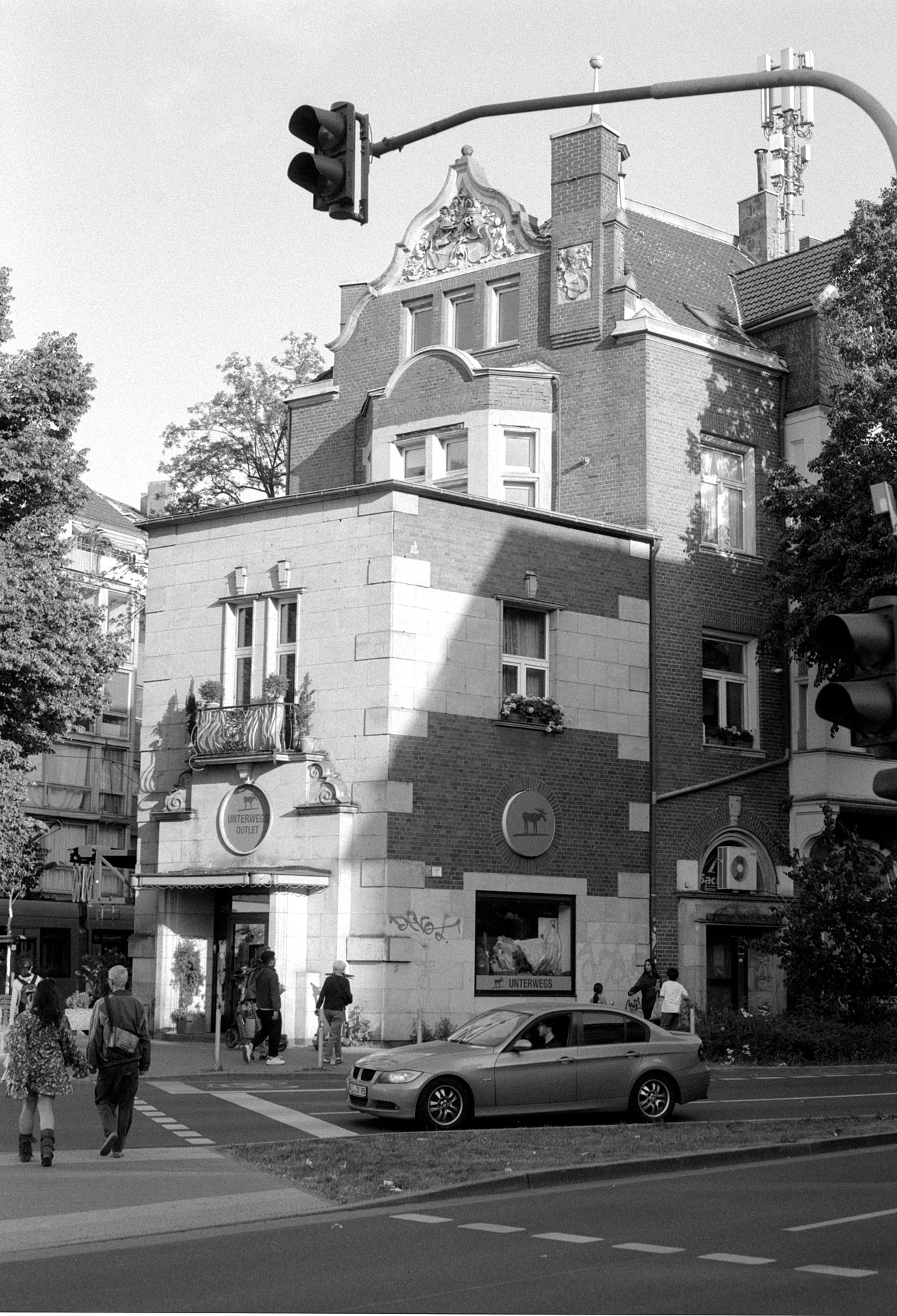

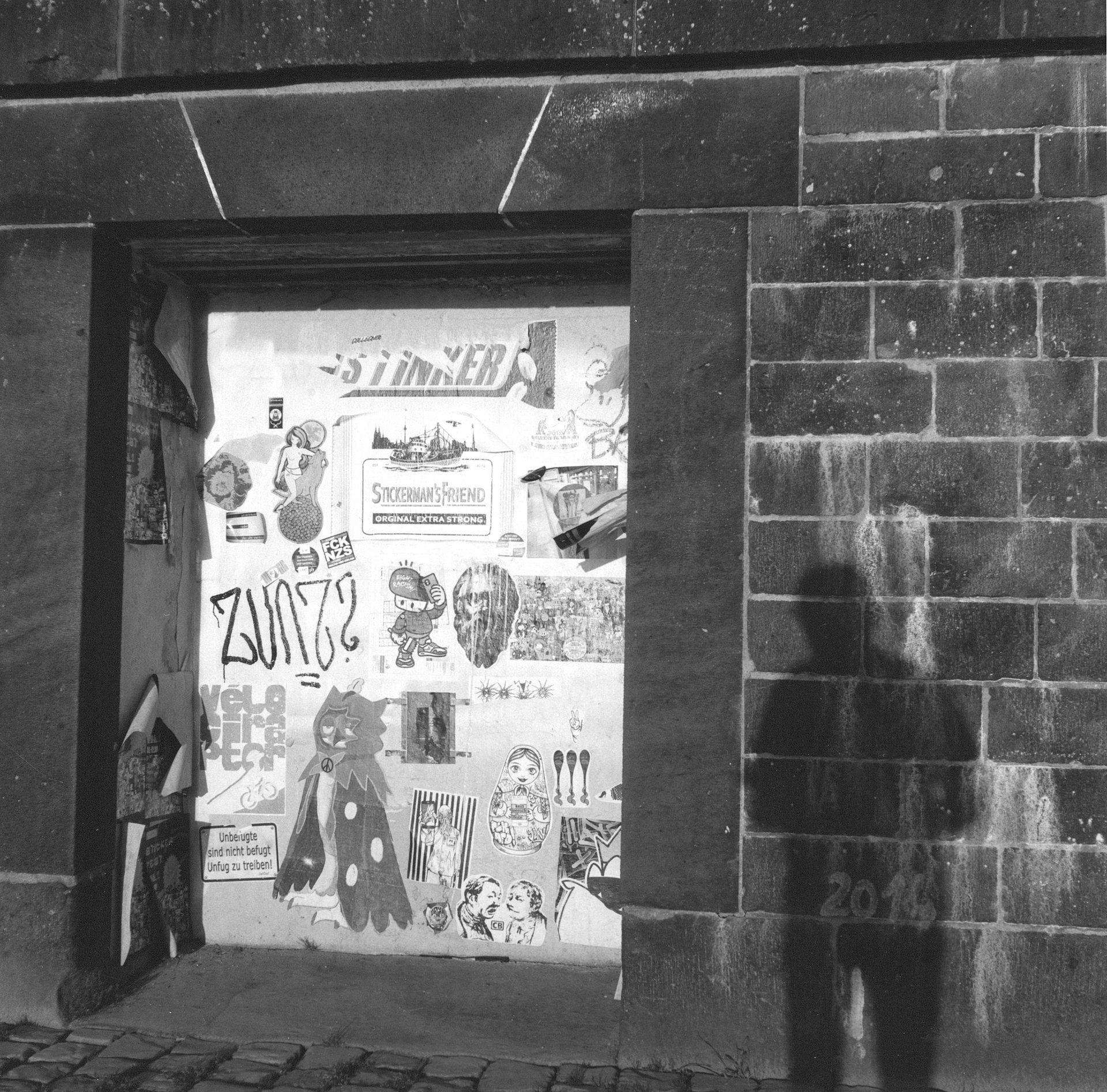

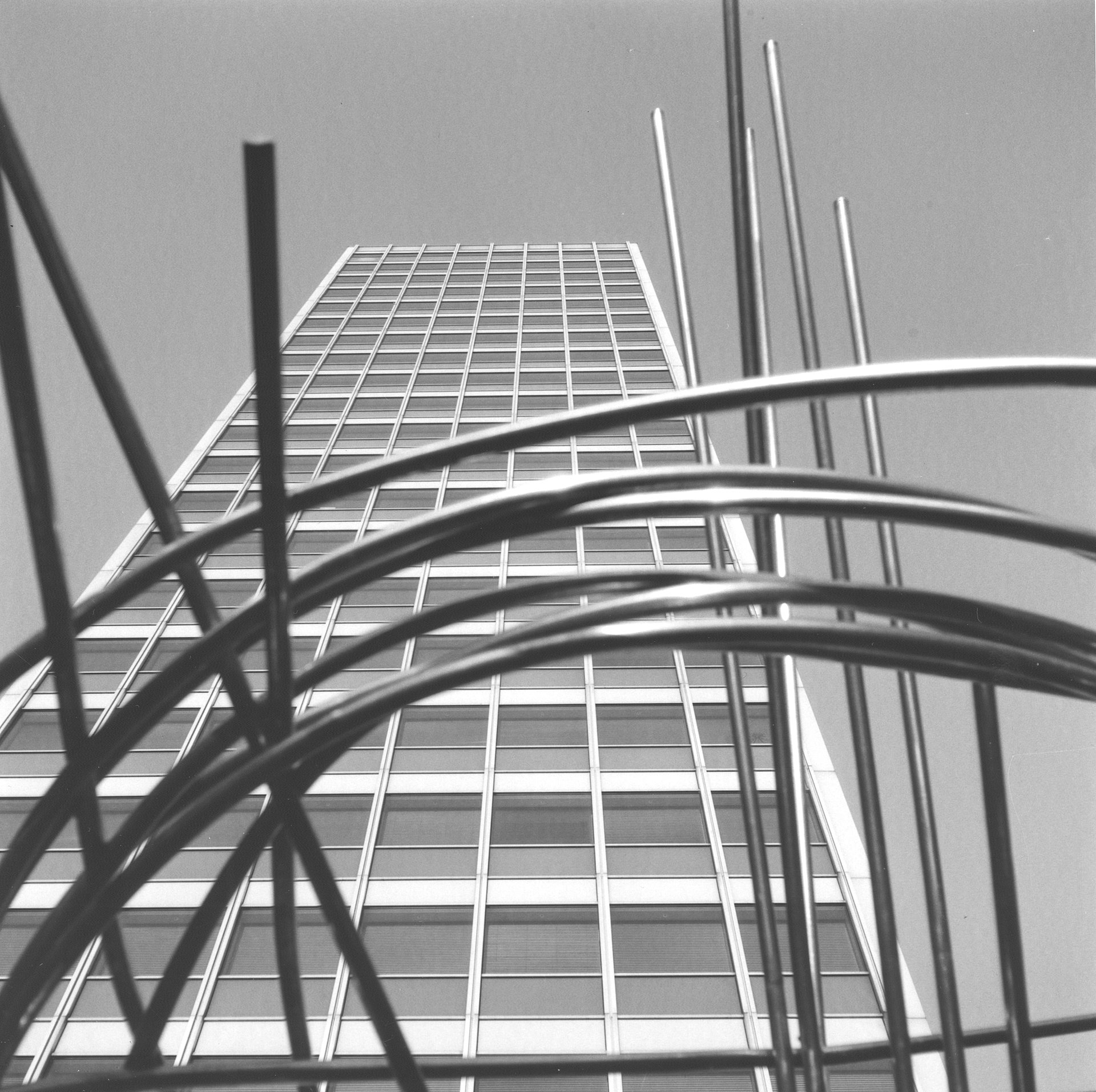

Some quick scans without post processing despite of reducing size and a little sharpening.
Asahi Pentax ME super, SMC Pentax-M 2,8/40 and 1,7/50
Adox XT-3, 1+2, 13 Min., Ilford agitation
Plustek Opticfilm 7300
Halation seems present, but certainly not excessive. Most Foma films in 35mm show more pronounced halation than this. Otherwise I can't tell much other than that the film evidently captures pictorial images just fine.

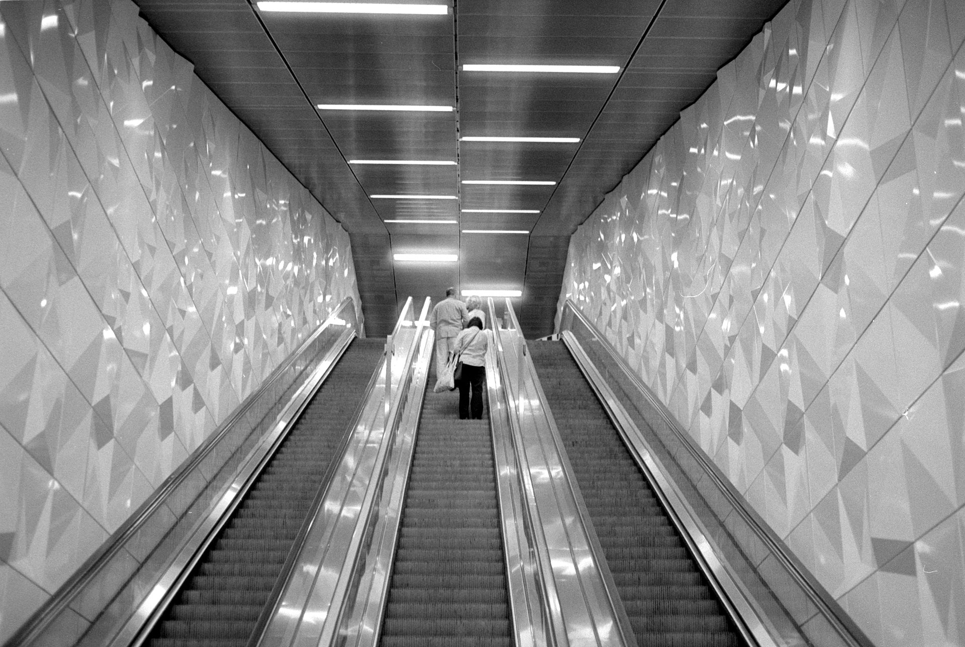

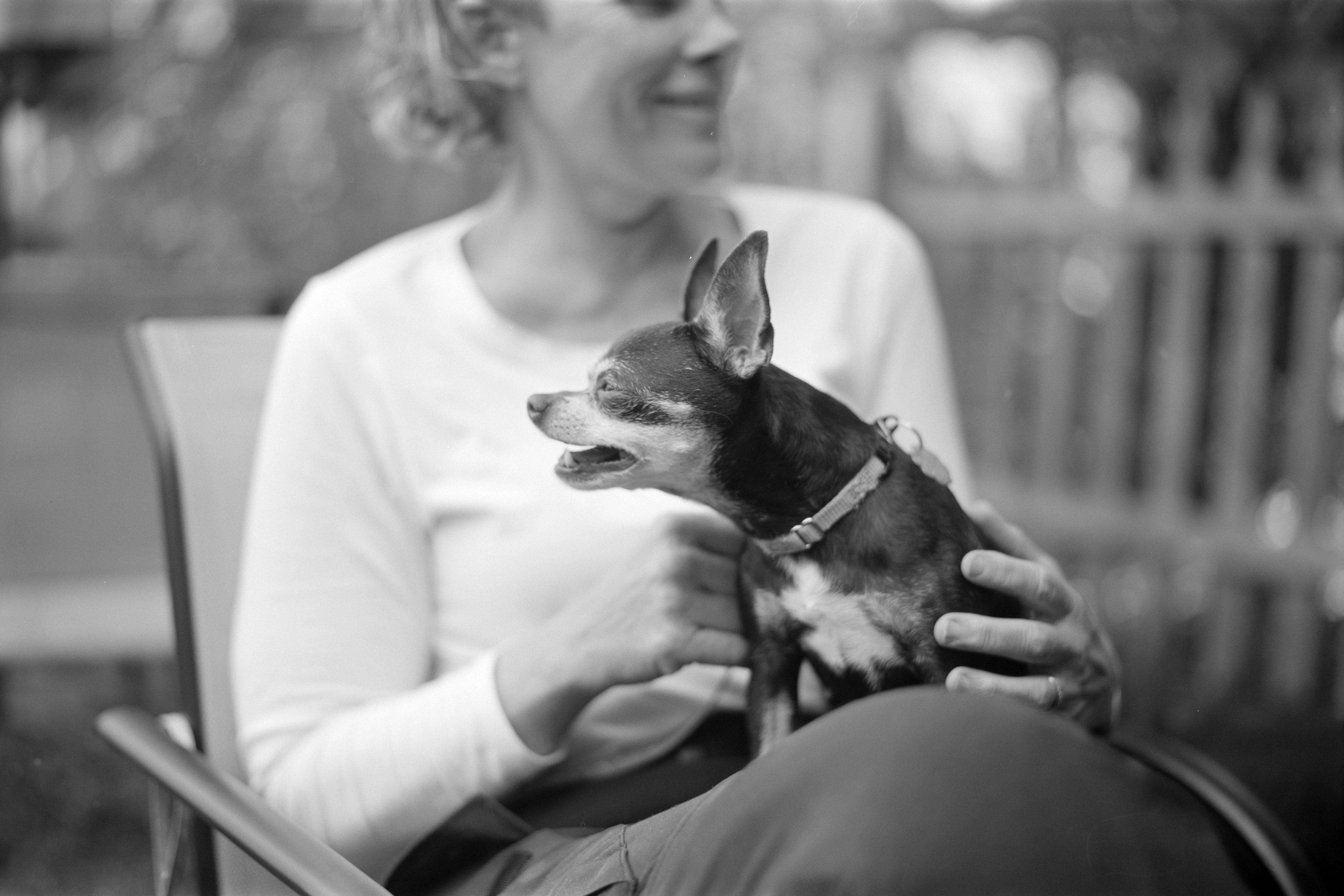

I shot a roll of Kentmere 200 in 35mm this week. It was overcast condition, so not conditions that would produce halation. This is the closest thing, and I think the image came out well.
