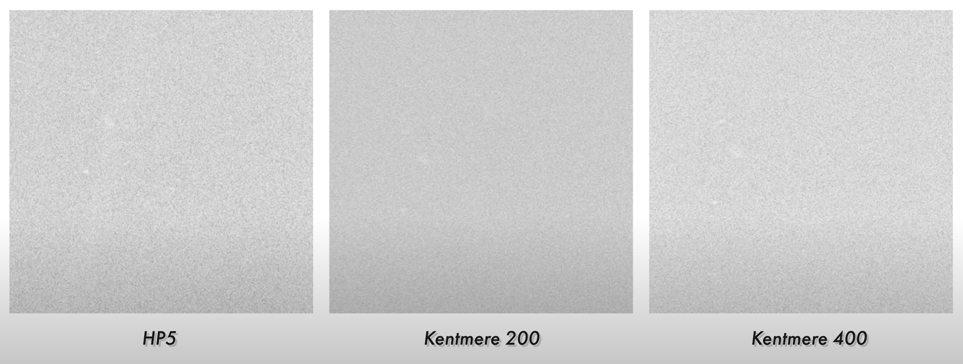

Grain:

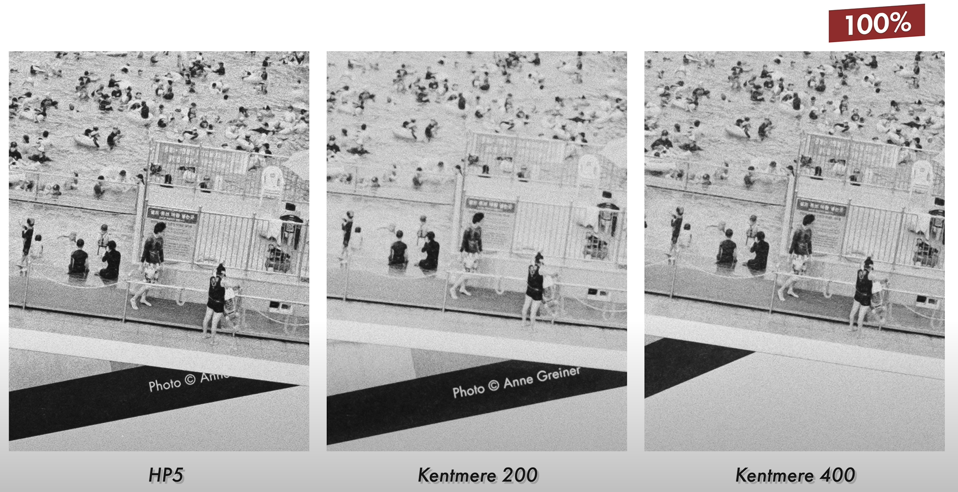

"Sharpness", this is an interesting one as, K200 appears less resolving vs K400 and HP5.
This sharpness test makes no sense. Everyone is in the exact same position. Would not have been possible to take that picture on three separate films at the exact same moment. It must be simulated.
I thought the same thing, but then noticed they're shots of a still photo. Could be a focus issue...or maybe it is just a soft film. There's a place for that!
Of the three plain light grey comparisons in #91 the Kentmere 200 looks as if it is the least grainy to my eyes and to a lesser extent this seems replicated in the swimmers/bathers scene
