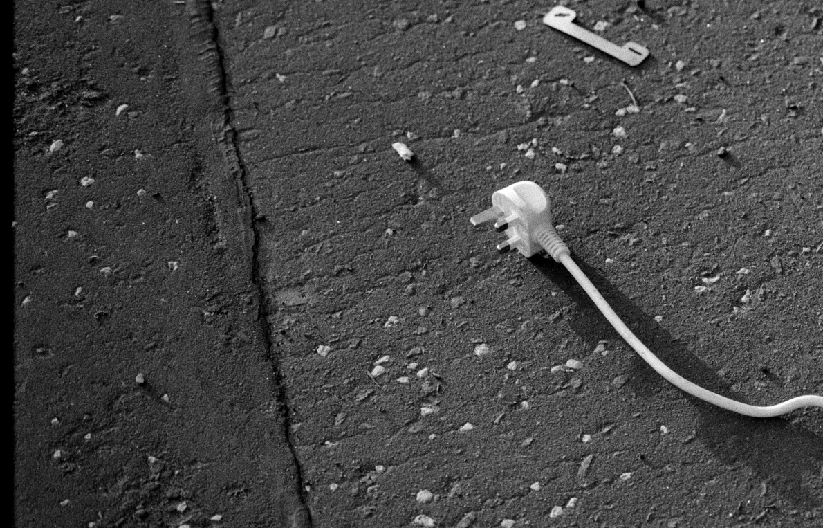

Hello,
I've got a Gl690 with 100mm f3.5 lens and shot 4 rolls of film so far and most images are not in focus it seems.
Checked the rangefinder patch allignment already and its looks good.
I do have a bit shaky hands sometimes but i shot some of the pictures at 500 shutterspeed using f8 or f11 so that should be fine too.
I will attach a picture at 100% zoom in lightroom.
I scan using DSLR scanning and have also tryed a flatbad with same results.
Greetings,
Robert
Did you try to put the camera on a tripod to see if your shaky hands are to blame?

Don't ask AI about anything technical, especially not something like this.
The problem is that multiple elements of your imaging chain are uncontrolled, so varying this and that is just chasing your tail and finding unlikely things to blame (loose film, skylight filter, etc).
You need to take steps to isolate the parts of the chain and systematically test them so that you can rule causes out and improve each part. One step is to take the camera to someone familiar with them to look for problems, but you can also do tests yourself. For example:
- focus rf on an object at infinity and see if the lens focus scale agrees. Same for an object at say 2 or 3 meters.
- use the improvised ground glass/screen (it MUST be flat and translucent, not transparent) at the film rails on objects at infinity and 2 or 3 meters, and test whether that agrees with the lens focus scale and RF. I am emphasizing that the focusing aid must be translucent, because you got inconsistent results before and it could be due to focusing "through" the screen onto the aerial image.
- Test on film. Use a tripod or rest the camera on something to eliminate motion blur. Focus on something like a fence or wall running diagonally away from you, so there is a range of distances. Focus on an obvious reference point you'll remember, like a sign or fence post. Take exposures at a range of apertures, like wide open to 2-3 stops down.
- Examine the negatives with a magnifier, not a scanner. You may be able to use a phone camera in ultra-macro mode. You need to see film grain; if you can't see film grain you can't make a critical evaluation of the image. Look to see if the image was sharp where you focused, or if it is sharper forward or back of the reference point. Look to see if the stopped-down exposures have a wider range of acceptable sharpness as expected.
- The scanner has to be eliminated from the chain because it introduces a whole set of problems that have nothing to do with the camera, but you can do a separate set of tests to get the scanner working correctly.

Just to establish a baseline, here's a very quick 100% crop from a 1000ppi scan of a GW690 neg ('well used' would describe the 690 in question). If the forum software doesn't do anything too weird to the file, it should show what a decent scan (old high end CCD, but competent camera scans should get more than close) without any added sharpening should look like in terms of granularity, sharpness representation etc.
Film was Kentmere 400 pushed a bit in Ilfosol 3.
Winding problems/ dropping frames in a 690 are usually an indicator that it desperately needs a service. They were often used pretty hard.

Did you try this................without looking through the viewfinder window rack the lens to INF, the furthest focusing. Now look through the viewfinder and see if the range finder patch is inline and focused correctly on a far subject. Also, have you taken a photo of a far distant subject with the lens set to INF? If your photo is sharp (subject sharp) at a far distance with the lens set at INF and not sharp when you focus properly at a subject, say5 to 10 foot away, the your rangefinder needs to be adjusted, which is not a major job.

If you aren't loading the film correctly it can lead to numerous problems. For any 120 camera keep your finger on the take-up roll until the arrows line up with the marks then close the back. This step is mentioned in your camera's manual. If you don't the film leader can be wound onto the take-up roll loose, and you get your uneven frame spacing. But it can also become a spring, and some films are more 'springy' than others. If there is a lag between exposures the springy film can then unwind and press outward against the pressure plate causing it not to be flat come the next exposure. A loosely wound roll of film is often called a 'fat roll', and because it isn't tightly wound when you unload it it can cause light leaks. And always wind to frame 1 and don't second guess the process by stopping winding before the camera has cocked the shutter.
I think there may be some bad technique with the use of the camera or in scanning or both but just try to solve one thing at a time. The first step would be to get yourself a manual for the camera and understand it, here
https://butkus.org/chinon/fujica/fujica_gl690_gm670/fujica_gl690_gm670.htm
the manuals are free but a donation is polite.

Infinity and close focus are ok... i shot a new roll of film this time i loaded it correctly and winded to frame 1. Iam going to let the negative scanned to see the issue.
