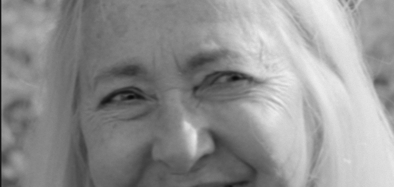

Hello,
I've got a Gl690 with 100mm f3.5 lens and shot 4 rolls of film so far and most images are not in focus it seems.
Checked the rangefinder patch allignment already and its looks good.
I do have a bit shaky hands sometimes but i shot some of the pictures at 500 shutterspeed using f8 or f11 so that should be fine too.
I will attach a picture at 100% zoom in lightroom.
I scan using DSLR scanning and have also tryed a flatbad with same results.
Yeah, and the unsharpness doesn't look like motion blur.
Can you post a full frame?
If you shoot a scene with objects at various distances from the camera, does anything render sharply (although not the objects you focused on, I assume)? If so, do objects closer or further away from the focus point render sharply?

Iam trying to post full frame but its not uploading somehow.
I did have something sharp once i think it was at 3-5 meters away, so i think further away more in focus.

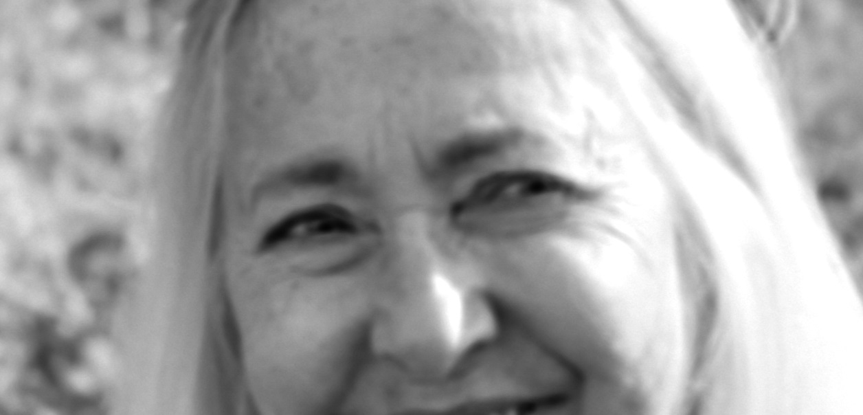

I just did a scan with my digitaliza holder and somehow its already better result.
I'm asking because of the grain. If you had used something like TMAX100, the grain might have been difficult to see on a not-so-great scan. The grain of FP4+ should have shown up clearly in your scan.
Scanning is part of the problem, but probably not all of it. Btw, the second scan you posted is also not so great, but that's a different problem. I'd focus on the camera for now.
PS: for comparison, this is a snippet of a scan I was just working on now:
This is a pretty mediocre flatbed scan at effectively 1200dpi but from a very fine-grained film (Kodak Vision3 50D). You can already see the grain appearing on this low-res, soft scan (with some USM applied). Your FP4+ negative should show much more and tighter grain than this on a decent scan.
If you can't see the grain in an FP4 negative when scanned, then it's a problem with your scanning technique, not the camera.

re: your scan. Can you assure that you didn't miss focus?....or the subject did not move?.....& what % of the image are we seeing on the scan....& what aperture was the photo made at?
Iam sure i didnt miss focus, it was non moving, the uploaded picture is 100% zoom of the image taken at F8 i believe and 500 shutterspeed.
