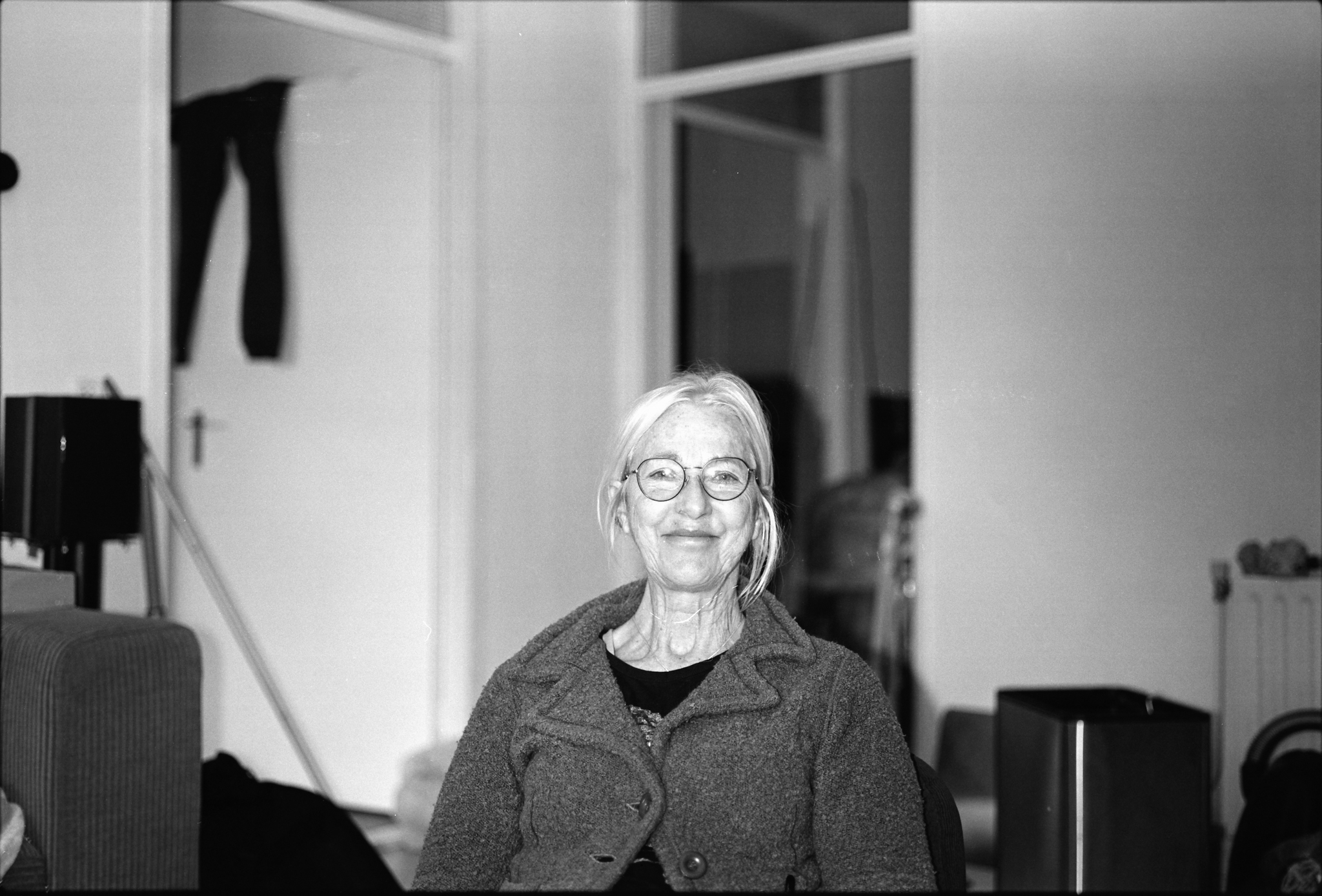

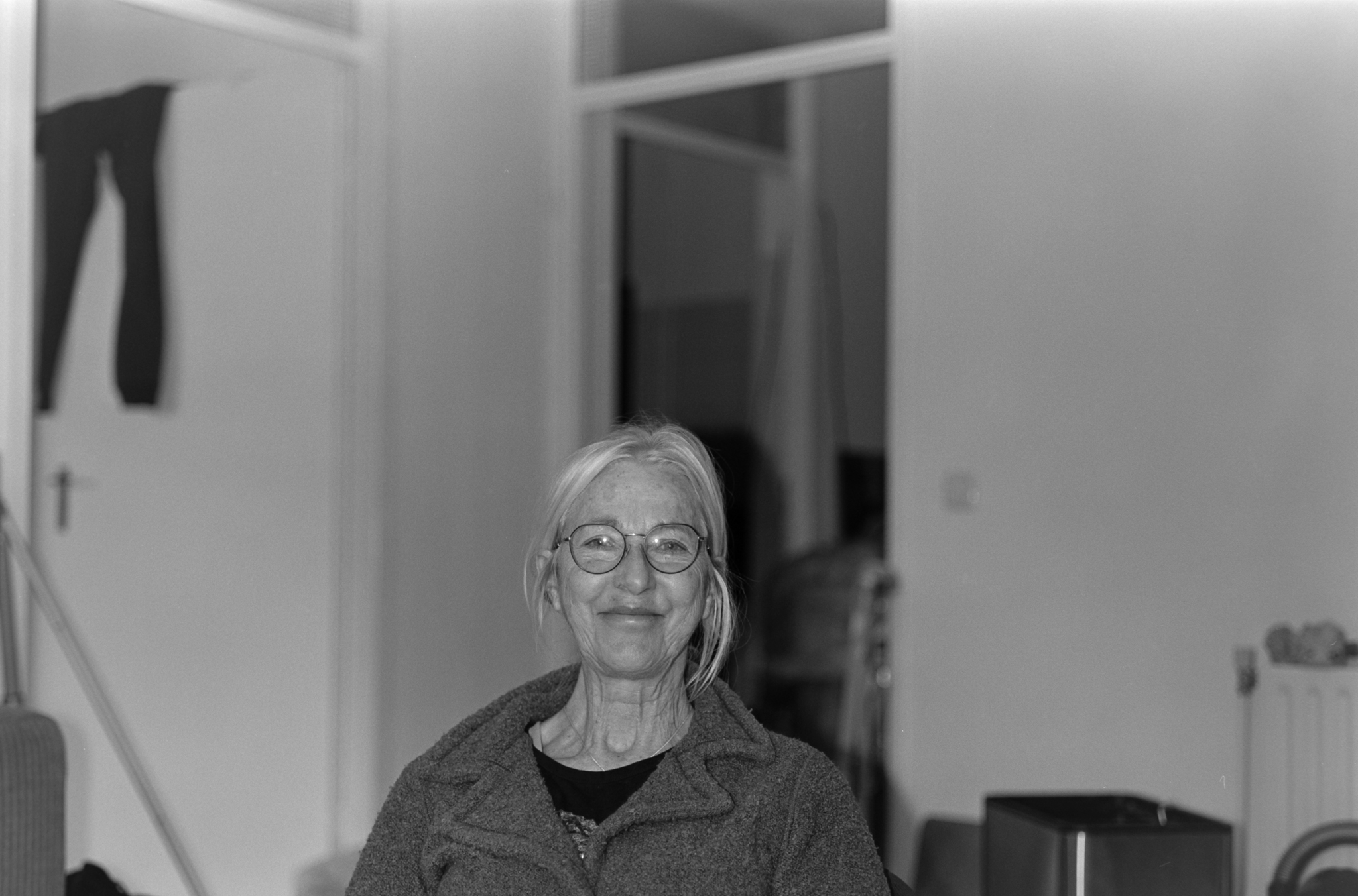

OK big update on this one:
It wasnt the lens.
Dont lauch.. i tryed to ajust the rangefinder screw and it didnt go so ended up removing the whole screw.
Then i came to the conclusion that i almost destroyed my camera.
I removed some obstacles that stoped the mirror from moving.
Then when the mirror moved from 0-100% i removed the side prism mirror.
I glued the mirror on a different angle so the rangefinder patch was almost near as good as possible.
I found out the framelines now also changed.. they first didnt.
I guess the previous setup also stoped the lens from focusing (Because of the screw).
I made some test shots on tri-x400 see result from flatbad scan canon mark ii 9000f.
f3.5 125 shutter on tripod now sharp .. dont watch the mess in my livingroom.
Thanks for feedback all!

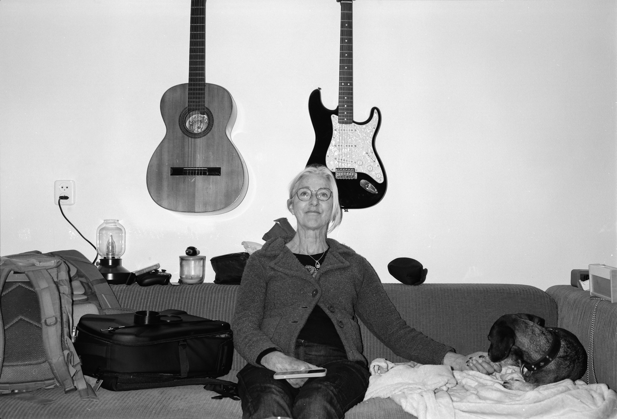

DSLR scan :smile:
I got the information also from this site:
