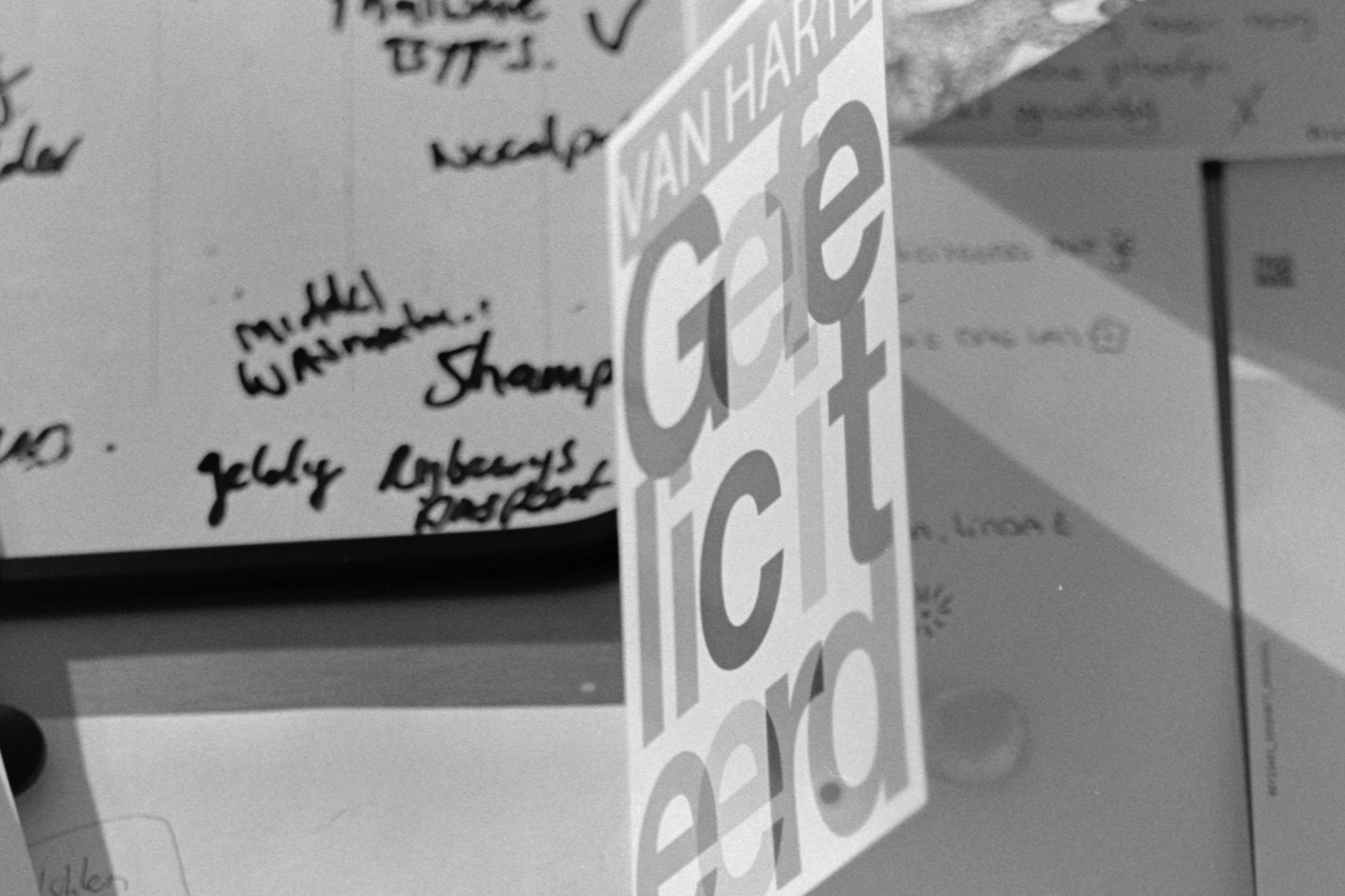

I developed the roll i shot yesterday on a tripod focussing on a birthday card on my fridge with flash on f22 ss 125. and with cable release.
Then i put my macro lens on 1:1 and scanned 12 frames and stitched them together in lightroom.
I believe its in focus..?

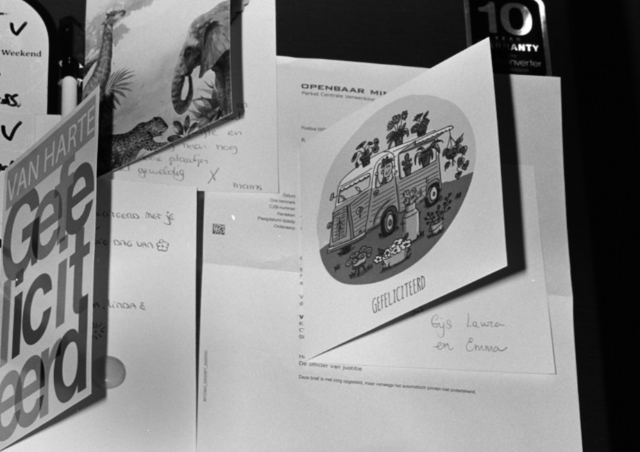

Impossible to tell. You shot at f/22. Tests like these should be done at the maximum aperture (f/3.5 in your case I think). Otherwise it's too easy to overlook focus issues due to the larger depth of field.
i did also shot at f3.5

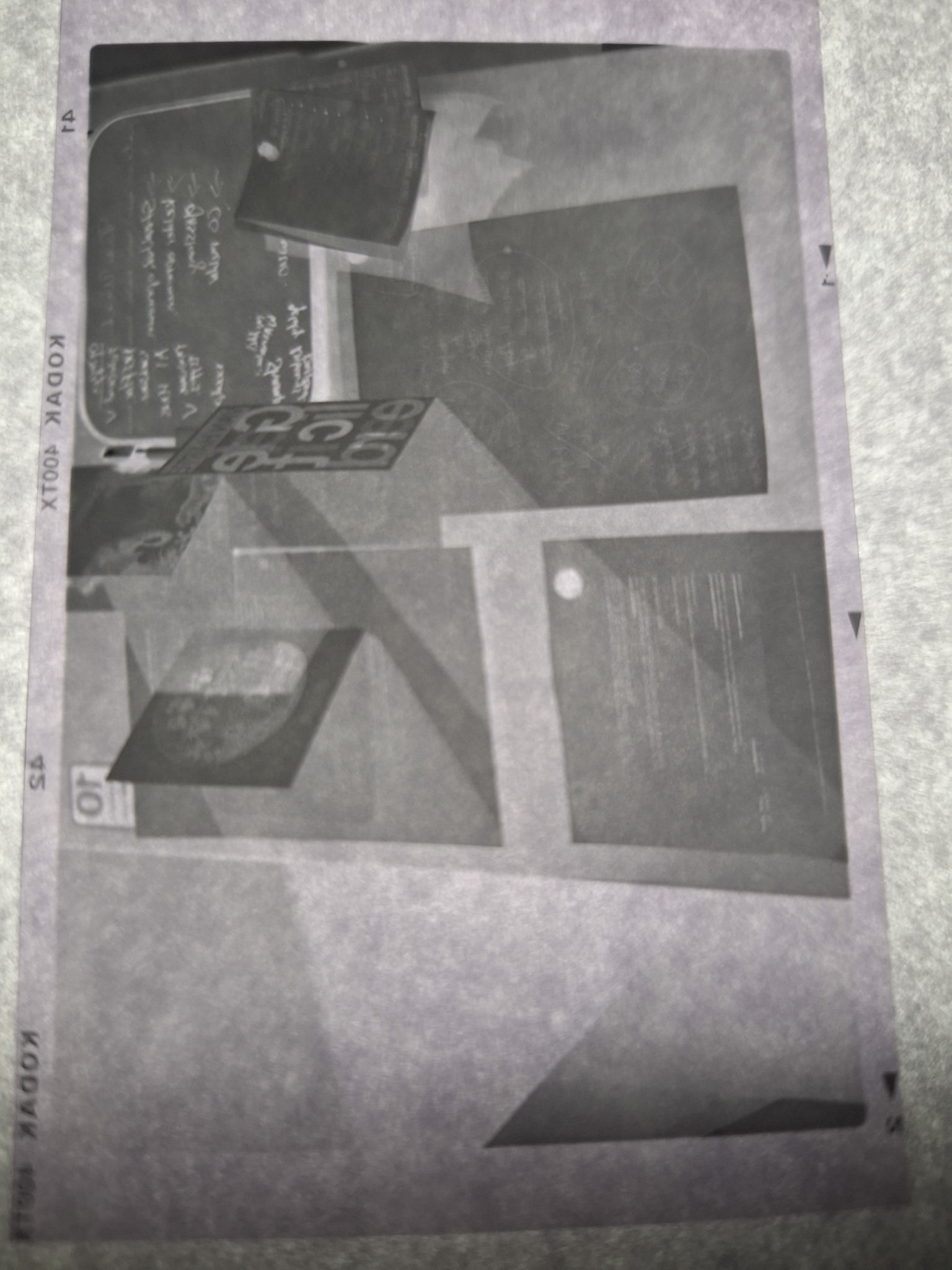

Put it on a
place it on a computer screen (with a blank white page on it) and take an iphone foto.
a stitched photo isn't a good example.
here it is..

As you can see you have a bit of front focus.
can i fix it myself? cold shoe off turn the big screw i think it is?

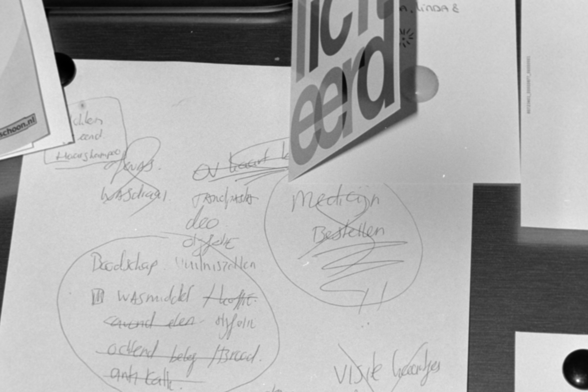

Found some tape used for this kind of messurements of the film plane.. now i see better whats in focus i must say, so from what i can see now 1 meter object is not in focus at 1 meter film plane.. but in stead 2 meters .. but then again 3 meters to 5 looks sharp too
