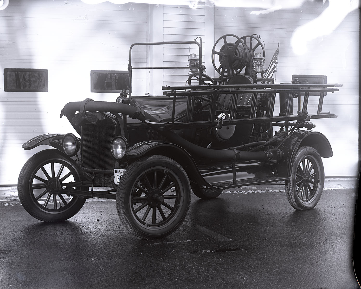

I developed one of my recent plates last night. Came out well. Here is a scan of one plate (the blob in upper left is emulsion on the back of the plate that I didn't clean off before scanning). Did not do anything to this except scan it in and reduce resolution for uploading.

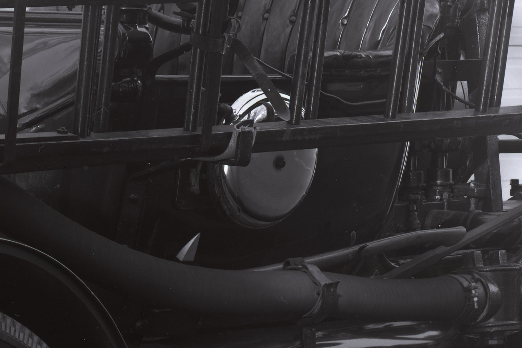

The following is a crop of the plate equivalent in size to a 35mm frame (36mm x 24mm). This will give you a better idea of what the grain looks like. Ignore the stinkin' dust.

Hi,
looks good. :smile:
Are you using a antihalation coating on the back of your plates?
Have a good new year
Jens
Hi,
looks good. :smile:
Jens
No, I haven't yet seen the need for it. The subtle effect on bright objects in the scene is pleasing to me, and not overpowering. I think the emulsion thickness helps this. See the picture of the abandoned car in my media.

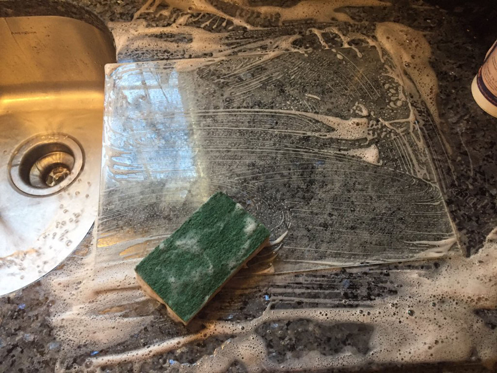

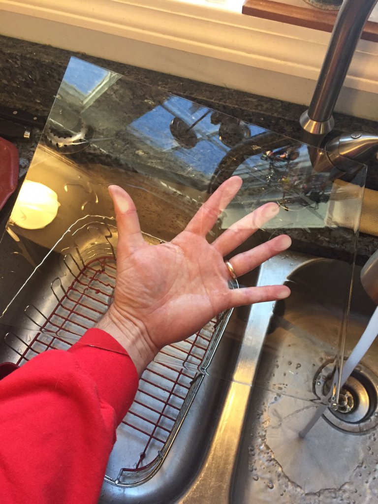

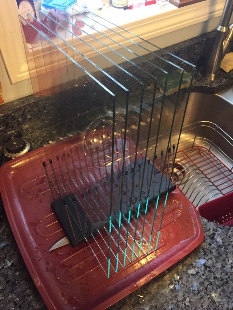

I just coated a set of plates 11" x 14" in size for a gentleman who requested them. They came out awesome. I wish I could take a picture of the finished plate, although I did get pics while I was prepping the glass.
If you need any size plates, let me know.
-Jason
Those 11x14s must have been fun to coat.

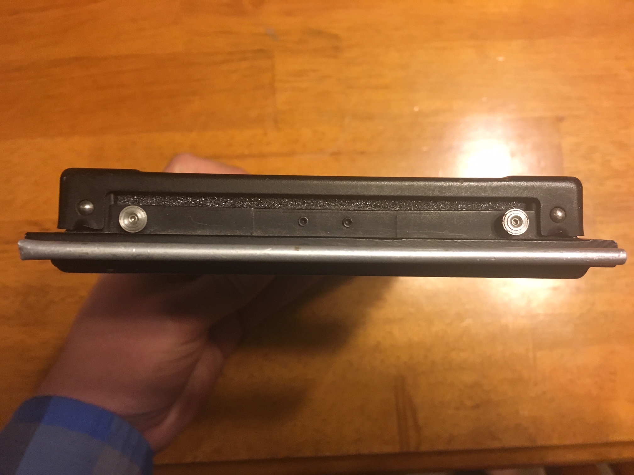

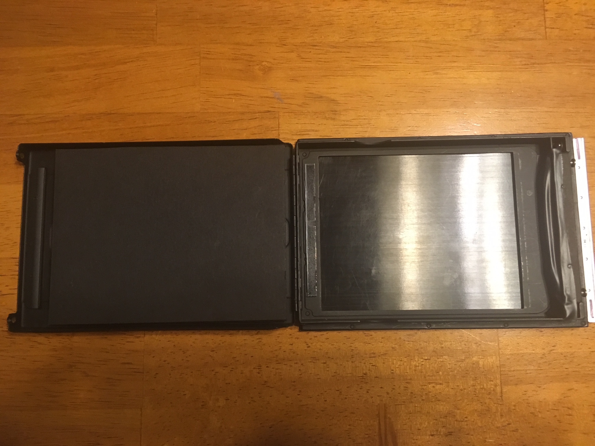

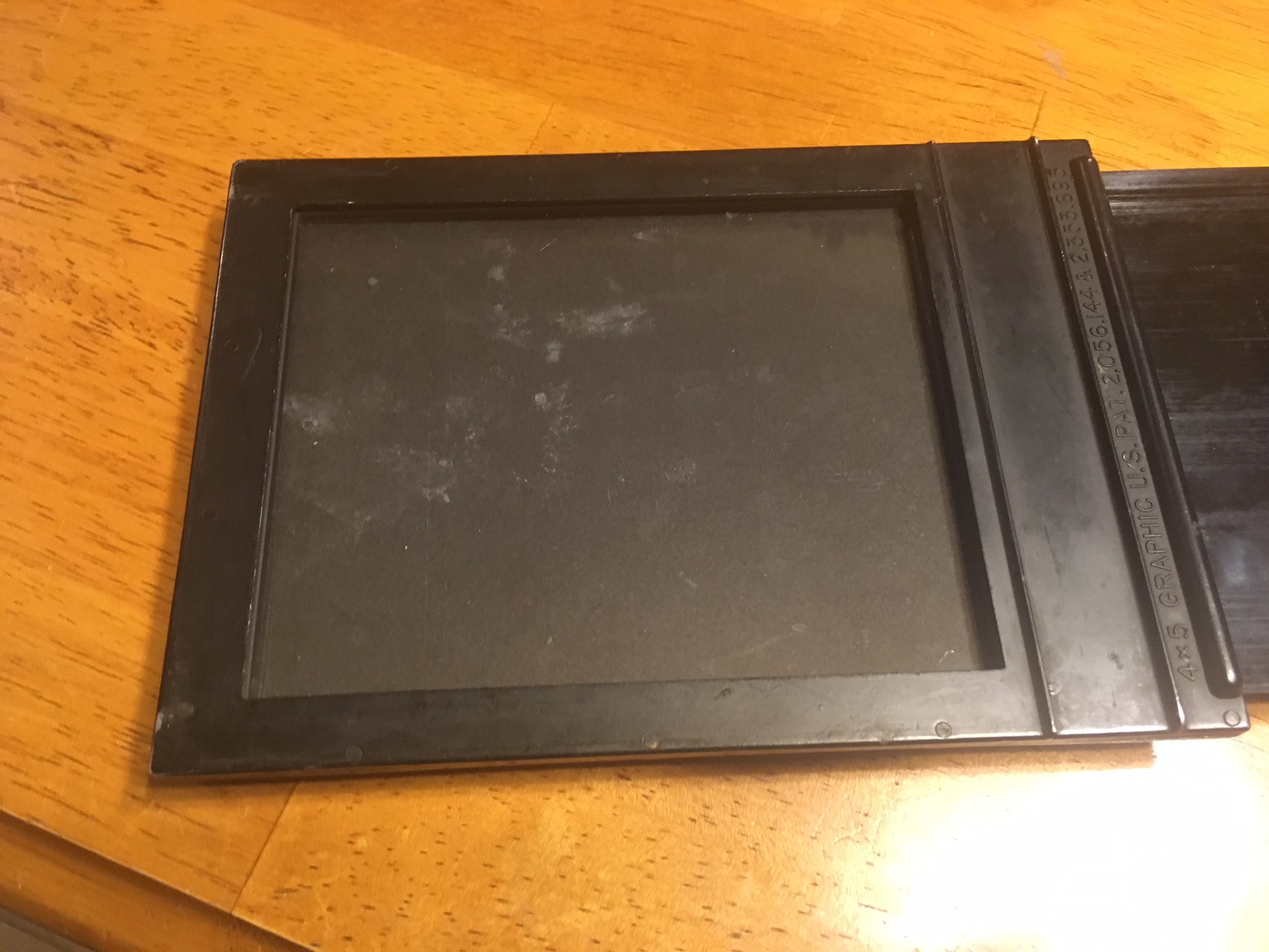

I have been using modified Graflex Pack film holders for glass plates with success for the past 3.5 years. Two sheets of foamcore hold the plate against the front of holder. I blocked the area where the film moved in the pack with foamcore and electrical tape. The main downside is each holder can only hold one plate.

Now I have a use for my film pack adapter. Thanks for the tip!
