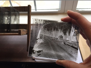

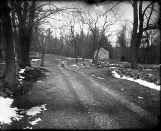

I have fresh 4"x5" dry plates available for sale that I made as part of my latest batch. These are "extra" above and beyond what I need for my own purposes (helps offset the costs a bit). If you ever wanted to try dry plate photography, this is your chance.
There are three (3) 10-plate boxes available. $35 ea. box plus $7.25 shipping.
ISO 2, developing instructions on the box (I got creative with the label). You'll need a plate holder (they are too thick for film holders), but otherwise they work just fine with a 4x5 camera. If you do your part, the results should be comparable to the photos below. Keep in mind that these are hand-coated. I screen them for major flaws, but there may be minor flaws which add .. character .. to the final product.
