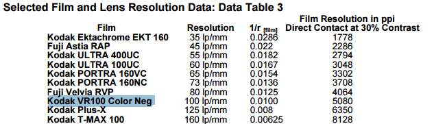

See this table:
Reference: http://www.tmax100.com/photo/pdf/film.pdf
These are results from contact copies. Amazingly the 40 years old VR100 (The kodak product that introduced T-Grain in around 1980) has the best rating of the color films, but it had some grain and more color noise in the scanning. If you make clouds larger then clouds from a color layer overlap better with clouds in the other layers, lowering color noise in the discretization.
There always had been a trade between size of color clouds vs granularity, a film that scans easy may require larger color clouds, at the end lost sharpness can be compensated with a wise digital sharpening. Of course a detailed analysis should consider what average cloud size we have for each density in each layer, measured in the reticle of a microscope... but to compare it's enough to inspect at x400 how gray subjects with same density (concrete buildings, for example) have the clouds overlaping less or more.
In the other hand that contact test suggests a resolution value in ppi, this is 3300 to 3700 for the old Portra variants, but those are tests from contact copies, those figures have to be lowered for practical shooting conditions, the same document calculates the actual ppi once the lens performance has degradated the image, note that Portra 160 was peaking 2450 with a very good 140 lp/mm lens:
This fully explains why an Epson V700 is able to get all IQ Portra 160 is able to record, as it is able to resolve 2900dpi effective in the Hor axis and 2300 in the vertical one.
I guess this table is a precise answer to what OP was asking.

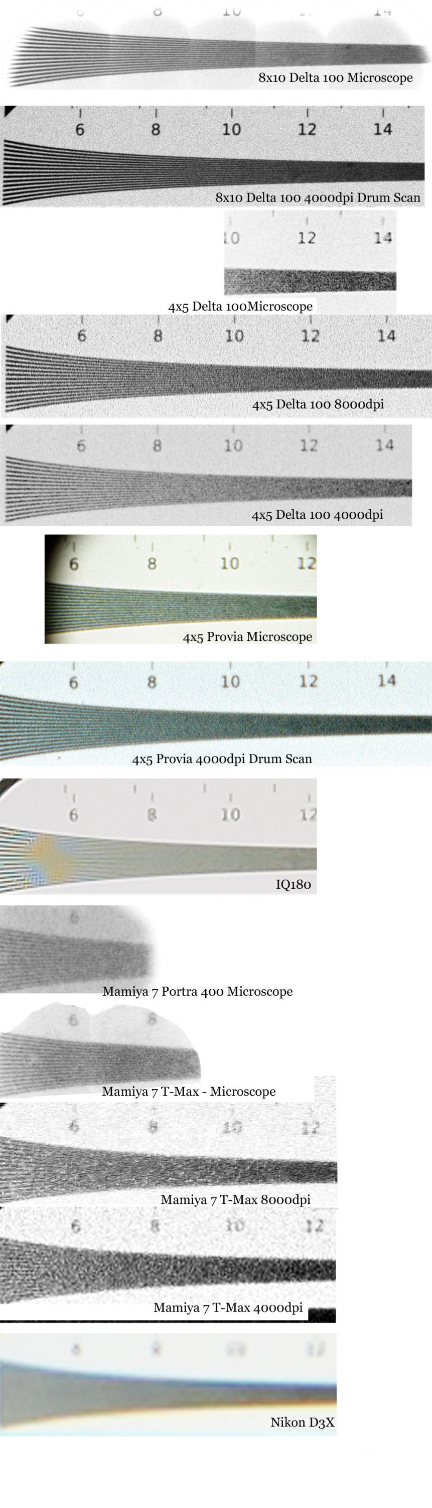

There have been several examples or hints at just how much resolution is in a square inch/mm of film in the intervening fifteen years.
Here is a two examples;
Tim Parkins tests are pretty famous. Here is one of the more interesting images from one of them (in this context) from his, “film against a Phase One 80MP back”, test.
Don’t pay any mind to the changes in film size between examples, as long as you compare the same size against itself, you are good.
The emulsion is if not exactly the same then much the same between 135 and 8x10.
What matters is the dpi of the scan and the magnification.
Notice how close Portra 400 and Tmax 100 really is in the Mamiya 7 microscope crops (while the structure certainly looks different).
Also notice the jump from 4000dpi to 8000dpi, and how much is still left to resolve in the microscope examples from the same piece of film:

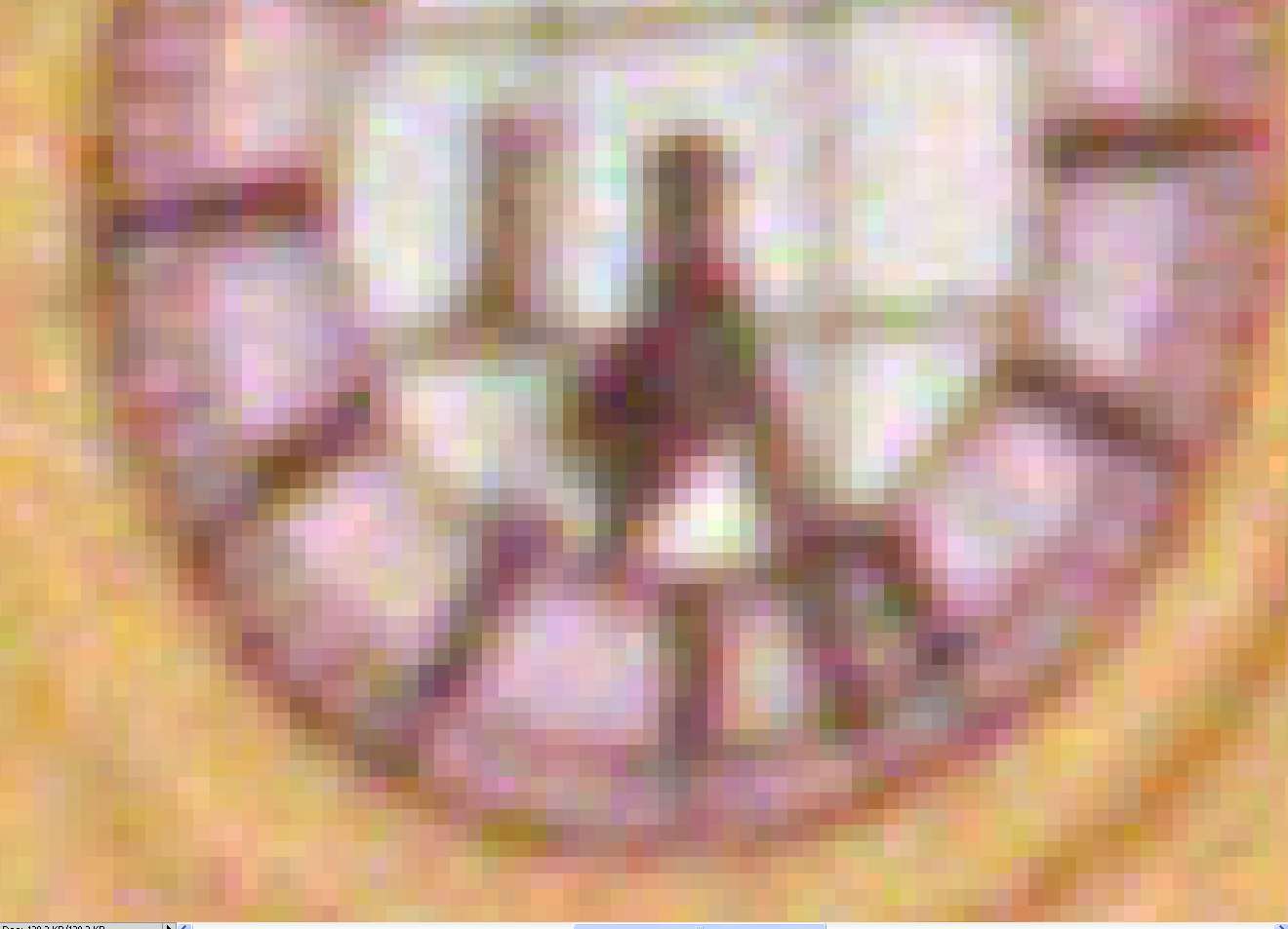

Here is a another good example of how much resolution it is possible to get out of film, and this not even with optimal equipment.
IE “only” a 5400 dpi scanner and less than optimal film to show resolution:
http://www.rokkorfiles.com/7SII.htm
Notice how you can see the individual minute marks on the clock face!
This is far, far from the 2600dpi claimed by 138S and authors of the articles as the practical limit for colour film.
View attachment 253272 View attachment 253273
Helge, this crop is made at 5300dpi, yes, but the 100% crop is quite blurred and probably you have no more than the half (2600dpi) effective.
I'm totally confident that the Epson would be able to catch all IQ that this negative has if scanning 4800 or 6400 to also yield around 2600 effective.
A simple test to check the effective level of detail of an image file is to downsize it (e.g. in Photoshop) to see at which resolution the image loses image content details. You can download that crop, load it into Photoshop, set the resolution to 5400 ppi (without resizing) and then resize to lower resolutions. Resizing the scaled down image back to the original resolution and adding appropriate sharpness will help seeing which details can be retained and which are lost in the process.
That crop started to lose detail already when resized to 4000 ppi and the other crop on the website Helge linked to had more than 4400 ppi worth of detail. Thus, the level of detail of the original negative has been at least 80-90 lp/mm for those higher contrast structures. Downsizing to 2600 ppi will make a blurry mess out of it.

If you take the original crop and you make a super pixel peeping (of the clock) in Ps you will find that an edge takes around some 4 pixels to make the transition, this suggests that the actual effective performance is less than 1/2 of the scanned resolution, so 2600 or less, by no means it is 4000.
See here the edges in the clock:
