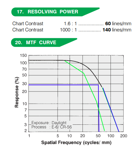

And at such low to moderate contrasts films like for example HR-50, TMX, Delta 100, Provia 100F, Velvia 50 / 100 etc. achieve resolution values in the 120 to 150 lp/mm range (depending on the used lens).
This is the 1000:1 graph from Provia datasheet, I painted the extension to 140 and a possible 1.6:1 curve.
Note that at 1000:1 contrast and only 50cy/mm 70% is already destroyed. Any pictorial situation will lay between the 1.6:1 and the 1000:1 curve, but even at 1000:1 by 50cy/mm most of the quality is destroyed. IMO one thing is the technical capability to resolve an another thing is what is worth for pictorial usage.

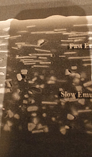

See the TMY cross section, for sure (don't doubt it) TMX also has a cubic component for linear large latitude in the highlight, if you blend the two components that horizontal aligment of the T crystals would be a chaos. IMO your single layer coating of TMX is an elocubration without base, rumorology.
My view is that the double layer adds incredible performance to TMX, and that Kodak won't sacrifice that easy after developing the 9 sensitive layers for color. If you have a true evidence please post it, with the reference document and the author.

Helge, TMY, TX/TXP for sure (and probably TMZ) are made in two emulsion layers and they are not color films... To me it's quite hard to belive that for TMX Kodak renounced to double layer emulsion, because that insane latitude/linearity would be hard to obtain with a single layer.
As already explained several times, please do not overrate these data sheets. You cannot transfer them 1:1 into real pictures.
With your example here with Provia 100F, we can ensure you that the final results concerning resolution will look better as it would be expected from the datasheet. Fujifilm is in general a bit conservative (underrating) with the data.
