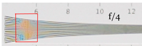

https://en.wikipedia.org/wiki/Nyquist–Shannon_sampling_theorem
Of course reconstruction depends on the nature of the function, but an image is a "worst case" because the function is totally arbitrary, still we may consider that our function has a Fourier Transform, to apply that theory body. That "worst case" scenario implies that you need that safety margin in the samplling rate to not loss too much.

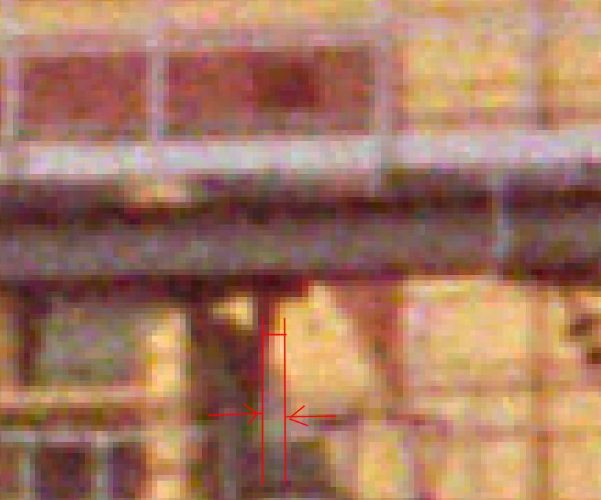

If you downsize to 2600dpi a larger image that is 2600 effective you will lose the 2600 performance. Try to sample a 20 line pairs (40lines) with 40 pixels, you'll get pure aliasing !!!
Again, from a super pixel-peeping, see how many pixels an edge takes for the transition, this not worth the half, clearly under 2600.
You manage to prove yourself wrong in reverse order within this post. Take a look again.
You never ever want an abrupt square waveish transient in a scanned image, or any kind of real world sampling. That would mean aliasing and beating as you touch on in the first half. And would mean that you need to filter, or increase sampling rate.
There is clearly more information in the image. The scanner just wasn't up to the job of extracting it.
You read the the sampling theorem and information theory like the devil reads the bible.
You might want to look through this one: https://www.wescottdesign.com/articles/Sampling/sampling.pdf

1) Depending on film resolution you require more or less scanning resolution.
2) We were evaluating the resolution of an image posted by you, that clock...
3) Here someone says: "A simple test to check the effective level of detail of an image file is to downsize it (e.g. in Photoshop) to see at which resolution the image loses image content details. You can download that crop, load it into Photoshop, set the resolution to 5400 ppi (without resizing) and then resize to lower resolutions. Resizing the scaled down image back to the original resolution and adding appropriate sharpness will help seeing which details can be retained and which are lost in the process."
I pointed that downsizing to the checked resolution is not rights,a safety margin has to be accounted, IMO.
Then insisting: "The other crop of the Minolta 5400ppi scan contains finer details and some higher contrast lines that spread just over a single line of pixels indicating that the effective resolution and level of real detail in that area is very close to the sampling resolution."
(https://www.photrio.com/forum/threads/film-vs-scanning-resolution.177544/page-5#post-2314547)
Then I aslo provide evidence that your image is not 5400 worth but half: the number of pixels it takes the transition of an edge: https://www.photrio.com/forum/threads/film-vs-scanning-resolution.177544/page-5
If you downsize the image to 2600 and later you inflate it to 5400 you have some loss (try it), bit this is not because the image is worth more than 2600, this is because point 3) is wrong or a bit coarse precision.
So this may be interesting because we debated that the shrinking-inflating is not an accurate test and that we have the (super peeping) edge transition criterion to evaluate if we are scanning at overkill dpi, but first we have to evaluate the scanner's native edge transition to be aware of when the scanner can be the limiting factor.
