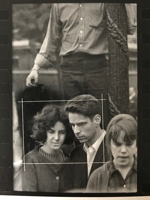

An example: Dave Heath used to fearlessly crop the ever lovin' life out of his 35mm negatives, turning some of them into 110 size, basically. This image is from my copy of Multitude, Solitude, which I highly recommend:
So the question is how do we digitize that little speck of a negative and print it the size that we need? The reason the final print size is so important is that it forces all other downstream imaging decisions, starting with the scanning equipment. And that can be very expensive and/or time consuming. If Heath's image needed to be the size of a postcard I'd do it myself with a Cooolscan, but if it needed to be printed 11X17" then I have no scanner that can do the job and would need to hire someone.

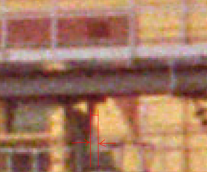

Helge... no ruler is required... the scan is made a 5400dpi (hardware), isn't it ?
Then the edge transition takes al lest 5 or 6 pixels (consider both sides of the edge), belive me: it is not worth the half of the scanned resolution... can you see it ?
Click to enlarge...
This is what I was teached at college (8/64 aprox), if you want I can search references for you, I've seen them sometimes.

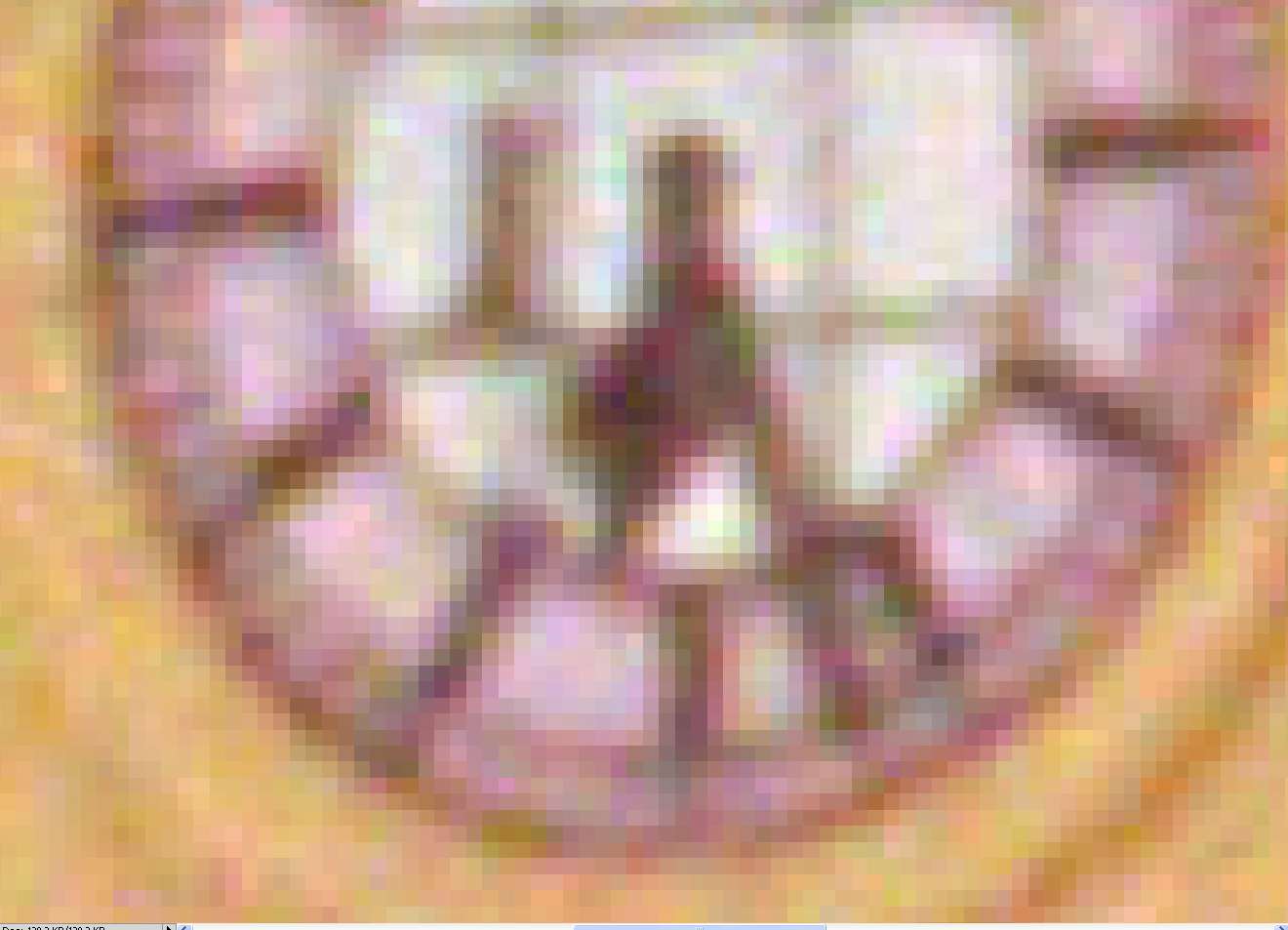

Now you're just cherrypicking. No sensor/camera/lens combination would be expected to completely reliably make two pixel transitions with contrast like that.
Your carefully chosen example, could be due to a number of factors such as colour bleed from the wall behind, heat haze around the ballister due to the column being hot etc.
There are plenty of other examples in the crop, where there are clear lines that are as thin or even thinner than the 200 dot pair indication at the edge of the frame. Others have edges with much sharper transitions than your example. In these it's clearly the scanner that is the limiting factor. Examples are: The double railing at the top, the horizontal lines in the wall, the wires etc.
These lines have much lower contrast than the 120 line pairs per milimeter @ 1000:1 contrast claimed in the data sheet for Reala.
And yet they still show up clearly.
And again you are conveniently eschewing Tim Parkins results, which are even stronger evidence than what is discussed above.
Helge, sorry... but I have not choosen that example, that was choosen by another poster (SCHWARZZEIT ) to say it almost had 5400 dpi effective, which is clearly not true by an x2 factor, at least. https://www.photrio.com/forum/threads/film-vs-scanning-resolution.177544/page-5#post-2314547
With the crop you selected it happens the same.
Don't tell nosense, the crop you personally posted (https://www.photrio.com/forum/threads/film-vs-scanning-resolution.177544/page-4#post-2314208)
...is not worth 1/2 of the scanned resolution, LOL
Click it to see that's not worth the half of the scanned 5400, LOL if you say this is more than 2600

But don't read the bible like the evil. That resolution is at contrast extintion, and with a flat target, real shots usually have less, and some may have to enlarge much less for the quality they want.
I won't more post about that image, it is evident it does not reach the half.

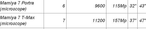

Among other things, a little further down he talks about the real resolution achieved by the digital cameras used in the test.
https://www.sonyalpharumors.com/sony-36-megapixels-vs-6x7-velvia-tim-parkin/

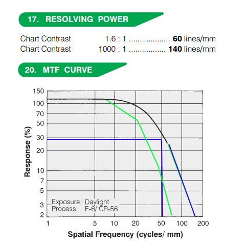

But provia, for example, resolves this:
You can see that even at 1000:1 extreme high contrast by 50cy/mm only 30% of the contrast remains, pictorial situations are usually under 8:1 contrast.
Fuji just don't show the low contrast MTF, saying only that extintion is at 60. This is before degradation from lenses, vibrations, focus miss, DOF vs perfect focus...

MTF diagrams are not for a specific contrast ratio. The MTF shows the relative modulation over a spatial frequency range of any given contrast ratio. The green line in your edited MTF drawing doesn’t make any sense.

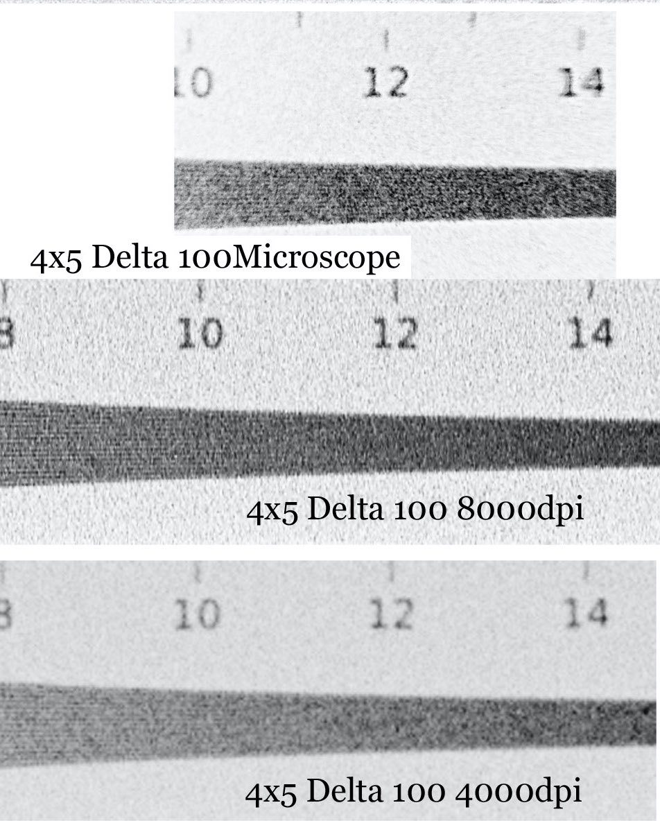

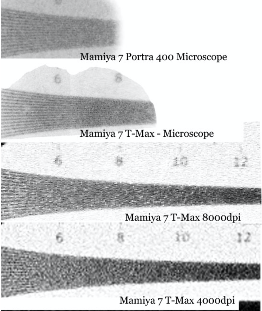

Tim Parkin’s article shows the crops of the converging line target at both 8000 ppi and 4000 ppi scanning resolution as well as a microscope view for 4x5” and 6x7cm formats. It’s quite obvious that the 8000 ppi drum scans barely contain any more detail than the 4000 ppi scans. For information on the effective resolution in each crop Tim provided a reference table. Based on that table the resolution of the Mamiya 7 TMX shot is limited to ~100 lp/mm when evaluated by microscope. Despite the 8000 ppi sampling rate his drum scanner is unable to resolve the limiting resolution of the film because of its low sampling efficiency at this resolution. On the website for his drum scanning service Tim Parkin has additional statements on scanning resolution and the limitations of various scanners: http://www.drumscanning.co.uk/about/resolution/
He mentions that his Screen Cezanne outresolves all drum scanners he has tested for real world film. The Cezanne is limited to 5300 ppi but apparently maintains good sampling efficiency at this resolution.
Really‽
I'd say that is a pretty significant difference.
At these kinds of magnifications those are the general differences and demising returns you'll generally see regardless of format. Again digital will have an artificially "cleaner" scrubbed look. But that is not an advantage in my book.

You can still clearly see which way the scan head ran, aliasing and other artifacting. That is of course a problem, and a problem in general with these types of actually scanning scanners.
Tim has admitted long ago that camera scanning, as you have found out, is most probably better for smaller formats, and only because of potential veiling and lens flare avoided with the lensless aperture of a drum scanner, would that type of scanner still make sense for large format.
For film, MTF graphs are for an specific contrast ratio, this is not the same case than with lenses.
With film, depending on the contrast ratio grains of different sizes take action, so depending on contrast (and base exposure) the MTF graph is totally different.
In the 1000:1 contrast there is a 10 stops difference between lines, so in practice this can be made with a contact copy or perhaps with something like a semiconductor integrated circuit manufacturing lens (projection with reduction). By controlled fogging the film in advance (or after) you adjust contrast of the test and the base exposure of the (projected) black lines.
In that 1000:1 test, if black (projected) lines are in the toe (or not exposed) then white lines will be overexposed around +7, so you are to detect the effect of the ultra small grains having high resolving power over a "fog" from more sensitive crystals... 1000:1 does not describe the film behaviour in pictorial situations as you test crystals that are sensitive at +7 overexposure.
Instead a 1.61:1 tells the truth for common textures, 8:1 for contrasty edges, and 30:1 is good to guess performance for backlighted silhouettes.
If you see the TMX datasheet it says Modulation Transfer extintion at 200 lp/mm for TOC 1000:1 and 65lp/mm for TOC 1.61:1
The posted Provia graph is the one for the unobtanium 1000:1, clearly it has a tendence to extintion at 160lp/mm, well... commercially this MTF graph is nicer than the 1.61:1 would be.
I llustrated in green what it could be the 1.6:1 MTF graph, with extintion at 60lp/mm in that case.

Show us an example of a real world shot you think qualifies as resolving to approximately the fullest potential of 5600 dpi or approximately 42 megapixels for a Barnack frame.
The Serger's Porsche, for example.
The clock faces minute marks clearly have quite low contrast (dirt or colouring?).That’s what makes it so impressive.
It is impressive because it is MF, MF at 2600 effective does that.

One of the best things about camera scanning is that you can get ninety percent of the way there with very modest equipment.
An old DSLR body is more than good enough.
Hm, yes and no :wink:.
Older DSLR: That would mean a 12MP to 24 MP model. In our experience not enough to surpass the scan quality of for example a current Reflecta RPS 10 M / Pacific Image Primefilm XA or a Coolscan 5000.

Depends on the macro level, doesn’t it?
With bellows and flash backlight, I can get to very high magnifications. I need to clamp down the film between glass and use scanning fluid (using a medium format enlarge holder).
But it is possible to exceed 8000 dpi reliably with that setup.

8000ppi with a 24 MP FF DSLR as a scanner? No, definitely not. We've never seen such results. It is physically impossible, as the Nyquist frequency of these sensors is too low.
