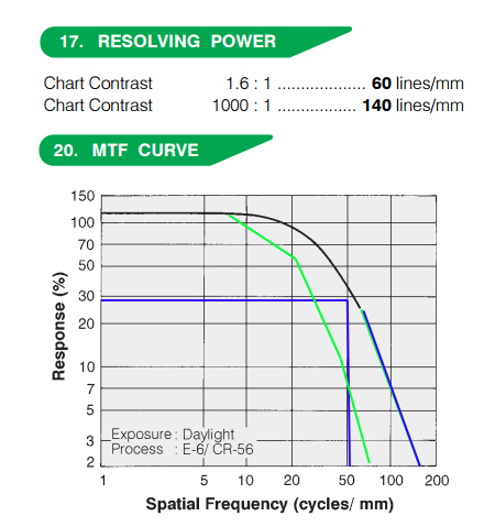

For film, MTF graphs are for an specific contrast ratio, this is not the same case than with lenses.
With film, depending on the contrast ratio grains of different sizes take action, so depending on contrast (and base exposure) the MTF graph is totally different.
In the 1000:1 contrast there is a 10 stops difference between lines, so in practice this can be made with a contact copy or perhaps with something like a semiconductor integrated circuit manufacturing lens (projection with reduction). By controlled fogging the film in advance (or after) you adjust contrast of the test and the base exposure of the (projected) black lines.
In that 1000:1 test, if black (projected) lines are in the toe (or not exposed) then white lines will be overexposed around +7, so you are to detect the effect of the ultra small grains having high resolving power over a "fog" from more sensitive crystals... 1000:1 does not describe the film behaviour in pictorial situations as you test crystals that are sensitive at +7 overexposure.
Instead a 1.61:1 tells the truth for common textures, 8:1 for contrasty edges, and 30:1 is good to guess performance for backlighted silhouettes.
If you see the TMX datasheet it says Modulation Transfer extintion at 200 lp/mm for TOC 1000:1 and 65lp/mm for TOC 1.61:1
The posted Provia graph is the one for the unobtanium 1000:1, clearly it has a tendence to extintion at 160lp/mm, well... commercially this MTF graph is nicer than the 1.61:1 would be.
I llustrated in green what it could be the 1.6:1 MTF graph, with extintion at 60lp/mm in that case.

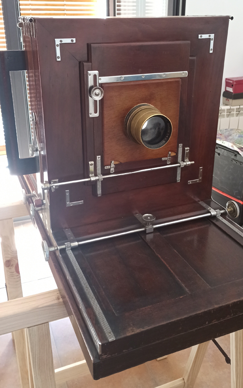

Format rules... If you want I show you how my 8x10" shots resolve, made with a W 360.
https://www.flickr.com/photos/125592977@N05/32535835184/

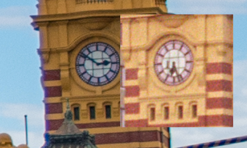

The photo with the clock tower of Flinders Street Station in Melbourne was taken on standard 135 film in a Minolta HiMatic 7sII, so not medium format.
It so happens that with a quick search on Flickr, that there is a photo of the same tower with almost the same magnification ratio, only taken on a 24 MP camera.
So three times your claimed resolution of 2600 dpi/9 MP on a 36x24mm frame.
This is a dubious comparison, since the circumstances and taking conditions are completely different.
Different angle, much more contrasty lighting in the digital photo and different aerial perspective due to the different season.
So, this is a very rough and unsteady comparison, but I still persist because:
From your claimed 9 MP to 24 MP up to the 42 MP of 5600 dpi, there is quite a jump. And that jump is not in any way visible here.

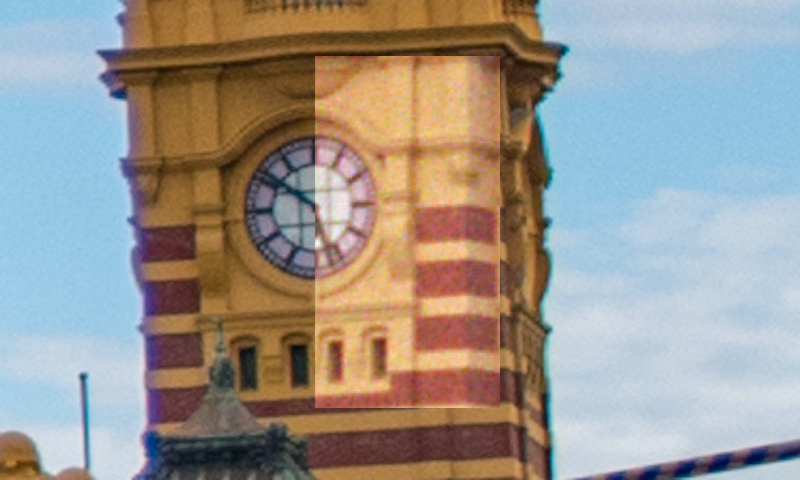

It's interesting to note that while the demosaicing and edge enhancement algorithms have attempted to raise contrast and detect edges in the clock face, it has often completely misunderstood the geometry and made the image lumpier and harsher. The arc over the clock is especially glaring with huge bayer artefacts.
Also note the I have opted to be conservative and give the benefit of doubt to the digital image. The scaling and angle of the shot makes if anything the tower face take up more space in the frame on the digital shot.
And might I recap:
- Reala is not an especially high resolving film.
- The Minolta lens while very good is designed in the mid seventies for a point and shoot, so for example coatings are simpler.
- Minolta Dimage Scan Elite 5400 II used to scan, is a 2005 scanner, with an effective resolution of around 4200 dpi.
So the result is actually subtly amazing really, when you look through devils advocate eyes.

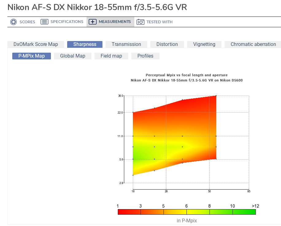

Beyond the DXO test I personally tested my 18-55 and it resolves around those 8 MPix in the sweet point.
Still 8MPix effective is quite nice.

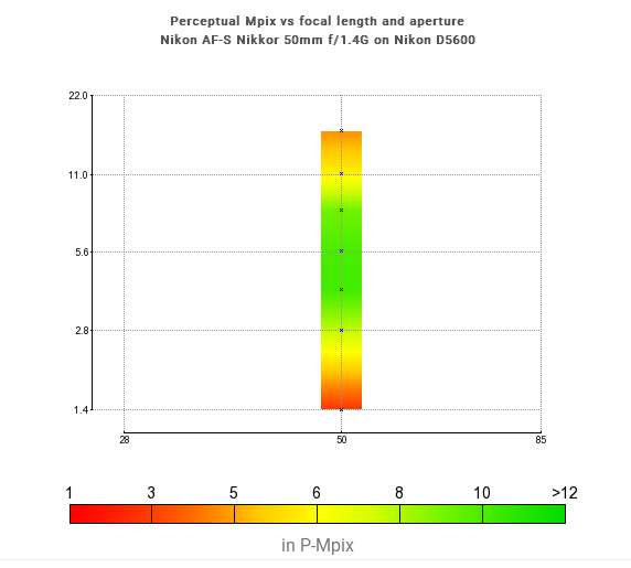

See here the P_MPix and the field map...
https://www.dxomark.com/Lenses/Nikk...R-mounted-on-Nikon-D5600---Measurements__1139
I'd say it pretty clearly resolves to the maximum ability of the sensor.

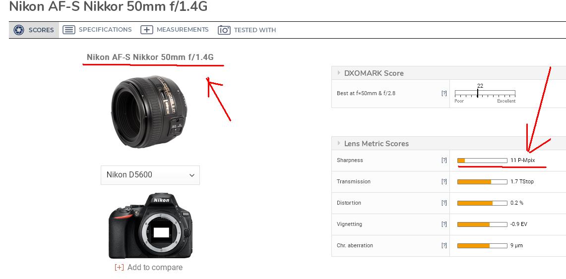

Not by far !!! You have to use a prime (like the 50mm 1.4G ) to reach 11MPix with a D5000 series camera:
This is quite well known...
Still many 18-55 shots are quite good because of the excellent VR, which the 50G lacks.
with the 50 you have to stop f/4 or 5.6 to get optical performance,
then you have same shutter setting than with the 18-55 and in that situation the VR may make a difference.
The 18-55 is excellent and 8MPix effective are a lot for most things (like a 4K TV), but it is 8 MPix. I use a lot that lens.

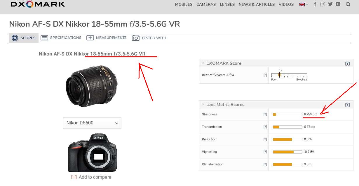

Looks like you discovered that lens and sensor forms a system and has to be judged as such.
My 24 MP Nikon with a lens that gets a combined score of 11 MP gives far higher resolution images than my iPhone 11s 12MP.
Guess what, the same goes for film cameras.
So my comparison is sound in that regard.
Prime lenses doesn’t score too high in DXO Mark either it seems. 14MP for the Nikkor AF 35mm 1.4...

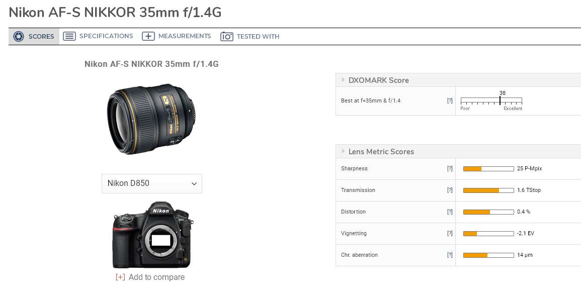

Prime lenses doesn’t score to high in DXO Mark either it seems. 14MP for the Nikkor AF 35mm 1.4...
14MPix is with an APSC small sensor camera, with a Full Format D850 the 35mm f/1.4G is rated 25MPix, both are totally fair values for the situation IMO. Think that the 35 is a FF lens, optimized for a format that has x2 the area.
Those rated 8 MPix effective of the 18-55VR in the D5500 are totally fair, but to get that you have to shot f/5.6 or f/8 and under 28mm to get that, see the performance map:

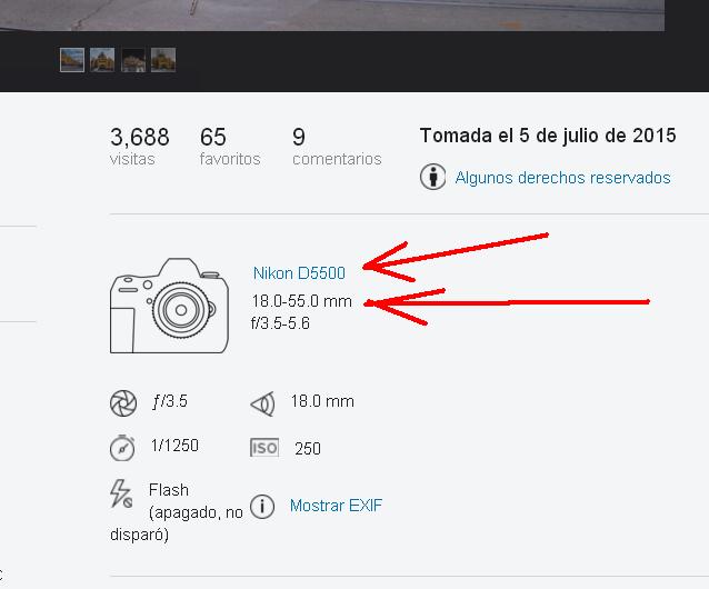

The EXIF of the Melbourne shot says 18mm focal and wide open f/3.5, the focal in good for performance but the apperture is not totally optimal, still not bad. That shot should be slightly under 8MPix effective, but not beyond 8...
This enforces that 2600dpi effective rating,isn't it?

But the truth is that
1)
TMX is multi-layer, T on cubic
2) that Provia destroys 70% of the contrast at only 50cy/mm even at TOC 1000:1, we don't know at 8:1 but it's it's easy to imagine the range in what the real number is.
3) For each TOC contrast we have different MTF curve
4) And that real practical results are like these most of the times:
https://www.photrio.com/forum/threads/film-vs-scanning-resolution.177544/#post-2313390
So he discredits himself. Sorry for that off topic. I'll try to speak, no more about him, better if his discredits himself.

7, 8 and 9 is the mostly the same, but from 24 effective to 8 effective there is a noticeable difference.
Helge posted the comparison of a 35mm film shot with DSLR shot. I provided some evidence that the DSLR shot is gear limited to around 8Mpix effective and not 24.

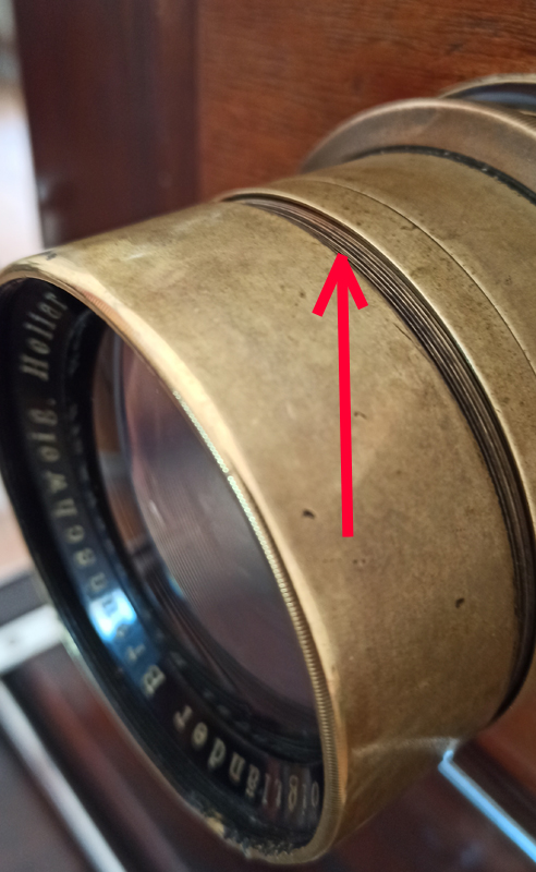

Hi guys,
Let's relax a bit and see what I'm testing right now:
I'm messing with an ancient Heliar 30cm that came with the Globus K a week ago.
I'm trying a DIY conversion to emulate the Universal Heliar, the Universal displaces the inner element to provocate diffusion for portraiture. I try to learn what happens is shut shimming the front group...
Nicer than scanners !!!!!!
