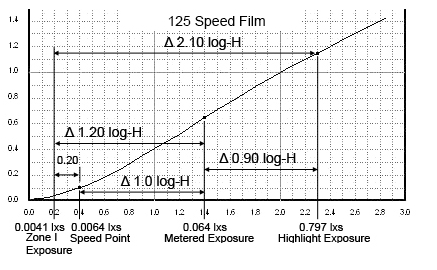

log-H at Hg is 8/EI. You should use 8 * Shutter speed. 8 * 1/125 = 0.0640 lxs. 0.064 * 25 or 0.0640* 0.32 = 2.048 lxs. If my math is correct.
Shutter speeds are actually rounded so to be as precise as possible; you need to look up the actual value. Now you have an approximate value for your incident Illuminance to plug into the equations.
To hit 0.10 at the point of density you state, the incident Illuminance needs to be for each EI:
100 = 4.2 lxs
125 = 3.36 lxs
400 = 1.05 lxs

I used 1/4 sec in the test exposure.
8 * 1/4 = 2 lxs
Is there a typo in the examples: you show 0.064 lxs being multiplied by 2^5 (or 32) = 2.048 lxs......................then 0.064 lxs is shown being multiplied by 0.32, but that = .02048 lxs...............have I misunderstood it?

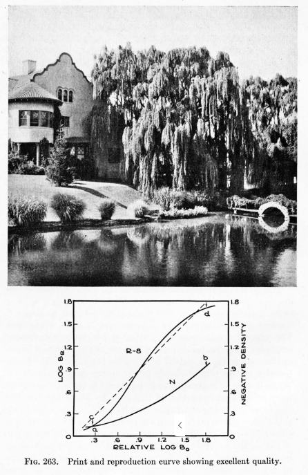

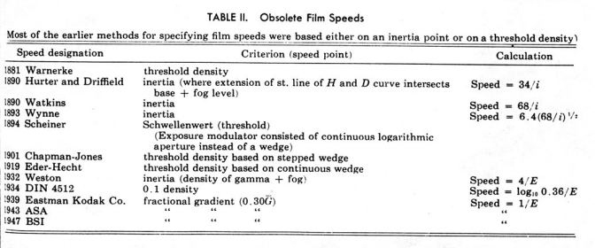

Fortunately, a nice summary is available in all the editions of Theory of the Photographic Process. From the 3th edition, page 440, "A statistical method was used by Jones to determine the relationship between the exposure of the negative and the quality of the resultant prints. A series of twelve negatives in which the camera exposure was increased progressively from a very low to a very high value was made on each material to be studied. To secure the best possible print from each negative thus obtained, skilled operators were asked to print each negative on several grades of paper, use several printing exposures, quality of the resultant prints. A series of twelve negatives in which the camera exposure was increased progressively from a very low to a very high value was made on each material to be studied. To secure the best possible print from each negative thus obtained, skilled operators were asked to print each negative on several grades of paper, use several printing exposures, and then select from this group of prints the best one that each negative was capable of giving. These series of prints were then arranged in order and were judged by two hundred observers, each observer being requested to pick the first print in each series which he considered “excellent”. This is, of course, a very laborious method of working, but it allowed a statistical selection of the negative which the average observer would consider “satisfactory.” It was also possible to select a print inferior to the “first-excellent” print."
View attachment 383509 View attachment 383510 View attachment 383511
That’s the Hayes’ residence on Willow Pond - It’s right outside my office window.

Looks like a typo. There's probably more.
My values start with the meter reading, and then the value when opening up 5 stops. Actually, yours probably includes the 2^5 stop addition since it's your camera exposure setting when shooting. So, 2 * 0.0019 = 0.0038 lxs. 0.8/0.0038 = 210.
Based on the exposure, did you meter for a 125 speed film? Can you post your curve?

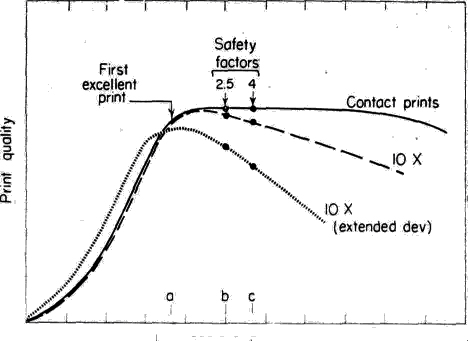

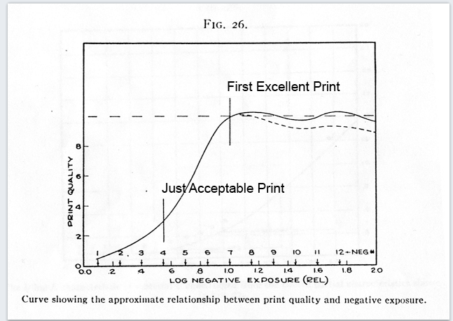

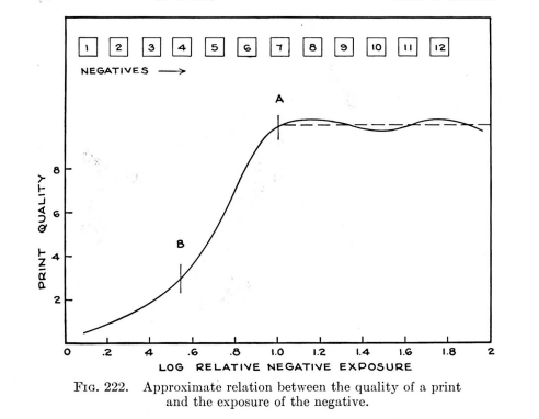

Below is a chart of the results from the first excellent print test. The judges found a little additional exposure, from what was determined to be the first excellent print, had a corresponding increase in print quality. Beyond that point people couldn't decisively agree on the order of the prints. Remember the name of the test was first excellent print, not the very best print. The idea is to find the point that is easily identifiable and indicates a limiting factor.
And another print quality chart. Quality increases after the First Excellent Print exposure eventually falling off at a rate relative to the enlargement.
I believe I've said to use what ever exposure works best for the individual, so I have no idea who you are patronizingly attempting to explain exposure to.
You made a statement speculating about the reason for the change in the 1960 speed standard. Like Woody Allen in Annie Hall, I brought Marshall McLuhan out from behind a display in a movie theater lobby to settle a disagreement about his book. I quoted C.N. Nelson, who explained the reasoning behind the change in the 1960 standard. A quote from Nelson's own paper on his research and conclusions leading to the change in the 1960 standard. Which you rejected outright as if you knew more about Marshall McLuhan's book than Marshall McLuhan.
One again you are confusing exposure and film speed. And just because I am discussing one, doesn't mean I don't understand the other.
I've never said you have to exposure at any speed point. As to exposure, I believe I said what ever works best for the individual, so I have no idea who you are patronizingly attempting to explain exposure to.

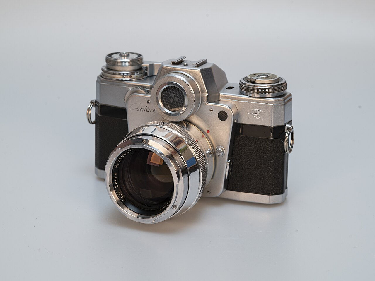

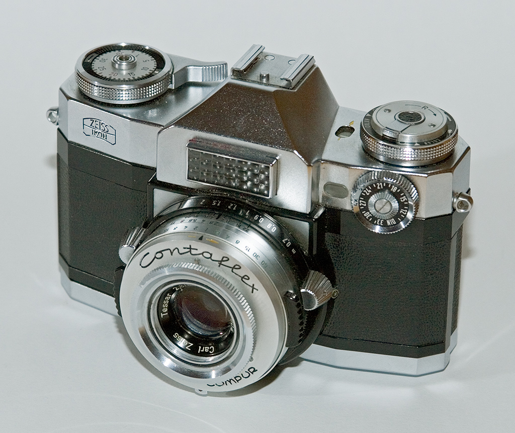

This is the kind of camera that well-heeled photographers used in the 1950s:
It had a leaf shutter. With the faster films that became available later in the 1950s, smaller apertures were needed. At these smaller apertures, proportionally more exposure would be given than at large apertures.
This is a focal-plane shutter camera from the late 1950s. Exposures made a small apertures did not present a problem, because the shutter was a focal-plane type.
Do you understand now?

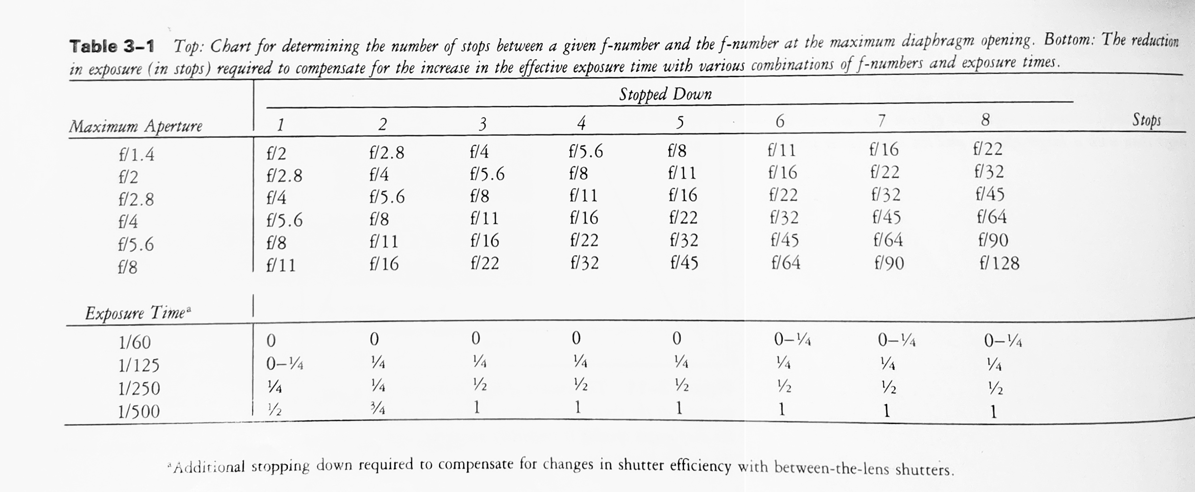

Right, shutter efficiency. It is something to consider for the individual while shooting depending on the type of shutter being used. I remember reading something long ago how mechanical variables tend to moderate each others influence on exposure. Is shutter efficiency a potential reason to add a safety factor to your EI that is based on the ISO? Perhaps, or you could use a chart like below. Still that has to do with exposure and not film speed.
The raising of the speed number was intended to reduce exposure. Otherwise, why do it? Cameras like the Contaflex were subject to that issue. Contarexes amd Nikons and Leicas and Pentaxes were not. When using cameras with focal-plane shutters, use 2/3 stop more exposure.
There is no reason to change the standard for measurement. Just change the number! Go back to the ratings numbers used before!

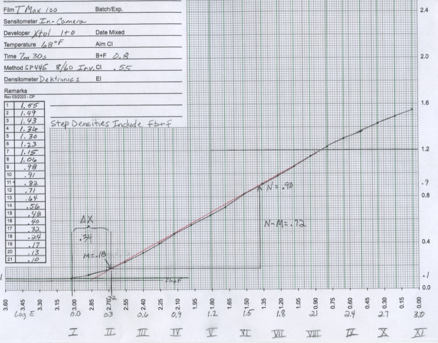

The TMax 100 curve . I used @Bill Burk 's Speed Meter overlay to ascertain the Delta-X space on the curve, but I have to admit I don't really understand the concept, that's putting it lightly, lol.

The TMax 100 curve . I used Bill Burk 's Speed Meter overlay to ascertain the Delta-X value on the curve, although I don't really understand how to utilize it.......................but that's for another thread.
