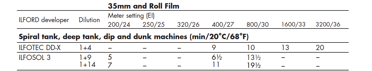

The passage quoted by the person a few posts up has to do with the suggested processing times when an exposure index other than the ISO speed is used (for example, rating Delta 100 at EI 50 or HP5+ at EI 800, etc.)

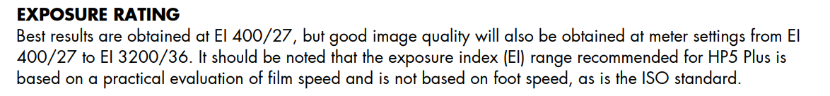

The Ilford film data sheets state: “It should be noted that the recommended exposure index(EI) is based on a practical evaluation of film speed and is not based on foot speed, as is the ISO standard.”

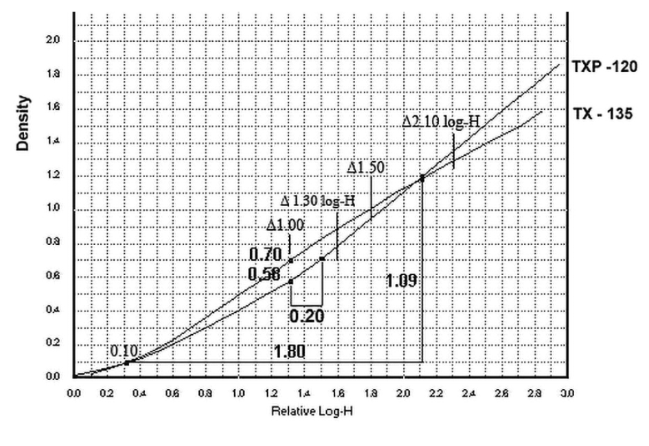

The density curve used in ISO (see #29 above) has nothing in common with a typical curve of modern b&w films. This ISO standard is completely outdated and is obviously ignored by today's suppliers.

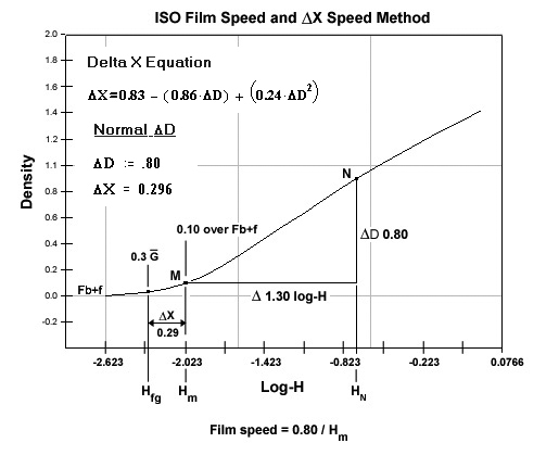

Here is the ISO contrast parameter along with the equation.
Instead of having to apply the equation, by adhering to the development conditions, the fractional gradient speed point will always fall at the same Δ log-H from the 0.10 fixed density point. The value of ΔX remains constant. The fixed density of 0.10 is where the film speed is determined. Nothing more.
If you are concerned the contrast is excessive with the ISO parameters and the speeds derived at the higher gradient won't represent the normal pictorial gradient, one: don't be, and two: adjust your shooting gradient. 0.62 is approximately 1/3 of a stop greater than the processing for statically average conditions. Small variations in a scene's luminance range, variations in flare, and LER variations in different grade 2 papers can easily make the difference. Let's not forget the difference between the negative density range for a diffusion enlarger and condenser enlarger. Also there is an "inverse" relation between ΔX and average gradient (or ΔD). As the film gradient is increased, the value of ΔX decrease which limits the change of film speed compared to just using a fixed density method. Which brings us to the next point. Any speed determination for development conditions other than the ISO parameters requires the use of the Delta-X equation. Otherwise, "The fixed-density criterion tends to underrate films that are developed to a lower average gradient and to overrate films that are developed to a higher average gradient." How many people do this? How many people notice the difference? A third of a stop is not much to complain about.

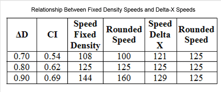

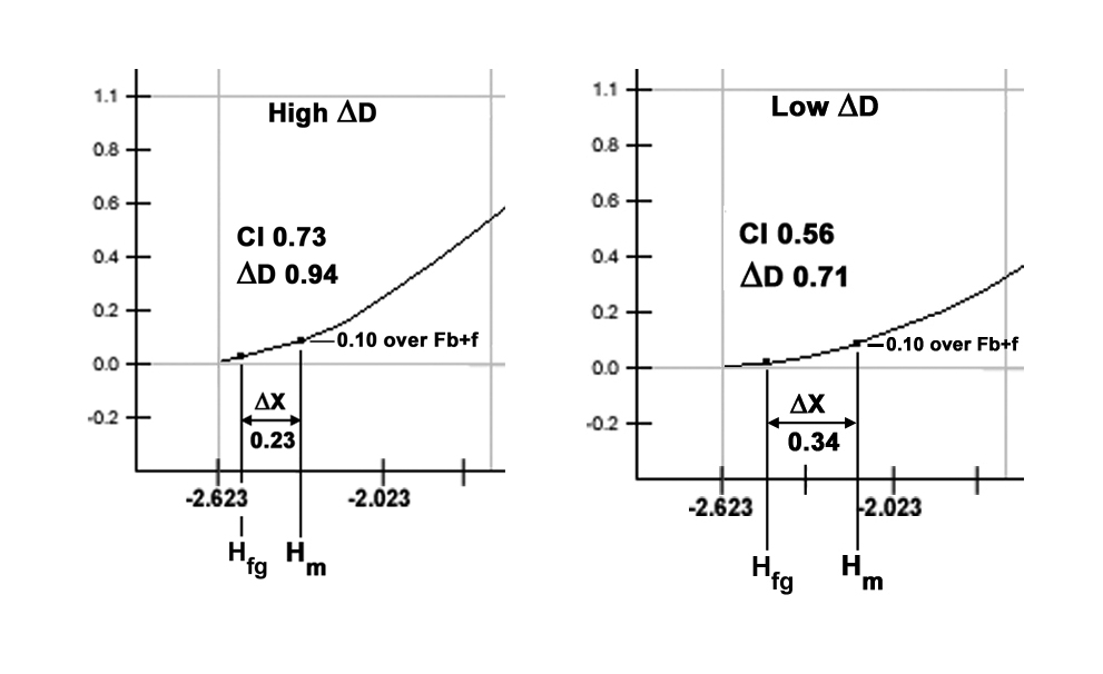

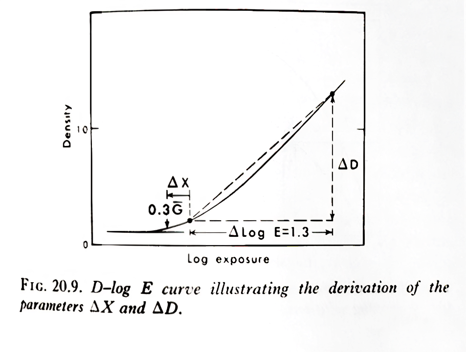

I just want to first make a few factional corrections before moving forward.
On page 443 of Theory of the Photographic Process, 3rd edition.
The Delta-X Criterion is discussed for 1 1/2 pages. Towards the bottom of page 443.
“In view of the data presented by Nelson and Simonds, it is clear that the poor correlation which Jones and Nelson found between speed numbers obtained from the D=0.10 criterion and speeds obtained from a statistical determination of the “first-excellent” print can be attributed to the use in their investigation of negatives that had been developed to widely different average gradients.”
And on page 444, “It is now feasible to restrict the use of the speed criterion to those cases in which the negative material is developed to a fixed average gradient corresponding to that realized in commercial practice. With this restriction incorporated in the development specifications, it follows from the studies of Nelson and Simonds (Simple Methods for Approximating the Fractional Gradient Speeds) that the fixed-density (D=0.10) speed criterion is a valid correlate of the fractional-gradient criterion.
In 1957, the responsible committees of the American Standards Association undertook the drafting of a revised American Standard Method for Determining Speed of Photographic Negative Materials (Monochrome, Continuous Tone). One of the primary objective in writing the standard was to specify a method of testing which would permit the use of a fixed-density speed criterion. The view was held that by abandoning the fractional-gradient criterion, which had been specified in previous American Standards, and adopting a fixed-density criterion, a serious obstacle in the way of international agreement on the method for determining speed would be removed. Because, in addition, the use of a 0.10 fixed-density criterion in combination with a suitable development specification offers the convenience and precision characteristic of this criterion and retain the practical significance of the fractional-gradient criterion, this method was adopted in the new American Standard."
I’ve found papers explaining the theory behind a new photographic standard were common, like Safety Factors in Camera Exposure. Some of the papers could be about proposing a change to a standard, but as Safety Factors was published in 1960, the same year as the new speed standard, and the above quote has the committee working on the new standard in 1957, it appears it was at least being written concurrently with the standard. So, for a better understanding of the choices in the ISO speed standard, two of the papers one should read are Safety Factors and Simple Methods of Approximating the Fractional Gradient Speed.

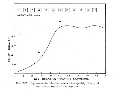

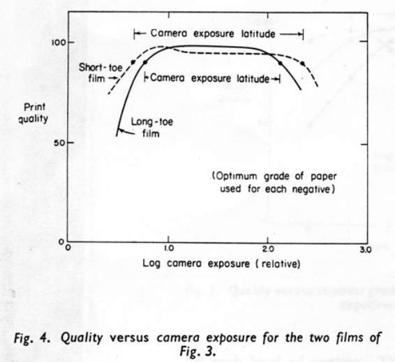

A good paper that addresses print quality from different film types is Simonds, J.L., Factors Affecting the Quality of Black-and-white Reflection Prints, The Journal of Photographic Science, Vol, 11, 1963.
As for density being a deciding factor in exposure placement, there's a favorite quote by Lyod Jones, "From the standpoint of tone reproduction theory, there seems to be no justification for the adoption of any value of density as a significant criterion of the speed of a photographic negative material. The primary function of the negative material is to record brightness differences existing in the scene. Density, per se, has no significance as an indication of the ability of the photographic material to perform this function. The value of negative density by which any particular object brightness is rendered, as, for instance, the deepest shadow, is of no consequence except insofar as it may have some bearing on the exposure time required to make a print from the negative."

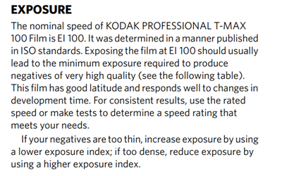

This is from the exposure section in Kodak's technical data sheet for TMX.
As Kodak's statement suggests, the ISO standard is a guide. ISO 6 is not intended to be universally applicable. It is designed to accurately work under certain conditions. The further from those conditions, the less accurate the results. There are a number of caveats involved including both physical and psychophysical. In the forward to ISO 6, "the ISO speeds will provide correct exposures for average scenes with the exposure meters conforming to ISO 2720 or ISO 2721 when the film is processed as specified in this international standard." As a scene moves further from the average scene or if the film is processed differently, the agreement is reduced.

I may have missed the meaning of your question before. I read it as using the just black method as a determinant of proper camera exposure and speed rating. If you are asking about the printing methodology of the psychophysical testing done in the first excellent print tests, it is explained in great detail in Jones' paper The Evaluation of Negative Film Speeds in Terms of Print Quality, Journal of The Franklin Institute, 1939.
Fortunately, a nice summary is available in all the editions of Theory of the Photographic Process. From the 3th edition, page 440, "A statistical method was used by Jones to determine the relationship between the exposure of the negative and the quality of the resultant prints. A series of twelve negatives in which the camera exposure was increased progressively from a very low to a very high value was made on each material to be studied. To secure the best possible print from each negative thus obtained, skilled operators were asked to print each negative on several grades of paper, use several printing exposures, quality of the resultant prints. A series of twelve negatives in which the camera exposure was increased progressively from a very low to a very high value was made on each material to be studied. To secure the best possible print from each negative thus obtained, skilled operators were asked to print each negative on several grades of paper, use several printing exposures, and then select from this group of prints the best one that each negative was capable of giving. These series of prints were then arranged in order and were judged by two hundred observers, each observer being requested to pick the first print in each series which he considered “excellent”. This is, of course, a very laborious method of working, but it allowed a statistical selection of the negative which the average observer would consider “satisfactory.” It was also possible to select a print inferior to the “first-excellent” print."
This is the only part of the post I can agree with. You find what works for you and has the results you like. Here's the thing. It doesn't go against the ISO speed standard. There's no contradiction if a person is willing to understand the theory. Sure the standards need to be tweaked from time to time, but for the most part, any blame directed toward the speed standard is generally misplaced. You don't need to understand theory to photograph, as the next section from a Kodak data sheet demonstrates, but theory helps it all make sense so we can stop misplacing blame.
Jones says in The Psychophysical Evaluation of the Quality of Photographic Reproductions, PSA Journal, Vol 17, Dec 1951. "In this discussion, the term photographic quality will be used in referring to the degree of perfection with which the photographic picture reproduces in the mind of the observer the subjective impression which he received when looking at the original." What if the intention wasn't a realistic reproduction of how something looks but an interpretation that departs from a realistic impression of the subject or for lack of a better term, an artistic interpretation? A situation where the emotional element supersedes a strictly technically reproduction. How would this affect Jones' print judgement speeds and consequently sensitometric speeds? Or looking at it from a different perspective, how would film speeds based on Jones' print judgement speeds be applicable to the artistic work of photographers like Bill Brant, Brett Weston, or Michael Kenna?
The fractional gradient speed point has excellent correlation with psychophysical testing and is used to accurately compare the limiting gradient across films of various characteristics. It means the same for all film types. This is the basis for black and white film speeds. The old ASA standard had an ASA speed and an ASA film exposure index. The ASA standard was the fractional gradient speed while the exposure index takes into consideration the meter's characteristics, a scene's luminance range and distribution, flare, and other factors including any safety factors. In other words the factional gradient speed is the film speed and the EI is how the film is to be applied. While the current ISO speed standard doesn't make a distinction between the two, the ISO speed is still determined in relation to the fractional gradient speed and can be considered an EI. A user’s choice of EI can then be further based on an individual's situation which may include many additional variables including taste, but the actual speed of the film is defined. It's common for people to conflate speed with exposure.
Apart from all that, what makes more sense, people who use EIs other than the ISO value have a better understanding or more ridged testing procedures than the people that researched and developed the methodology or that they have found a value which works for them?
The speed of T-Max films is now listed as ISO, not EI. In any case, a little more exposure than the absolute minimum is not in any way deleterious. It's best to err on the side of generous exposure, especially in rapidly changing situations.
The except from the Kodak technical data sheet is from around 2017. It isn't implying the film doesn't have an ISO. The only time T-Max films didn't have an ISO was prior to the 1993 standard. Kodak's use of EI is referring to how you set the camera's exposure meter. The film has an ISO of 400. You set the your camera / meter to EI 400.
Again, let's remember there is a distinction between film speed and exposure.
