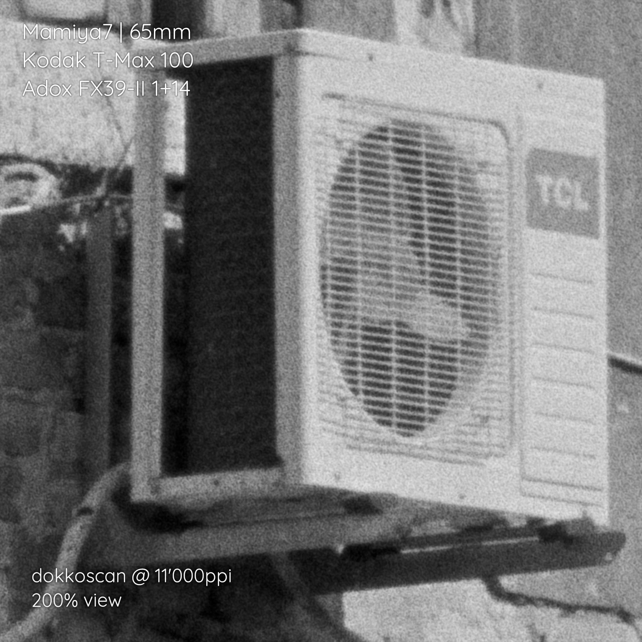

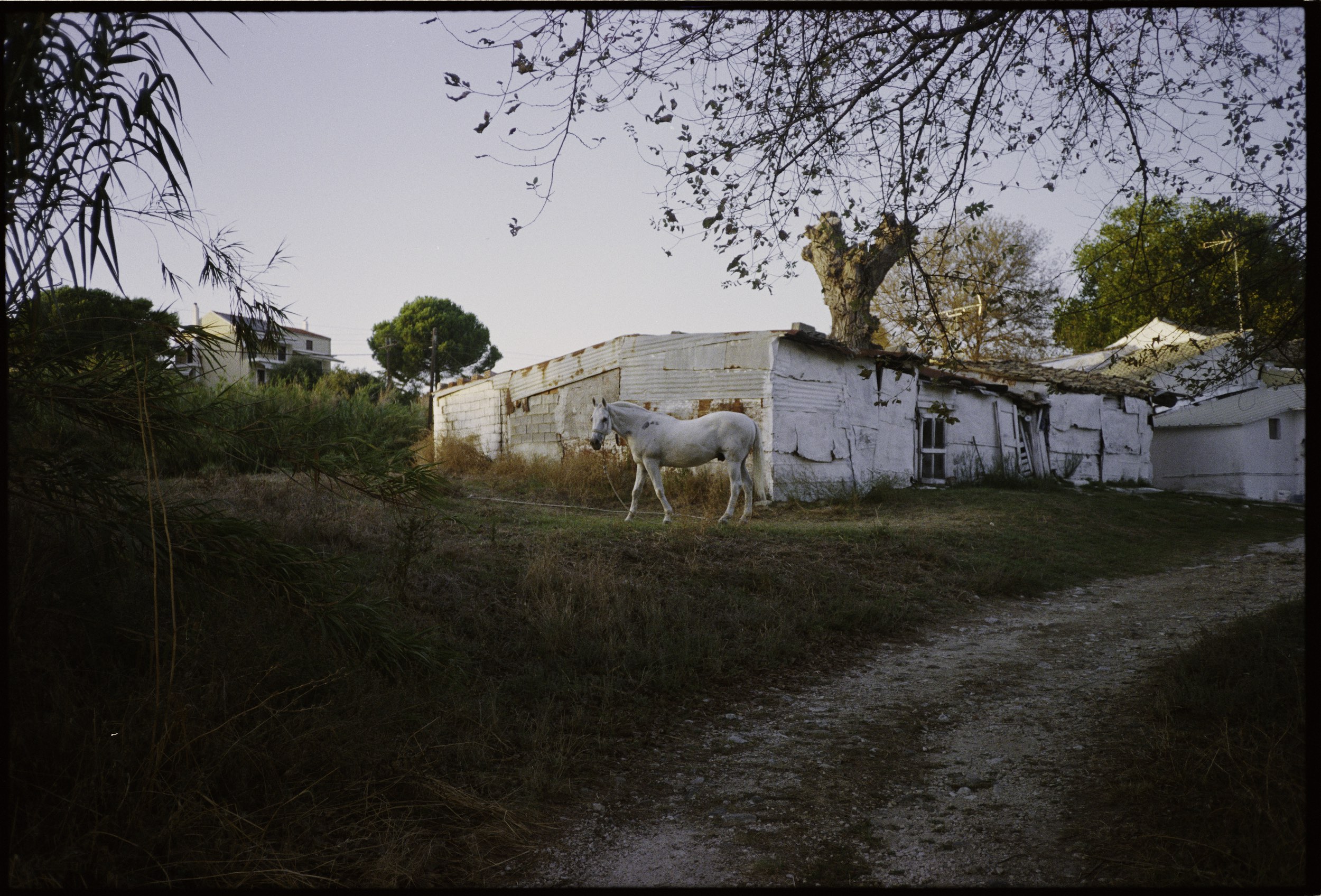

Just wondering which developer was used? This says XT-3 and the ones below say FX-39II. Are they two separate pictures?
good catch, I got confused here. the building in corfu is 99% certain FX-39II since I scanned that right after developing and put the labels on top of the image, so the XT-3 mention is wrong (can't seem to edit it anymore in the post above).
Here's a lens test with TMX (and Delta100) in XT-3 vs other developers though.. overview of the 6x6 image, with the rectangle marking the crop:
and the crop at 11'000ppi as a gif animation:

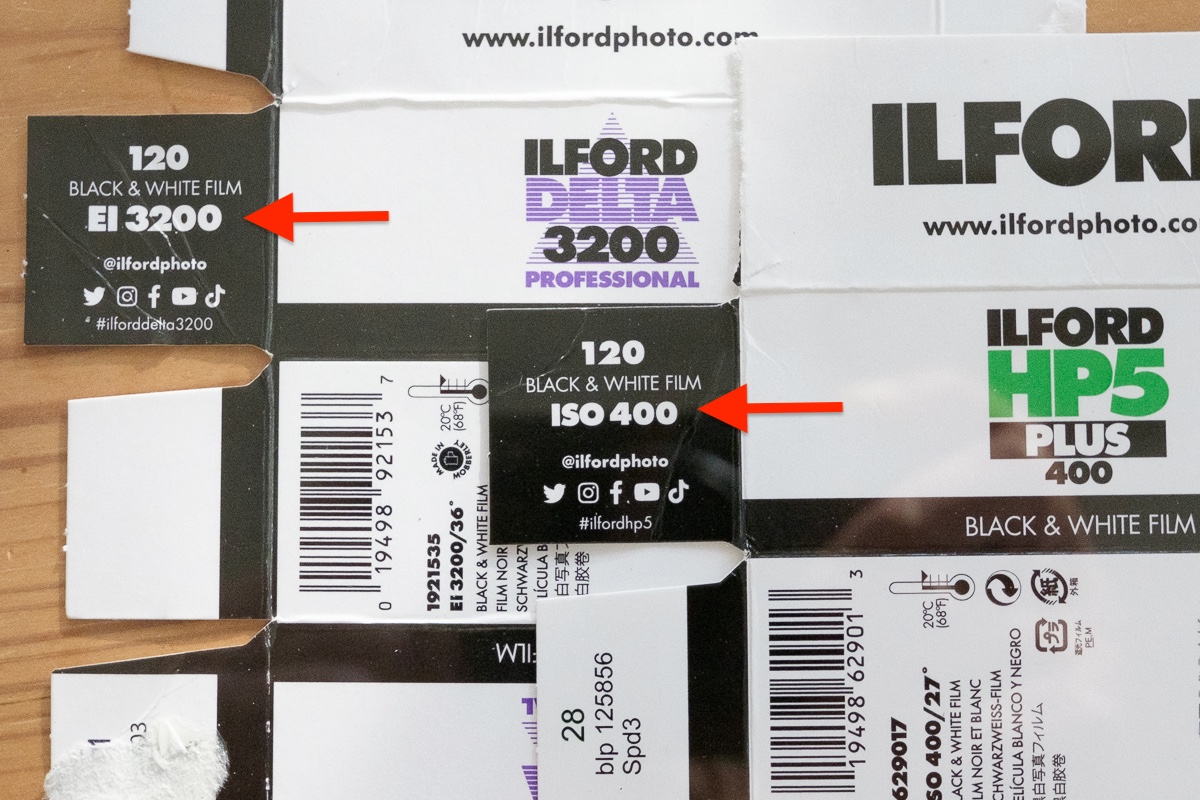

@honerich: "The Ilford film data sheets state: “It should be noted that the recommended exposure index(EI) is based on a practical evaluation of film speed and is not based on foot speed, as is the ISO standard.
Ilford uses that statement ONLY for their Delta 3200. The data sheets for all their other films state the films ISO rating, similar to this:
"FP4 Plus has a speed rating of ISO 125/22º to daylight. The ISO speed rating was measured using ILFORD ID-11 developer at 20ºC/68ºF with intermittent agitation in a spiral tank. ..." The Delta 3200 data sheet states, "...the ISO rating DELTA 3200 Professional has an ISO speed rating of 1000/31°..."
The Ilford data sheets do go on to discuss EI recommendations, but except for Delta 3200, the numbers on the film box are derived from ISO testing. Notice the packaging shows "EI" for the 3200 and "ISO" for the HP5+...
If it says "ISO" on the box, then I believe the film has been tested according to the ISO standard. How the user applies that number when exposing the film is a different matter, as this thread demonstrates.
