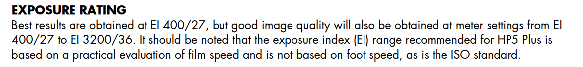

The except from the Kodak technical data sheet is from around 2017. It isn't implying the film doesn't have an ISO. The only time T-Max films didn't have an ISO was prior to the 1993 standard. Kodak's use of EI is referring to how you set the camera's exposure meter. The film has an ISO of 400. You set the your camera / meter to EI 400.
Again, let's remember there is a distinction between film speed and exposure. If the second part of your statement is directed toward me, you aren't reading my posts very closely.
The current packaging says ISO 400. Anyway, if you set your meter at 2/3 ISO you will probably get a higher percentage of good printable negatives than if you use the ISO setting. I rarely meter anyway. Most of the time the exposure is based on the light conditions, so long as the light is not frequently changing. I shoot at about 1/500 @ f/8 in the sun, and about 1/250 @ f/5.6 in open shade, with ISO 400 films. I do mostly "candid" photography, quick captures of events, not tripod photos of rocks and trees. Metering off grass is a good practice.

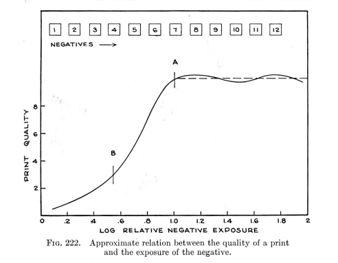

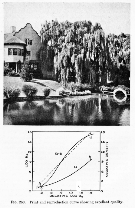

Fortunately, a nice summary is available in all the editions of Theory of the Photographic Process. From the 3th edition, page 440, "A statistical method was used by Jones to determine the relationship between the exposure of the negative and the quality of the resultant prints. A series of twelve negatives in which the camera exposure was increased progressively from a very low to a very high value was made on each material to be studied. To secure the best possible print from each negative thus obtained, skilled operators were asked to print each negative on several grades of paper, use several printing exposures, quality of the resultant prints. A series of twelve negatives in which the camera exposure was increased progressively from a very low to a very high value was made on each material to be studied. To secure the best possible print from each negative thus obtained, skilled operators were asked to print each negative on several grades of paper, use several printing exposures, and then select from this group of prints the best one that each negative was capable of giving. These series of prints were then arranged in order and were judged by two hundred observers, each observer being requested to pick the first print in each series which he considered “excellent”. This is, of course, a very laborious method of working, but it allowed a statistical selection of the negative which the average observer would consider “satisfactory.” It was also possible to select a print inferior to the “first-excellent” print."
View attachment 383509 View attachment 383510 View attachment 383511

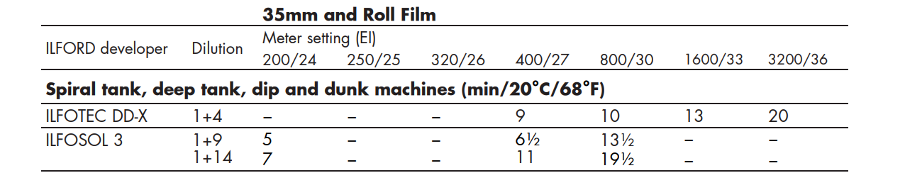

The simplest way to "test" (assuming the use of a 35mm camera with focal-plane shutter) is to put the camera on a tripod and take a 36 exp roll, using an aperture of f/8 or so on a first-class 50mm lens, running a sequence from 1/30 to 1/2000 second (or 1/1000 if that's your top speed), over and over till the roll is complete. This is best done on a sunny day with no clouds. Be sure that there are areas of shadow and white (typical white houses make a good test subject).
Then, in the darkroom, snip the roll into thirds, then process each strip separately, one at normal, one at 15% less, and the last at 25% less time. Keep records of the exposures! Then make enlargements of the negatives on your usual paper (grade 2.5 or 3 is what I use with Ilford's latest Multigrade). Compare the results with the value your meter gave you. Don't be surprised if your best print comes from the negative given a stop more exposure and 25% less development. I have tested dozens of times, with many films, and the results are always less than ISO speeds. My cameras are Leicaflex SL2s, maintained well.

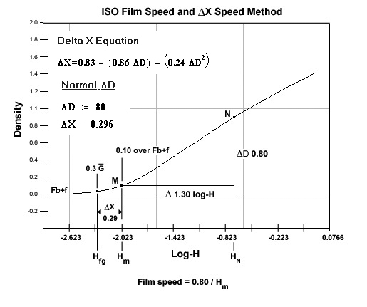

As far as I know, this is a standard statement used in all Ilford's black and white film technical data sheets. It is referring to how the development tables were derived as opposed to the ISO speed.

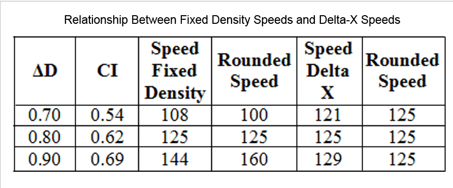

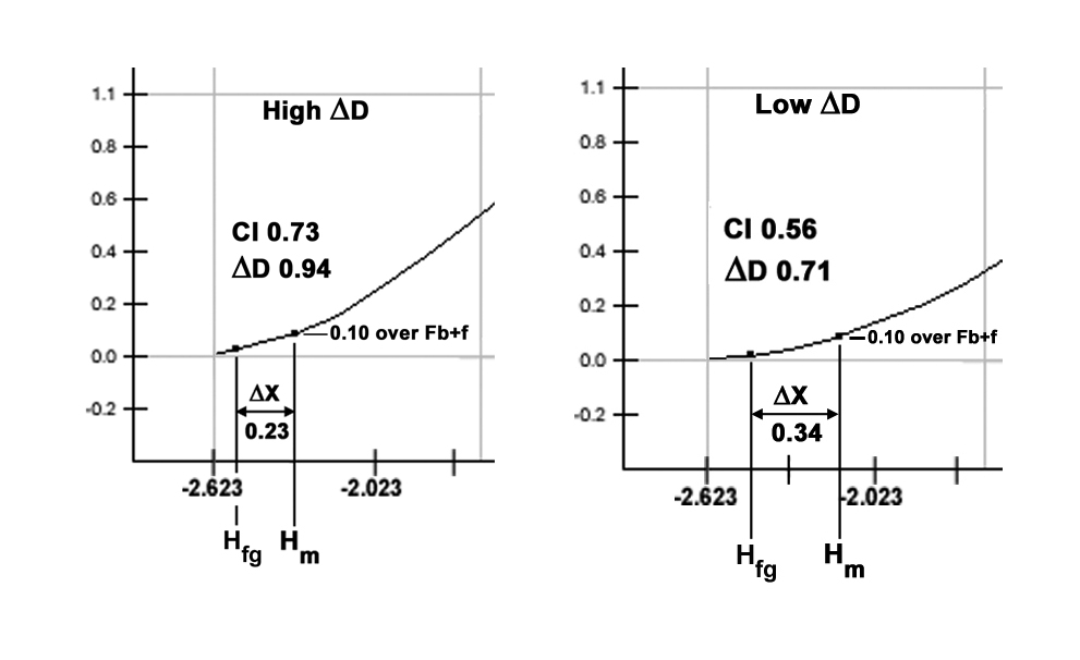

Contrast index is just one type of average gradient method, but I'm assuming you mean the ISO contrast parameter no longer applies to the development of modern film. The contrast parameter in ISO 6 doesn't indicate how to develop pictorial film (although the contrast is not unrealistic). That's not the purpose of the speed standard. One of the problems with the standards is that they don't generally contain the theory and reasoning behind them. They just explain how to do something. With ISO 6, the contrast parameters is actually part of an equation. According to C.N. Nelson in Safety Factors in Camera Exposures, "Thus when development is controlled so that ΔD remains constant, a good correlation exists between speeds based on a density of 0.1 above fog and fractional-gradient speeds."
"A new formula for speed can be derived which will make use of the 0.1 fixed-density speed criterion. If a specification is adopted requiring development to a ΔD of 0.80 or an average gradient of 0.62, for example, the log E difference (ΔX) between the two types of speed becomes 0.29, and the exposure, Ed, at a density of 0.1 above fog becomes 1.9 times greater than the exposure, Es, at the fractional-gradient speed point."
Here is the ISO contrast parameter along with the equation.
Instead of having to apply the equation, by adhering to the development conditions, the fractional gradient speed point will always fall at the same Δ log-H from the 0.10 fixed density point. The value of ΔX remains constant. The fixed density of 0.10 is where the film speed is determined. Nothing more.
If you are concerned the contrast is excessive with the ISO parameters and the speeds derived at the higher gradient won't represent the normal pictorial gradient, one: don't be, and two: adjust your shooting gradient. 0.62 is approximately 1/3 of a stop greater than the processing for statically average conditions. Small variations in a scene's luminance range, variations in flare, and LER variations in different grade 2 papers can easily make the difference. Let's not forget the difference between the negative density range for a diffusion enlarger and condenser enlarger. Also there is an "inverse" relation between ΔX and average gradient (or ΔD). As the film gradient is increased, the value of ΔX decrease which limits the change of film speed compared to just using a fixed density method. Which brings us to the next point. Any speed determination for development conditions other than the ISO parameters requires the use of the Delta-X equation. Otherwise, "The fixed-density criterion tends to underrate films that are developed to a lower average gradient and to overrate films that are developed to a higher average gradient." How many people do this? How many people notice the difference? A third of a stop is not much to complain about.
View attachment 383257 View attachment 383258

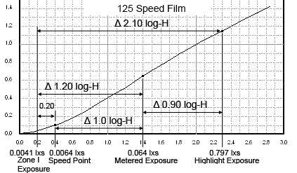

To determine the exposure when using a step tablet first identify the point of density where you want to ascertain the transmitted illuminance. The density of the step tablet where the resulting film density is at 0.10 for instance.
This is where having a precise measurement of the incident illuminance comes in handy and an accurate density value (calibrated step tablet). Although, a relative speed value can be determined and then used as a comparison against future tests. Finding the necessary lxs for any speed is simply 0.8/EI.
0.80 / 400 = 0.0020 lxs
0.80 / 125 = 0.0064 lxs
0.80 / 100 = 0.0080 lxs
Transmittance = 1 / 10^Density
Transmitted light = Incident Illuminance * Transmittance.
2.76 step table density has a Transmittance of 0.0017
If the incident illuminance is 1.18 lxs, the transmitted illuminance is 1.18 * 0.0017 = 0.0020 lxs
0.08 / 0.0020 = 400
Here's something fun. The value of Hg or the metered exposure is 8/Speed Value. 8/400 = 0.020
The relationship between Hg and Hm can be expressed as Hg / Hm. It can also be expressed by the constants of Hg and Hm or 8 / 0.8 = 10 or 1.0 logs, or 3 1/3 stops. Not the 4 stops of the Zone System and the explanation as to why they are usually 2/3 stop difference in EI.

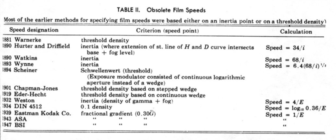

Speeds were designed to enable photographers to get consistent results with minimal effort, with the introduction of meters. It was never supposed to require elaborate measurements. That seems to be lost in this discussion. As I have claimed, the doubling of speeds in the 1960 revision of the standards was a mistake, in that it rested on evaluation of exposures and negative densities that were rapidly becoming obsolete. Films were becoming faster, and the leaf-shutter roll film cameras were being supplanted by 35mm focal-plane-shutter cameras. The older cameras, when loaded with faster films than had been available before the war, tended to create slight overexposure (when stopped well down to accommodate the faster films), but this did not matter greatly because the negatives were usually contact-printed by photo-finishers. I have seen such photos of my relatives taken in the 1940s. The photos came bound in a group, like a book. Some of the photos show the cameras, and they are the large folding models with leaf-shutter lenses.
Just when the new ASA standard finally was put into effect, these cameras were already being supplanted by Japanese 35mm SLR models with focal-plane shutters that were better able to handle the new faster films. The result is that almost every user of 35mm focal-plane shutter cameras will do well to use a little more exposure.
Speeds are designed to make it easier for users. Easier for users, yes, but they still needed to be determined.
The adjustment in film speed was partially due to smaller 35mm cameras but not for the reason you suggested. From Safety Factors, "If a large safety factor is used, the negatives obtained will, on the average, be much denser than is required for making a high-quality print. A small safety factor means thinner negatives. The main advantages of negatives resulting from the use of a small safety factor are:
