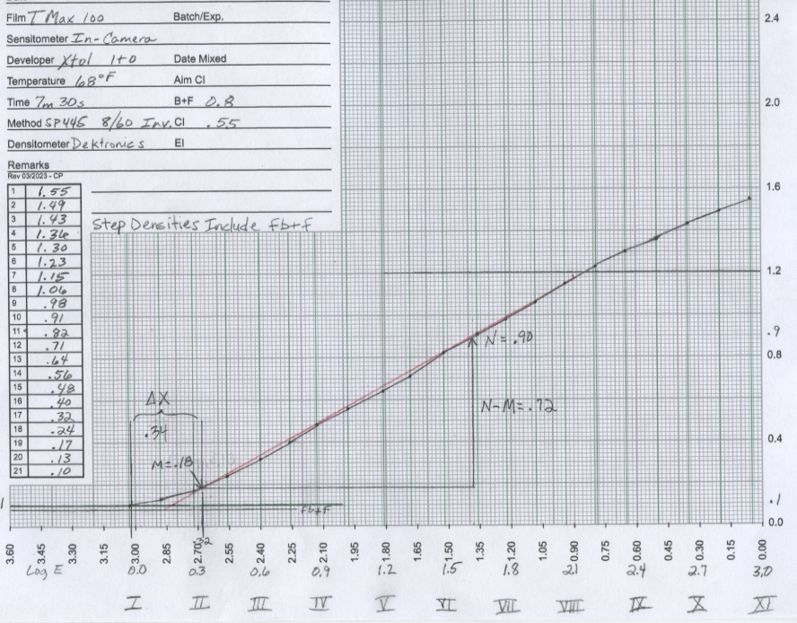

The TMax 100 curve . I used @Bill Burk 's Speed Meter overlay to ascertain the Delta-X space on the curve, but I have to admit I don't really understand the concept, that's putting it lightly, lol.
The TMax 100 curve . I used Bill Burk 's Speed Meter overlay to ascertain the Delta-X value on the curve, although I don't really understand how to utilize it.......................but that's for another thread.
Bill's graph has always been hard for me to read. It's just too busy. I worked through it, never the less, and it looks like there are no issues with the plotting. The problem is the step tablet density you have for 0.10 is too far to the left for the exposure you gave. For a incident illuminance of 2 lxs, you need to have 0.10 fall at a density of 2.39 on the step table or one stop to the right. So either my math is wrong or you are unknowingly underexposing the test. I personally like to see the 0.10 point fall a little further to the right to exposure a little more toe, but also to leave room on the left side for the tests processed to higher than normal development levels. It makes a family of curves work better.
You can either retest or assume this is the results of the testing method, but consider the EI to really be 100 (which is a realistic assumption). Zero on this, use it as a reference or change the constant from 0.8 to 0.4 (0.4/Hm). Let me know. Hopefully all this isn't just screwing things up for you.
Accurate testing is difficult. That's why the testing equipment tends to be so expensive. That's also why people doing personal testing based on a list 10 how-to-steps shouldn't expect results better than the manufacturers. Just because a test yields a number, doesn't mean the result is correct. I once got into an argument with someone at Kodak because all I had was a calibrated EG&G sensitometer.
Accurate testing is difficult. That's why the testing equipment tends to be so expensive. That's also why people doing personal testing based on a list 10 how-to-steps shouldn't expect results better than the manufacturers. Just because a test yields a number, doesn't mean the result is correct. I once got into an argument with someone at Kodak because all I had was using a calibrated EG&G sensitometer.
Ok, thank you, this test was done Feb 2023 and I will simply re-do it. I currently am using an expired box of TMX and will re-do it with my next box of new film. Thanks for taking a look.

Lines on the graph are 0.02 apart every fifth line is 0.10. You can write and read to 0.01 resolution by making use of the space between lines for odd numbers.
Green lines are ChuckP’s calibrated step wedge densities. His x-axis is always going to be correct. The illumination at his film plane can vary with his method.
If we trust the film and Delta-X his x-axis at 2.73 (attenuation) is where -2.1 log mcs (arithmetic .008 mcs) has fallen upon film plane.
Bill, those green lines indicating my calibrated step densities are precisely why I like that graph sheet so much and I enjoy plotting my curves by hand, it suites me well. I can plot across the sheet very quickly.
