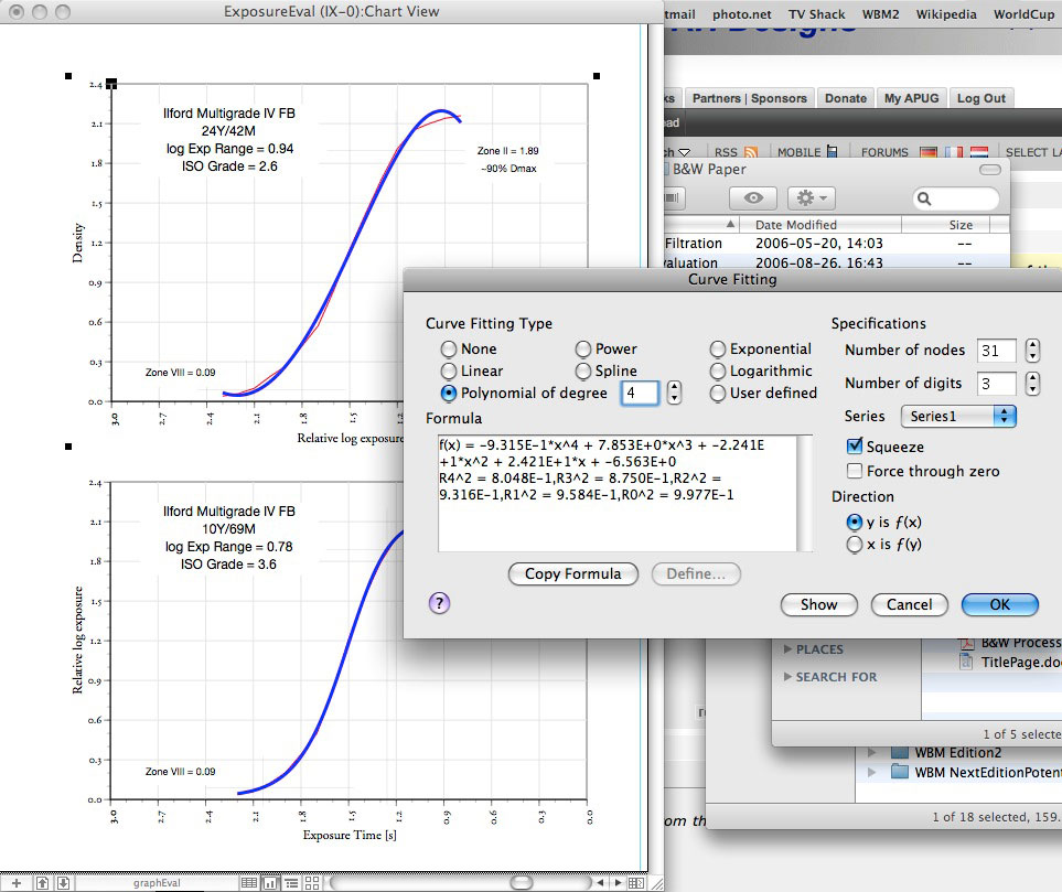

I too have been interested about the mathematics involved in determining some values on the film curve.
For me, the BTZS method of testing has placed the "density" of the negative correctly on the film curve most of the time. No person is always correct, and despite my best efforts, sometimes the negative appears too dense or too thin. I then try to correct my errors using the "correct" filters and/or paper grade(s).
In addition, while trying to learn how to develop film by inspection, I echo Nick's conclusion and those of so many others: Expose for the shadows, and develop for the highlights. Indeed.

It looks pretty decent to me, and doesn't behave wildly outside the range of interest.
One thing I do when fitting curves to film data is to simply add more data points on the F+B end of the curve. Afterall, giving less exposure is not going to cause a decrease in F+B. So I just add extra points, all with the same density of F+B.
On the other end, since the films I use (Fuji Acros) is pretty linear and doesn't get a shoulder in normal usage/exposure, I add extra point to extend the data. I could just make a second step wedge exposure that is given several more stops and get real data, but I find the range of data I'm interested is well within the range of values I get for nearly all step wedge results I have. Only on really low contrast N-2 or less negs do I not get enough density to plot the data and make calulations from it. (That's because the neg density is not greater than the paper exposure range I use for grade 2.)

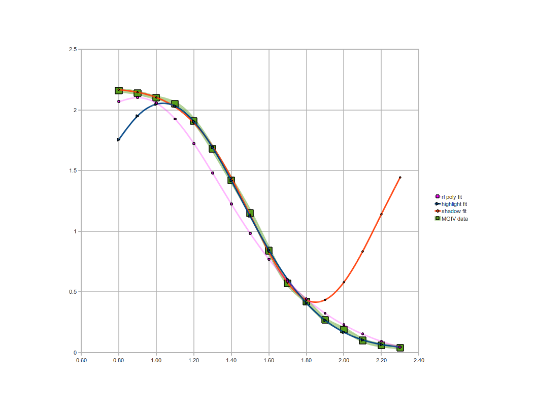

... So here's another graph using Ralph's MGIV grade 2 data plotted in red, and a quick manual attempt to match it only at the highlights with a gaussian curve (in blue). It looks pretty decent to me, and doesn't behave wildly outside the range of interest. It also follows the procedure in Nicholas' post, and only tries to match one end of the curve. I haven't attempted to match the darker print densities...

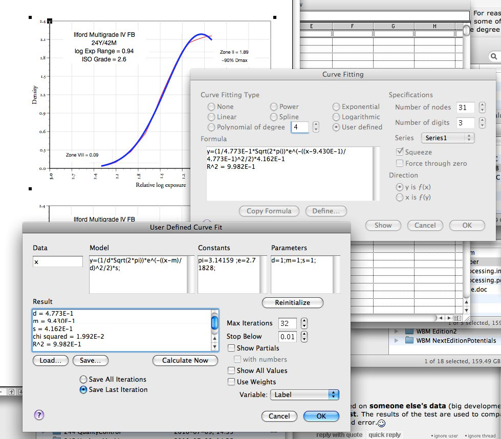

I have tried to fit a normal distribution curve to paper data. It works reasonably well but falls short in the shoulder due to the bell curve's extreme peak.

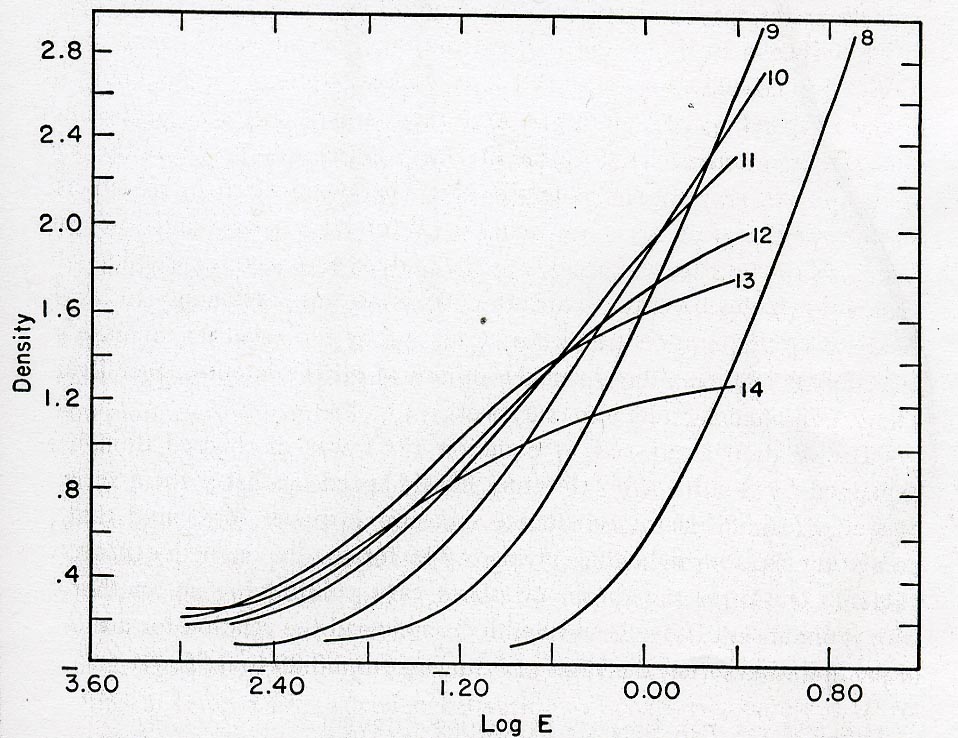

Evolution of this stuff

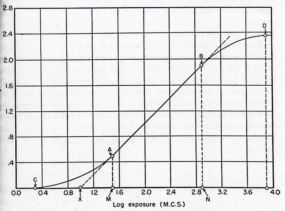

In post #247, Lee shows us an H&D curve with a bell shaped curve superimposed. If you consider the bell shaped curve to be representing the size frequency curve of the emulsion, then you see the reason behind a typical H&D curve.
This curve was idealized by H&D in the early days of photography (see my first figure below from Mees, Revised Edition). The best portion of the curve is marked in the figure.
In those days, that type of curve was not easily achieved due to the broad size frequency curves of emulsions made up to about the 50s. These were single run emulsions that produced the family of curves in my second figure below also from Mees. As addition times went up, speed went up but contrast went down. This was due to a broader distribution of grain sizes. Note how bowed the faster curves are. This made measurement and printing on faster films difficult at times.
In the 60s, it became possible to make double run emulsions that gave better speed, sharper toe and through blending, approached the H&D ideal.

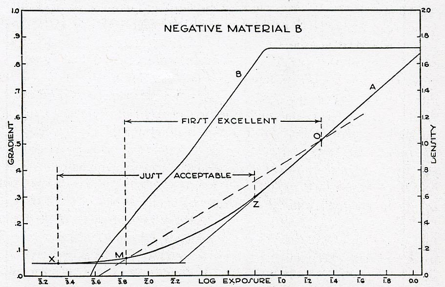

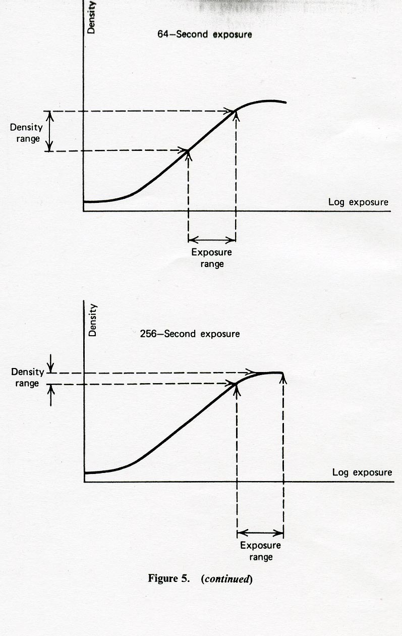

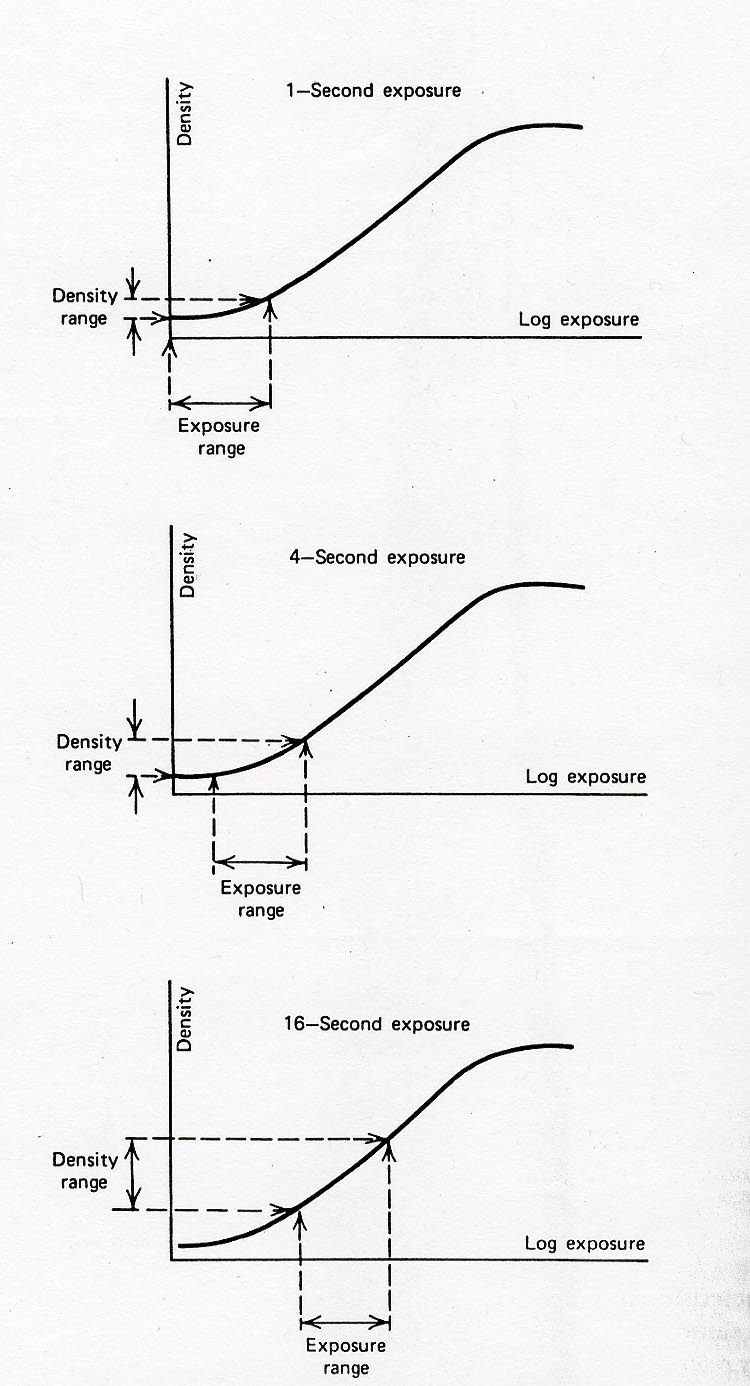

In Haist, Grant shows how to utilize the ideal curve to optimize the Density Range vs the Exposure Range by the simple expedient of insuring that the exposure was off the toe or by giving it a slight overexposure of about 1/3 stop. See the 3rd and 4th figures below.
Unfortunately, in his text, Grant says that you should expose on the toe to compensate for flare, but I believe this was a typographical error, since flare reduces contrast and the toe is low in contrast, the combination would be very bad. I intend to discuss this with Grant in a few weeks while he is visiting Rochester and I'll report back on this.
Fortunately, in Mees, in the chapter written by J. L. Tupper, he ran tests in which a relatively straight line (or near ideal) film was used in-camera and in which flare was considered. This data, in the 5th figure, shows the areas of Just Acceptable prints and First Excellent prints. Even though there is overlap, the only portion of the curve (points Z - O) which are Excellent lie vitually completely on the derivative curve shown by Nicholas Linden in his earlier post.

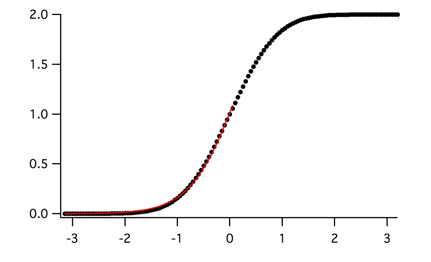

I don't think that this is actually what Nicholas was suggesting. As I understand it, he was arguing that the Gaussian functions should describe the derivative of the film curve, not the curve itself. The curve is then the integral of the Gaussian (for the appropriate region). This integral is known as the "error function", or "erf", because of its use in statistics. Unfortunately, erf does not have a simple closed form, and so fitting data to it requires first calculating numerical values.

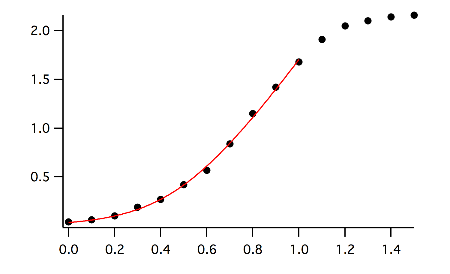

Just to see what would happen, I tried fitting my function (see the first post in this thread) to just the first half of the error function. The results are attached. As you can see the fit is very good, certainly as good as any approximations used to justify the error function as a physically-based model. In addition, my function accounts for both the toe and an extended linear region with out patching together two functions. Accommodating the shoulder would require another function.
I also tried fitting my function to the toe and straight line region of Ralph's paper curve. The graph is attached, and, again, it works very well for this region.
I don't think that he meant it this way, but I think that Nicholas' post offers support for my approach, *for flim curves*.
David
Yes, that is correct, and I took the same meaning, but perhaps got carried away with the gaussian vs polynomial issue. I need to review your code again after doing more reading, as I've been out and involved with other things most of the day. I'll see about correcting my earlier claims if I can still edit. (It's now too late to correct the post you're referring to here.)
My last math class was in 1973, and I'm not a mathematician or scientist, so I have to re-learn as I go when doing this kind of thing.
But my main point is that a curve derived from two gaussian functions for different shadow/highlight behaviors is more 'natural' (in the sense of scientifically 'elegant') than using a small section of a second order polynomial divided by a third order polynomial. The same objections that Nicholas has stated.

In post #258, I showed that a bell curve works well for the paper toe and midsection but not the shoulder. Attached is an attempt to make it fit a film curve, which also does not work very well. Tmax does not have much of a shoulder over a 10-stop range, and the bell curve is trying to squeeze one in. How well it works may depend on the individual data, but I think, I'm better off with the nonlinear function I'm already using.
Not ignoring your post, just have a lot going on...
Both methods sound reasonable to me. With the somewhat 'asymptotic' curve at the film toe, a model might find an extra fb+f point or two useful. It also helps to tell the viewer that it's a strict physical limit, and can vary with development time.

a bell curve
Unlike polynomial curve fitting (where a small section of a polynomial is forced to mimic a small section of data representing a sampling of physical data) the proper fit to the HD curve uses the equation that represents the underlying physics. It doesn't have to be bent to the task, it normally fulfills the task and fits the HD curve from 0 to infinite exposure.
The correct function is not a bell curve. A bell curve (properly called a "normal distribution" or a "Gaussian distribution" http://en.wikipedia.org/wiki/Normal_distribution) does not fit an HD curve. As one is bell shaped and one is S shaped this is sort of obvious. Mangling the parameters of a bell curve so that half of it sort-of fits a portion of an HD curve is not the answer.
It is the integral (summation, adding together) of the bell curve distribution that needs to be used - it gives the total number of silver grains that have been exposed as a function of the light exposure. The integral of a probability is called a "Cumulative Distribution Function" (cdf), which in the case of a bell/normal/Gaussian distribution is the "Error Function" (erf). http://en.wikipedia.org/wiki/Error_function - please click on the link for the picture, it should look familiar...
The following is a very crude simplification: The bell curve gives the probability that one more grains of silver will be exposed. In the toe region the probability increases with increasing amounts of exposure for rather obvious reasons: the more light shining on the film, the higher the chance a grain of silver will be activated. However, as the number of grains of exposed silver in the film increases the probability of light hitting an unexposed grain falls. After all the grains are exposed the probability of another grain getting exposed is zero (though, as we all know, probabilities never fall to zero, rather they become infinitely improbable).
So we have two sets of probabilities: one for the toe and one for the shoulder. There are several factors contributing to the physics at the toe region, but as a Gaussian function with a bit of a twiddle fits the data well enough it is what is commonly used for this part of the curve.
The integral of a Gaussian distribution - the “error function” or “erf” - can only be represented numerically. There is no closed form solution to the erf. Your math package may or may not include the erf even though it is a very common function in physics. An easy and universal method for calculating an HD curve is with a spread sheet and simple numerical integration. An Excel file is provided at http://nolindan.com/UsenetStuff/GaussianHD.xls
