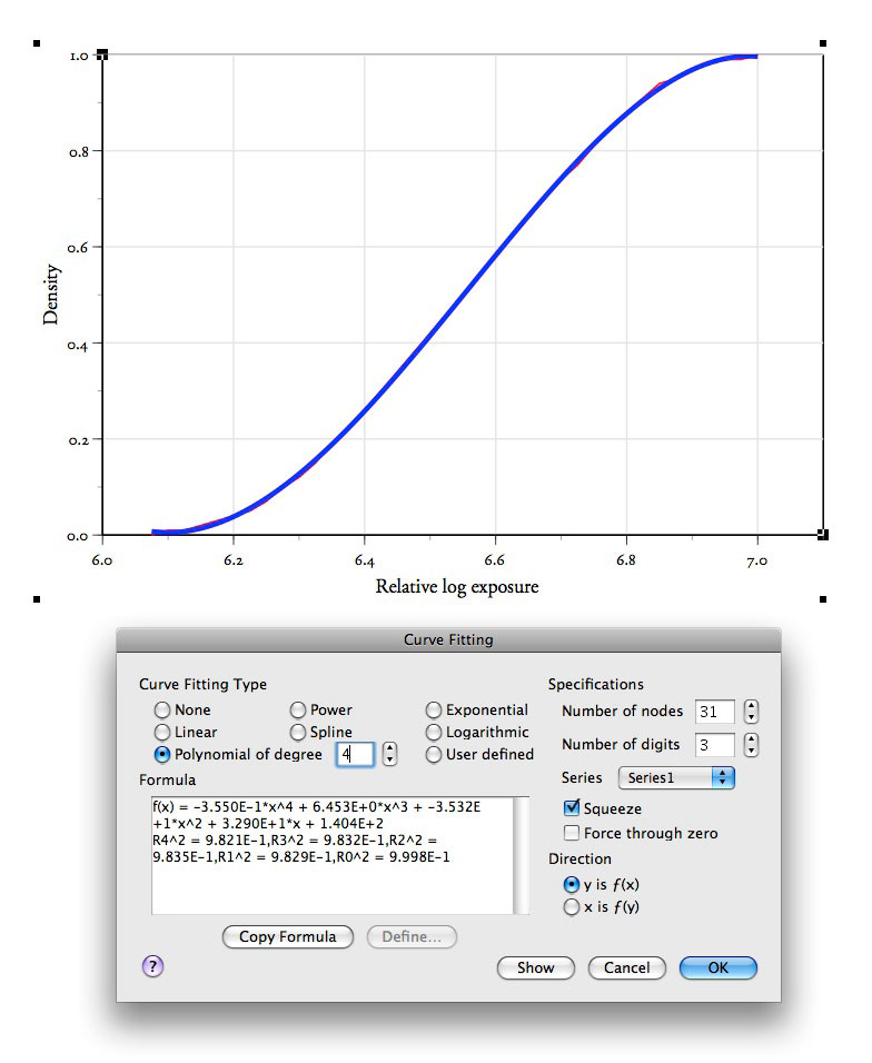

Try to use a polynomial to fit the blue HD curve in http://nolindan.com/UsenetStuff/GaussianHD.xls as shown in the graph over the range of X values from 5.5 to 7.5; for extra fun try to fit the red curve. The data is in c8..c88 for the x values, i8..i88 for the blue density curve and f8..f99 for the red derivative of the density dD/dE curve.
Nicholas
I had no problem fitting the s-curve portion with a 4th order polynominal. Even a 3rd order was very good. But I'm sure you knew that anyway. This would not work if you included the entire data set, of course, but there is no sense in including the horizontal lines, because they contain no relevant exposure data. As you can see, not a problem with polynomials as long as you stick to the relevant data from toe to shoulder. And much better than a normal distribution curve, by the way.

I'd still like to see anyone post a solution ( handwritten on paper or an actual spreadsheet, or the steps involved in solving it, etc.) to any of these nice gaussian, polynomial or spline curves, solving for y = 0.1, asdpgoldenberg demonstrated for the curve fit from the original post for this thread :smile:
x = (ln(exp(D/a1) - 1)-a3)/a2
He is using "D" as "y",
so it would be x = (ln(exp(0.1/a1) - 1)-a3)/a2
However (Ralph, correct me if I am wrong) I could not get DeltaGraph to do a "user specified" curve fit like the one mentioned in the original post (D(x) = a1*ln(1+exp(a2*x + a3)) ) to get the a1, a2 and a3 values. Did you try it also?

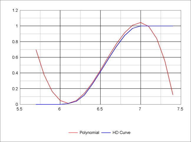

Nobody is questioning the ability to fit one or more polynomials to the central portion of the HD curve.
My question is: What value does a polynomial fit provide?
On other points:
1) Here is the comparison of the polynomial fit Vs the HD curve, when one looks past the inflection points:
The inability to model the under and overexposure regions of the HD curve is one of the drawbacks of using a single polynomial. The behavior outside the area of interest is a problem with all polynomial fits when a polynomial is not intrinsic to the process. This problem can be mitigated by using a spline fit to the data using multiple 3rd order polynomials, one polynomial between every two data points. Some of the overshoot of the polynomial curve is likely the result of rounding as I copied the poly coefficients from the screen shot and they only gave 4 digit precision.

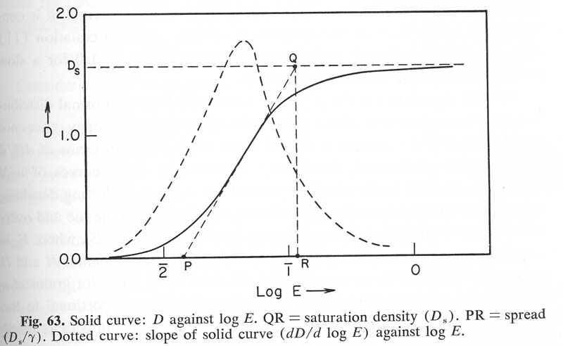

2) The diagram posted from the 3rd Edition of The Theory of the Photographic Process edited by James - the one where the derivative looks like a mesa, isn’t quite accurate. The derivative does not have a sharp corner at point A’. In any case, this graph is from chapter 20, “The Interpretation of Sensitometric Results” by Tupper. The same diagram is in the Revised Edition, Pg 870, as Fig. 299.
A better diagram, from the Revised Edition edited by Meese, pg 173, Chapter 5 “The Relation Between Exposure and Density” by Burton, is provided below:
This diagram represents one emulsion with one population of silver grains. Real films and papers are made from multiple emulsions and have a significant straight line portion that is made up of a succession of overlapping curves. This is the justification for splitting the bell shaped derivative curve at it's peak and splicing in a horizontal straight line segment.

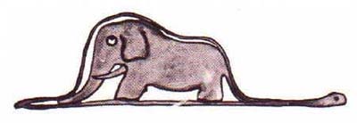

3) The HD curve is an 'S' shaped curve over the interval of interest. The derivative of all 'S' curves is a bell curve. The Gaussian distribution is the simplest bell curve and the Error Function (erf) is the simplest 'S' curve. This alone justifies its selection as the curve to use for modeling the HD curve. It is interesting, though, that the physics of density formation does indeed produce a Gaussian distribution.
4) The HD curve over it's entirety isn't really an 'S' curve. In fact, it better resembles:
(c) Antoine de Saint-Exupéry, “The Little Prince”

Nobody is questioning the ability to fit one or more polynomials to the central portion of the HD curve. ...
Nicholas
You did in post #271:
A polynomial (except for 0 and 1st order) can not fit a straight line. As an HD curve has a straight line section and two straight line asymptotes, using one polynomial for the entire thing is impossible.
The two straight line asymptotes are irrelevant for what we are discussing her, and again, we're talking about one polynominal not several, but if you agree that the relevant portion of the HD curve can be fit by one polynominal, maybe we can drop the case?

Maybe I can help. Deltagraph can solve for y=f(x) and x=f(y). So, if you are willing to put up with a mediocre x=f(y) fit, you'll get your answer by solving the attached equation for 0.1, using Nicholas data as an example. But, you could always do it graphically with the y=f(x) function.
