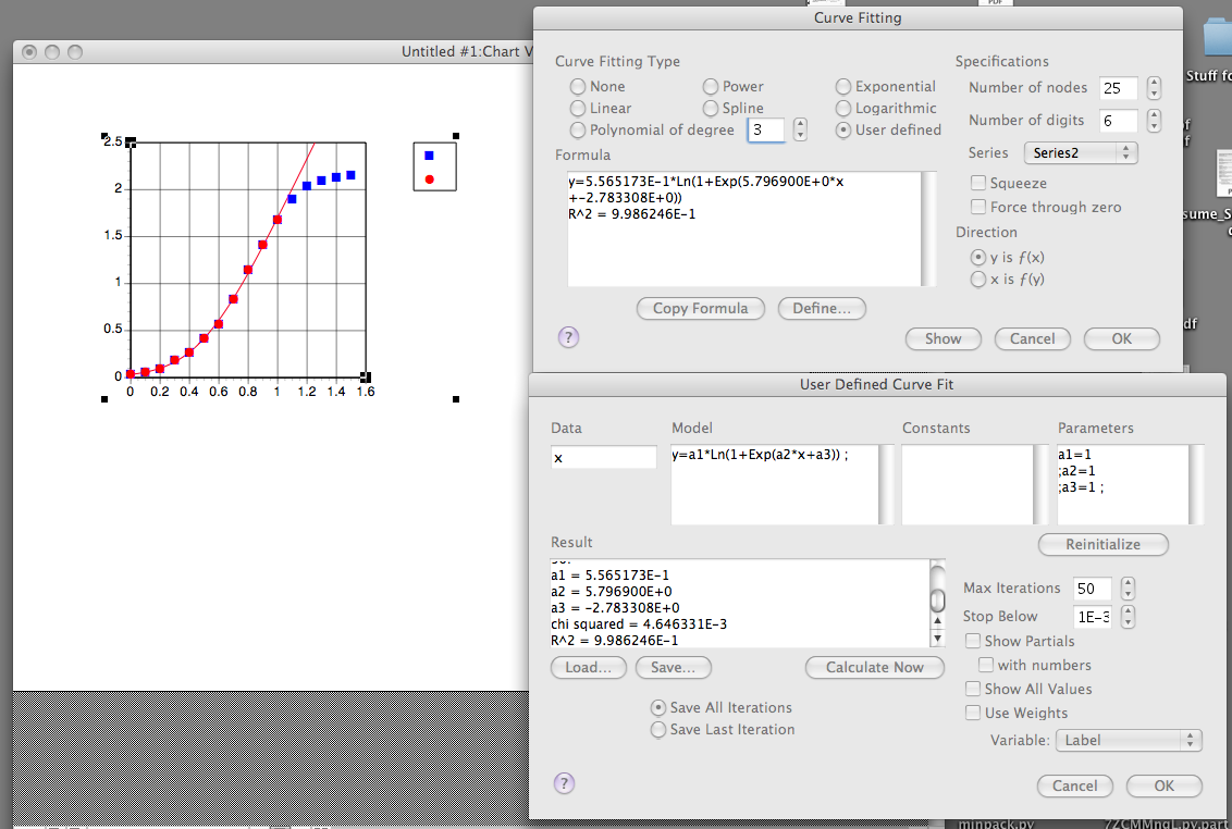

dpgoldenberg
Feb 18, 2009
50
Med. Format RF
However (Ralph, correct me if I am wrong) I could not get DeltaGraph to do a "user specified" curve fit like the one mentioned in the original post (D(x) = a1*ln(1+exp(a2*x + a3)) ) to get the a1, a2 and a3 values. Did you try it also?
It took me a while to figure out DeltaGraph enough to do this, but I did get it to fit my function to the toe and linear regions of Ralph's paper curve. Here is a capture of the dialog boxes.
David

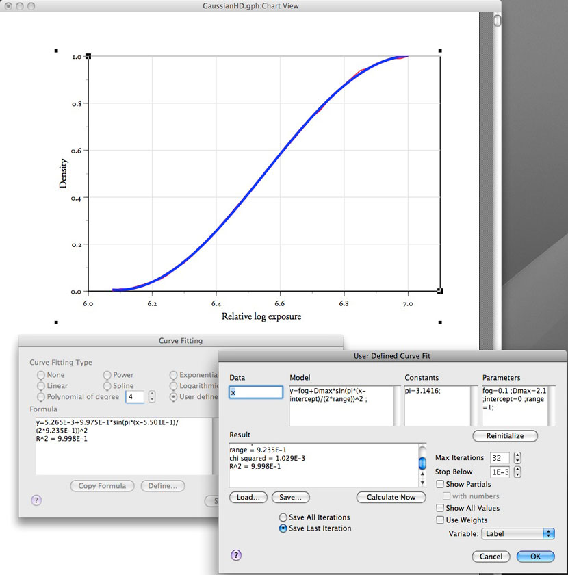

That's a half cycle of a sine wave Ralph. Give a few stops under or over exposure and you'll get a positive image with that model. With the right exposure (x-axis shift), you could make both highlights and shadows match density with midtones being the brightest part of the image, or both shadows and highlights bright with dark midtones. And you could keep sliding exposure up and down infinitely with alternating image characteristics.
In other words, it may fit the data over a very short range, but it's not a good model of how an exposed emulsion behaves.

A film curve can be a sine wave. Remember solarization? If you overexpose a film, you get a reversal curve which appears to be a sine wave. Modern films are built to repress this effect. It was there in older films and some of those texts show the reversal portion of the curve. If I run across one, I will post it.
On another tack, curve smoothing is sometimes not desirable. Some of these equations will smooth out the real bumps in curves of films and papers made of poorly blended emulsions. Therefore, you will end up with the wrong conclusions and perhaps poor photos from a bad batch of film or paper that looks smooth just because the curve is drawn that way.
This is an event that we always took precautions to avoid. We used individual points and drew the best curve through them so that we saw the data and the curve. If there were bumps that were not artifacts such as dust or scratches, then we repeated the test to see if the bumps in the real data was correct.
