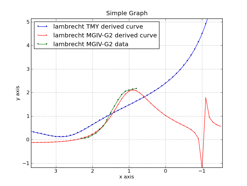

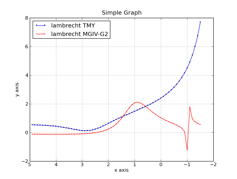

I've added a second graph with the x-axis reversed (relative to the x-axis numbers you appear to be using) to show more clearly what is happening (i.e adjusted for the orientation in which we typically read film curves). It appears to be relative log exposure vs. density, but with values on the x-axis reversed (values decreasing left to right) from the equations given in post #39.
Thanks,
Lee

Thanks Ralph.

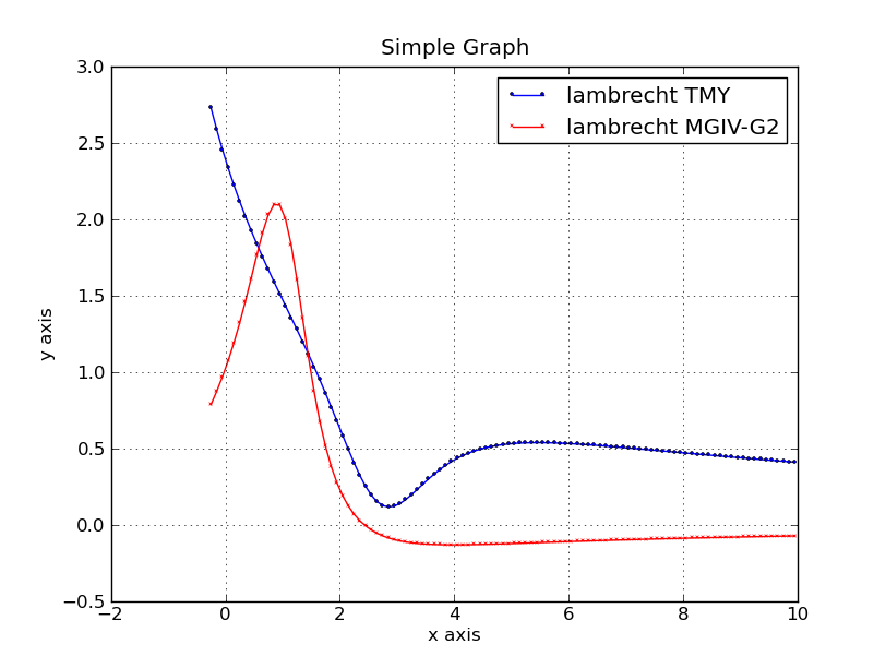

The curves shown in my graphs are your solutions for TMY and MGIV grade 2, the 'solved' equations you posted in #39 of this thread. I literally cut and pasted your two solved equations from post #39 into python and graphed them over the range x=-2 to x=10 in the first graph and over the range x=5 to x=-2 (lower values going right) in the second graph. The only change I made was in the power function character, from '^' to the equivalent '**' for python syntax. So the graphs I posted literally use your Deltagraph output, they just cover a wider range than your data, and the peaks are in your equations, just outside the range you use for data.
I like to see more of the curve to get a sense of the math and a visual display of what the curve actually describes, even if you're only using a limited portion of the curve to describe film and paper. However, I didn't show out to x=-2.21 for the curves, as your TMY equation peaks near there at about y=1280, which blows the detail because of the extended y-axis.
I've added your raw MGIV at grade 2 data to my python plot and attached it so that folks can see what portion of the curves you're fitting. I suspect that the fit is affected to some degree by the number of significant digits shown in Deltagraph's equation display combined with the number of terms and exponentials involved.
Lee

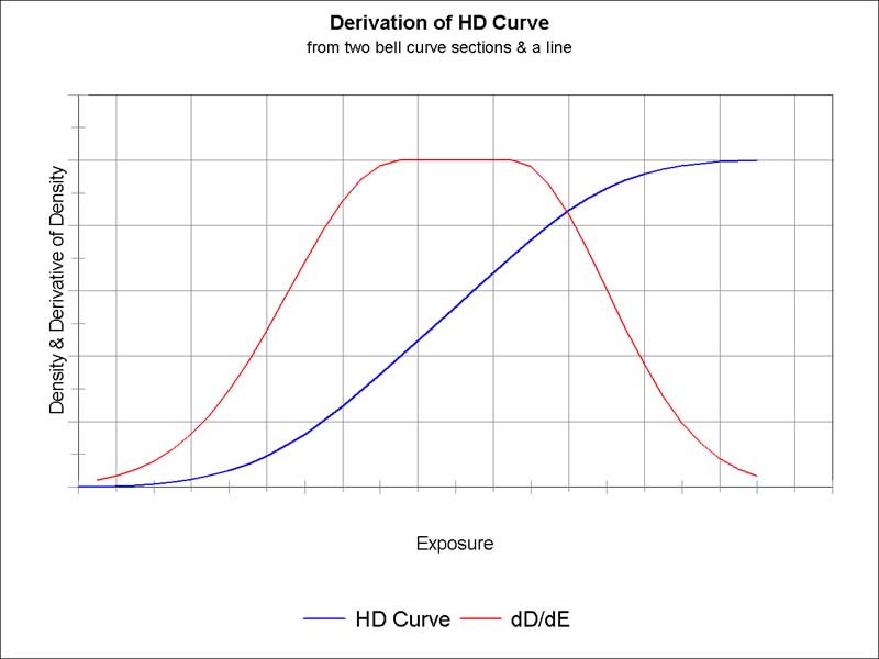

The physical processes that give rise to the HD curve are covered in chapter 5 of Meese, revised ed.. The three parts of the HD curve are due to different physical processes and therefore there is no one function that models the entire curve. Meese also points out that it is often easier to deal with the derivative (dD/dE) of the HD curve as the physical process of image formation gives rise to a function that gives the increase in density for an increase in exposure. The resulting function is integrated to give the HD curve.
The physics of image formation give rise to dD/dE equations of the same form as the normal ‘bell-curve’ Gaussian distribution function http://en.wikipedia.org/wiki/Gaussian_function . It is possible to model the toe and the shoulder region as halves of the standard bell curve, each half having different parameters. Although Meese doesn’t go into it, the straight line joining the toe and shoulder of modern emulsions is adequately modeled with, of all things, a straight line.
The result of integrating two 1/2 bell curves, one for the toe and one for the shoulder, with a straight line in between, is shown below.
It is - relatively - easy to fit this set of three functions to a real-life HD curve.
As the function is derived from the physics of the exposure process it has few artifacts, is continuous for all derivatives, and is well behaved outside of the set of data points. The resulting function has an infinite toe and shoulder that quickly become asymptotic to dmin and dmax, even if only the inner portion of the HD curve is used for data points.

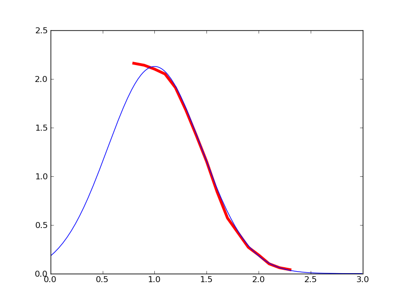

So here's another graph using Ralph's MGIV grade 2 data plotted in red, and a quick manual attempt to match it only at the highlights with a gaussian curve (in blue). It looks pretty decent to me, and doesn't behave wildly outside the range of interest. It also follows the procedure in Nicholas' post, and only tries to match one end of the curve. I haven't attempted to match the darker print densities.
For this gaussian curve:
mu=1 (the x-axis displacement of the peak of the gaussian curve)
sigma=.45
I also included a factor by which to multiply the y value, which for this curve is 2.4.
Lee
