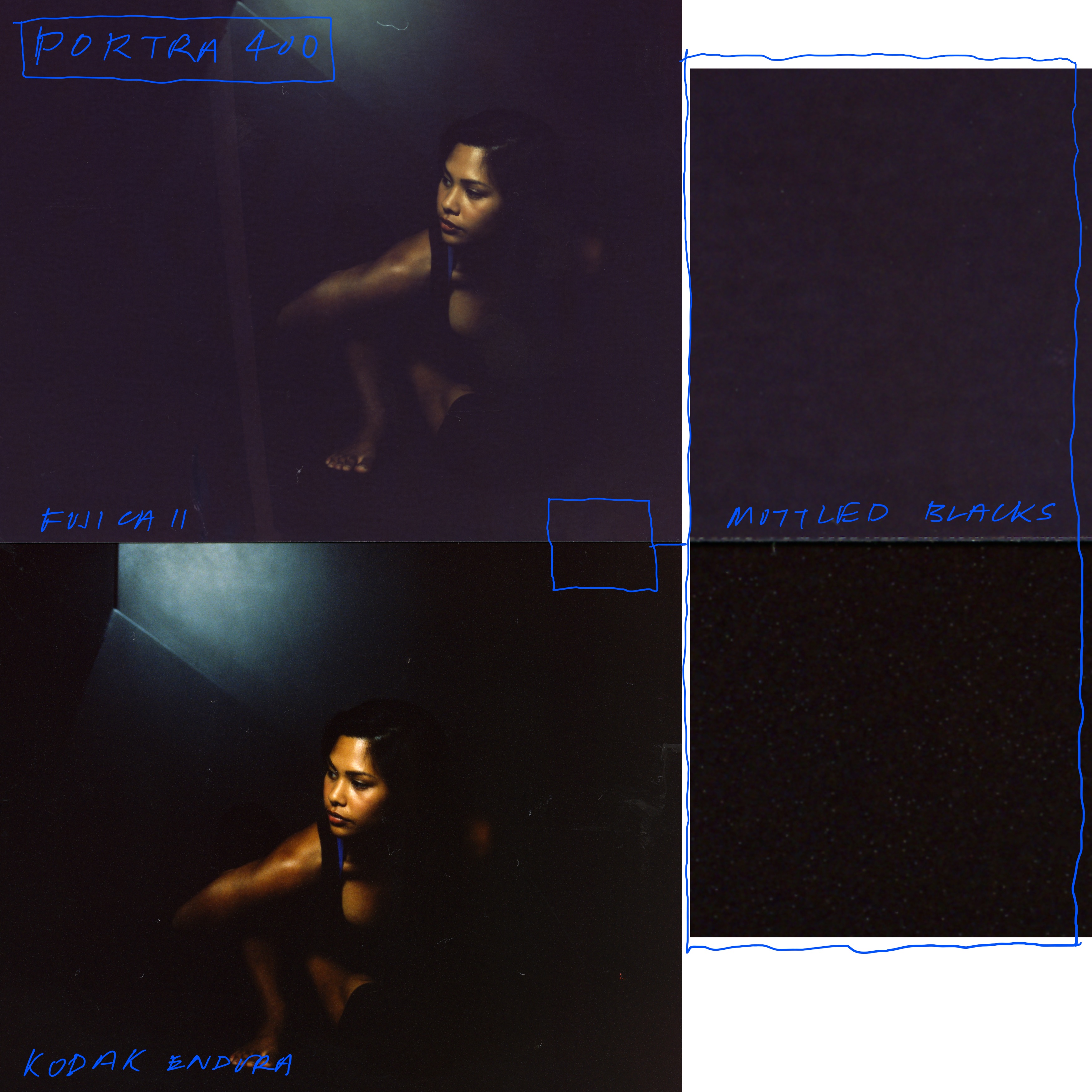

Drew can you recommend chems/dev for CAII? I have these mottled blacks which I don’t get from endura. I actually like CAII, in retrospect it is a good paper albeit a bit thin. At the time I was using Kodak chemistry. Here is a test
I keep saying it 'cause it's true: print on a higher end paper. Try DPII or even CA Supreme HD, which is just one step up but still better. The mottling on plain CA isn't going away with different chemistry. It's a little emphasized in your scans, but under very bright light, that is indeed what the 'blacks' of plain CA look like.
I have NEVER gotten any kind of mottled blacks from CAII. Never, not even once, even in prints with a lot of deep black. And several different brands chemistry has been involved : Kodak Ra/Rt, Arista RA4 kits, and Silver Pixel kits (all of these seem chemically identical standardized RA4, and even interchangeable). In fact, I've never experienced mottling with any kind of Fuji paper in any size. And as per CAii cut sheet, I've used different boxes over several different years. It's not a bad product at all, but just limited in certain respects.
But don't expect a "knock your socks" off DMax like I get with expensive Fujiflex Supergloss, or that Maxima is allegedly capable of in a special dev tweak.
I'd be curious about the exact time/temp dev method involved in these alleged complaints. I dev in drums and never replenish or re-use the spent chemistry. It is mixed fresh per daily session, just enough for that day. 83F (30C), prewet 1 min / Dev 2 min / weak stop bath 1 min / plain water rinse 1 min / Blix 2 min / multiple washings in drum. Is your own chemistry fresh?
Just a hypothesis - but being a thin paper, you might also want to see if there is any possibility of back reflection during exposure. I never noticed any difference from test strips placed exposed in a yellow 8X10 Saunders easel and full sized 20X24 versions done on big black easels. Something just isn't adding up. I'm not doubting Koraks experience; nor should he be doubting mine. I've thrown out most of my old CAii boxes, so can't reliably compare the actual batch numbers at this point in time.
Unfortunately, once I've completed this season's work with Fujiflex, I doubt I'll have any more time for color printing this year, or opportunity to test these newer Fuji papers entering the US. The specific labeling for most of them seems to differ from the EU; and the most popular item in small local labs is CA Supreme, which has agreeably replaced Radiance, but is only available up to 12 inch width, or only 10 inch width in the case of gloss surface. But that's plenty big enough for 35mm shapshot work, and it's still specifically optical exposure compatible. But I no have idea what the specific distribution chain to Australia is offering. It's confusing enough here. What I'd really like to try is the new version of Super C in 30-inch roll size.
While it could be the paper, I've also found mottling from exhausted stop bath.
That's an interesting note, especially since RA4 does not technically require a stop bath due to the buffering of the blix (at around pH 6.5). Indeed, most larger RT machines do not have a stop bath, and also not always have effective squeeze rollers to limit developer carryover. It's therefore somewhat puzzling to me how an exhausted stop bath would cause mottled blacks, while I do sort of see how it could contribute to overall mottling and color problems - but it would still be a rather exceptional situation.

Something doesn’t add up. I’m not willing to accept that we have to live with this mottling just yet. I’ve seen a few people, mostly experienced printers say they do not get mottling. I tend to believe that this is the case as it would be strange to me if it was there they wouldn’t see it. Most people don’t even know that it exists, for whatever reason, so they will say no it’s fine. As I am quite fastidious and have a very keen eye I can see it, jumps right out. As far as I am aware chems are standardised so this is not the issue, clearly.
My process is almost identical to yours: Jobo drums, single shot chems, 30deg etc. I always use a LPL Saunders x4 blade easel, print times on my Beseler 45 dichro head are fairly orthodox 5-10 sec exposure (small amount of ND dialled in to increase exposure time). I have tried with and without stop bath has no effect. I first printed this image 5 yrs ago using Fuji hunt at room temp - same. I have done this side by side on the same day with endura and CAII with same chems etc.
It’s possible you may be onto something re paper thickness. The mottling looks like slightly uneven distribution of fibres in the paper itself. Put a piece of standard paper on a light box and you’ll see this. 12 months ago I was baffled by some strange green and blues showing up in a print, had never seen it before. What happened was I had made a custom dodge card out of an old box. It wasn’t ultra thick cardboard but thick enough. There were coloured images on the underside of the card so as I dodged the light went through the card and coloured the print. I taped up the card with black tape and problem solved.
If the paper is thin and light can pass through it and reflect off the easel back onto the paper can it do this to the print? Don’t know but that sounds possible for sure. I have never used a black easel, they are always white or yellow. The only dark grey/black easels I’ve ever seen are Kienzle and some older ones. If you are using a black easel that may be a clue? Very few would be using black easels. Maybe the test strips are to small and you are just not seeing or looking for it. The only way to test this would be to black out the easel so light was absorbed not reflected.

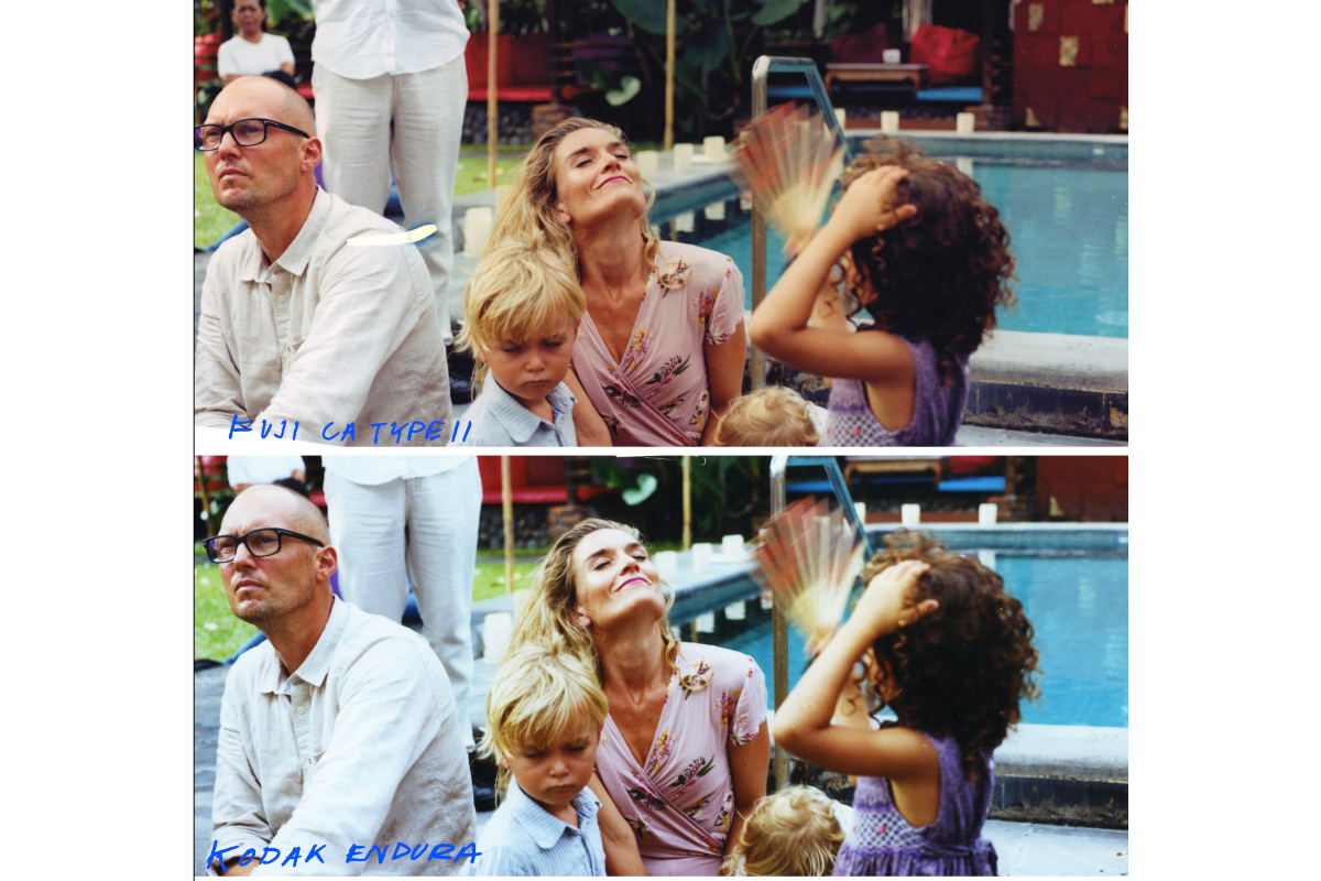

Regarding Endura vs CAII. Endura is designed for digital and for most prints, particularly with skin tones it is actually quite awful. Fantastic for certain density or color profile. It is contrasty, harsh. Although I haven’t used DPII I understand it is similar to endura. Not a fan at all. CAII is much nicer paper albeit blacks and thickness. I too would like to get my hands on the Fuji pro paper Super C or P type. This I understand this is the best (aside from the prem fujiflex, velvet etc). Although I can’t find it now, someone had compared these Fuji papers including DPII in darkroom and the super C and type P were clearly superior.
Attached is a test print of endura compared to CAII
No, it's not related to the thickness of the paper.
The problem is a combination of two aspects:
1: These papers are coated on a Schoeller base paper that's in turn laminated with PE layers top and bottom (this is done in-house by Fuji) and then the emulsion stack is coated on the top side. Part of the problem is in the Schoeller paper base, which isn't perfectly even. It's slightly wavy, like a hilly landscape - just with very, very subtle hills.
2: The cheaper papers have thinner image-forming layers in the emulsion stack, and also thinner inter-layers. Especially the thin image-forming layers limit the optical density attainable by the paper, and furthermore will exacerbate problems with unevenness of the paper base, since there's not enough optical density to hide the effects of slight variation in emulsion layer thickness as a result of the wavy paper base. This is why the problem also turns up in blue skies etc.
I'm nog second-guessing at this, I actually discussed this with the people who manufacture the paper. Earlier this year, I visited them and I brought some prints, one of which featured a large red area that was supposed to be fairly even, and it showed this same mottling. I brought this up with them and they explained the problem to me.
Coincidentally, the same mottling pattern can be reproduced on some B&W PE papers, since they apparently use the same kind of base material, or the material is at least manufactured in the same why (and by the same company; Schoeller is pretty much the sole supplier for photographic paper bases). Take a sheet of let's say Adox Easyprint, expose to room light, develop, fix, wash, and then start bleaching with a ferricyanide bleach. At some point you'll notice the same mottling pattern emerging. It also tends to be a problem if you reversal process B&W paper to make 'instant positives'.
Again, the solution is to move to a higher grade paper with thicker image-forming layers.
That's not right, but you'll get away with it alright if you adjust processing temperature. However, if you develop at 30C for 0:45 then you'll likely exacerbate the problem.
All contemporary RA4 paper are 'designed for digital'. There's a magenta/green crossover if you print optically onto these papers. Most people don't notice it until you try to replicate a (properly) digitally exposed print with an optical print. It'll take supplemental masking or at least filtered pre-flashing (with a lot of luck) to minimize the effect. The way it looks to most people, if you compare a digitally exposed RA4 print to an optical one, is that the digital print tends to look 'richer', or 'right', while the optical enlargement is somehow 'not quite right' or 'lackluster' by comparison. If you only print optically and never do strict side by side comparisons, there's a good change the problem will never bother you, since hordes of darkroom printers have merrily printed away for 2 decades now on their digital papers.
There are some stocks of old paper still floating around, heavily expired, that are not 'digital' papers. I still have some early-generaton Crystal Archive that printed fine the last time I used it, gave solid and deep blacks and (probably...) filtered correctly for optical enlargements. This was from the era when Fuji still manufactured their own base material (instead of sourcing it from Schoeller), the emulsion layers were coated thicker, and the actual emulsion mix was different and produced a more linear h/d curve that tracked better between the layers. The latter is not necessary with digital exposure since you can just make an ICC profile that corrects for the non-linearities and lack of tracking between the colors.
Again, not making stuff up here, but going by what the Fuji engineers told me. Interestingly, many darkroom printers are so conservative that they ignore, deny or ridicule what I relay from Fuji to them. With the exception of the handful pro/fine-art printers I also talk to face to face in my country, who understand, acknowledge and sometimes recognize the problems.
PS: Endura sure is a punchy paper, with high saturation and fairly high contrast. It can be nice for certain images. In your side by side comparison, there is also a fairly large difference in color balance which also contributes to the Endura looking somewhat garish. If you remove some yellow from the filter pack, the high-value skintones (e.g. the lady's forehead) will retain more tone since that's predominantly yellow, and it'll subdue the contrast in her face somewhat. This will make the Endura print look less harsh. The Endura print also has a bit of a cyan cast; if you filter that out by removing also some magenta from the filter pack, it's going to look a little more friendly. Still punchy and contrasty compared to the CAII though.

Thanks. Sounds like you are into this and what you say makes sense and is verified by engineers. It is consumer grade paper so it isnt high performing. Sounds like mottling is here to stay. For some images it is still good just not anything with large block colors. My understanding is that papers now are digital but others hybrid meaning both digital and optical? Have you discussed this with anyone? Yes, I’m not expecting any new pro papers to be traditional optical papers but more hybrid type.
Yeah these were test strips and colors were off but not far off. It is ektar so not great for skin tones and contrasty as hell. I’d use portra 160 with endura (still have 3 rolls) and get the neg right rather than paper. I might even “pull” the film a little reduce contrast. Still even with color balance the highlights are way off CAII. Typo I dev at 35deg not 30deg
PS: talking to Fuji here in AUS was as useful as an ashtray on a motorbike lol
This image on endura was perfect. On CAII it was dull https://www.dropbox.com/s/cg4ax687psd5xb7/img026.JPG?dl=0
This was the final print on endura because of the blacks. Flashed the print turned out pretty well

I experimented quite a bit with that, but currently, I think post-flashing is a better way to achieve the same thing, but with more flexibility. Here's what you do:
* Expose the print as you've done for your Endura example - so with slightly or even significantly underexposed highlights.
* Fit a diffusor under the lens; milky plexiglass works well.
* Give another exposure with the same filtration.
Then process as usual.
For the second exposure you'll have to determine how long it needs to be to get the desired effect. What will happen is that the low densities (highlights) get bumped in density, while the shadows remain barely affected, or not (visibly) at all. This can bring your Endura print exactly in line with the Fuji print.
The other neat thing you can do is change the filtration between the first and the second exposure. For instance, you could balance the first exposure a bit more blue/cyan and the second one more yellow/red. This will induce a sort of 'split toning' that looks quite natural. Or go crazy and do the opposite, or something different entirely. You'll find this opens up creative possibilities that you probably had never realized, and it's relatively easy. Just be prepared to go through a lot of test strips...
Also, you could do the second ('flash') exposure not through the negative and a diffusor, but on a different enlarger and through a clear piece of C41 (or ECN2) film. This will take out the influence of the color distribution of the original negative. May be useful especially if you're working on a series of prints that you want to make as consistent as possible. I personally don't bother and just swivel a frosted plexi diffuser under the lens and have at it.
Finally, you can experiment with doing the diffused exposure first (before the image exposure) or last (after it). There will be a difference. Give it a try.
