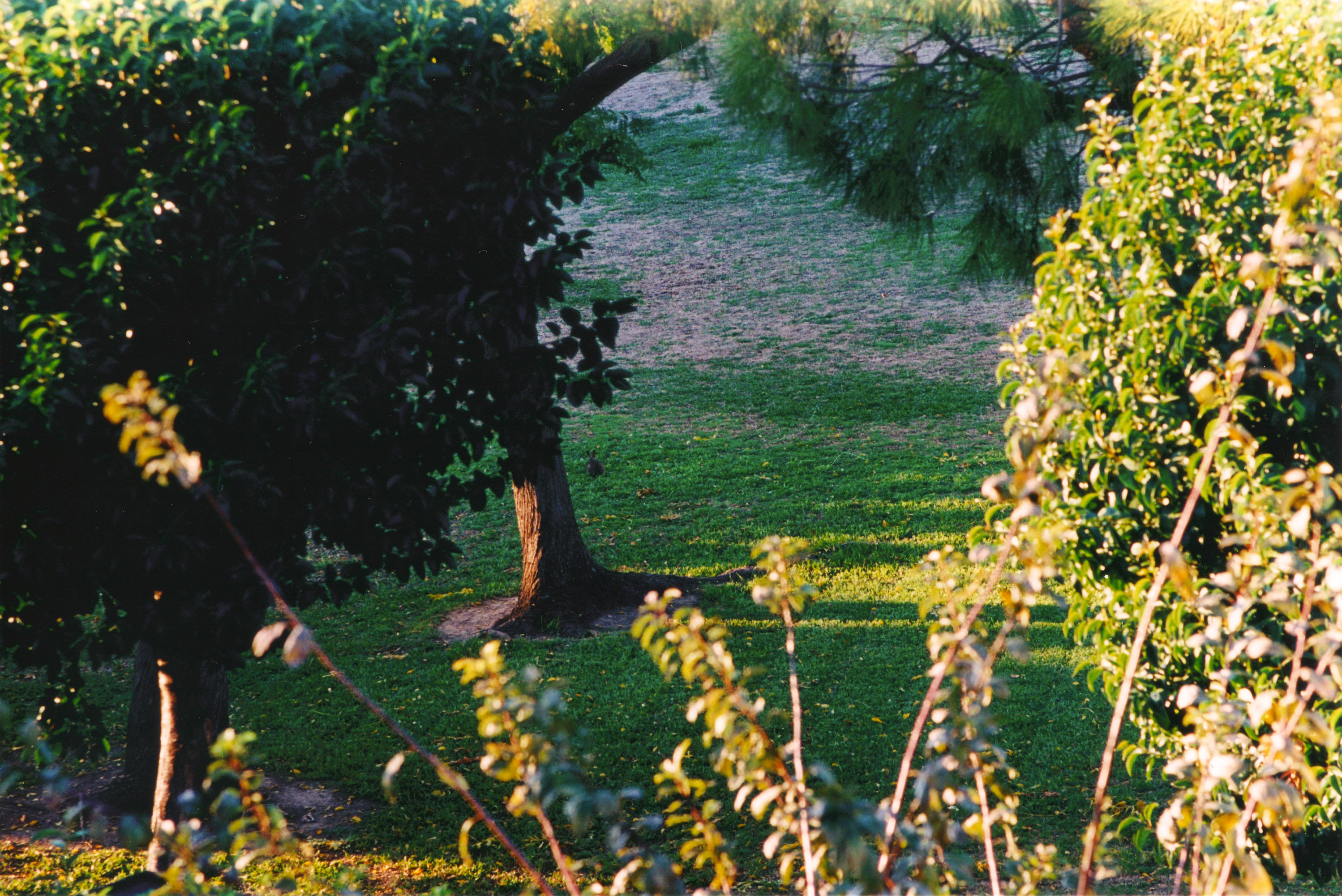

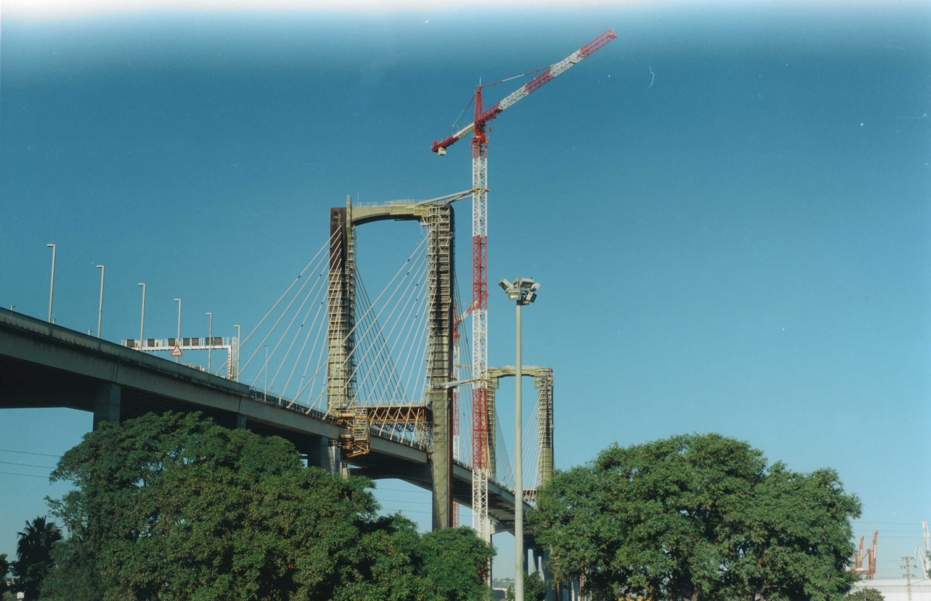

So, after several weeks I have the results. I have to say that they are not my best photos. The differences are noticeables. I recommend to see them at fullscreen.
Bellini RA4.
Scanner used: HP F2200
Flickr (higher resolution and quality, see the comments): https://www.flickr.com/photos/arturo_rs/albums/with/72177720313506784
Kodak 250D - ECN2 4 minutes.
The contrast, at 4 minutes with MAXIMA, for me is too much.
Crystal Archive:
DP II:
MAXIMA:
Other examples, both with MAXIMA paper. C41 at 3:15 minutes.
The first one, Portra 400, the second one, Ektar 100.
Differences between DP II and Maxima:
  • MAXIMA is a cooler paper. I had to reduce the yellow filtration around 10 points. I use Arista RA4 filter set.
  • The exhaustion of chemistry is noticable.
  • Less exposure time, around 1/2 stop.
I run out of RA4 chemistry so I can´t do more prints. Next moth surely I will upload more prints.
Those were also my findings with matte. But in my case the differences are more subtle. A bit cooler (3 points in Durst scale) and a bit less exposure (10% aprox) in exchange of some more density specially in the shadows. I use one-shot chemistry in a Jobo CPP2, so exhaustion is not an issue.
