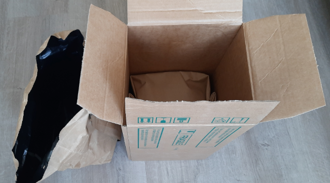

This is the packaging of a 2-roll 8" box:
Two rolls to a box, each roll packed in its own lightproof bag. One remaining roll in the box above; empty bag to the left.
Empty bag; these are paper bags with a black polymer lining on the inside. The material is quite sturdy, but not bulletproof.
Selling single rolls from a box like this would involve taking out one of the rolls and repacking it in a suitable box for shipping. That's all.
