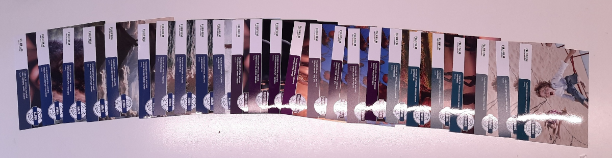

These are the papers that are in the sampler pack I got a few weeks ago:
This does not include Flex or Trans since these are manufactured in Japan. "PD" as such isn't in there either because it's a product that appears to be unique to the US market. I'm not sure if it's actually a unique product or that it's in the lineup in a different name as well.
In this lineup there are also various Album papers. These are intended to be glued back-to-back (or perhaps on top of a carrier/base material) to make wedding albums etc. Some, like Album XS, are really, really thin, which is interesting (and creepy to think of handling bigger prints of this weight!)
The paper I'd really like to get my hands on would be Velvet. It's a true dead-matte finish and unique as a result. This, combined with Maxima or DPII, would be ideal for my needs.
But I guess the wide selection of materials also illustrates why for retailers it's unattractive to offer more than one or two of them in cut sheet. They'd end up with unsold and expired stock much of the time, no doubt. Still, I'd like to make a case for retailers/confectioners to offer more than plain CA in cut sheet. IMO it would make perfect sense to replace CA with e.g. DPII if only a single cut-sheet option would be offered. It's a snap-in replacement of overall higher quality, and since the added value in cut sheet is the actual cutting & confectioning, the margin could be just as healthy with only a marginally higher retail price. So far, only Nordfoto in Germany seems to have realized this.
Wow! That's an impressive selection. But certain of those are probably being listed in the US under different names or hypothetically different size options, if inventory were up to normal. And photo albums per se related to weddings etc are an almost extinct custom here, with people wanting almost instant web presentation instead. They claim "silk" is designed to be difficult to copy or pirate - another not so versatile idea, though it would be interesting to see a sample of.
Brick n' mortar retailers are completely out of the color darkroom paper business in this country with a handful of exceptions. It's just the large internet and phone order houses involved. So what stores might or might not want is probably a non-factor. Few store personnel know a thing about color darkroom printing anymore. Inkjet has taken over. But labs still buy a lot of RA4 product. I've seen stacks of it being delivered to even the smaller niche labs. Convenience "Photofinishers" are yet another category, but depend on specific papers we darkroom workers don't have much use for.
But yeah, you'd be a Superhero if you could convince them to try cut sheet packaging of DPii when their master rolls of CAii run out; but somebody in marketing would probably whine about any price point shift, or that amateurs simply don't deserve something thicker. But gosh, the inconsistency in product designations between here and there sure makes things confusing sometimes. And Fujifilm USA just plain refuses to sell some of these products through retailers. It used to be that even the full selection of Super C could be ordered through B&H. B&H is now listing a wide range of roll sizes of Super PD as a special order option, also Silk, and big Fujiflex rolls too; but I'm not quite sure what PD equates to yet. It seems to be marketed as a lower contrast portrait paper, so not a replacement for Super C at all. I sure don't want anything lower contrast. What seems to be intended as a replacement for Super C is Type Cn - one of those alleged "digital only" options; but I take that with a grain of salt.
There is a big wholesale distribution warehouse just 15 miles from me here on the West Coast, who formerly handled a huge inventory of Kodak papers, and at least had an active Fuji account too. But they had hell trying to transition over when Kodak papers were dying off, and the pandemic was limiting Fuji imports, and probably affecting staffing too. They tried to be helpful to my queries, but just like all the others, didn't get responses from Fuji itself. It's that kind of thing which make me state the dust needs to settle a little more here first. Supply itself is just starting to normalize - and competent representation or knowledgable sales personnel - who knows? Those kinds of people are getting rare with respect to any product line these days.
Too bad some purchasing collective couldn't be put together here in the US for sake of combined bulk paper cuts, much like is done for special sizes of film.
I wonder if we can get a sampler for the US choices.
The US choices would be a subset of the papers shown above. There's only one plant manufacturing this material, and what's shown above is the full selection currently being made.
The only exceptions are FujiFlex and the older FujiTrans, which are niche products that are being coated in Japan.
