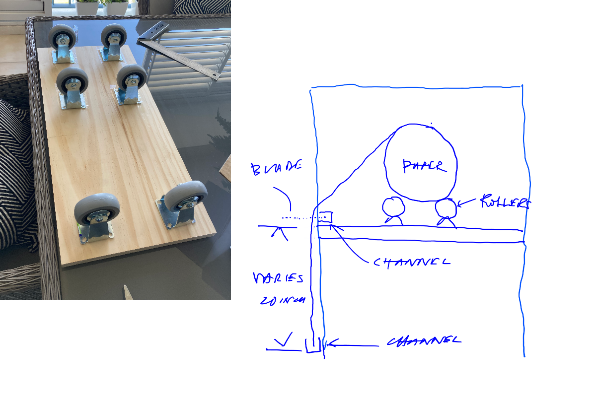

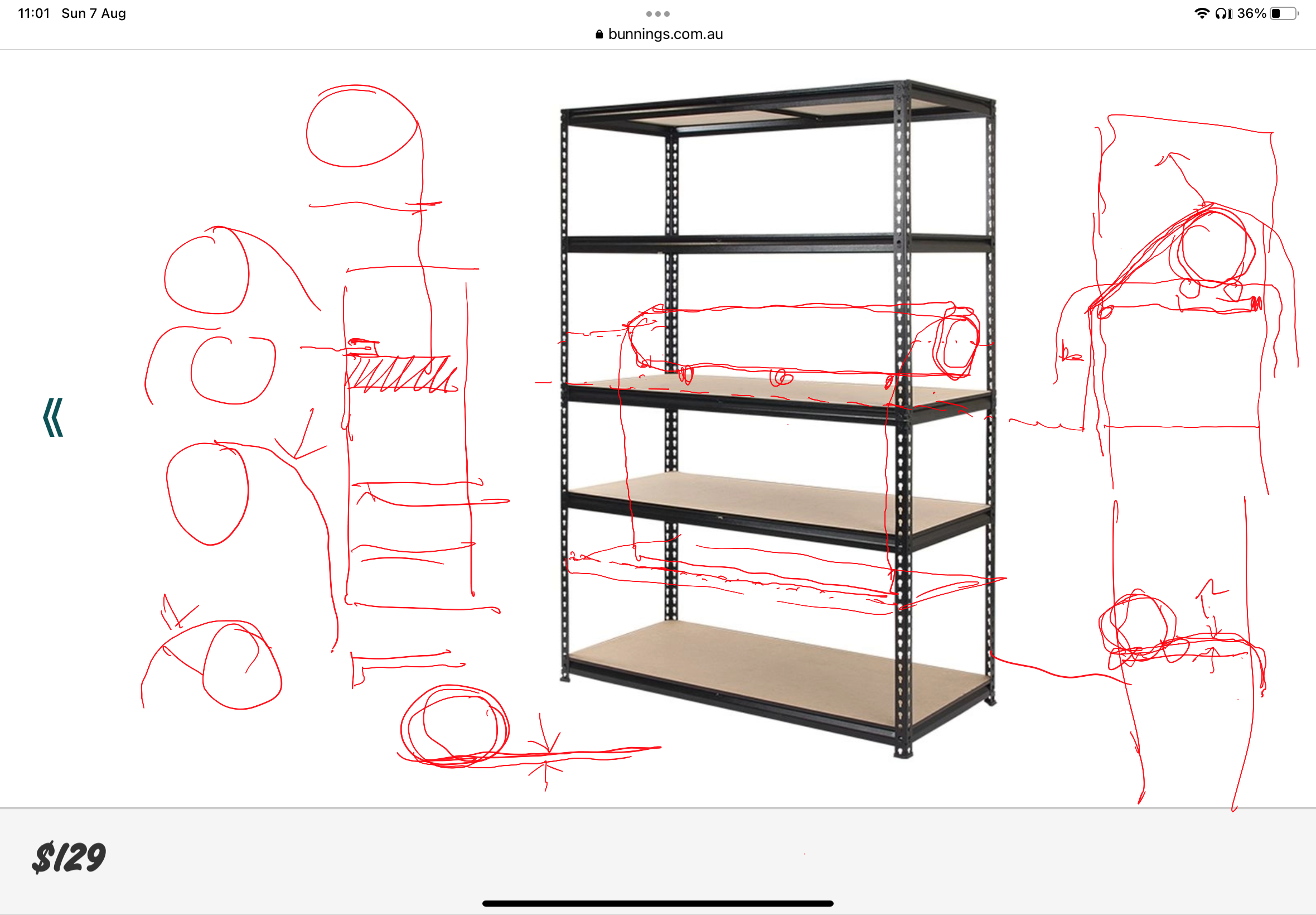

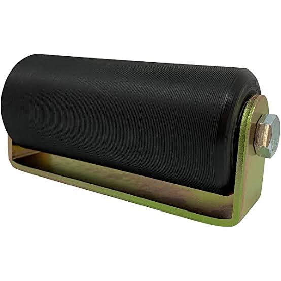

By rollers, I meant end roller. They are cone-shaped and plug into the end of the hollow cardboard core of the roll. Fujiflex is EMI (emulsion side is wound toward the inside). I wouldn't recommend narrow rollers below the material itself or you might get compression creases. A set of thick rollers the full length of the roll might work. And they'll only make contact with the base side. But as the roll gets used up, it's diameter will obviously decrease. Make sure that stand idea is well reinforced. But how do you plan to cut it exact length and squarely at the same time?
Fujiflex is unique. It's coated on thick polyester sheet, not on paper at all. True high gloss, like Cibachrome, but even better. Richer color and depth of blacks than ordinary papers, excellent gamut, and a marriage made in heaven with Ektar sheet film - the results are more like those taken with chrome film than a typical color neg look.
Thanks. Paper sounds amazing, not for all images of course. Almost sounds like very thin piece a acrylic bonded to the front, that sort of effect. That’s good emulsion down.
What I will do is place a steel channel at the shelf where paper is and just run a blade along. Put another channel lower at the desired length. Maybe 5 rollers each side to distribute weight more evenly. Image on top left is something I made for drums so similar concept. Use wide rollers easily place up to 40 in

Yeah, keep the pressure from accumulating at any one point. It cuts easily enough with a box knife etc. I happen to use a four-foot wide Rotatrim mounted to a large laminated table with a positionable stainless steel length bar, plus an ss squaring edge; but that takes up quite a bit floor space. Cut it in total darkness, though I keep a tiny Jobo Minilux safelight in my pocket which can be momentarily used if some kind of disorientation or misalignment issue occurs.

The beauty of this is floor space and handling large rolls. You run the exacto blade along the channel and the cut would be pretty clean and straight. I have a rotatrim 4ft also but this I think this is better. The first time I cut in the dark the first cut was off so they were all not square, usable but not ideal for the easel which has guides etc. this would be perfectly square and easy to load the paper without a central rod. You could place any size roll on it. With wide rollers say x3 each side the weight would be very evenly distributed. The whole thing would cost next to nothing

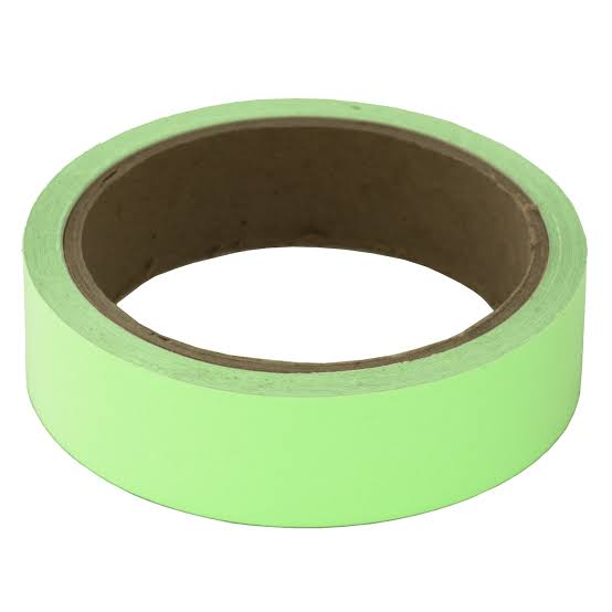

Have you ever used that DELTA fluorescent tape? Says it can be used with color??
I wouldn't trust anything like that without testing first. It only glows awhile anyway. And I have to be extra careful if unexposed film is handled in the same room. But what I have successfully done with that kind of tape is take a regular 1/4 inch paper punch and make little dots of it to individually apply to things like light switches or potentially risky counter corners etc. I've never experienced fogging to either film or paper when using it in that tiny of a manner.
