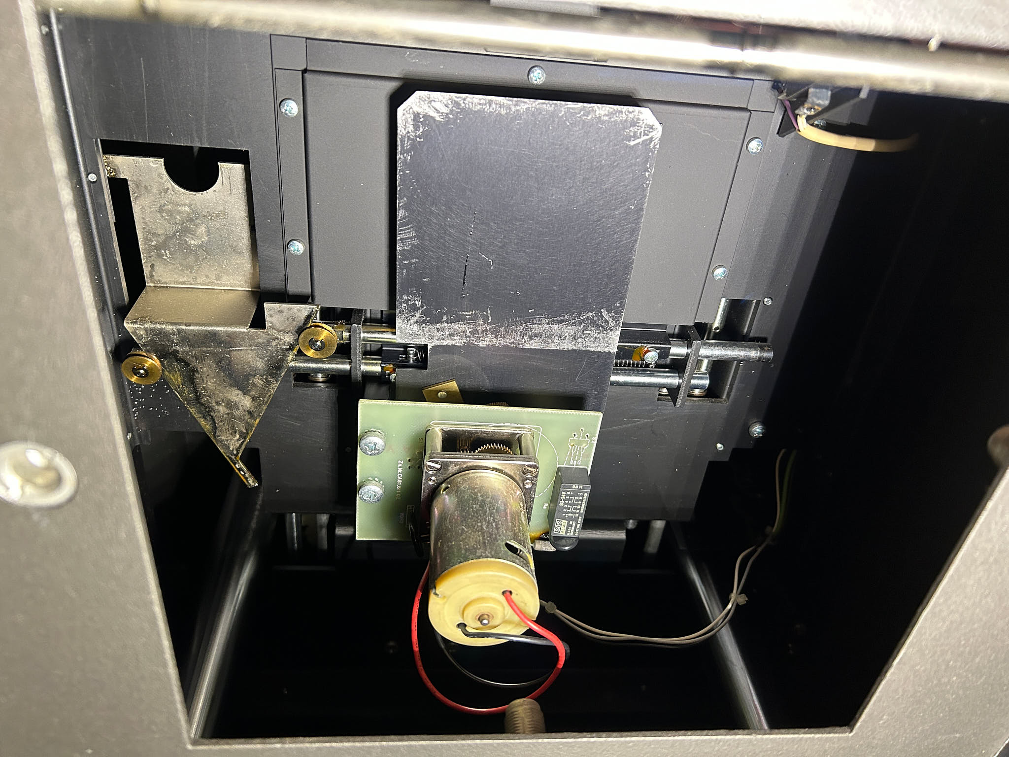

I'm pretty sure on mine it was from the shutter jamming. When I got mine the shutter was disconnected and left open. I repaired the shutter and replaced the resistor, and it worked fine, nothing else was damaged.

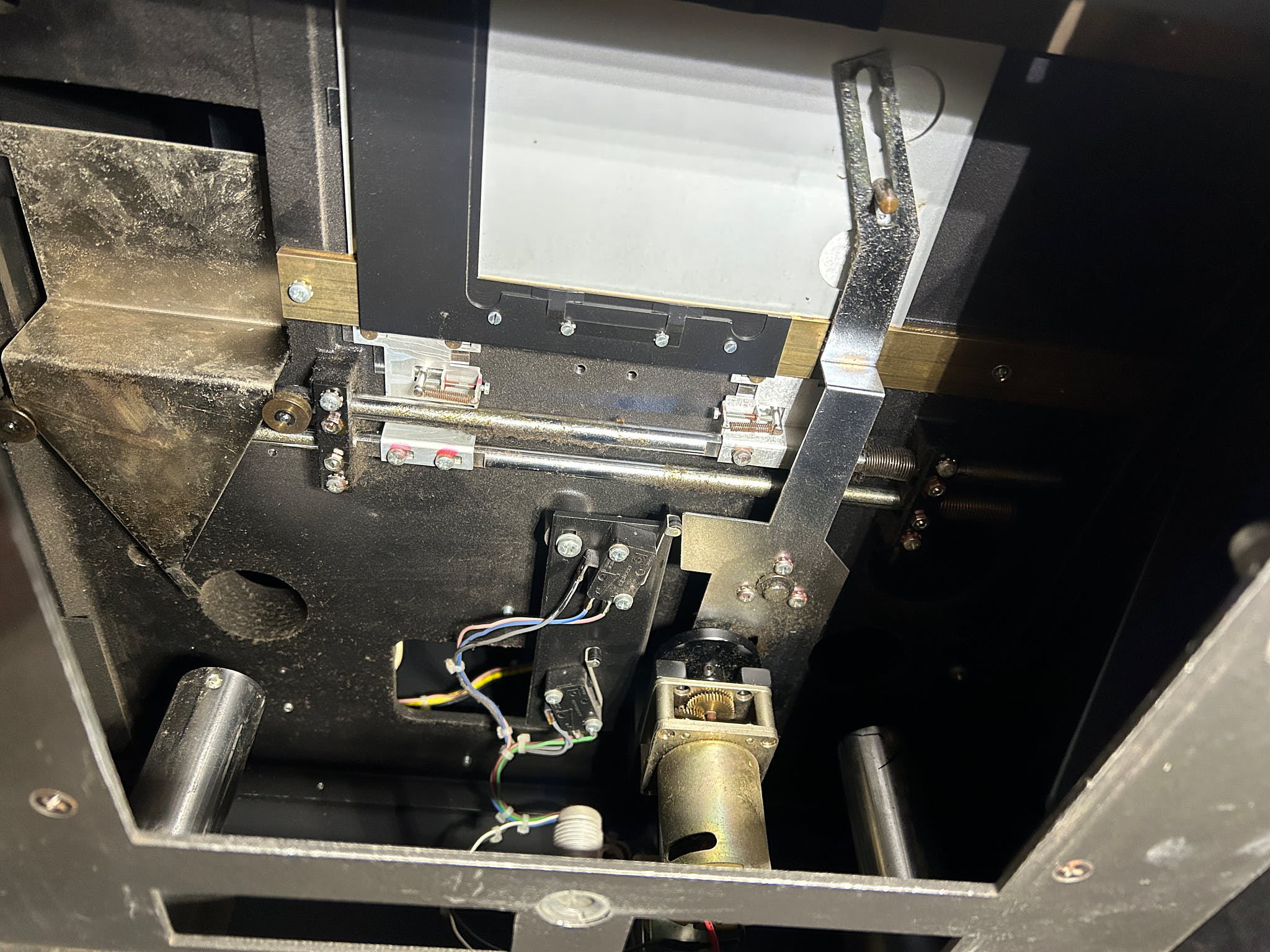

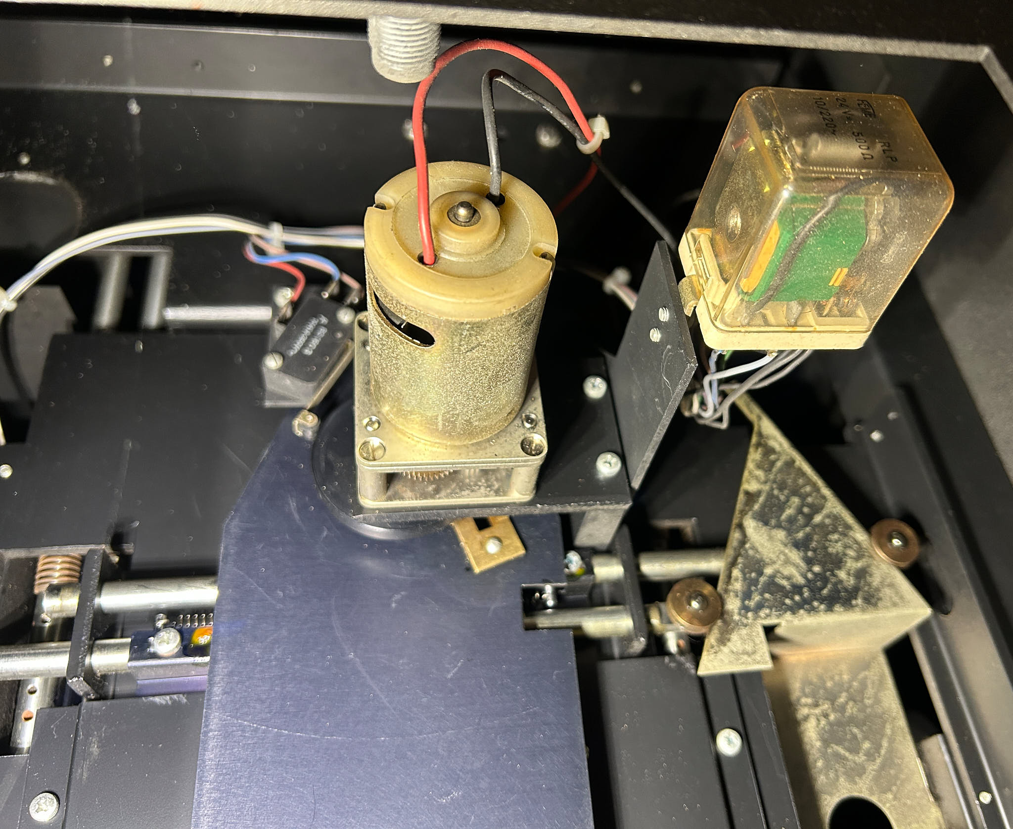

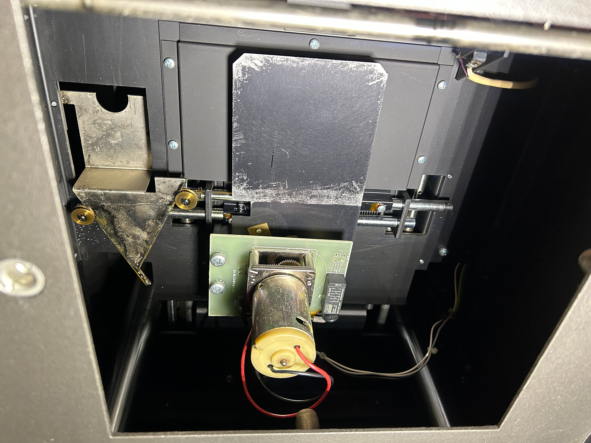

Here is the shutter on my 2000. I wonder what Gary's looks like.
Al three are different. Last picture is from my spare parts.

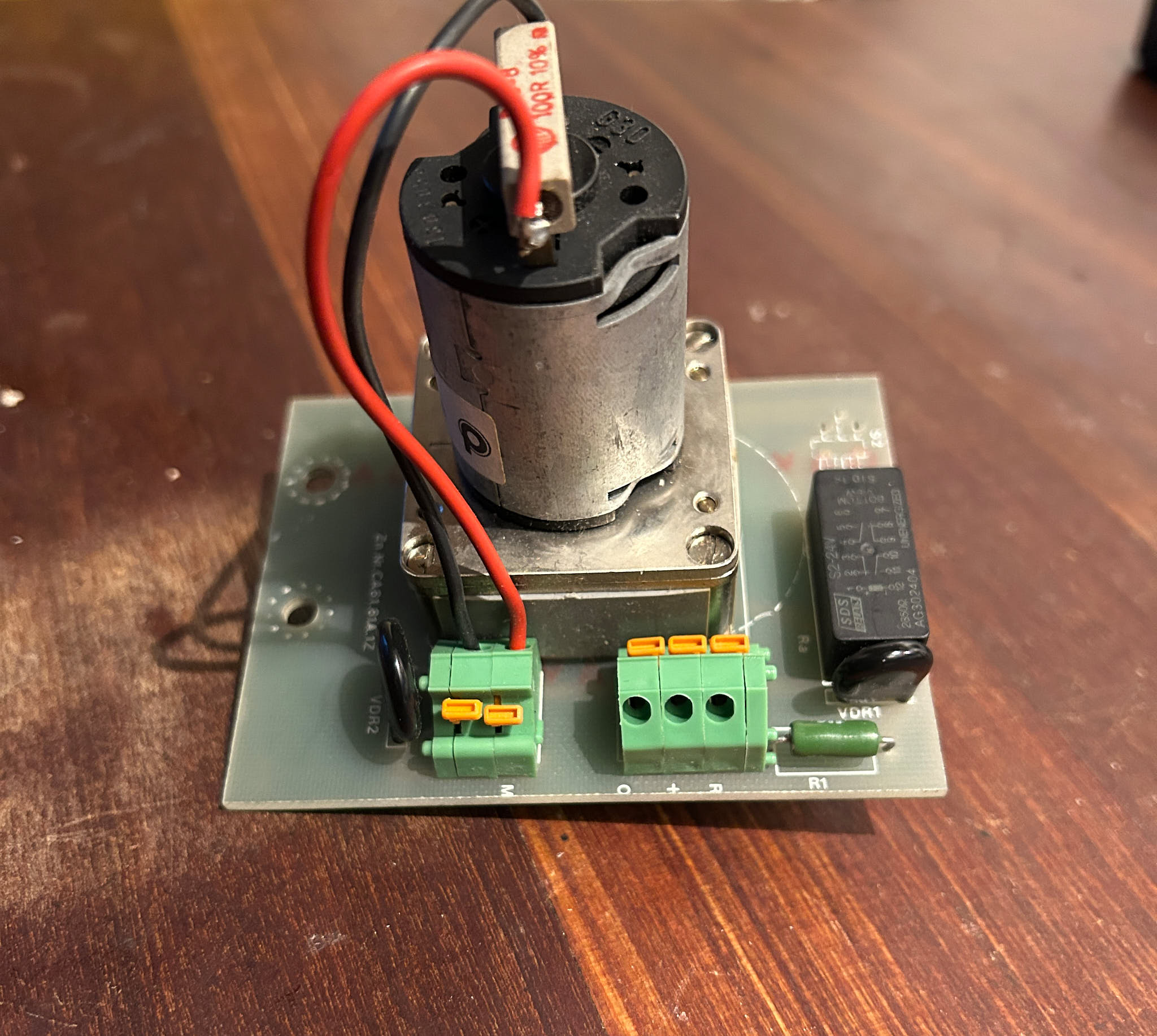

Been working on the enlarger today.
It seems like the shutter is a very simple mechanism. You have 3 connections. Two are - and one is +. Once you connect the second -, the mechanism will do one movement, opening the shutter. Connect it again and it will close the shutter. This is controlled by the 24v relay mounted on the old-school PCB board. My friend and I will write some code to calibrate the shutter precisely. Well, if it's necessary, that is.

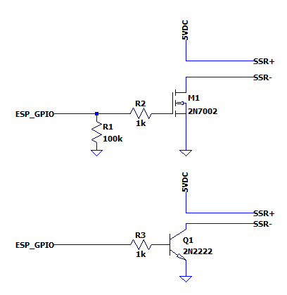

We figured out that we had to use some mosfets in order to control the ssr relay. It seems like the esp can not output enough amps to trigger the relay. Still a bit puzzled, but we will get there.
Hm, that doesn't make all that much de de really. An SSR typically has a logic level input; it doesn't draw any appreciable amount of current.
We are a bit puzzled :D Maybe it's just an oversight we were not yet able to entangle.

So it's a generic SSR40DA relay; the big question is whether there's a datasheet available. Probably not, so some measurements could be taken, although it's probably easier to just forego that and simply hook up the relay through a small signal mosfet (BSS123, 2n7000 etc.) or even a small NPN and run it off of 5V instead of the ESP's 3.3V logic level.
Thanks. Confirms that use of a 5V microcontroller is less complicated.
Koraks, thank you once again!
Yes, we will probably ditch the SSR and switch the fan using the other relay board we also installed. It can handle the load and works fine with the esp's signals.
Depends on how you look at it. ESP-series uC's are more flexible and vastly more powerful, so things like multitasking (which made you consider adding a second controller for) are relatively easy to implement. On the more basic 8-bit AVR controllers, it takes a little more ingenuity to get that done. On an AVR, you have to arrange something with periodic polling of tasks or perhaps using timer interrupts if it's really time critical. On an ESP, you can simply create multiple tasks that the operating system will then balance for you without having to worry about it.
As always, it's a compromise.
Yeah, I would have expected the SSR you have there to do fine with 3.3V signals. But again, it depends on the specifications, which may not be easy to find for generic components like these. I personally prefer to only use parts for which I can find a decent datasheet. Most DIY-oriented relay modules (SSR or otherwise) accept logic level inputs regardless if they're 3.3 or 5V.

One thing I see different is that in my CLS2000, the lamp pre-warm does not eminate any light.
