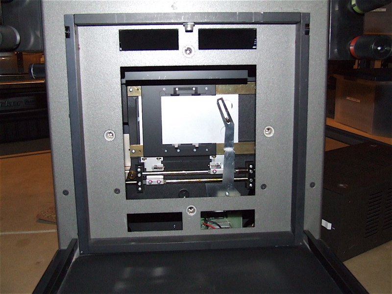

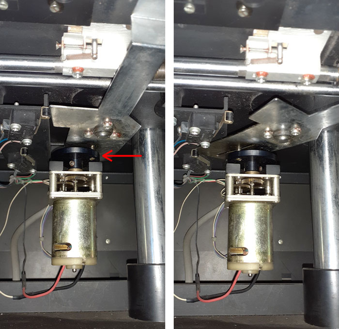

There were at least two different types of shutter mechanism. In one case the microswitches contact a rotating cam. In the other case the microswitches contact the actual lever that moves the shutter. You should be able to look up there and see which kind you have. They should both function the same. The logic function of the two micro switches and the relay is not outlined in the service manual I have. You might have to figure it out for yourself or see what Gary knows about it and how he programmed the shutter motor function via the arduino.
I see, I'll have to see once the power supply is ready to be moved into the darkroom for further testing. But it doesn't look that complicated. :smile:
Thanks for the photos!

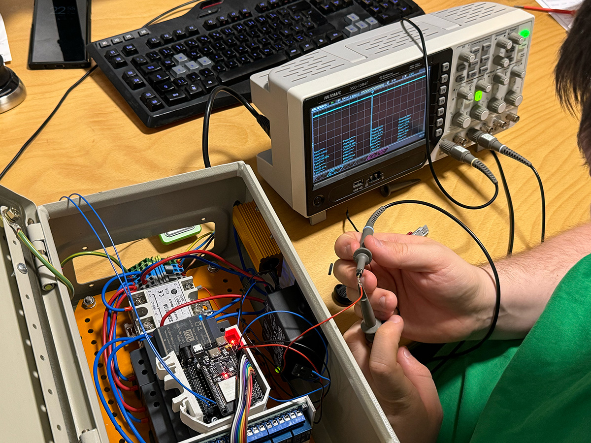

The picture is wat happens across the 22 ohm resistor in the startup fase.
The challenge is to not trip the safety circuit of the Kemo power control. It’s a very nice feature of the Kemo. It saved me and the Kemo more than once. But also very vast. It will trip almost immediate when the current exceeds (10A ?) only for some milliseconds. Despite the output is only 16V RMS it still peeks at ± 90 V. After all it’s just a PWM signal. 22 Ohm is just enough to keep the current under the tripping level.
The resistor will naturally not come to a fully developed thermal flow but I like to be on the save side. The potential over the resistor peeks at 28.5 volt rms in the startup phase. The potential over the resistor is not the same as over te bulb. Once the bulb has the minimum temperature keep it there for the time the unit is turned on. You don't need the resistor after the initial startup.

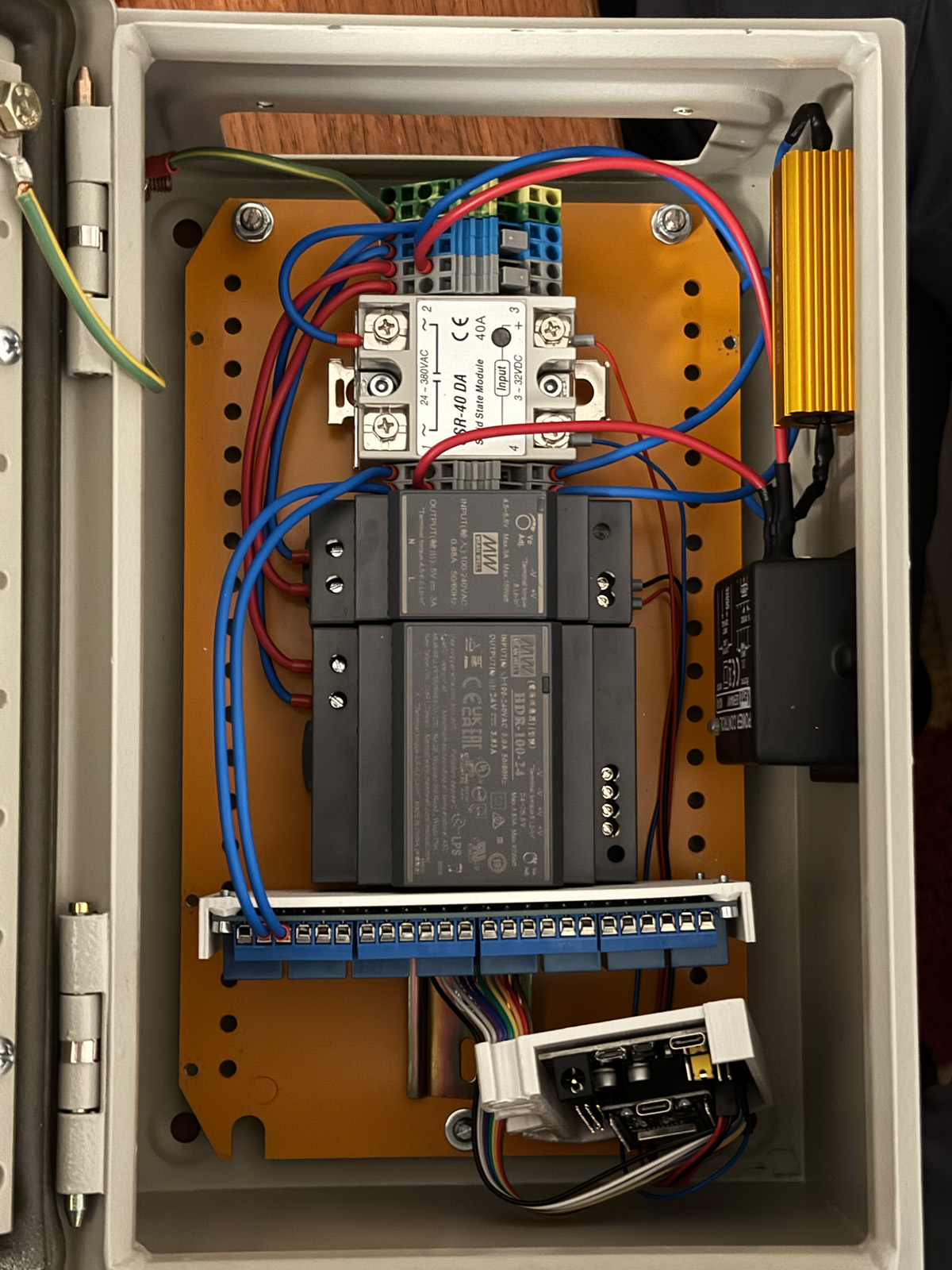

Update on my power supply build.
My friend Angelo and I started the build today. We found an old housing that is of high quality and perfectly suits our needs. I will have to laser cut or 3D print an adapter to fit the old Durst plug. I ordered all the parts with the idea in mind (well, actually my friends' idea) to fit them on one of them norm mounts for electrical installations. This has worked out nicely. We 3D printed some holders for the ESP32 and the relay board. This way, everything fits neatly into the box.
We started writing some simple code, thankfully my friend Angelo has some experience with this, and I didn't have to start from 0. We already did some sketchy tests with the lamp. I adhered to what Gary recommended and everything seems to work fine. Next time we will have to move to the darkroom in order to look at how the shutter and fan need to be wired up.
After that, I will start designing the timer and it's functions. I will most likely also switch the electrical up- and down movement of the focus and enlarger head to the timer in order to fully remove the huge original control unit from my tiny space. Derek, from Dektronics, has a really smart feature that displays the Color head filter settings, when dialing in the normal contrast numbers, in his printalyzer timer. I want to include that, an f-stop timer with fine increments, as well as a test strip mode. Maybe also some communication to my LED red light.
I am quite happy with the results thus far and will post and update once done. I'll also share all the links, code and so on collected on a webpage (my friend recommended github) for everyone to use. (If there is interest)
Thanks again for the continued support and lovely help you guys have provided thus far :smile: I appreciate it.

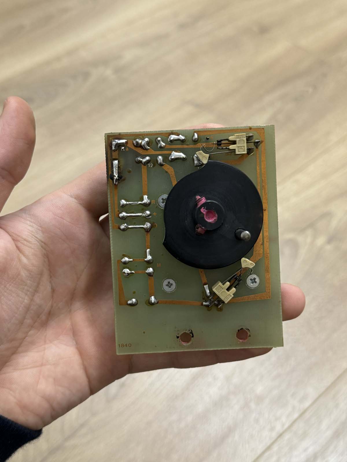

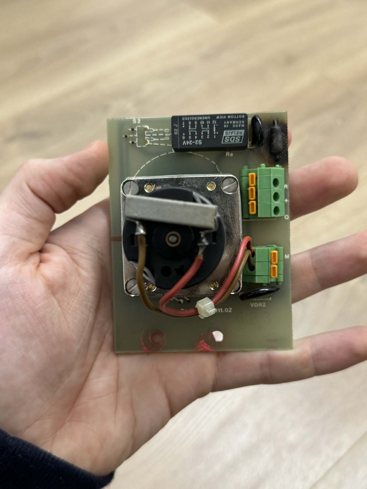

Some more images for people of the future who might need them :D

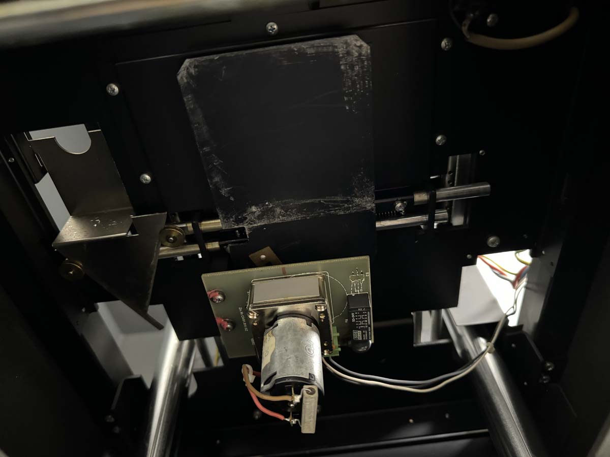

The resistor on my shutter motor board looks cooked.
The shutter is just an off center pin on the motor, that fits into a slot on a piece of metal, that is mounted on a hinge.
I once had a really nice iris shutter that was in my Homrich VA250. That would've been a pleasant upgrade. Unfortunately, I don't have it anymore.

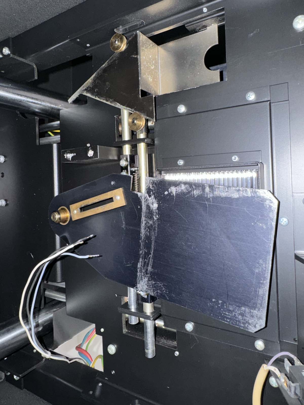

Here is the shutter on my 2000. I wonder what Gary's looks like.
