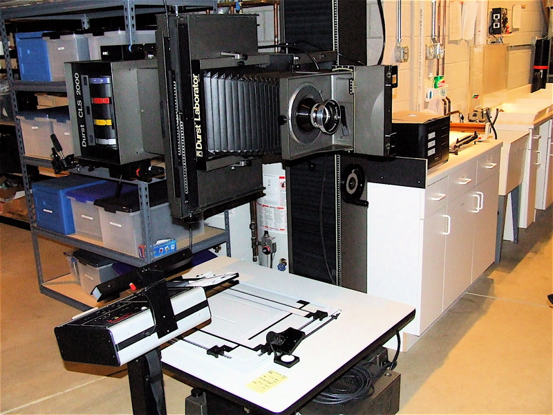

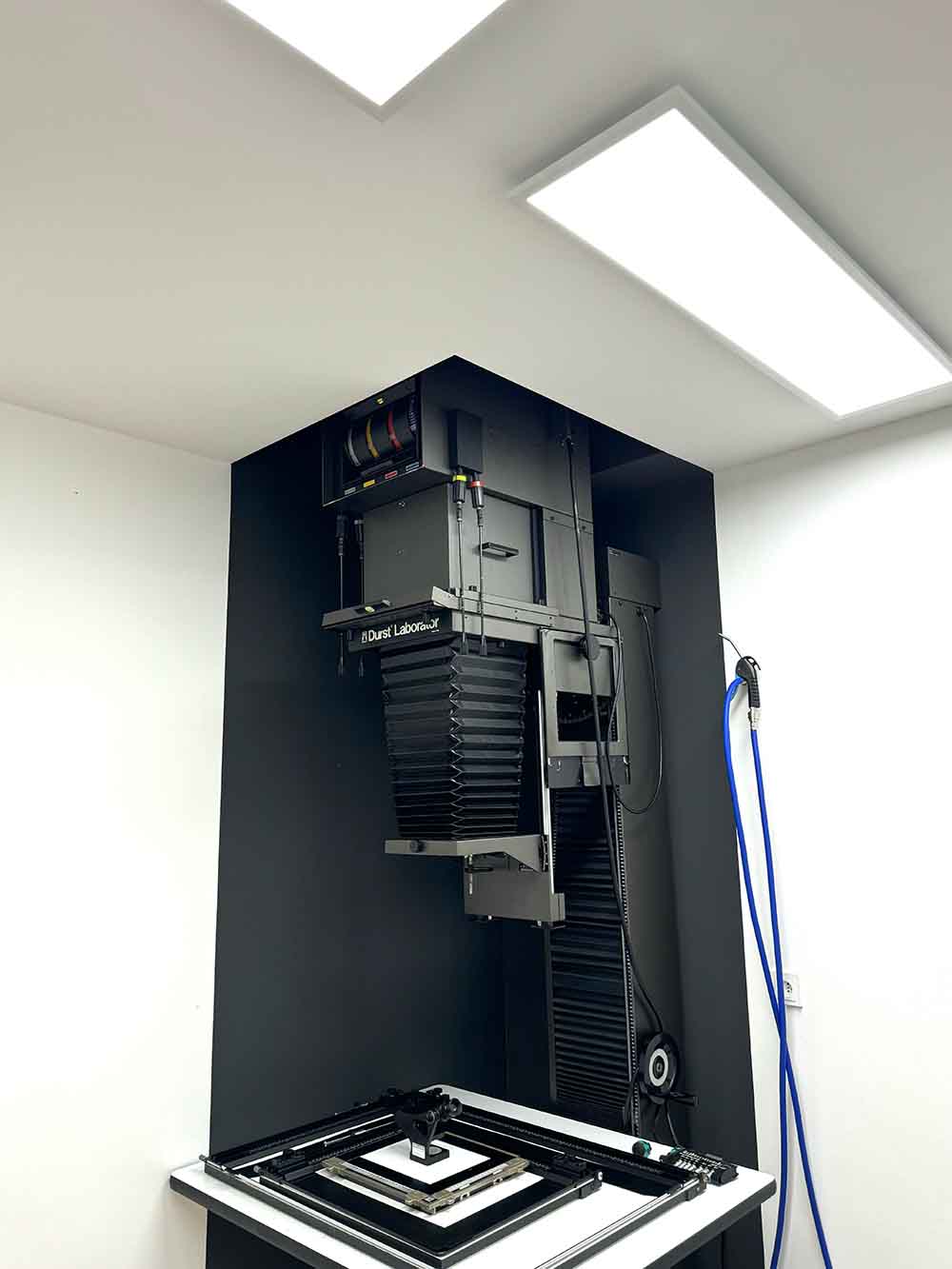

Dear photrio community,
I am in the process of finishing my new darkroom space. Before starting to redo the room, I got my hands on a Durst CLS 1840. The whole darkroom is based on this unit and I plan to use it for the rest of my life. I am reaching out to you since I face a couple of problems.
1) I need to find spare 1000W bulbs for my unit. One 750W bulb is installed and that seems to be working fine, but I am sure it won't last forever. Could anyone provide me with a contact that might be able to sell me some?

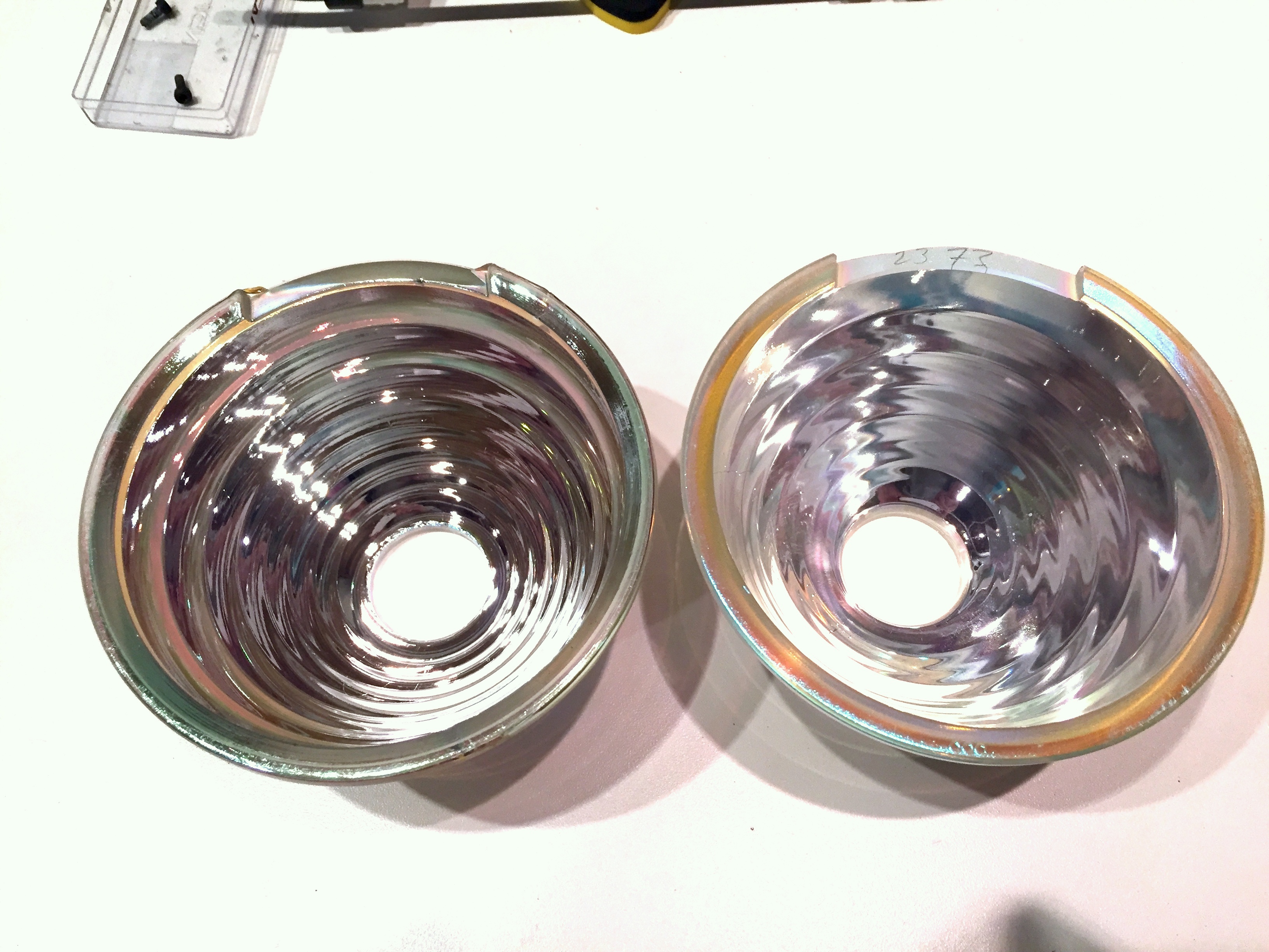

2) The reflector in the unit seems to be quite damaged, it flakes off lots of little glasslike dust. Is there a cheap way to get a new one? There is a seller that sells them for almost 400 bucks (incl. shipping) on eBay. I am quite unsure about paying such an amount of money when there might be an alternative.
3) My EST 1000 Power supply had the two paper capacitors blow up. They stank like hell. Any ideas why both the capacitors would fail at the same time? (The 6k ceramic fuse also got extremely hot)
I am thankful for any tips you could give me! All the best! -Rene

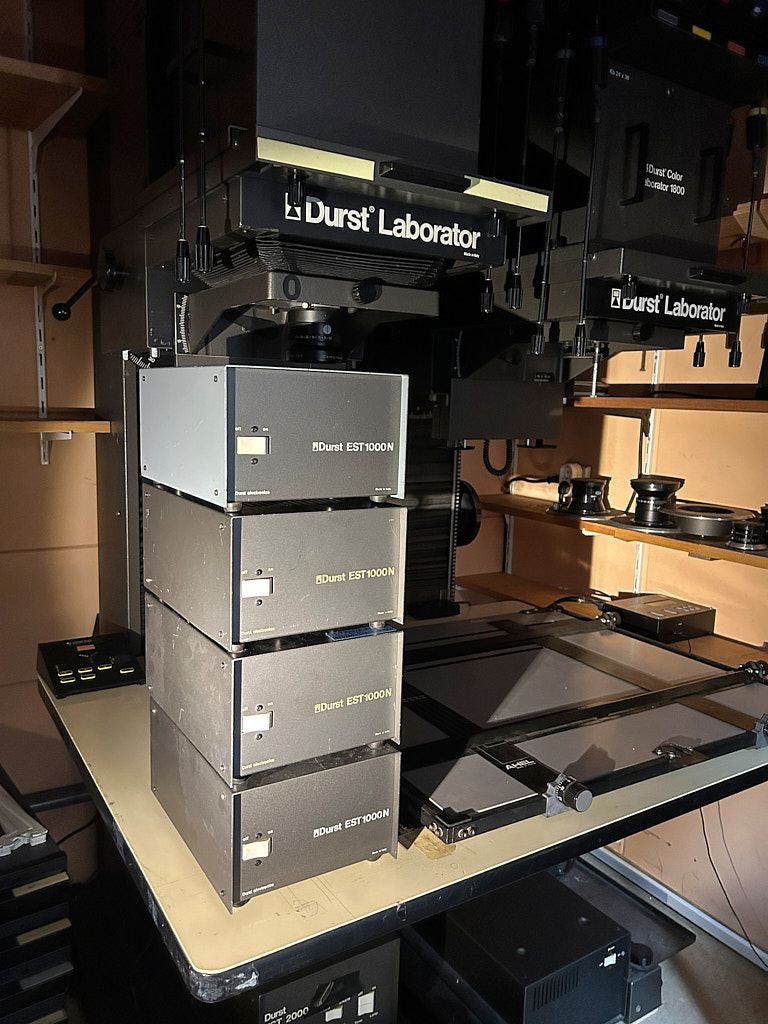

Great setup you have there!
A while back one could get replica reflectors from Russia. That was before the current political situation.
I have the 2000W head on mine. I don't know much about the 1000W lamps. There are a few alternatives I know of for the Thorn 2000W lamp, however.
Not sure about the power supply, it depends on which capacitors. Do you have the service manual?

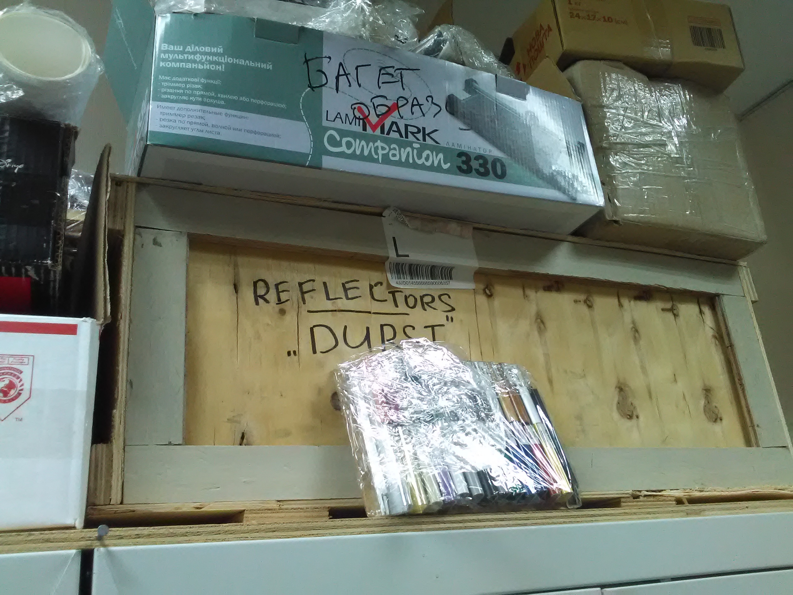

Is there any chance you could forwoard me the contact you had in Russia? I might be able to get a couple reflectors smuggled and distribute some here on the forum.

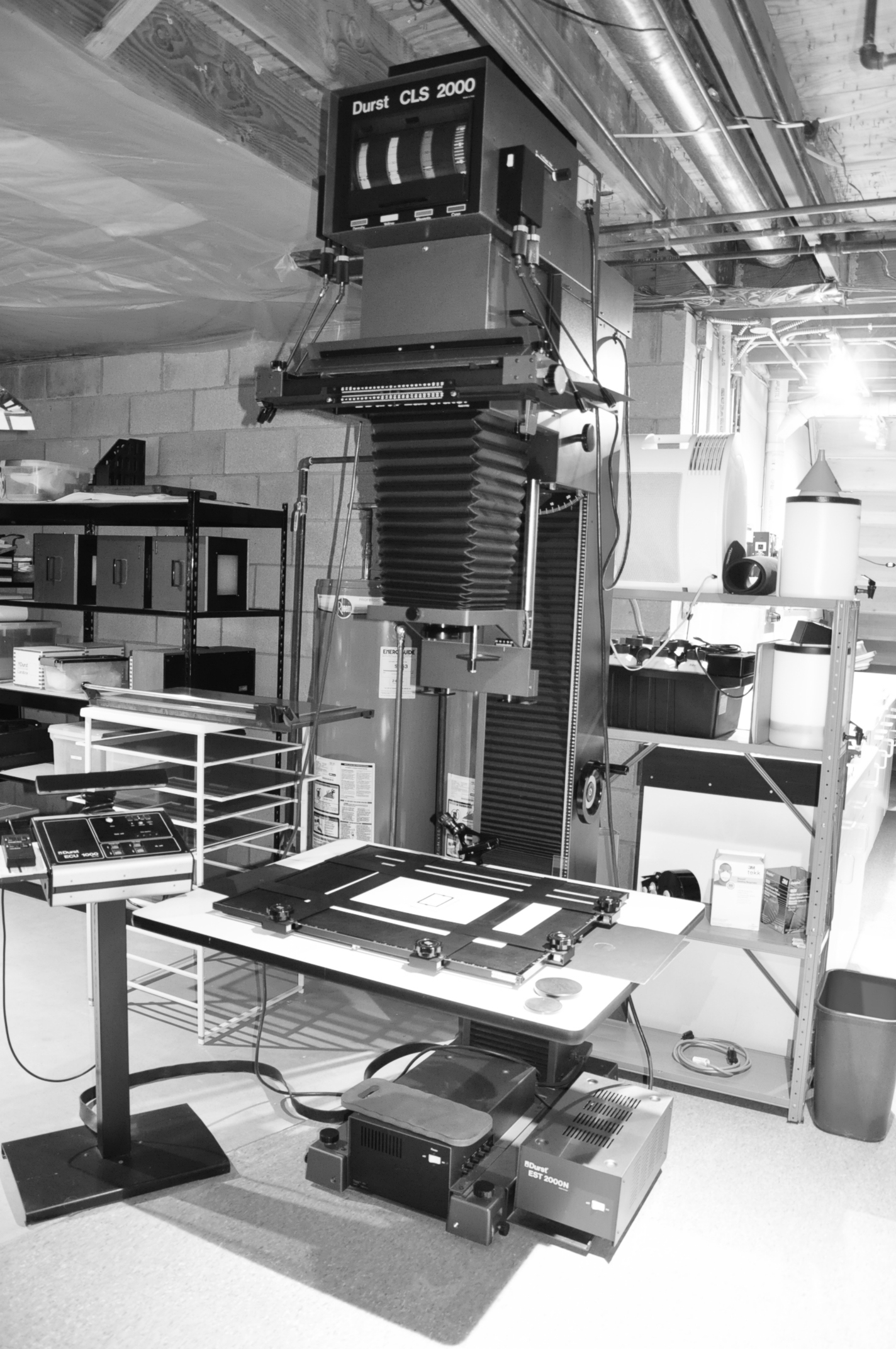

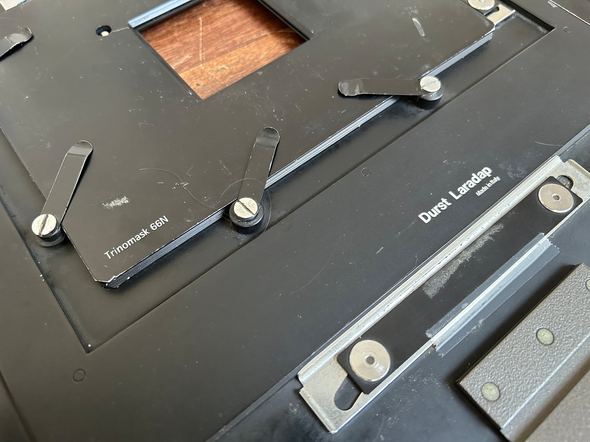

This is awesome, almost the same setup as I have. What kind of negative carrier is this? Do you use this professionally or is this your personal unit? I also have a full set of spare Light mixing boxes (Altough the ones I have might have been for the vertical 10x10 unit Durst made.) Also I have one more question for you, I also own a set of Trinomasks, the ones that are intended to be used without glass. They do not fit my normal 10x10 holder. Do I insert them instead of the glass? The holders a slightly smaller than the glass insert area.
All the best!
The Trinomask’s fit into the Laradap. The Laradap replaces the glass in the Rapidinsert. The top part of the Rapidinsert will not be used in this configuration.

My negative carrier is the Negateil. When the enlarger is used for horizontal projection, the Negateil can shift the negative vertically. This allows multiple horizontal strips of 50" paper to be exposed and later spliced into a massive mural.
With the 2000W head, glass/glass carriers are usually needed as there is a second blower that blows right on the negative carrier.
I repaired two power supplies for the base (EPU1000) and two for the head (EST2000N) but only ran into faulty transistors or resistors.

The reflectors are mentioned in this thread:

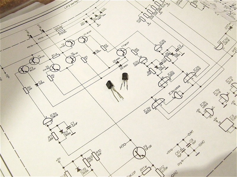

I also noticed that two transistors were colored weirdly. It seemed to me that they might have been damaged. I will most likely also replace them when ordering new parts.
Thanks again for redirecting me to the thread that mentions the reflectors. I'll try my best to get some. One of my employees is originally from ST. Petersburg and I am sure he might be able to pick some up for me when he visits family again.
This is deceptive; usually, there's no visible damage to transistors that have failed in this kind of device.
Ok, I see! Excuse myself, my knowledge about these things is limited. :smile:
I just made an appointment with my friend, who is the electrical engineer, and he agreed to check the device and swap the parts for me.

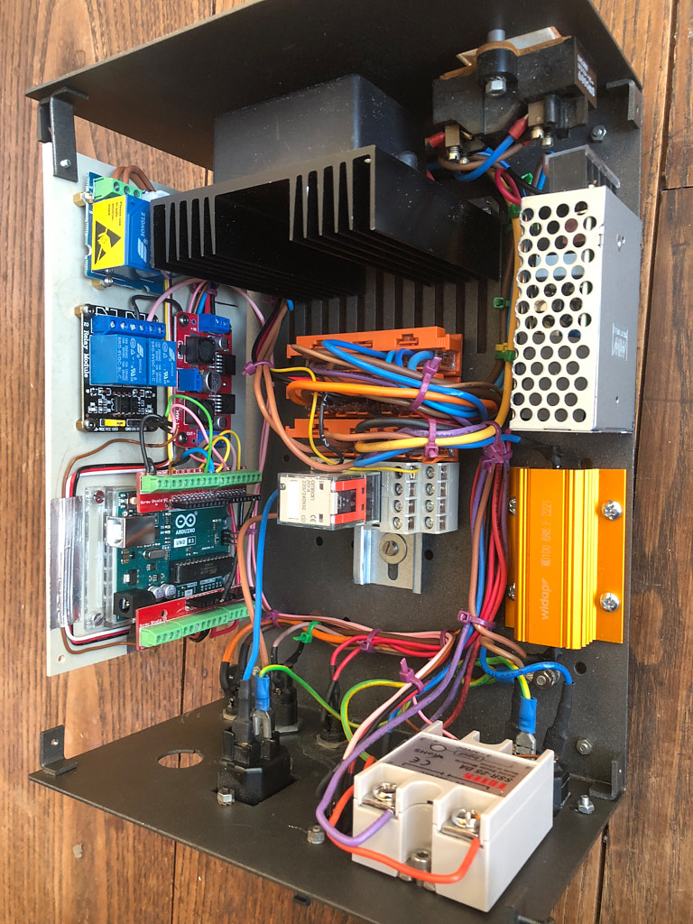

The EST 1000 Power supply’s are notoriously unreliable. I stopt repairing them. (For my own usage). I replaced it with a a generic PWM-controlled thyristor dimmer board and a micro processor.

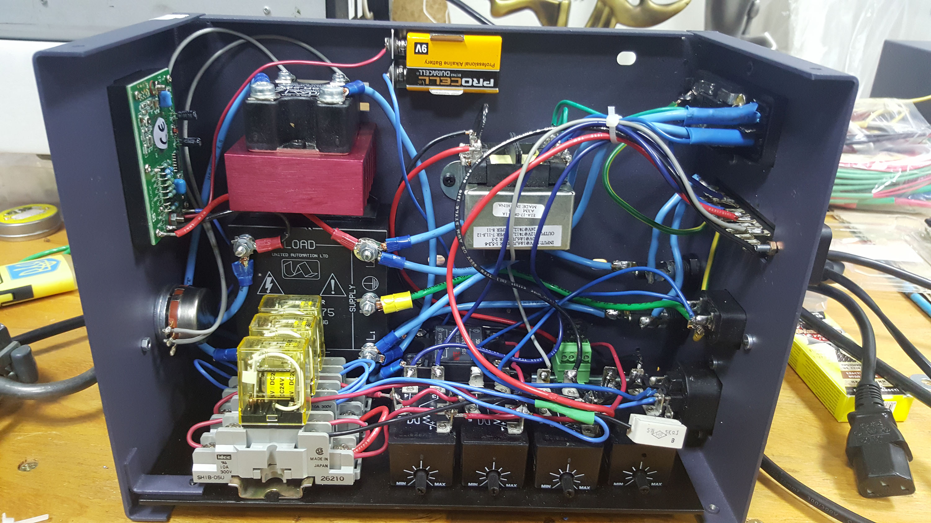

gary, I don't think I have seen a picture of that setup. Two heads and a single baseboard??
There was a thread a while back about reverse engineering the Durst PRO EST1000, but it looks like you have come up with your own design?
Image: Durst Pro EST1000 Replacement Internal Photo
Yes. I was’t aware that I had already been done. But the Arduno I use can controle the PWM-thyristor dimmer board. By adding a light sensor it’s possible to make a closed loop light source.

Gary, that looks amazing. Can you, by any chance, elaborate a bit on what the functions of your own build are? I am unsure what kind of different functions this unit even supports. In my mind, driving a 1000W halogen bulb shouldn't be very complicated. Excuse my, maybe idiotic sounding question, but an answer would greatly help me understand the unit and would allow me to communicate better with my mate, who's going to fix it.
The EST provides these basic functions to the head after it recieves an ON input from the timer:
Power and timing of the fan including a thermal switch
Regulated power to the lamp, (including low idle current when off)
Power to the shutter and timing for opening and closing
I think that is it, but I hope Gary chimes in with a more detailed description of his masterpiece!

That sums it up nicely. Except that the CLS1840 don't have a thermal switch. Maybe not that evident it also has to make sure that te inrush current from the bulb is handled in orderly manner. The cold bulb resistance is less than 1 Ω ! And also turning off the blower introduces a lot of electronic noise. These two aspects are not very wel addressed in the original EST 1000. Maybe causing the premature failing.
What I left out of my design is delaying the power down of the bulb making it not necessary for repeated powering up the bulb while making test strips in the usual manner. But that’s a software matter in my design. I do not make test strips in the traditional way.
