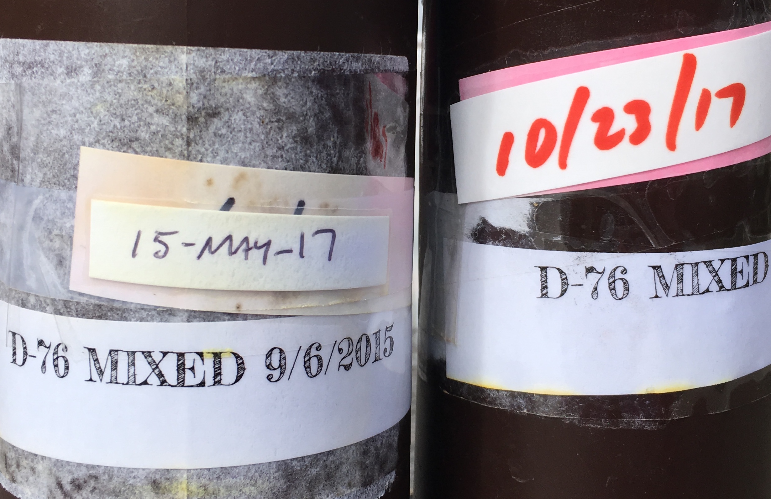

I mixed up D-76 on six occasions from September 2015 until now. (The pink label is dated 5/7/16).
I forgot to label this batch I am about to start using, which was mixed about three weeks ago.
So I kept the stock for 8, 12, 10 and 5 months... (can you tell I just played catch-up?)
Never any problem with it. I suppose I could produce a scatter plot of aim versus actual contrast versus developer age... Because I have a fair amount of sensitometry in the mix... and I note date mixed on my film runs.
