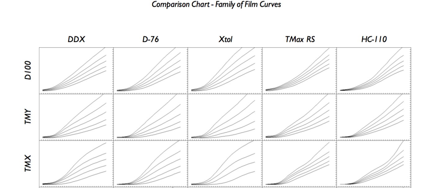

I have studied the film curves and the effects of DDX, D76, and Xtol when used with TMY. Very impressive. Really impressive. Xtol seems to be the champ as far as developmental latitude goes with D76 and DDX not far behind at all.
Interesting graphs. I studied TMX and TMY-2 in D-76
My TMX family curves do not imply shouldering at the higher contrast index, as this series implies. My curves indicate long straight line sections are achieved at all development times.
What dilution were you using? That could have an effect possibly.
1:1 for low to normal contrast then switched to Stock for the high contrast curves. Here’s my TMX family...
