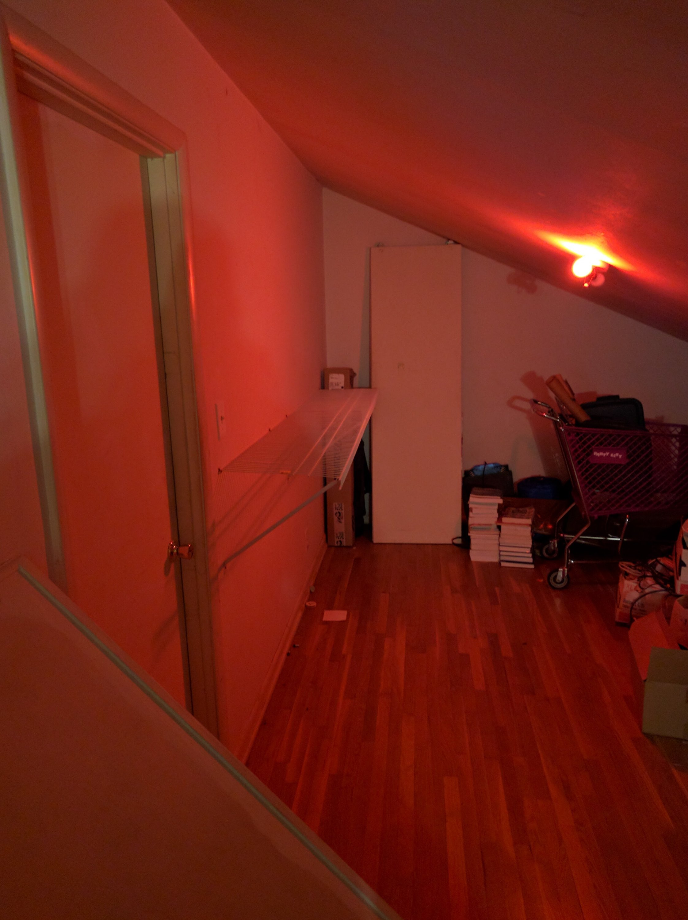

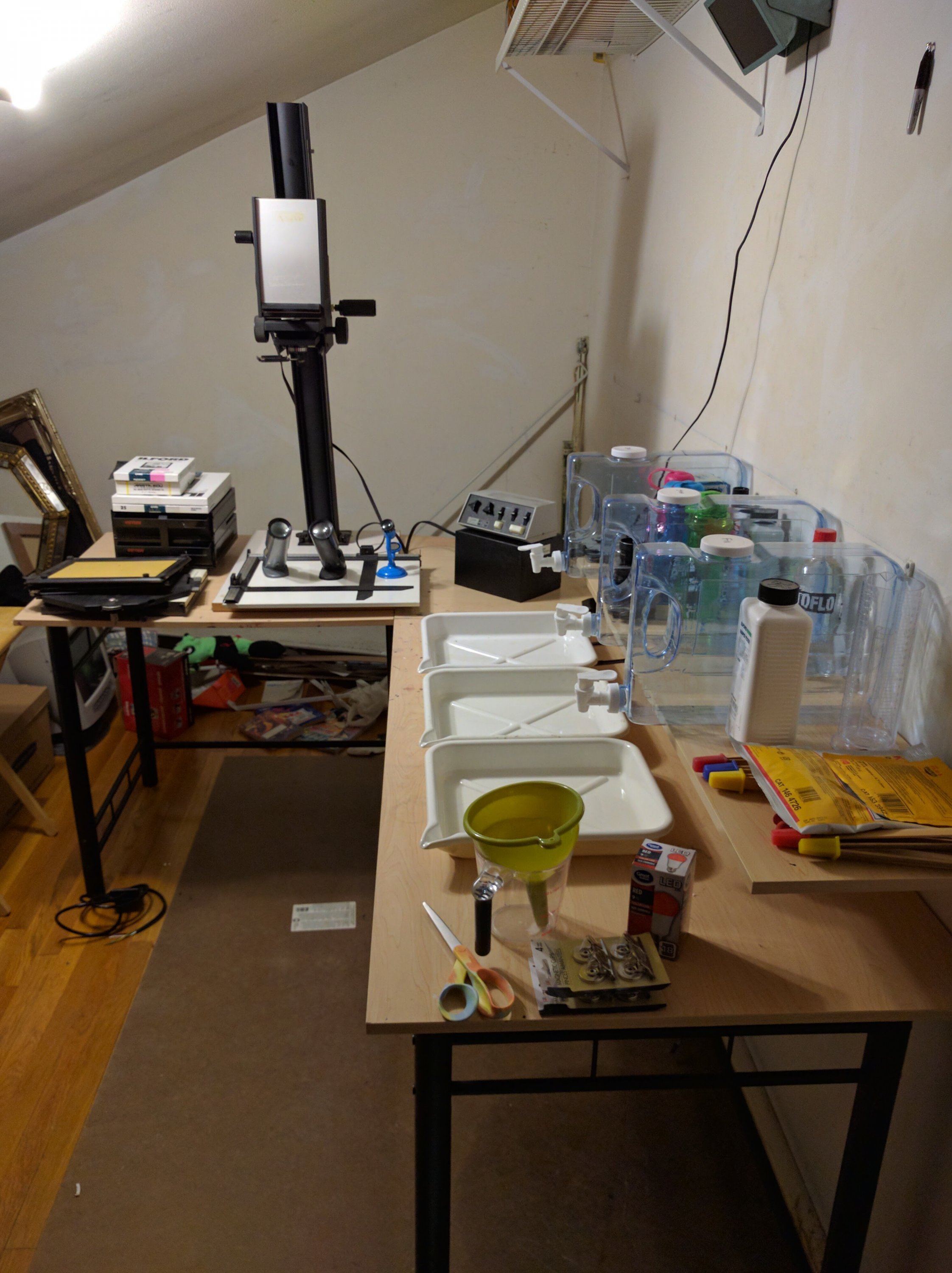

Just finally got my own darkroom set up. It's in a weird attic space that has no windows. Has no running water either, but I'm making do so far.
Found these awesome dispenser bottles at walmart for <$5 each which are great for storing chems between sessions and make it easy to dispense out into my trays.
On the other side of the room, I have some wire shelving up on the wall to put prints on to dry.
The bulb over there will fog paper if it's close, but after 15 minutes with it on and paper out where the trays sit, I get nothing (quarter test). It's at least helpful so I don't trip over the box above the stairs (bottom left) while I transport prints to dry.
Dear ratmandu,
A really nice space. Much nicer than I have ever had (although my water access has been better). Only one question. What are you saving that CRT for? ;-)
Neal Wydra
Wow, great space, sink, and enlarger!
I notice fluorescent lighting overhead. Is here an fluorescent glow after the lights are off?
(I had this problem with a fluorescent replacement of an incandescent bulb that I tried.)
Dear ratmandu,
Neal Wydra
Hah, not really saving it for anything, just too lazy to drag it down the stairs at this point.

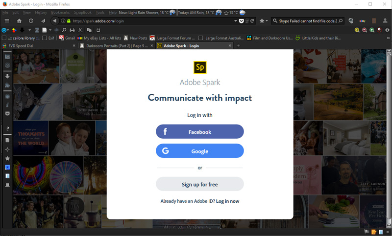

You really should post you pics here or to a readily viewable site. I have absolutely no desire to sign up to another site I'll never visit again... cookies and all.
UHHH its not a website
its a spark page I created of my darkroom build no need to sign up ?
I have neither FB or Google accounts. I may be missing something obvious though. Forest for the trees thing.
Hi Martyn,
Welcome to APUG! :smile: I'm afraid I, too, got redirected to a log in page. Perhaps if you sign out of Spark and get the link to your images from "outside" the site? Hmm, sorry, poorly explained, but I hope you can figure out what I mean. I've never used Spark before so I don't know my way around, I just know that some pages have different web addresses if you're signed in than when you're not.
Here's the page I got and which choiliefan probably got also.
If you're having trouble uploading images directly to this thread, I'd be happy to give you access to my Photobucket account? The only action it's seen in the past decade has been when I've "loaned it out" to another APUGger to use here, so don't hesitate to yell if you'd like to use it.

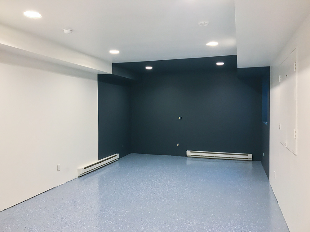

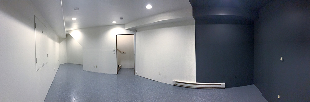

I'm super excited to start my build, closed on the house about three weeks ago, just finished the interior painting, walls, ceiling, floor and enlarger cove.
It's a bit over 450 square feet of usable space, ceilings are 8' foot 7" and the enlarger cove is about 14' feet wide so it will have an LPL4550 XLG on the left and right side, right side will be wall mounted with custom drop table and in the center will be an easily stowed wall mounted / horizontally oriented geared 4x5 camera converted to a mural enlarger. I have 15 feet of stainless steel sinks going in the wet side along a 33' foot wall but it will all be knit together to form about 22' feet of wet workflow area for a specially designed mural paper processing system. I am adding grey-blue vinyl baseboard this weekend, painting the can light trims "Jobo Red", might stencil sprocket holes along the edge of the grey paint for a fun effect.
Lots of things to do, plumbing re-route, drain, silver recovery, ventilation....
It's taken 12 years this month to get here, but finally, this next chapter of my career gets to be fully realized.
