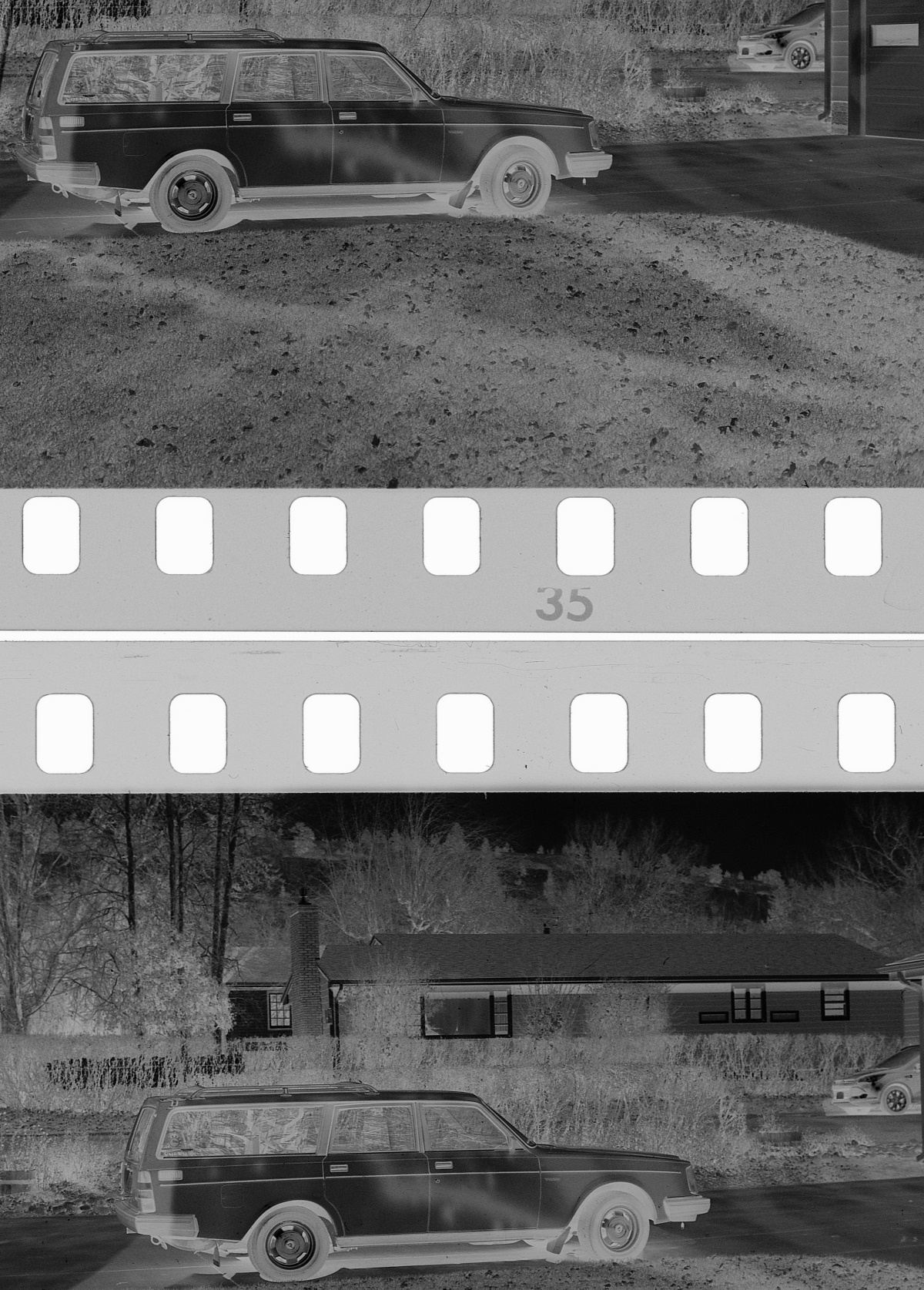

On a recent flight to Mesa, AZ I repeated my previous non-scientific experiment that I mentioned in post #83 with a bit of a change. I shot about 12 frames of HP4+ and cut the roll in half in the darkroom leaving one half rolled back into the canister and the other loaded into another metal canister. I put this in a plastic container (Kodak, I think) and tossed this into my backpack that went through the scanners in Billings and in Mesa. Upon my return I loaded both strips of film onto separate reels and developed together in Xtol for 8 minutes. After drying, I put the strips side by side in a medium format holder and scanned with my Epson V500 and reversed to negative. Here is the result. The top strip is the one that went through airport scanners. Visually there appear, in the clear areas, to be a slight higher density in the top strip. I used a tool in a paint program to measure the density difference and there was about a 5 point difference on a 255 point scale. The upshot, for me, is that this file, as ISO 125, is not impacted (much) by going through these scanners.
As an aside, I have TSA-Pre so only have to go through the metal detector which is never a problem. However, in Mesa I was “randomly selected” to go though the full body scanner. I set off an alarm as that machine detected my medical implant. (It’s made of silicone with a VERY small part of titanium and is in my groin. It’s an AMS800 for those curious.) They told me we should go to a private room. I asked if I had to disrobe and was told that I didn’t but they were going to do a very intense pat down in that region. I told them to just get on with it. They did and I passed but wondered what do you tip for that kind of attention. ;-)
Yes, I see it, and the Lab readings on the digital file confirm a slight difference. It's not something that would show up in the images unless they all occupy only the toe of the film curve and are boosted extremely heavily in printing or digital post processing.
