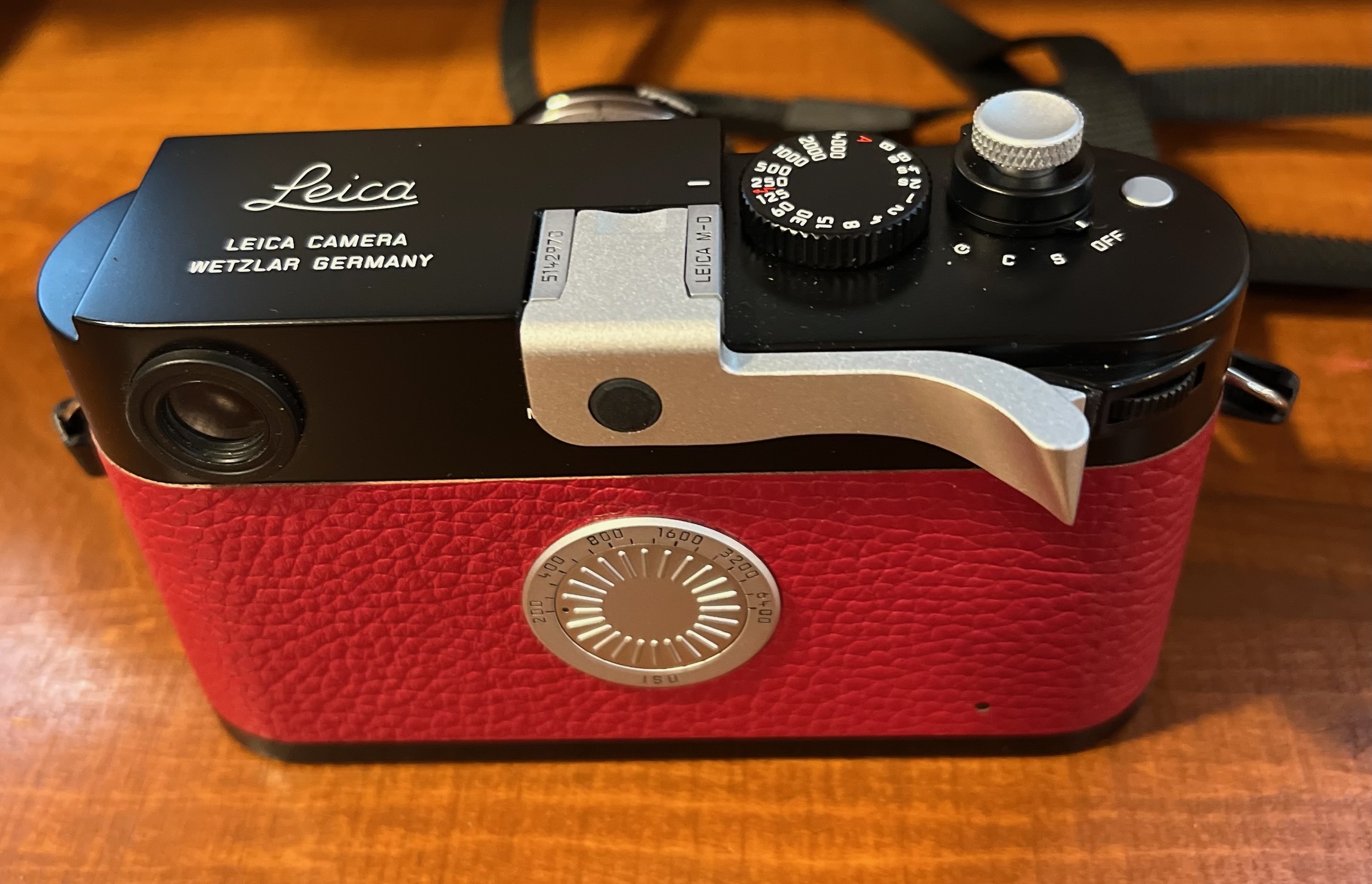

My X-Ray proof camera!
Especially made for international travel…!
