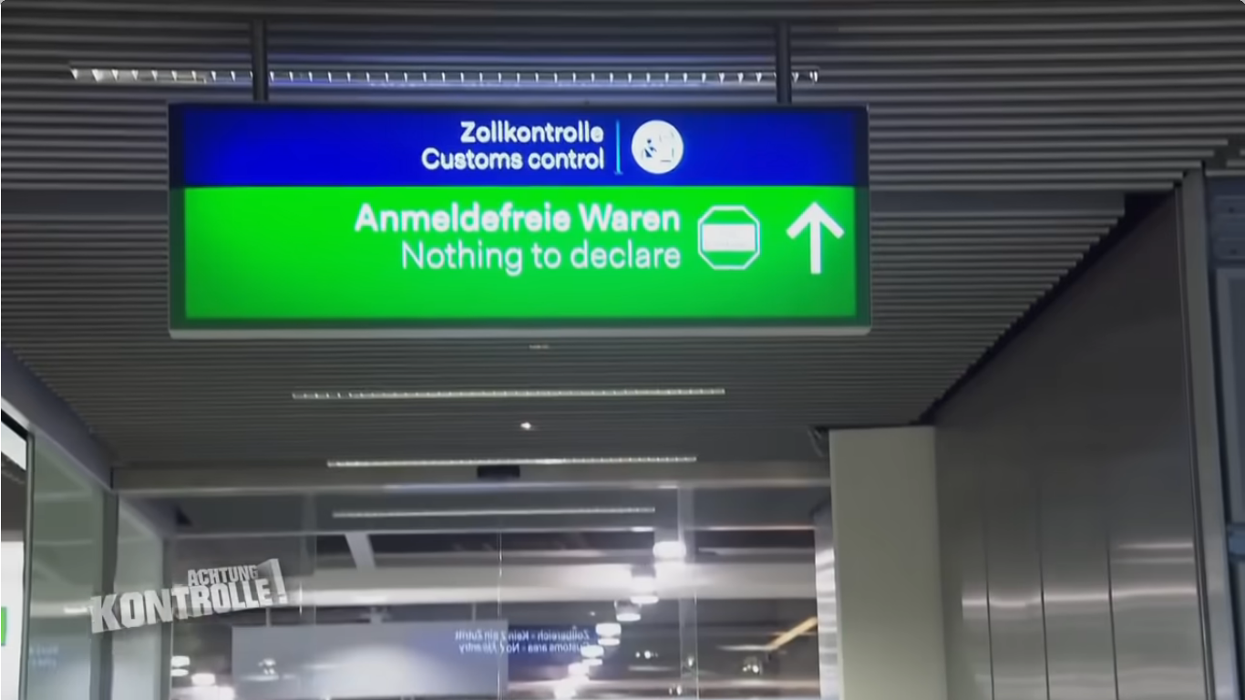

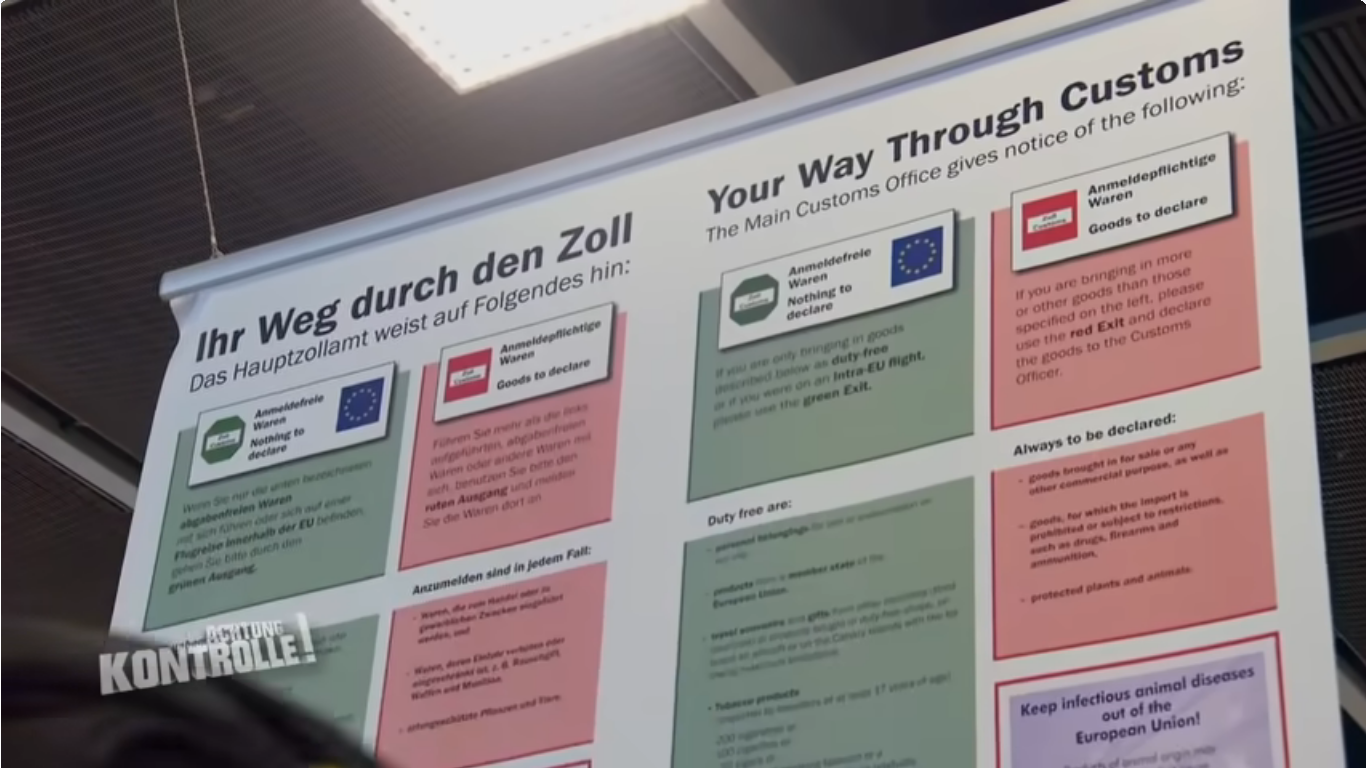

At german airports you have the choice to go through customs or not. Passing them means you state you have nothing of fiscal interest with you.
Should for any reason at passing you attract the attention of customs officers, or just end up in a sample and then it should turn out that you nonetheless got things of fiscal interest with you, you are charged for intentional tax evasion.
You will be fined for this and loose more money than having approached customs directly.
Here a respective board above the baggage belt:
Here a resp. pathway:
