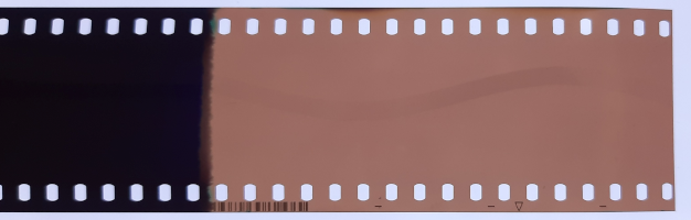

Well, I ran into a rare case of visible x-ray fogging despite the roll not having gone through a CT scanner - just two (2) old-fashioned x-ray scanners:
More details here: https://tinker.koraks.nl/photography/dont-look-down-getting-your-film-x-rayed-when-flying/
The TL;DR is that the defect isn't so far visible on scans. I haven't optically printed anything from this roll, yet, but I doubt it'll show up on prints. But I do hesitate to bring film on our next trip if it involves any airports or x-ray scanners (e.g. some international trains, and major museums). I think I'm going to stick to digital in those instances.
Eek! I go through Pisa a lot and haven't encountered any problems in the past year and a half. I now have 5 rolls waiting to be developed, so I'll see if anything has changed. Thanks for sharing about the possible patterns!
