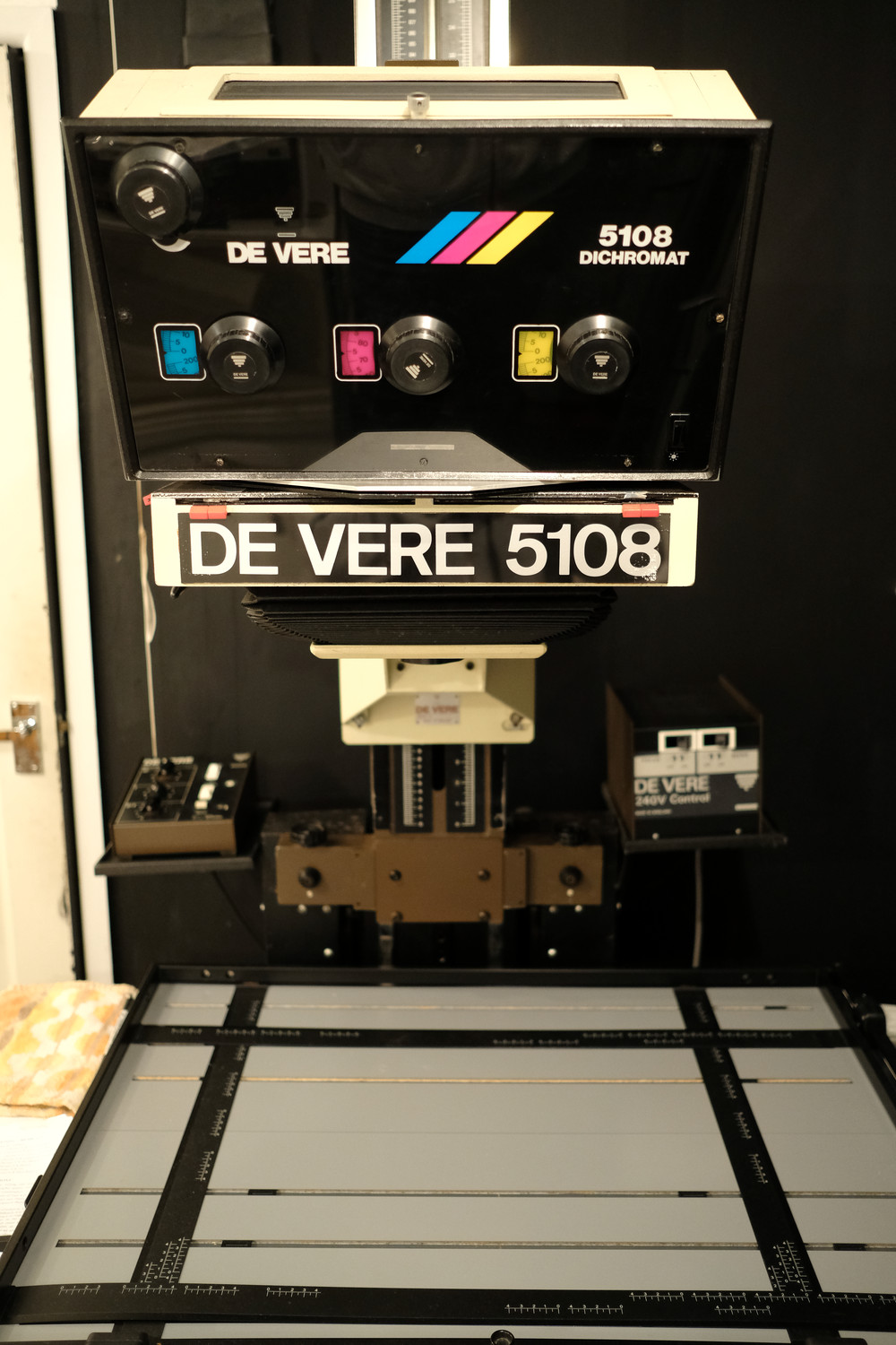

What goes wrong with the Beseler colour heads? I only use De Vere at the moment, although have used Durst, LPL, and Meopta at various times, not sure I've ever seen a Beseler, although they are available in the UK.
The electronics. The Dichro 45S has a opto-coupler that fails, it's easy to fix, if you have a part. The Beseler Universal 45 head is amazing, closed loop, RGB, dual controllers one for VC one for color. These heads have bugs, are impossible to reliably fix. I have 4 of these 2 work.
My De Vere 5108 has a simple colour head.

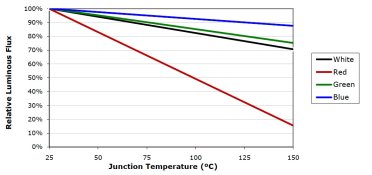

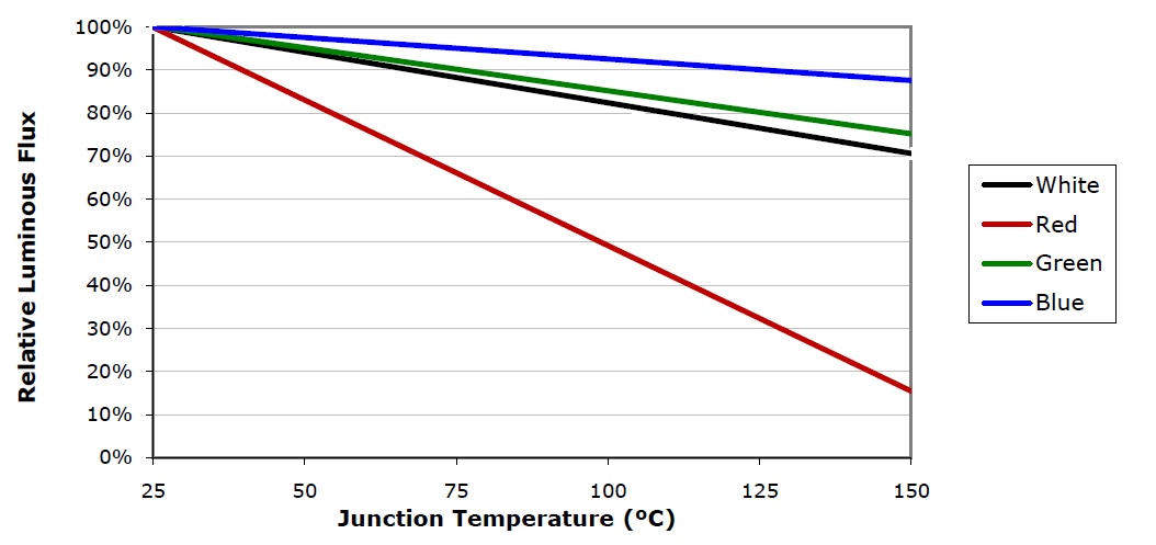

1: As junction temperature rises, light output drops. This is a non-linear relationship and may likely (or perhaps definitely) be different for various types of junctions (i.e. it will be different for the different colors).

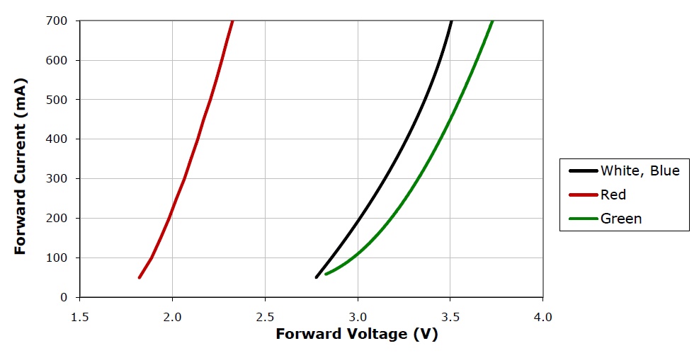

I had a quick look at a datasheet. For example, forward voltage of green and blue LEDs increases more with junction temperature than the voltage for red LEDs does.
Maybe your voltage for green and blue is too high for proper current regulation. You have to add voltage of LED plus voltage drop of your FET plus voltage drop of your shunt resistor at full current. If that total voltage exceeds your power supply voltage, the current drops.
Have you measured the current of all parts R, G and B in cold and hot situation?
On the other side, flux of red LED drops more with temperature as green and blue does. So this would be the opposite effect.
Another thing is the wavelength shift, you mentioned before. Depending what exactly wavelegth the LED has, effect will be different. Check out sensitivity curves of RA-4 paper. There is a kind of edge in the diagram for each R, G and B. If your working wavelength is at a flat part of the curve, the effect may be less. If the wavelength is at a steep part of the curve, the effect may be strong.
So you have to check out multiple things.
Exactly, so it doesn't work well as an explanation. It certainly happens (it's physics after all), but either the effect is insignificant, or other effects in the opposite direction are simply more significant.
