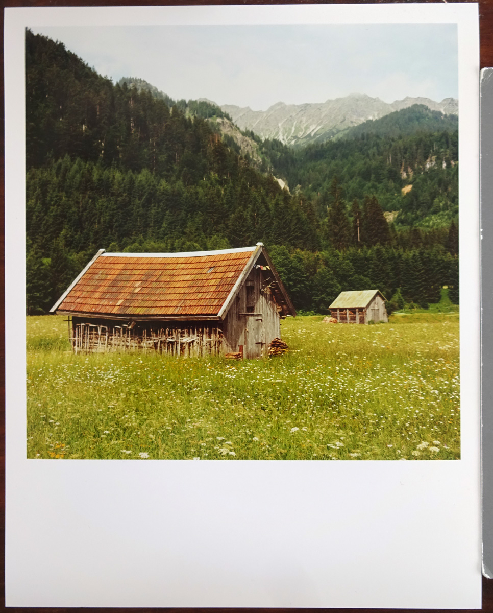

This is a sample printed on 10x12" paper (Fuji CA DP II) from a 6x6 cm negative (Kodak Ektar). Light source G120 E27 LED bulb with 5500K, 1800 lumen, 18.5 watt with a frosted glass filter in the filter drawer (eats about 1.5 stops of light in my experience). Exposure time for this print was 20 seconds at f8 with the Latico 240/130 combo and a 90mm lens. Filter pack was M200 and Y240 with a ca 1970s Agfa filter set (the high values are normal for Agfa filters).

Part of your high filtration may also be due to using a 5500K bulb rather than a 3400K that is closer in color to a tungsten or halogen bulb that the paper is designed for. Using an 85B filter on the enlarger would mostly compensate.
Hi Greg, you're right, I did a test with a 14 watt 1.400 Lumen 4000K LED and the filtration came down to 150M/150Y for a matching print. Its also faster about 1.5 stops because there is less waste of light with the small (6x6) negative. 4000K is also better balanced for b&w variable contrast printing. I have not done a test with 3400 K LED.
