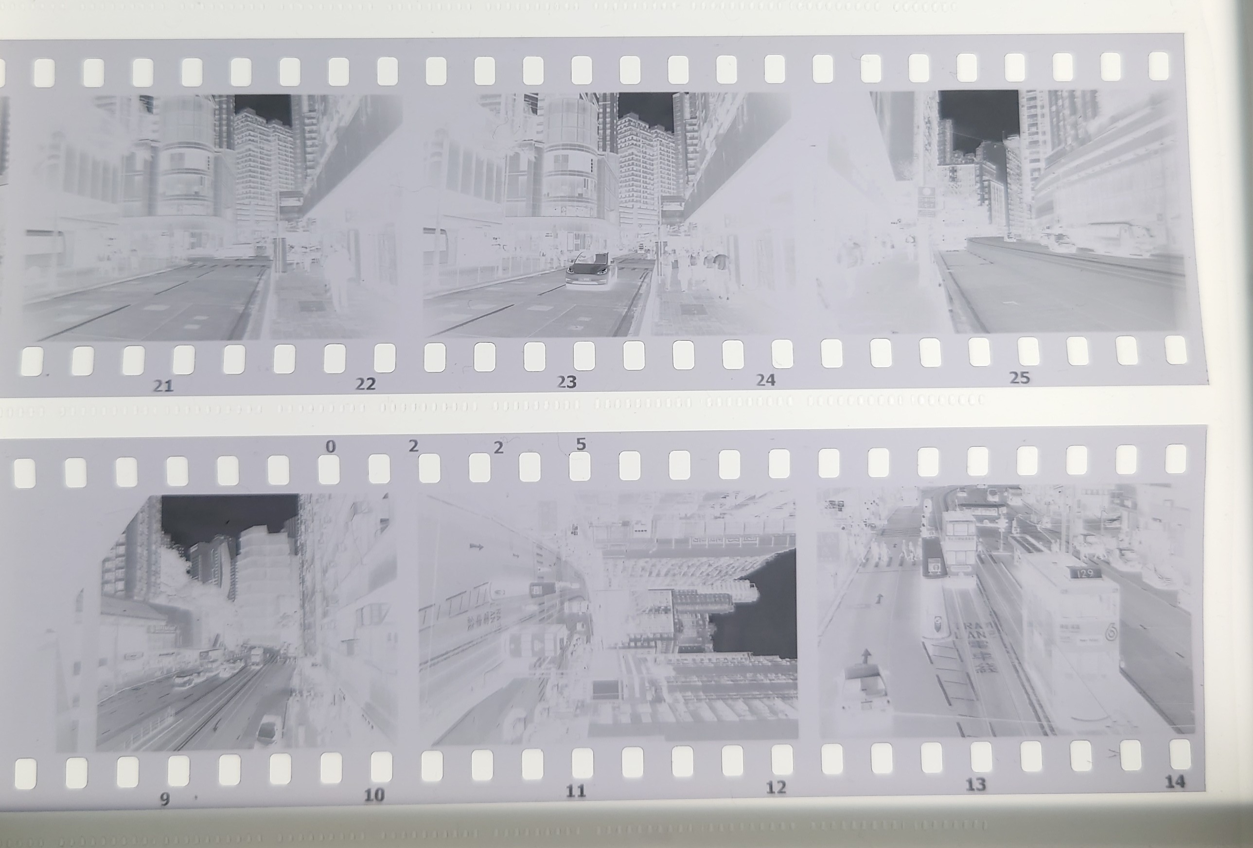

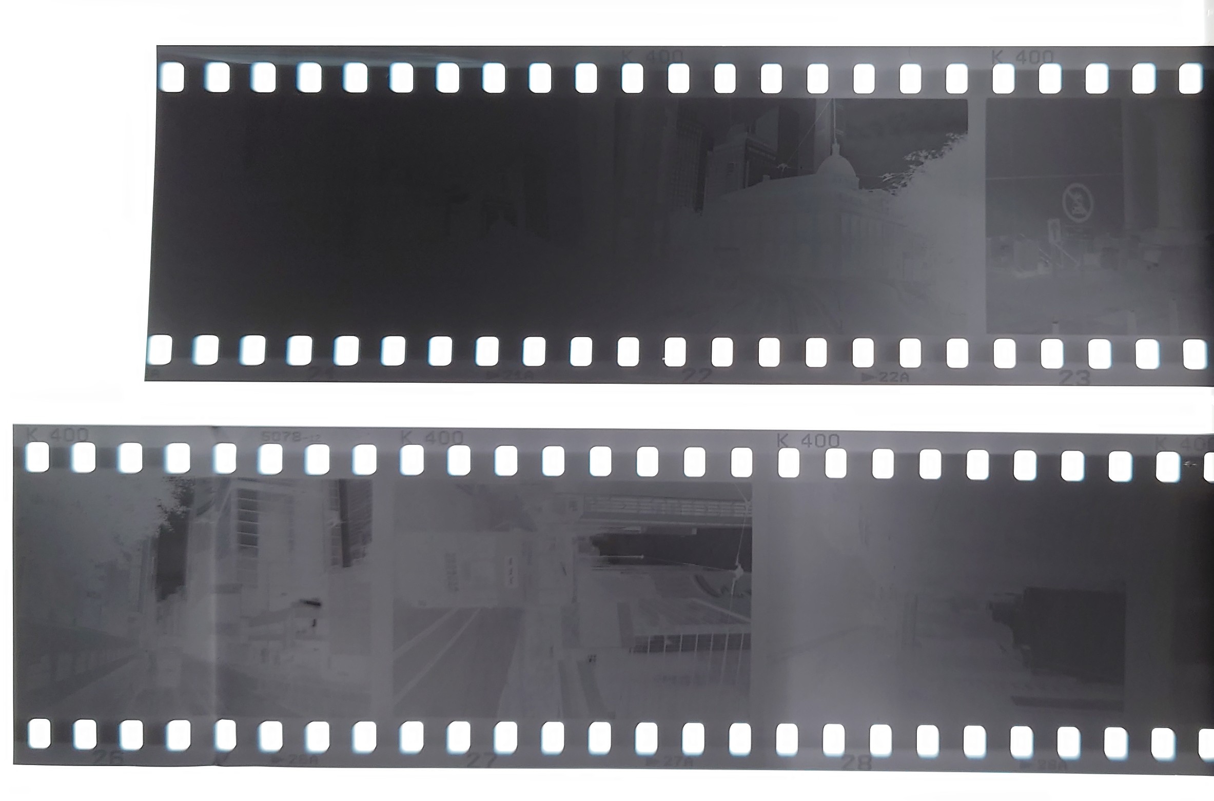

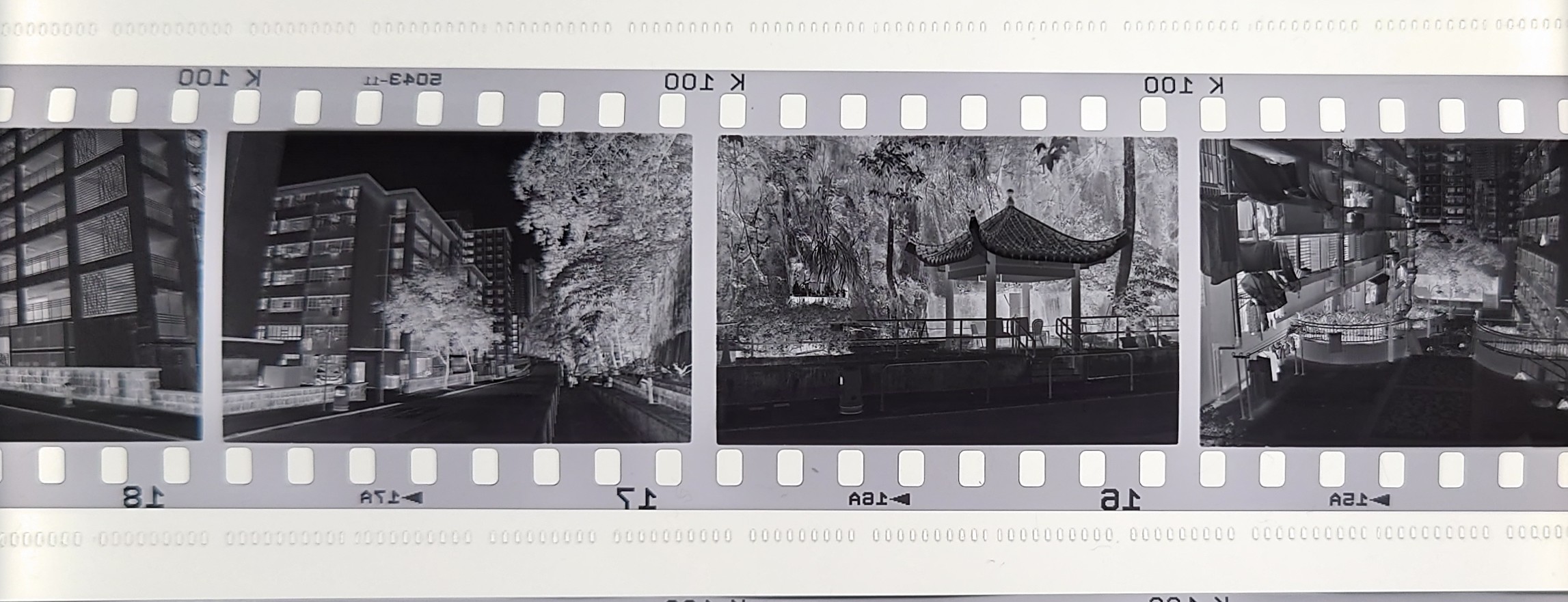

Here are some examples:
Kentmere 100 with Ilford Ilfosol 3 in 24 C/ 4 min process
Kentmere 400 with Df96 at 24 C
Fomapan 100 with DF-96
:wondering:??
For the Kentmere 400 to be dark even on the sprocket holes/film rebate, the entire film strip has been exposed to light.
For the Foma 100 - Was the film leader completely black? If so then it looks underexposed in camera.
Actually all are taken on the same day, using the same camera, same lens, processed with the same darkroom tools on the same day .
The reason why my K-100 looks better because after seeing the results of K-400 and Fomapan 100 I had decided to change the chemicals. The Fomapan 100 also have a black leader, although I cut it while filling.
