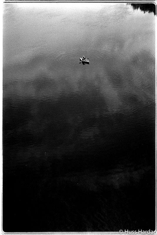

For the Kentmere 400 to be dark even on the sprocket holes/film rebate, the entire film strip has been exposed to light.
For the Foma 100 - Was the film leader completely black? If so then it looks underexposed in camera.
I agree in both cases. That Kentmere has light fogging, either during loading, in the tank, or before it went into the camera (damaged cassette), or possibly due to a bad light seal on the takeup side of the camera. Bulk load or commercial cassette? If bulk, could have happened during loading or when putting the bulk roll into the loader, too.
The edge markings on the Fomapan look nice and dark, and contrast (shadows to sky) looks normal, so probably underexposed. Meter left at EI 400 perhaps?

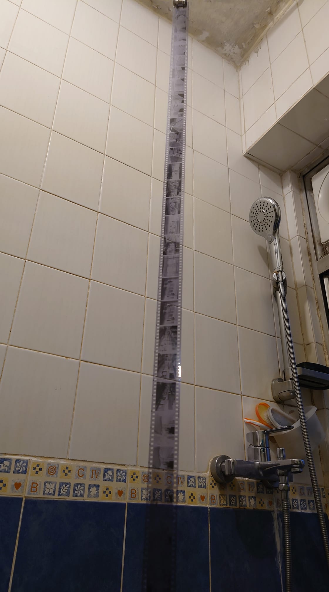

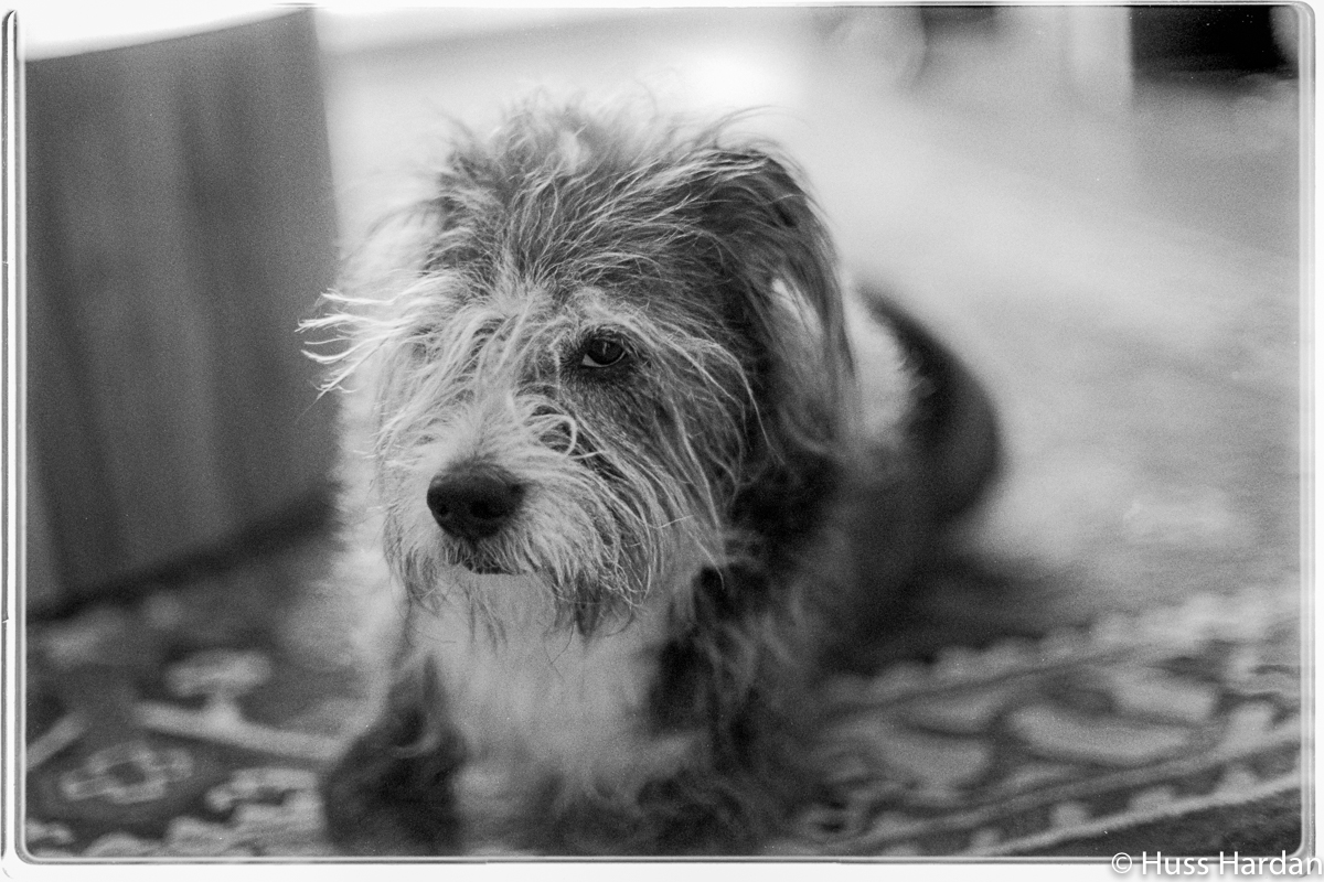

Here is the pic before I cut and filing the fomapan , the whole roll of film was like this way. It looks grey to me when compare to K-100 :

Let's forget about the Kentmere 400, as that was obviously light fogged, no matter how it happened. For the film to be black all across onto the sprocket holes has nothing to do with the developer - it has been light damaged.
The fomopan 100 WILL look different to K100 as it is not the same film! If the leader was black - as you say - then there is nothing wrong with the DF96. The film was perhaps underexposed. You just need to determine how that happened by thinking your processes through methodically.

FWIW, the Kentmere 100 in Ilfosol 3 negatives look to me to be substantially over-developed - I would be leery about using them as a standard for comparison.
The Fomapan 100 negatives in DF96 do look under-exposed and, possibly, slightly under-developed.

I took the liberty of screen grabbing one of your Foma images and converted it. Now remember, this is about as bad as it could get because I just captured your pic of your negs, then cropped so there is only one, then converted it! A real scan from one image will look so much better it's not even funny. And still it made this:
So it's a bit underexposed, but I'm sure you've got some stuff there if you just work with your actual negs.
