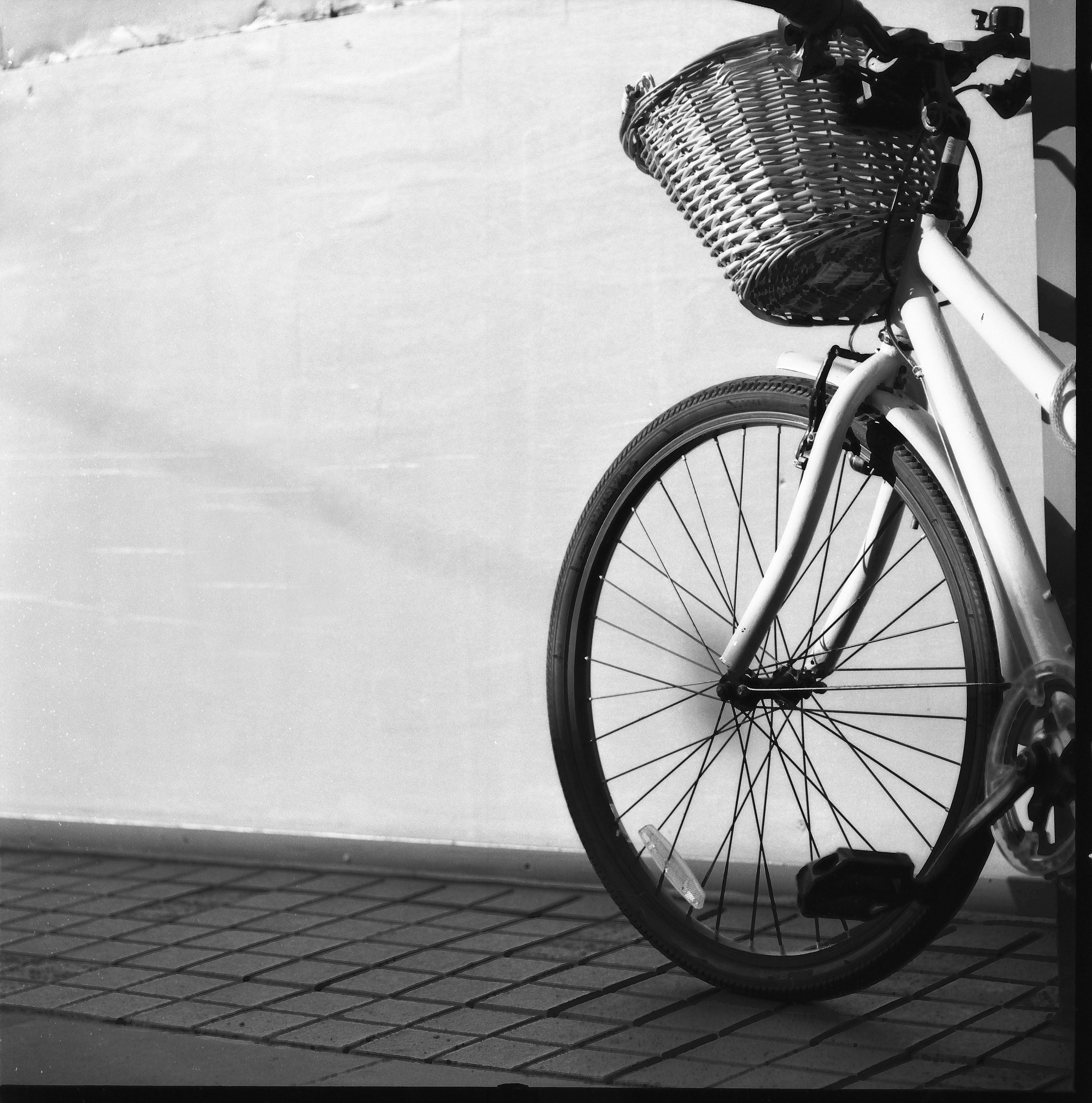

First developing at home. Used the Ars Imago Lab Box and their Monobath. Pretty happy with the outcome for my first go. Shot on Ilford FP4 Plus using the Mamiya C3

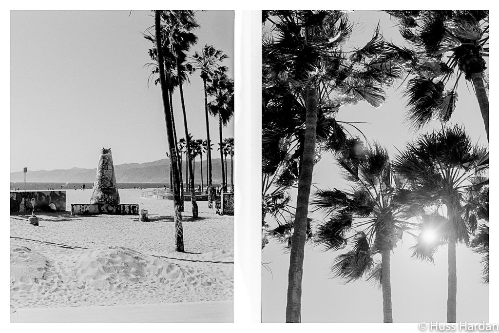

Leica MD-A, Wtulens 17mm f16, Ilford HP5, Cinestill DF96 Monobath
Same time of the year in 2017 you could not see hillside, everything was covered by 2-3ft high wild flowers...
