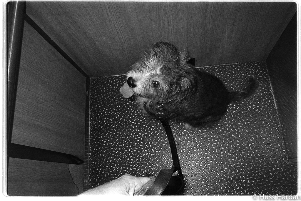

Hey Don! I used your step on leash idea today! Worked like a charm. Now why didn't I think of that? Off to develop another roll, back in 15 minutes...
My partner bred dogs -- golden retrievers and Japanese chin, mainly -- for twenty years before we met. Breeding requires showing, and showing requires knowing how to control the dogs before they're fully trained.

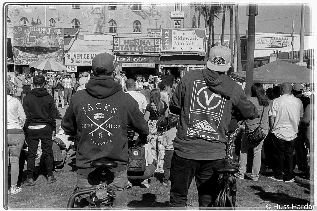

Aaannnd, Acros II is perfect in DF96 Monobath. Silky tones, zero grain. This pic was heavily backlit, and still came out like this
Rollei QZ35W, Acros II, Cinestill DF96 Monobath
What time/temp did you use? I'm thinking about trying DF96, but haven't had any luck finding specific instructions for Acros. Most of my B&W film stock is Acros, so I want to get it right.

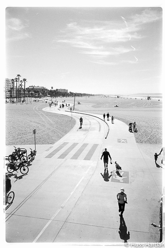

I did 8 mins at 75 for Acros
Extra time will do no harm at all. I also forgot to mention, don't forget to add time as the solution ages -- thirty seconds per roll previously processed, as I recall.
Also, from my own experience: if you open the tank and the film is still milky, don't just pour the Df96 back in; it will develop some of the now-fogged unfixed halide before it can finish fixing and leave a sort of faint Sabbatier reversal (BTDT). Instead, either make a habit of leaving the film in the solution for the double time recommended for tabular grain, or keep regular rapid fixer mixed and ready, just in case (which, of course, defeats much of the advantage of using the monobath).

It's 15 secs per roll that you add.
Cinestill recommends double the time for the Tmax/Delta type films. They don't mention Acros, but as that is similar tech that is what I used, and it comes out perfectly.
With fresh bottle (adding 15 secs per roll going forward), I dev Acros at 75 for 8 minutes. Initial 30 second constant agitation, then 10 seconds on the top of every minute, and 2 agitations at the 30 sec mark.
