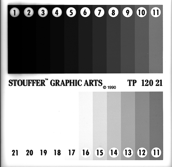

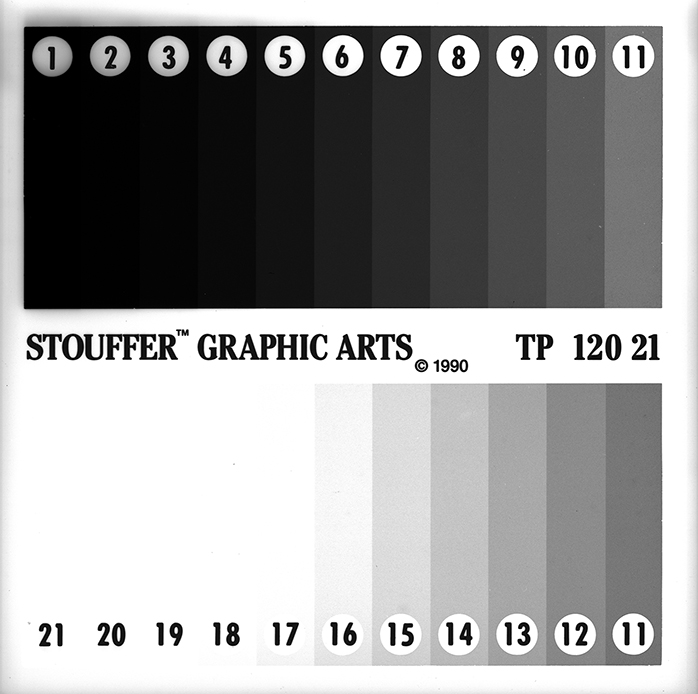

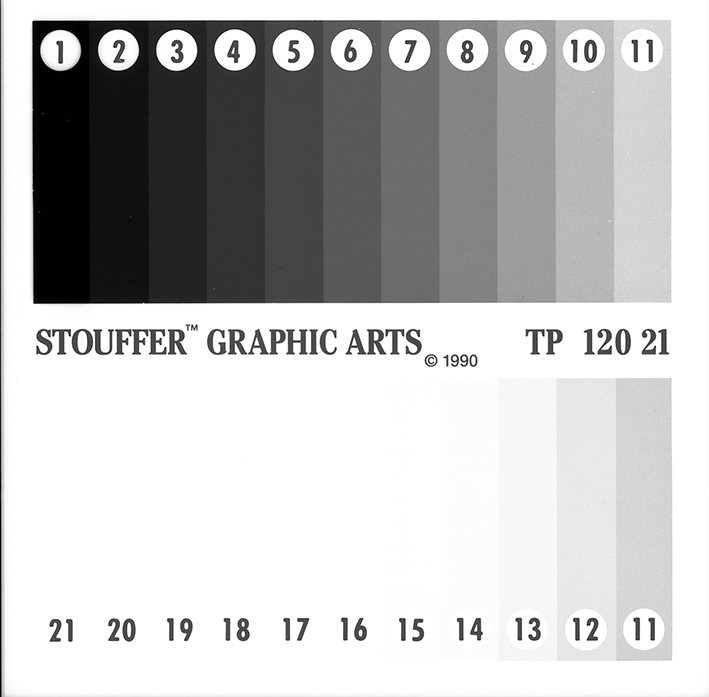

Left: V500, epson scan no corrections. Right: V500 vuescan Raw
Left: iV700 epson scan no corrections Right: V700 vuescan Raw.
Same scan resolution, reduction in PS5 for all.
Edit: each step = 1/2 stop increase in exposure.
Please answer the question in post 99.

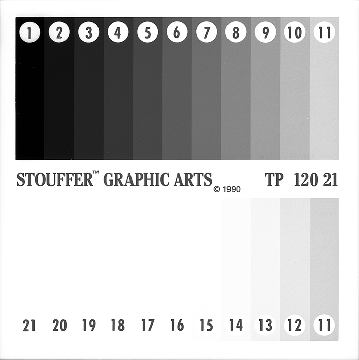

Stouffer 21 step transmission/projection step wedge. Each band from 1 to 21 is a .15 increase in density, scanned at flat/default to show what the scanner produces without enhancements or multipasses.
I would like to see the same of other makes of scanners.
https://www.stouffer.net/TransPage.htm

If I understand the Stouffer results, do both the V500 and V700 have the same dMax? Both sets of scan seem the same.
I'm also confused that there are four scans:- two scans of the 21 steps for each scanner. But the results are different for the same scanner. Why two passes for each scanner?
Site space editing removed the spaces that had the epson scan under the left pair and vuescan raw on the right pair.
Vuescan's exposure gives 2 steps more but steps 1 - 5 are not as sharp as epsonscan.

Shuttfinger, there are no manual controls that influence the way the epson scanner scans when using epson scan. The exposure control is completely automatic, all the software controls BP, WP, contrast, colour. etc are effectively post controls, that can be done in epson scan or later in something else. You can of course use those software controls to make a irreversible mess (clip all the values etc, reduce to 8bit before corrections have been made etc)
You can use manual exposure control, in vuescan. Or multiple exposure in other programs, these are indeed hardware controls, that will make a small difference in some instances... For whatever reason epson choose not to enable them in their own software.
I always use manual exposure in vuescan, (set for film base for any given type of film) which at least means I don't need to run a preview scan...
In the case of V700 someone was kind enough to run the test with the same wedge using vuescan and manual exposure, and the results clearly showed it could get all of 3.1D density in one scan.

I don't think this is the best way to check the full range of scanner.
You should find a way to mask the areas of non importance like the clear base of the transparent film and let the scanner only analyse the lightest/darkest patches with the rest in between then we can see what is the real range capability.
Base + fog is your Dmin.
The most dense silver or dye deposit in the frame is the Dmax.

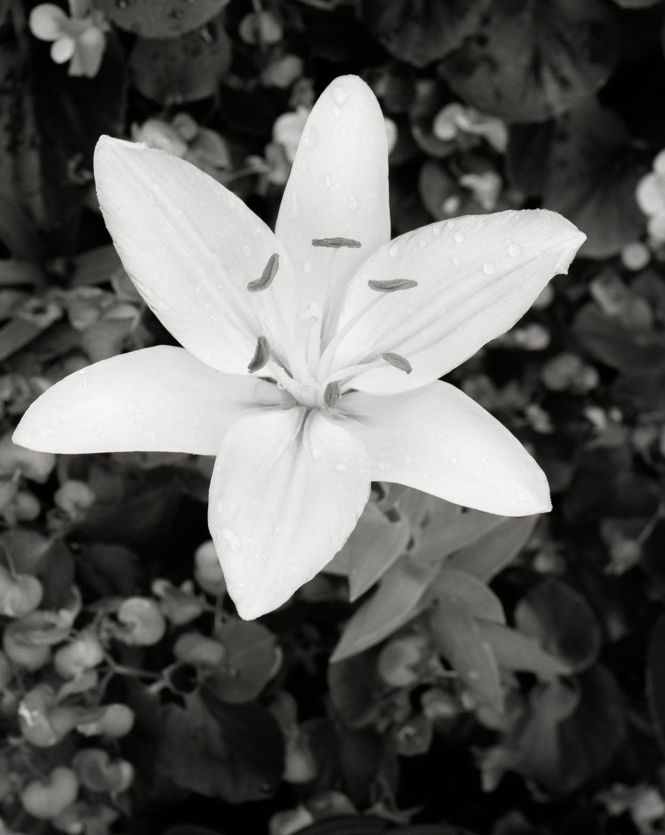

Here is a BW image scanned in the V600 as a color 48bit, no adjustments during the scan. If you notice, the image is dark and to the left in the histogram, typical of most of my shots. The final picture is after post processing using either LR or Elements, I forget. So would I have been better off setting the black and white points before the scan or just leaving it scan flat?

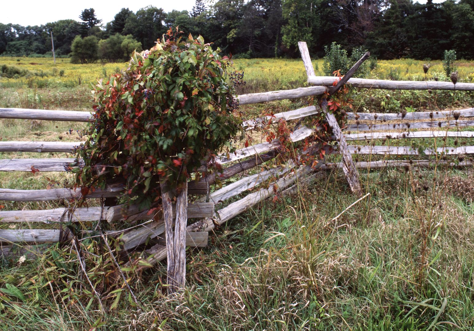

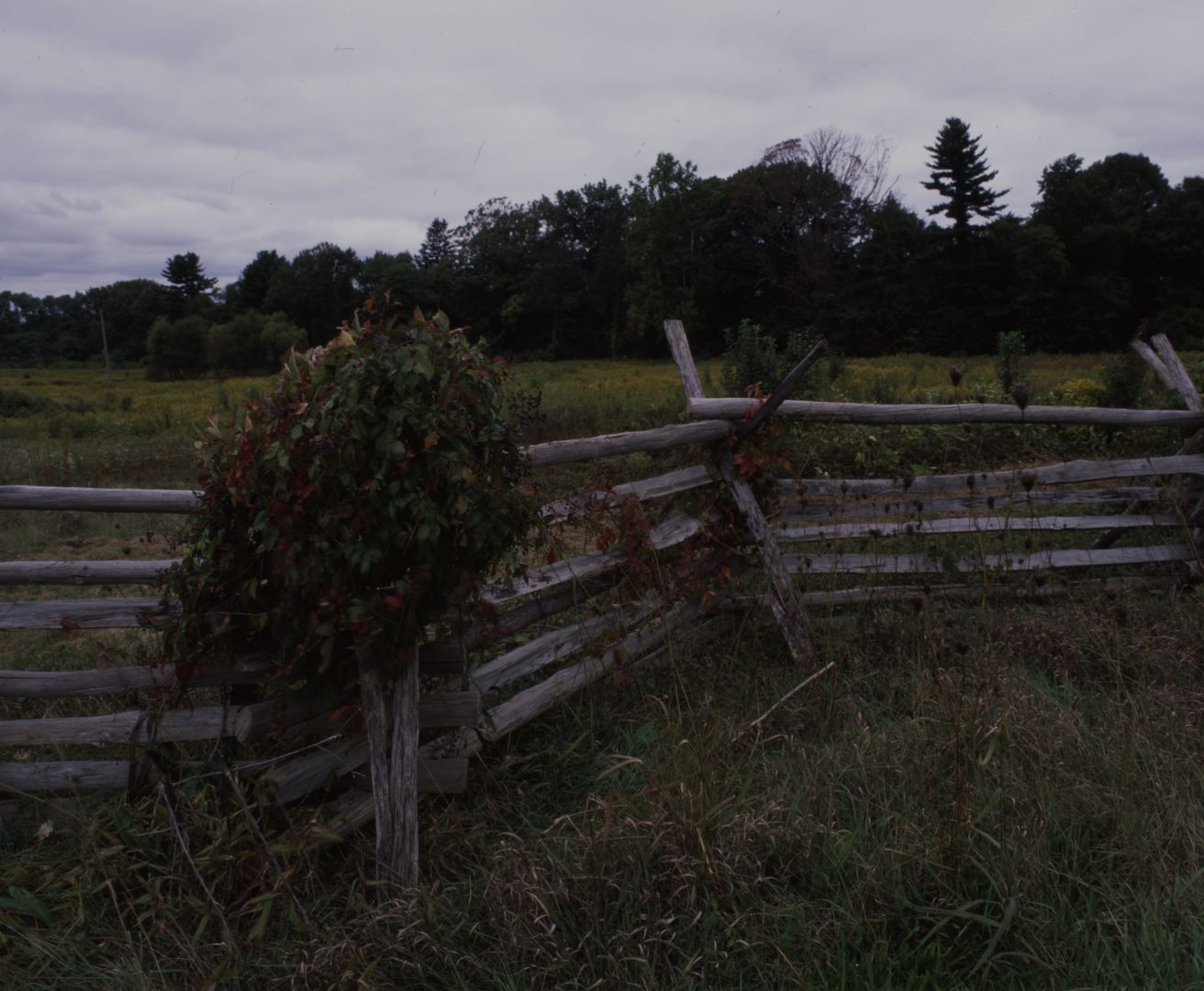

Here's a Velvia 50 slide color shot scanned flat. Also very dark which is typical. The histogram on the ground portion runs about 0-95. The sky portion runs 140-185 approx. The final was cropped and adjusted in PS Elements.
Note the original slide was exposed properly so the original is not dark like the scan. (I bracket my shots). So the darker scan is typical for me if I scan flat. DO you guys get the same dark thing on yours?
Again, would you set black and white points for the scan or scan flat and adjust like I did in post?
