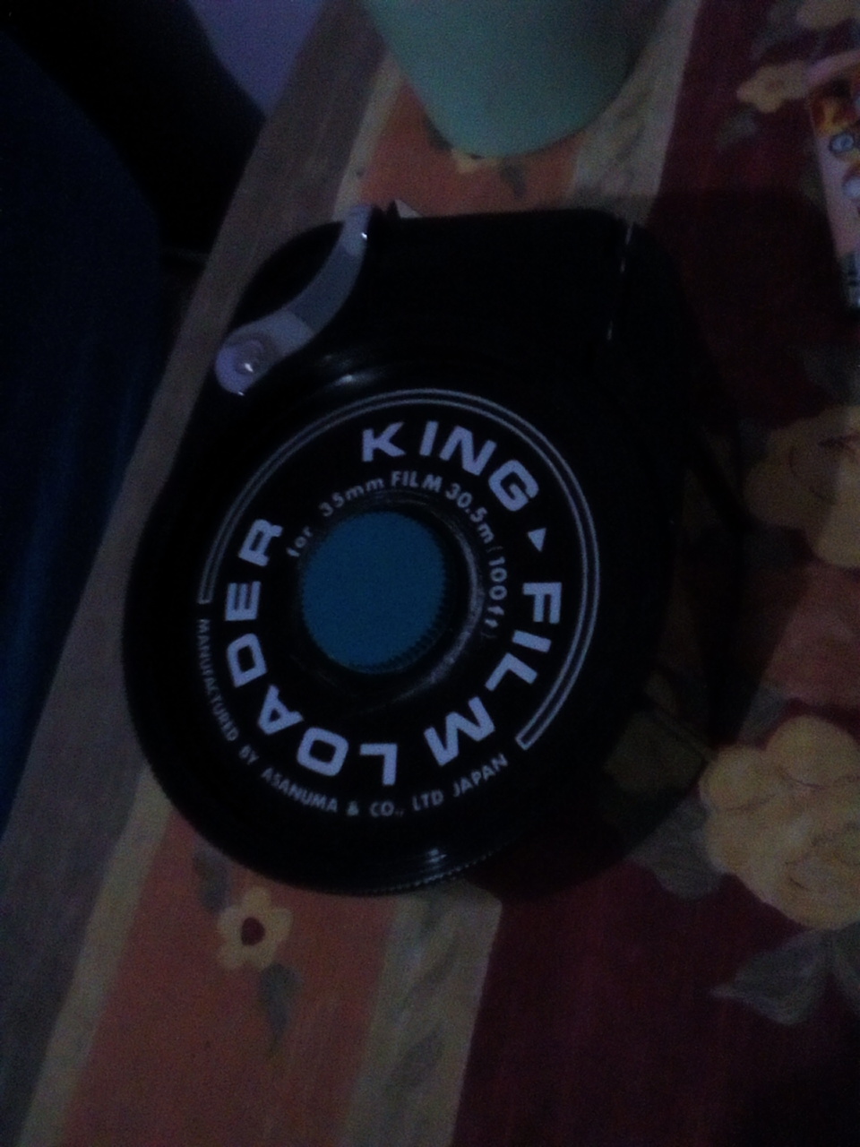

Hi, I received a King bulk film loader today but cannot find any information on it. Is it any good ?

This is the one I got. Seems nice. I did put a roll of film through it and it scratched the film, maybe im just loading it wrong since the instructions is in Japanese.
The roll also came out blank but I believe that is because my developer is expired.

Okay, that's essentially a Lloyd type. If it's scratching, the felt lining the (double curved) film passage from the bulk roll chamber probably has grit in it (or your cassette velvets do). The sticky edge of a Post-It does a pretty good job on cassette velvet; I haven't yet had occasion to clean the felt in a Lloyd style loader.

How do you determine that? To me it looks more advanced - like the Kaiser type with exposure- and remaining stock counters. I don't see any felt trap inside: https://aucview.aucfan.com/yahoo/w1036489361/

The person who gave it to me told me he used it once but it scratched the film thats why hes not using it anymore. Im sure there must be a way to fix the scratching. From what I see some people are having no problems with scratching or bulk loaders and others dont recommend it so not sure what to think of it. I would love to sucessfully load my own film rolls.

This, then, is not quite either a Lloyd or Watson type -- Lloyd shaped, but Watson operation. Scratching can come from failing to open the film gate while winding into the cassette or dragging the film over the counter sprockets, just as it would in a Watson/Weston. There are videos on YouTube showing how to operate that style of loader.

Frankly Kate I cannot see your loader clearly enough to tell what kind it is. Is it possible to brighten the very dark picture and show us the other side as well?
When you open it does it have a number of corners in the path from the bulk roll to the outside? If it has then it is probably a labyrinthine type which doesn't need any felt as light cannot turn enough corners to affect any of the film except close to the mouth of the loader
With labyrinthine ones they are more difficult, in my experience to load in the dark but they avoid any dust and grit sticking and scratching the film
