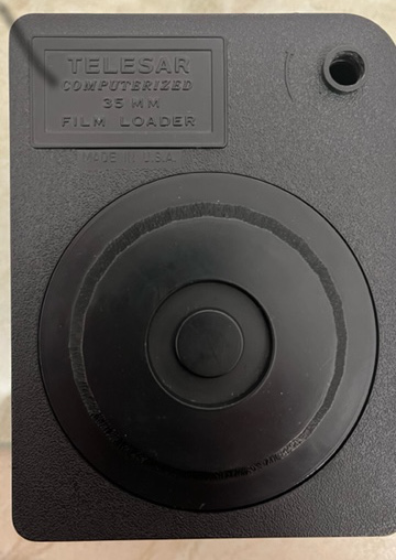

I don't know of any genuinely bad bulk loaders -- there are basically two types, the Watson style and the Lloyd style.

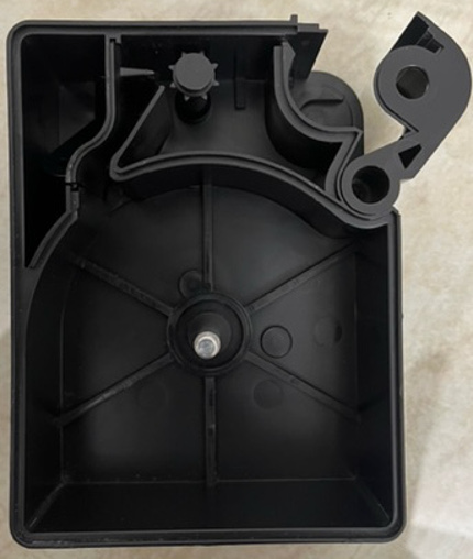

There's also this type. I actually prefer it to the popular Watson, which I also have. Externally, it has the appearance of having been chiselled from a solid block of plastic, but inside it is smooth as glass. It has a felt-free light trap, it is not such a silly shape overall as the Watson, and the handle detaches for storage inside (OK, that means you either have to load up the entire bulk roll, or tape the handle to the loader to avoid loss). And it is 'Computerized' - woohoo!

This last (Telesar) is effectively a Lloyd with a counter. I presume that's also the case with the Bobinquick and AP units. Because of the added counter, this will fog about as much film on each cassette change as a Watson -- look at the light path from cassette chamber to the corner with the fin pointing at the sprocket shaft.

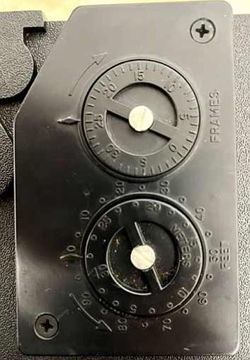

Well the telestar which is the one I have as well and is exactly the same as in snusmumriken's post, It is a labyrinthine type with no felt trap and I find it a very good loader. The path of the film requires more care when threading the film than does the AP style which does have a sealed light trap but I found it better than the Watson in terms of shape. being square and more compact and while I always tend to load the first 5 frames to be safe I get the impression that 3 frames wastage might well be enough. The two dials seem very reliable in terms of frame count and bulk roll usage count

Yes the AP Bobinquick loader belongs to the last group. With mine you can actually push the bulk roll through the opening via a knob that operates the sprocket near the exit of the bulk roll but until the film has emerged from the opening it is blocked by a hatch which requires the crank to be pushed through the winding hole. However when cranking the film into a cassette you need the crank handle to be pushed into the crank handle hole so the film is in no danger of being scratched. During the cranking the top hinged lid is also down and the crank handle hole is filled by the crank handle
The result is that the film is in a light tight passage from the bulk roll into the cassette so it's a foolproof system. For each new cassette you set the frame counter triangle mark to the triangle mark on the outer chamber mark. This gives you 5 frames for the necessary wastage on each film but I suspect you might get away with 3 frames. Then you crank the number of frames required. You can reset on each occasion.
Another dial tracks the film used in metres and feet. This dial can be reset to S for start each time a new bulk roll is started. The only sophistication it doesn't have is the ability to reset the film usage to a 17 metre roll. The only "work-around" then that I can see is either to mark a line of the dial at 13 from the S or very laboriously turn the built-in winding knob until the meter registers 17 i.e, it shows 13 metres used and then the end becomes the same end point at 0 metres remaining
All in all a very good loader
