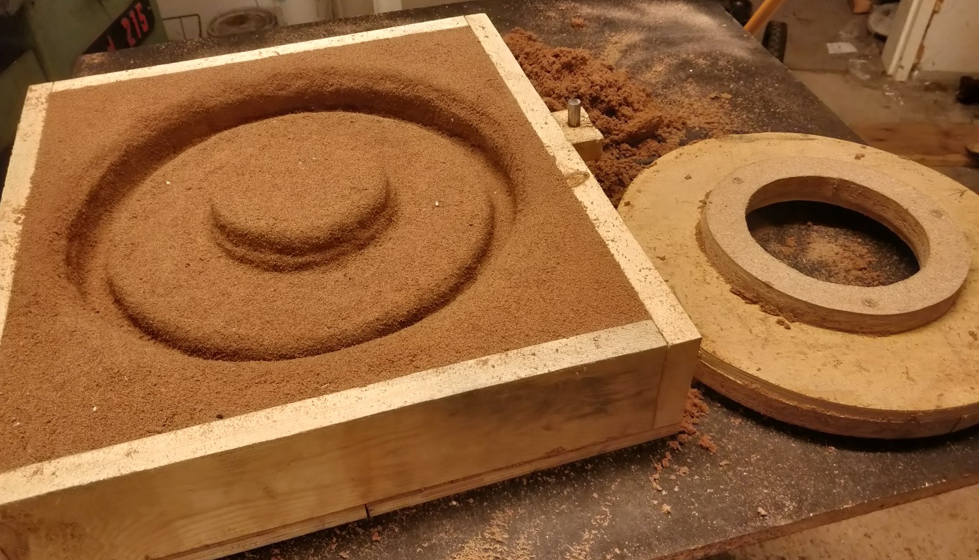

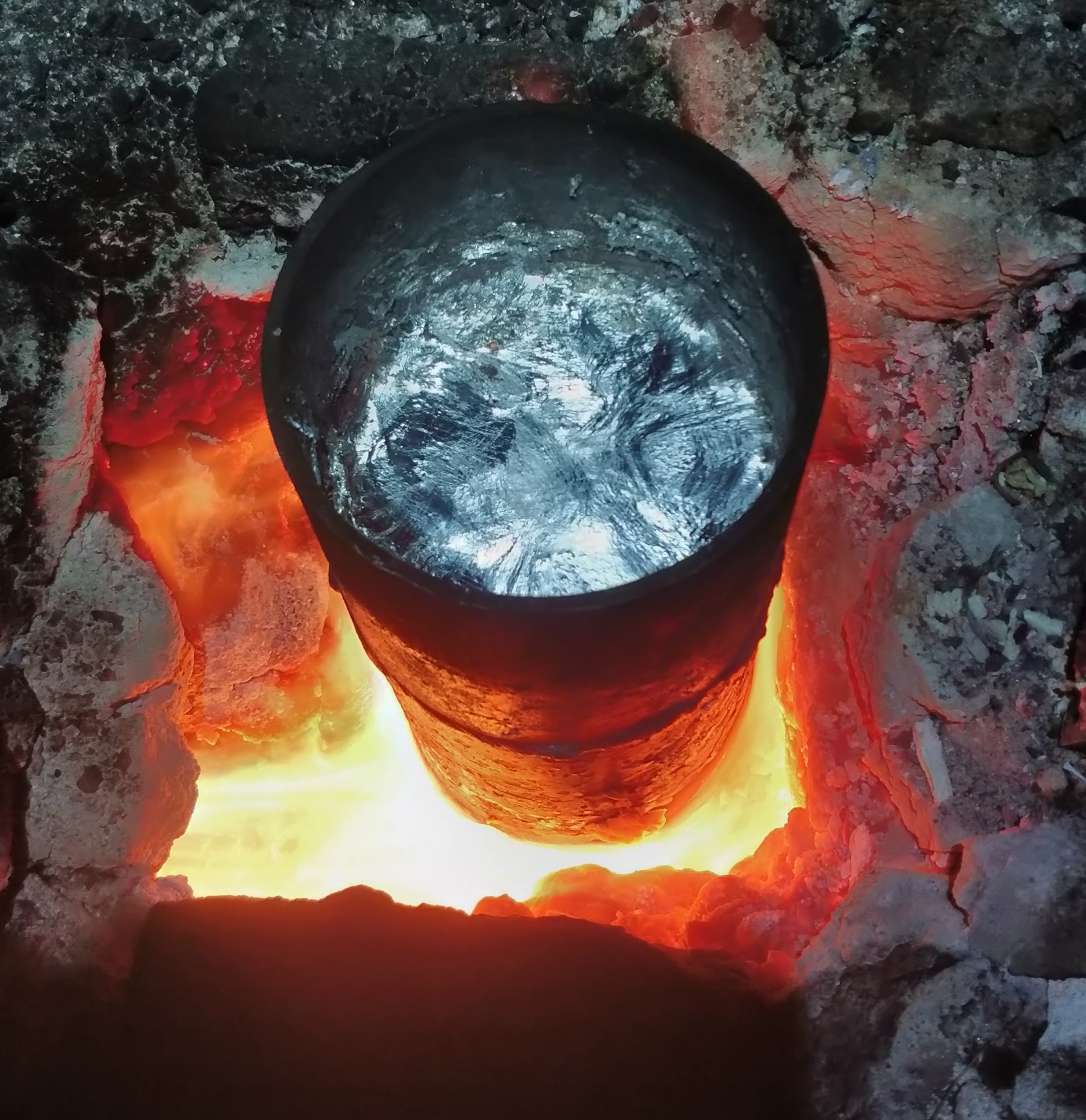

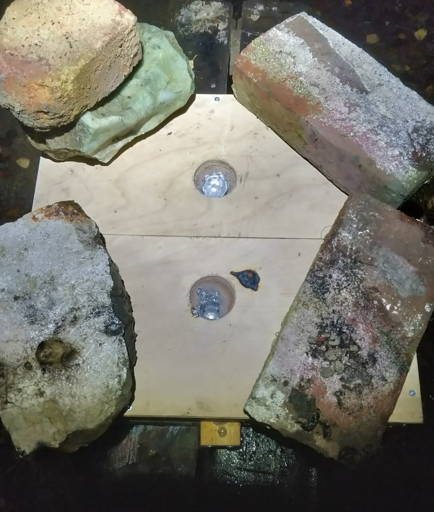

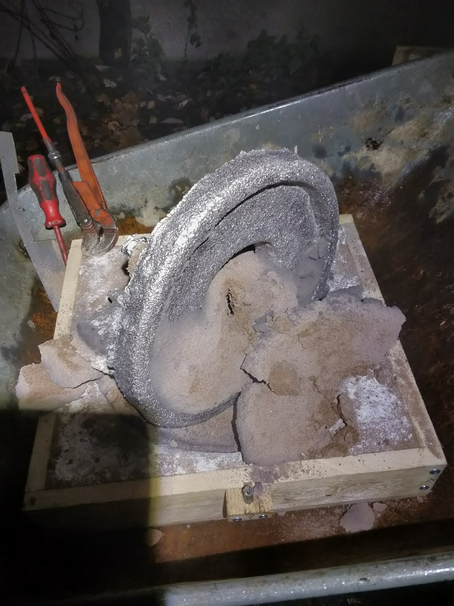

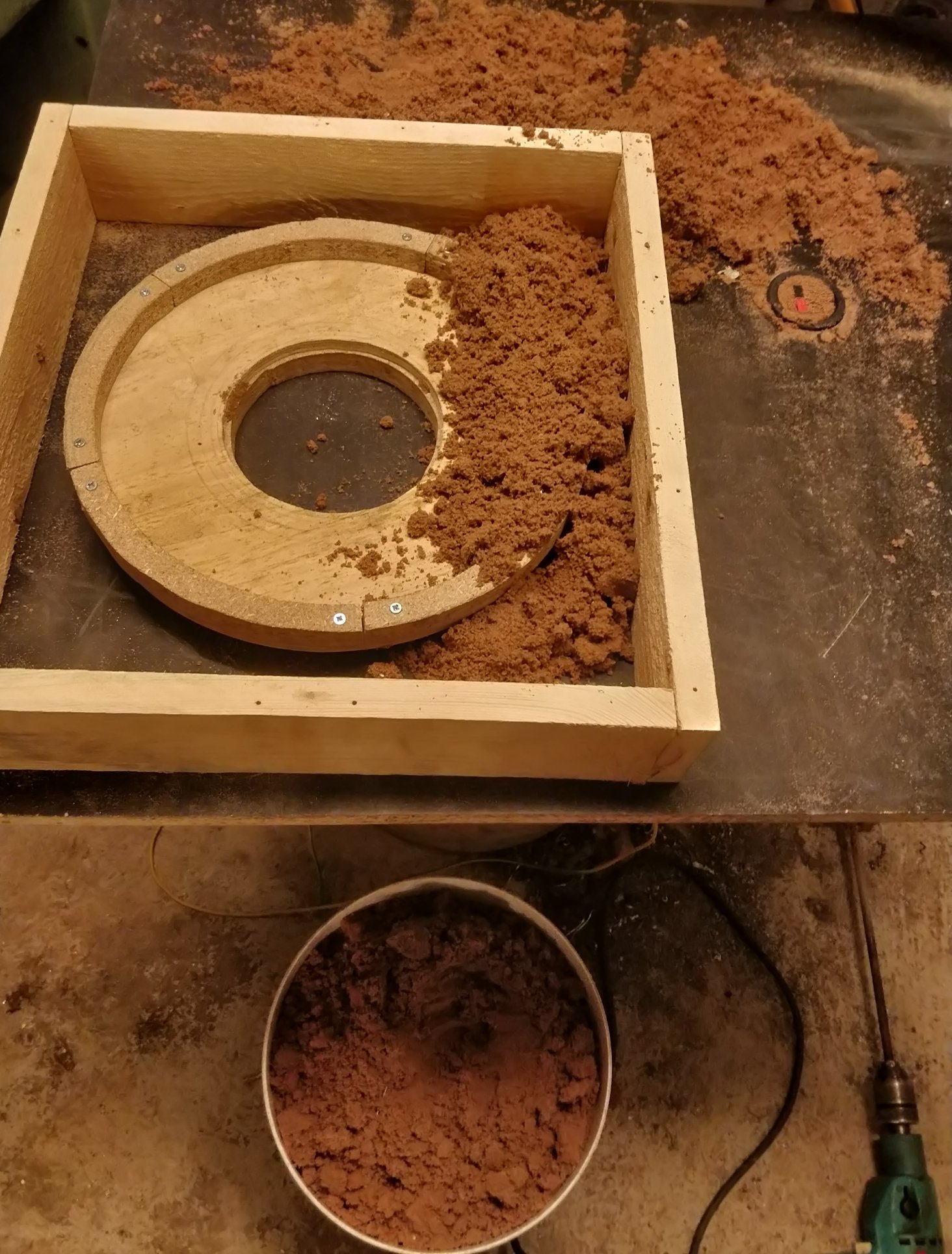

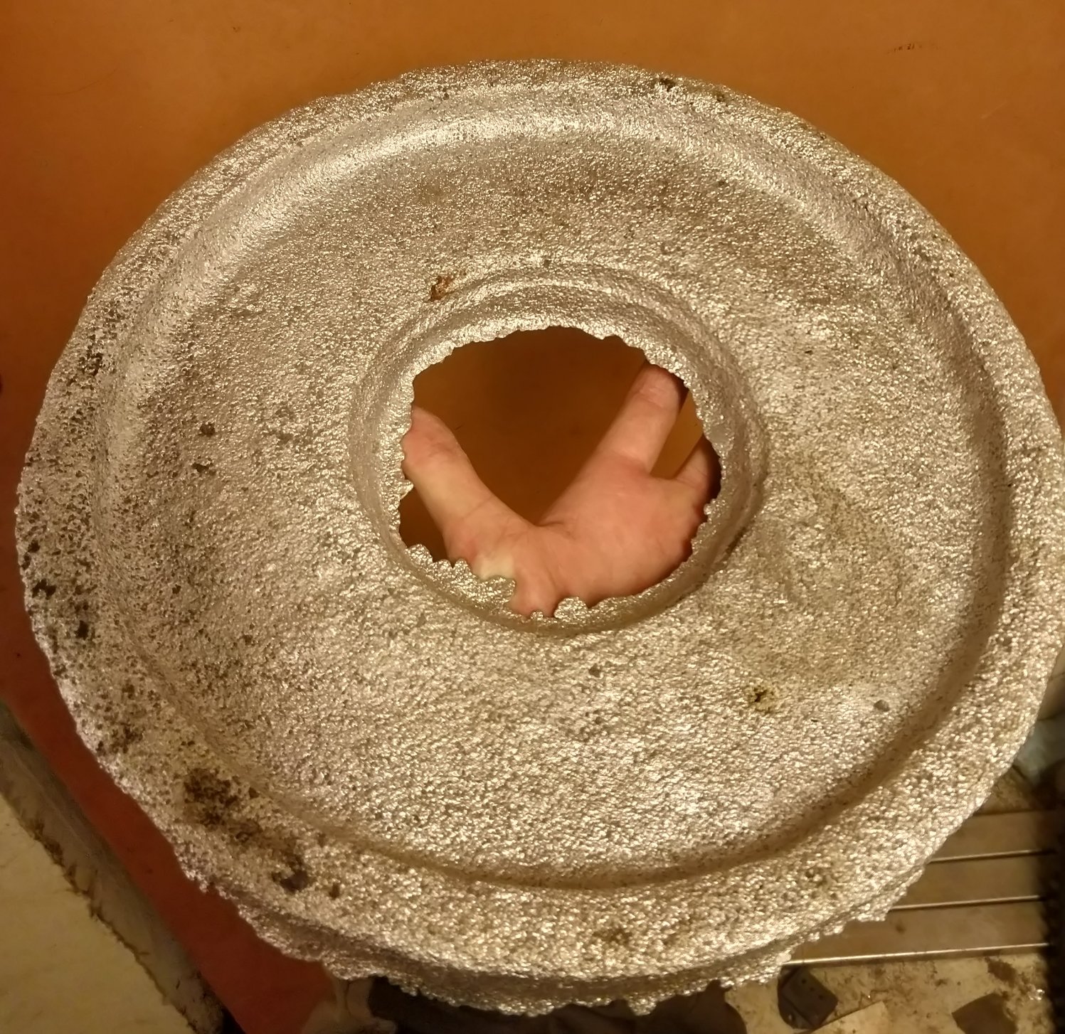

Project is still going, I managed to cast the shutter main body piece.
This is very crude casting, but it saved me a ton of work not having to finish and polish the model piece at all. I left plenty material to be machined away, that should correct rough surfaces.

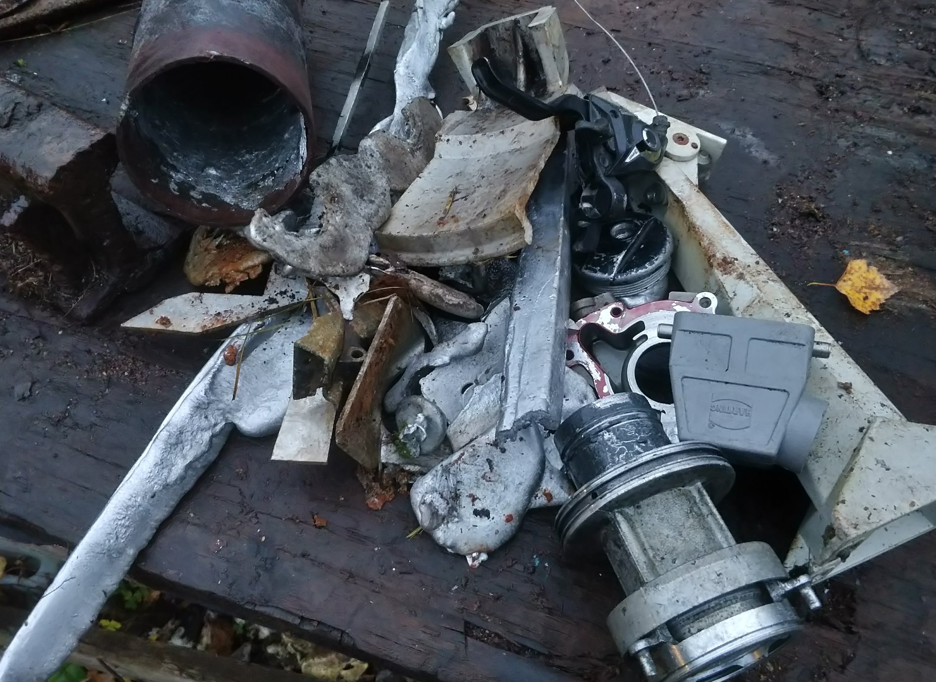

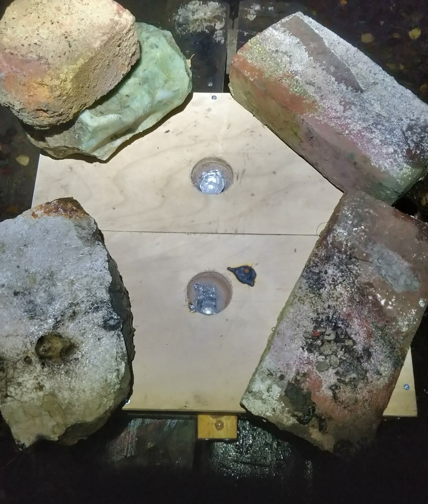

There's some images on steps of the casting process, they are kinda self explanatory. The third picture is showing the scrap aluminium material that become the shutter.
Now the casting has been on heat treatment in oven, to make it better to machine. And when machined, then this project is starting to take a shape. At least if I measured things correctly.
This casting sand is also "homemade", composed of sand blasting sand, bentonite clay dust from kitty litter, and water. Its reusable and very cheap.

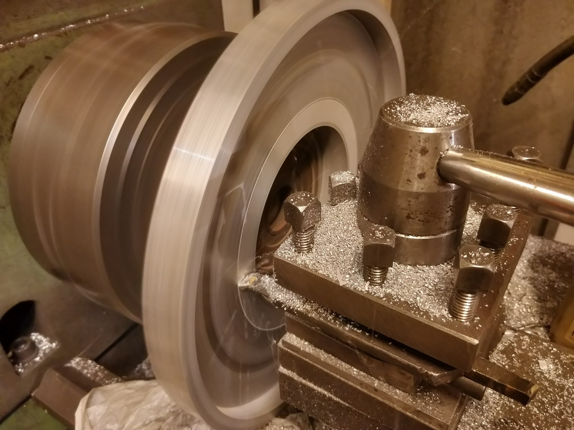

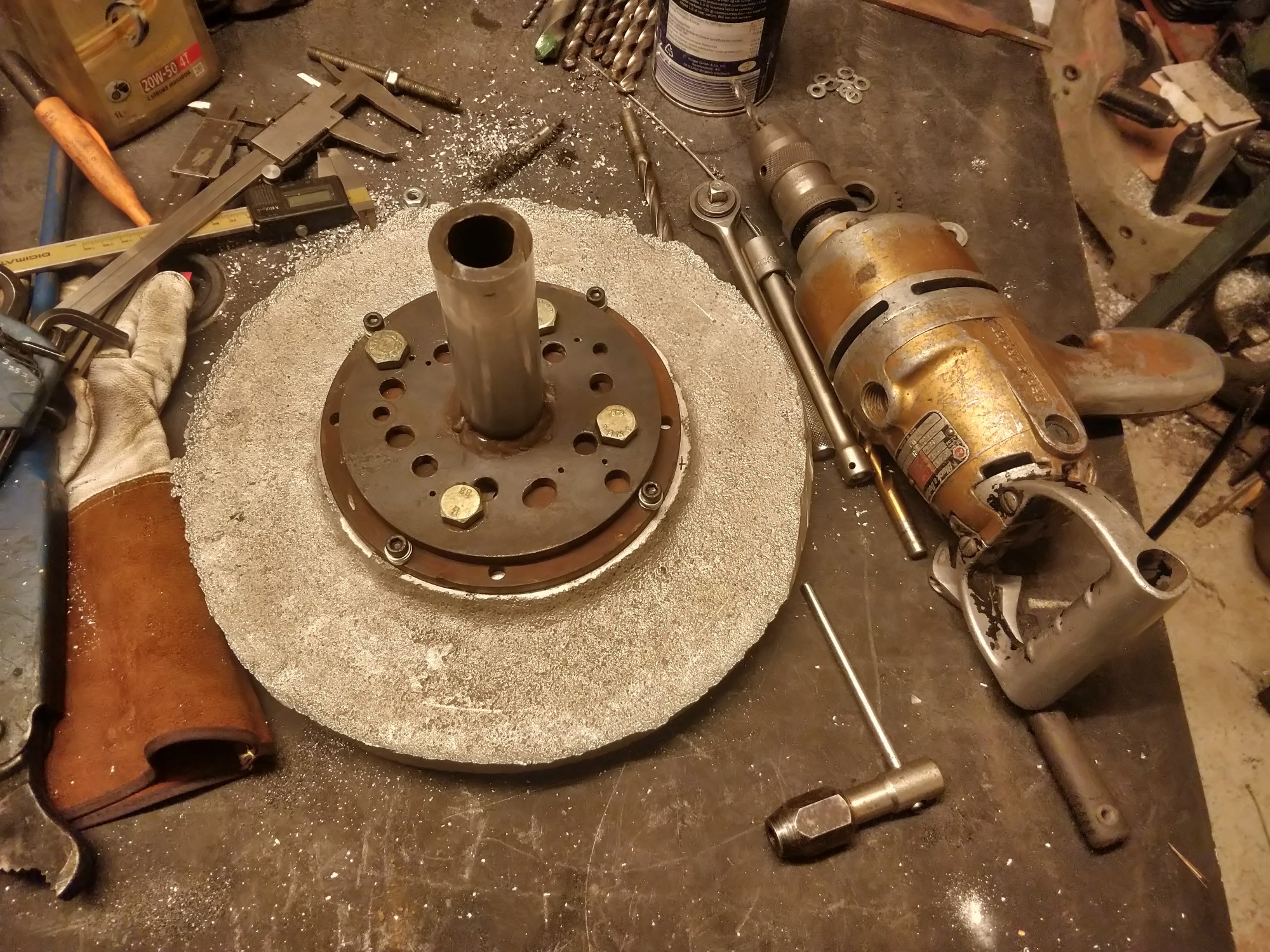

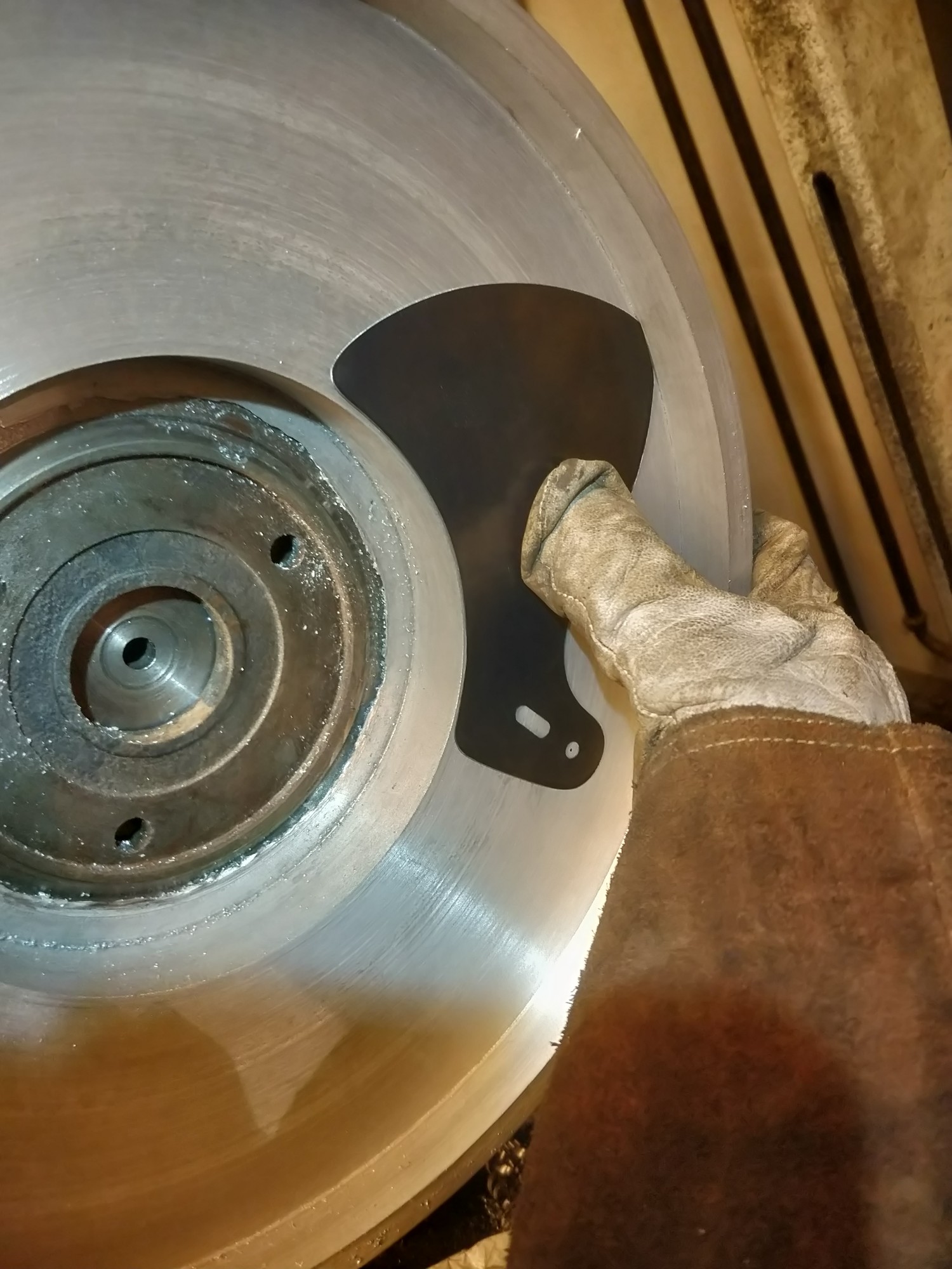

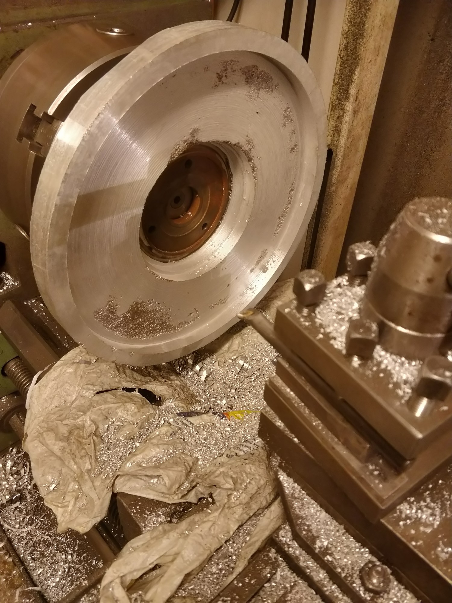

Attaching the casting to lathe with small threads and screws and starting the machining. Under the rough cast surface there is nice aluminium with no air pockets or porosity.
Also the casting were not too small anywhere, so that worked out nicely.
On the last photo the shutter opening and shutter body inner dimension is on size already. I am holding one of the shutter leaves there to show how it fits nicely. The opening is 141mm actually, i wanted that its 140 for sure :D
Next up is machining a pocket for the ring part, and to cover that, make some kind of steel sheet cover, that has just slots where pins for leafs poke trough. Similarly than in shanel 5 shutter.
The shutter looks pretty large on outer diameter, but it can't be any smaller since the leafs has to have enough space to open fully. Outer wall can be taken down couple of mills thinner of course.

Wow, that is one old drill motor you have there (in the first picture). Good to see someone who takes care of their tools.
Yes :D I was wondering if anyone notices the drill. Its black & decker 1/2" general duty. Its fun to revive and use some old tools and especially when they can be had cheaply/ saved from scrap.

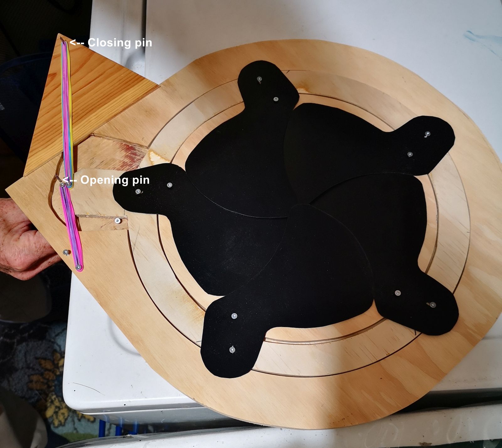

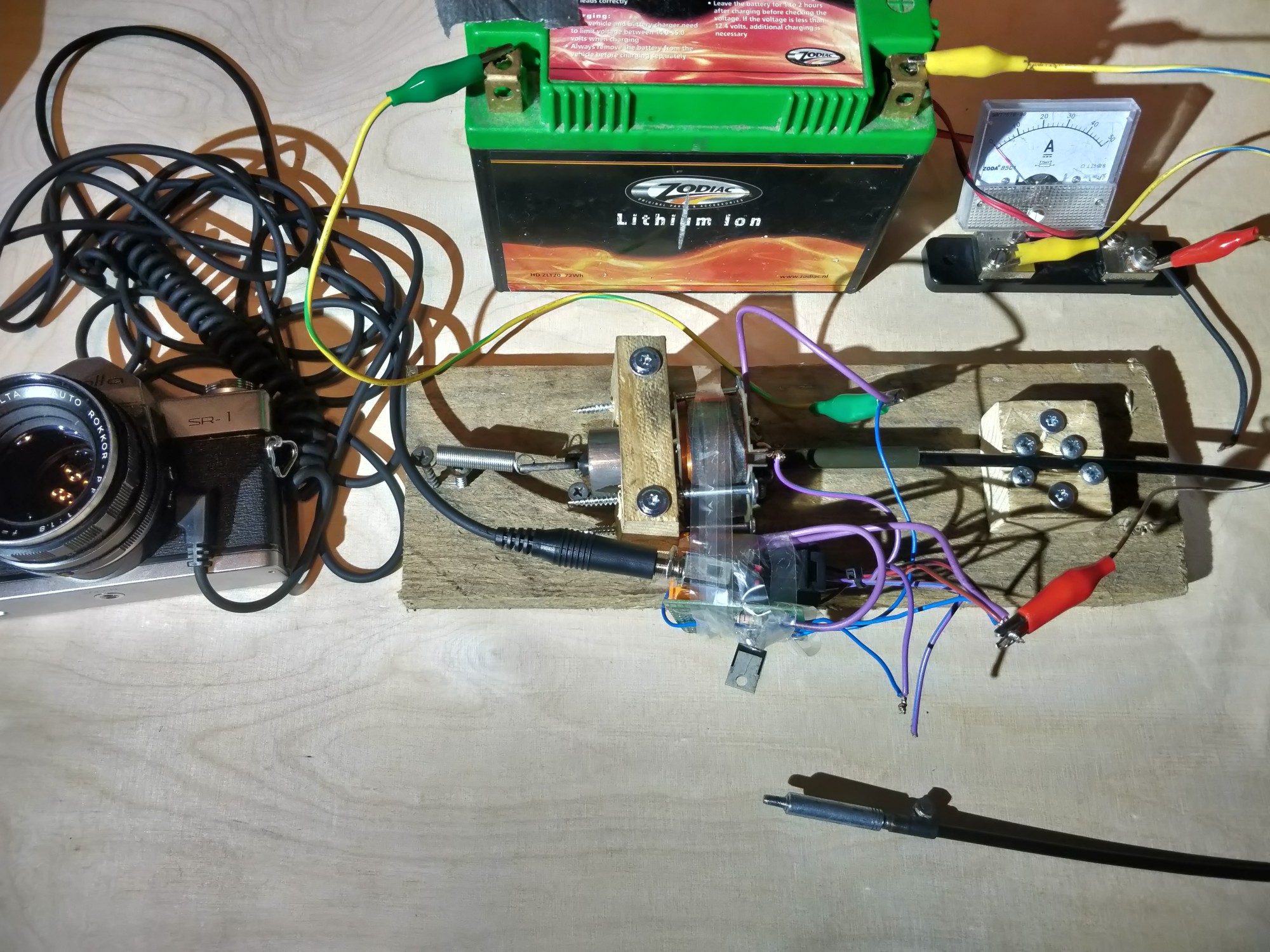

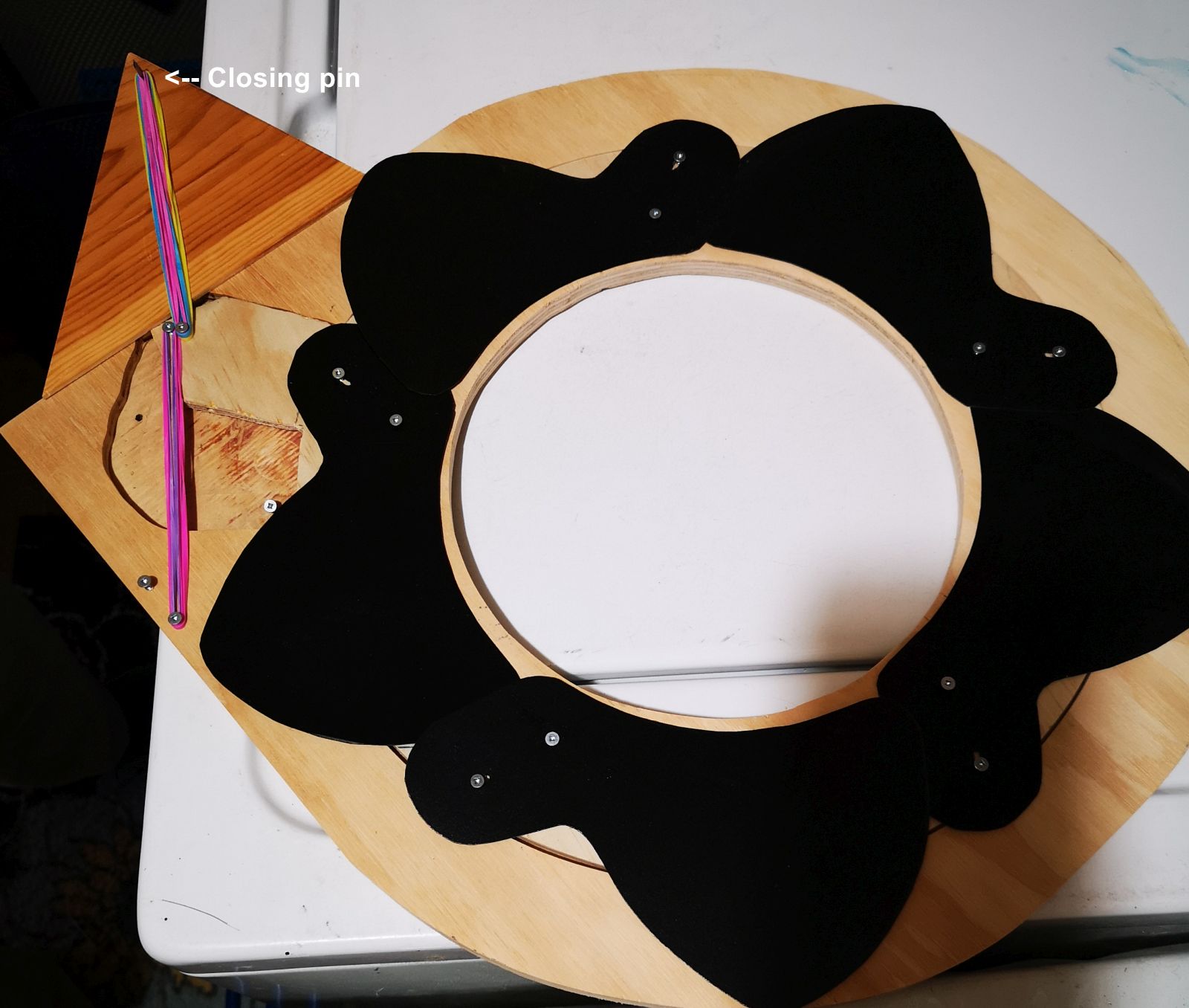

This is quite the project! I don't have a metal shop, but have access to a wood one, so was curious as to what was possible. Someone asked me about making an 8" leaf shutter, which is a little big for a 3D printer, so tried making a prototype out of wood with vinyl blades. The shutter itself is very doable, but the actuating mechanism is of course the big challenge. Manual operation, unless it was by cable, would introduce a lot of vibration. A solenoid is the option discussed here but it needs to be quite powerful and would require lots of power and trickier to control electronically, and as in previous posts, would work best if mounted remotely to reduce vibration making it more complicated. A servo could work, and would be inexpensive and wouldn't be difficult to control with an arduino, and would likely be able to do shutter speeds 1/4 second or slower.
So here's another idea. 2 springs connected to the shutter ring, one strong enough to overcome the other while the shutter is open. The stronger spring is held taut with a pin. The shutter is closed and another pin is used at the shutter ring to hold the shutter closed. Pull that pin to open the shutter, then pull the first pin to close it. Conceptually it works with rubber bands, and I think 2 solenoids could be used in place of the pins. Here's a video of how it would work: 8 inch shutter operation test . The shutter gets "cocked" by installing the hold back pin and opening spring with its closing pin. I did another video with a shutter tester manually pulling the pins: Slow motion leaf shutter test and it's interesting to note how slow my reflexes are. Ideally, the fastest shutter speed would bounce back from open, instead of bouncing open, then closing. It looks like it could achieve a nominal shutter speed of 1/10 or a little bit faster.
A variation on this which would require less spring force on the opening spring could be a method to dynamically engage the closing spring on the actuator, then to pull the closing spring to the open position and hold it that way with a closing pin. Insert the opening pin at the actuator and stretch the opening spring to a pin that somehow releases the spring once it's open (an important unresolved detail). Then pulling the pin on the closing pin to close the shutter.
Thats really cool! I wonder on what use requires 8" opening? Thats big! It looks to be moving very nicely and fast at the 1/10s.
Hmm, i think the wollensak studio shutter has a bit similar system, 2 levers working opposite each other, with stronger and weaker springs, but it only has bulb mode.
Youre right, the solenoids and servos might be quite limiting/troublesome. The remote cable solenoid thing is not very nice in the field. Its getting to a territory where shutter actuator needs its own tripod :D.
I have been thinking these same problems quite a bit, and have come to pretty similar idea. Taking the power to the shutter actuation from spring. Enabling having the fastest shutter time and bulb mode without any electronics.
Then the shutter can be made to stay open longer with a small solenoid, for different shutter times.
With your metal design, you should be able to use strong metal springs to achieve fast opening/closing times, and perhaps achieve shutter speeds upward to 1/60 at least. My wooden prototype can't take too much force... Cocking the shutter would be basically pulling the strong spring over the closing solenoid pin. You would also want a way to keep the shutter open easily for focusing/framing.
To control the closing shutter, you would need a way to time the exposure. If you place a shutter open switch that detects when the shutter is tripped, you can use an arduino to time it, then activate the shutter closing solenoid after the exposure is complete. It's not difficult programming and arduino and they're inexpensive.
Yeah! I will write to my next post what ive been thinking for the spring system. It would be super awesome to hit 1/60 without shaking the thing apart. Your shutter also maybe probably have lighter components relative to the size.
I would have room to mount arduino and small battery to the front of the shutter, to keep it so that everything needed shutter to work, is one single unit. But that is something that will be a project on its own and have to look up later.

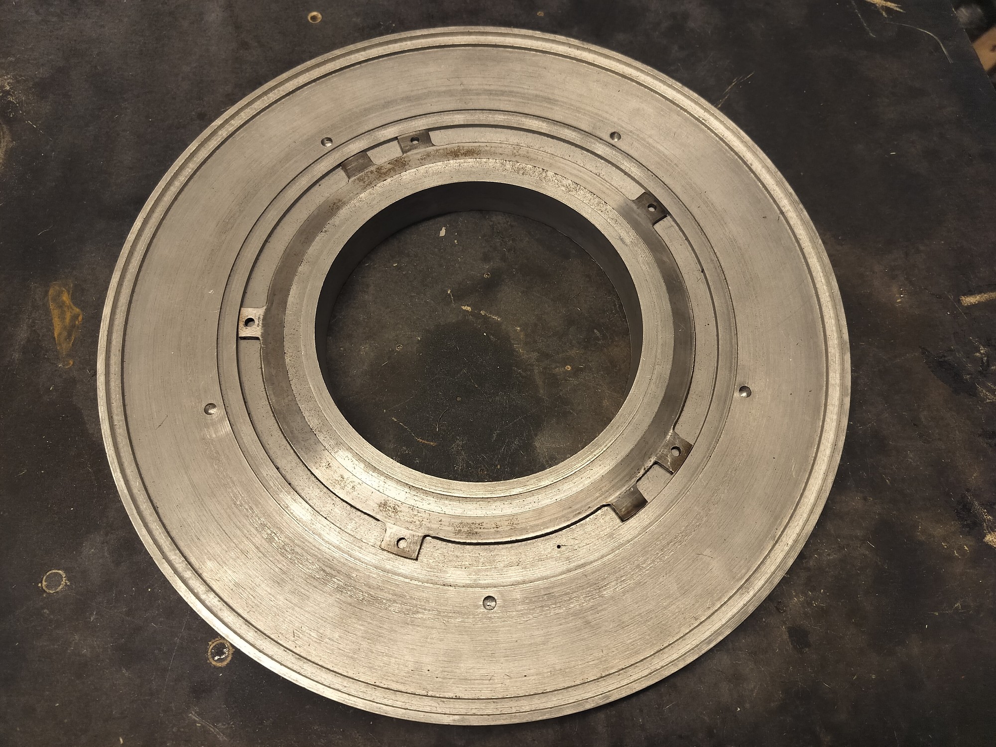

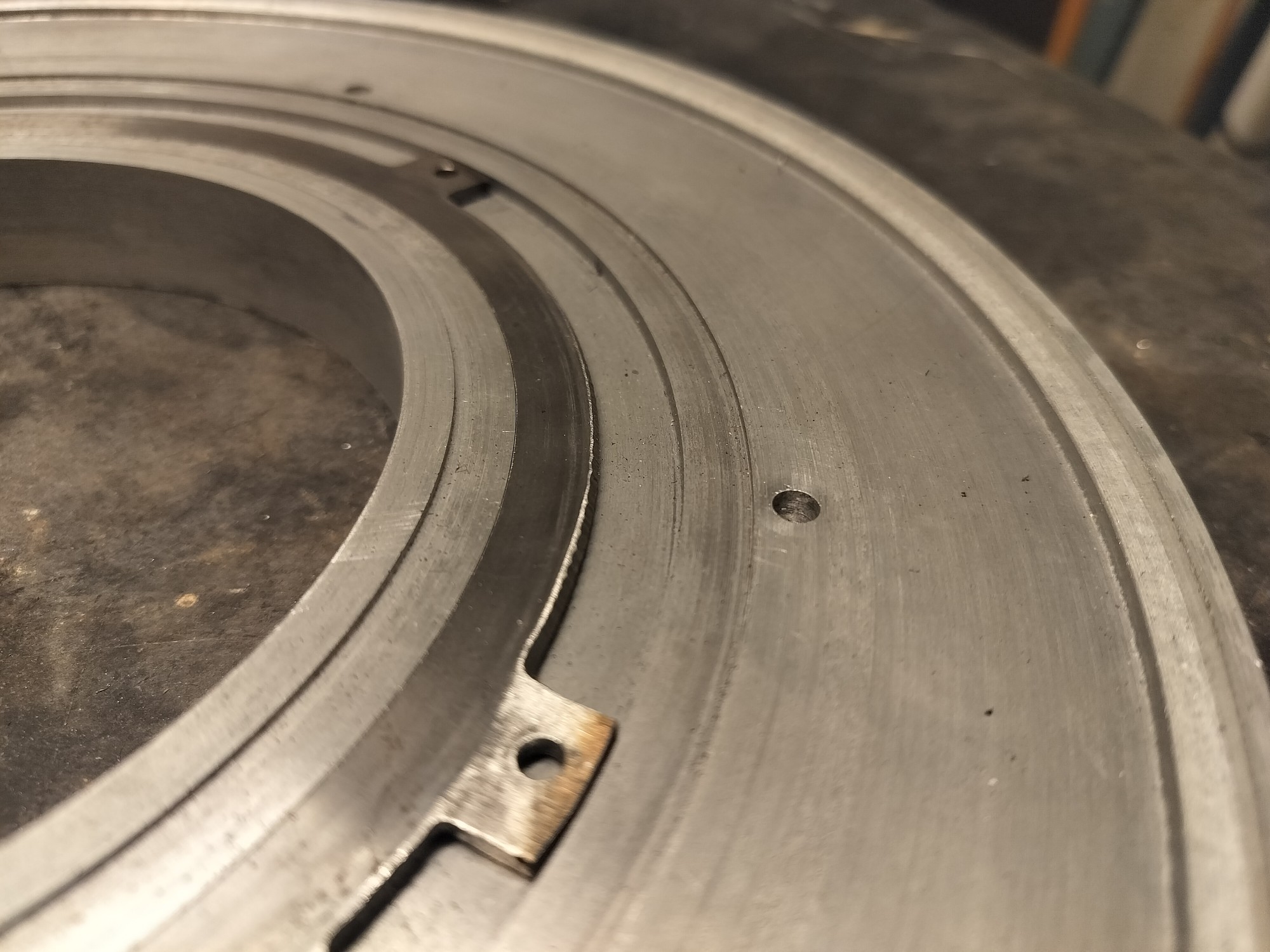

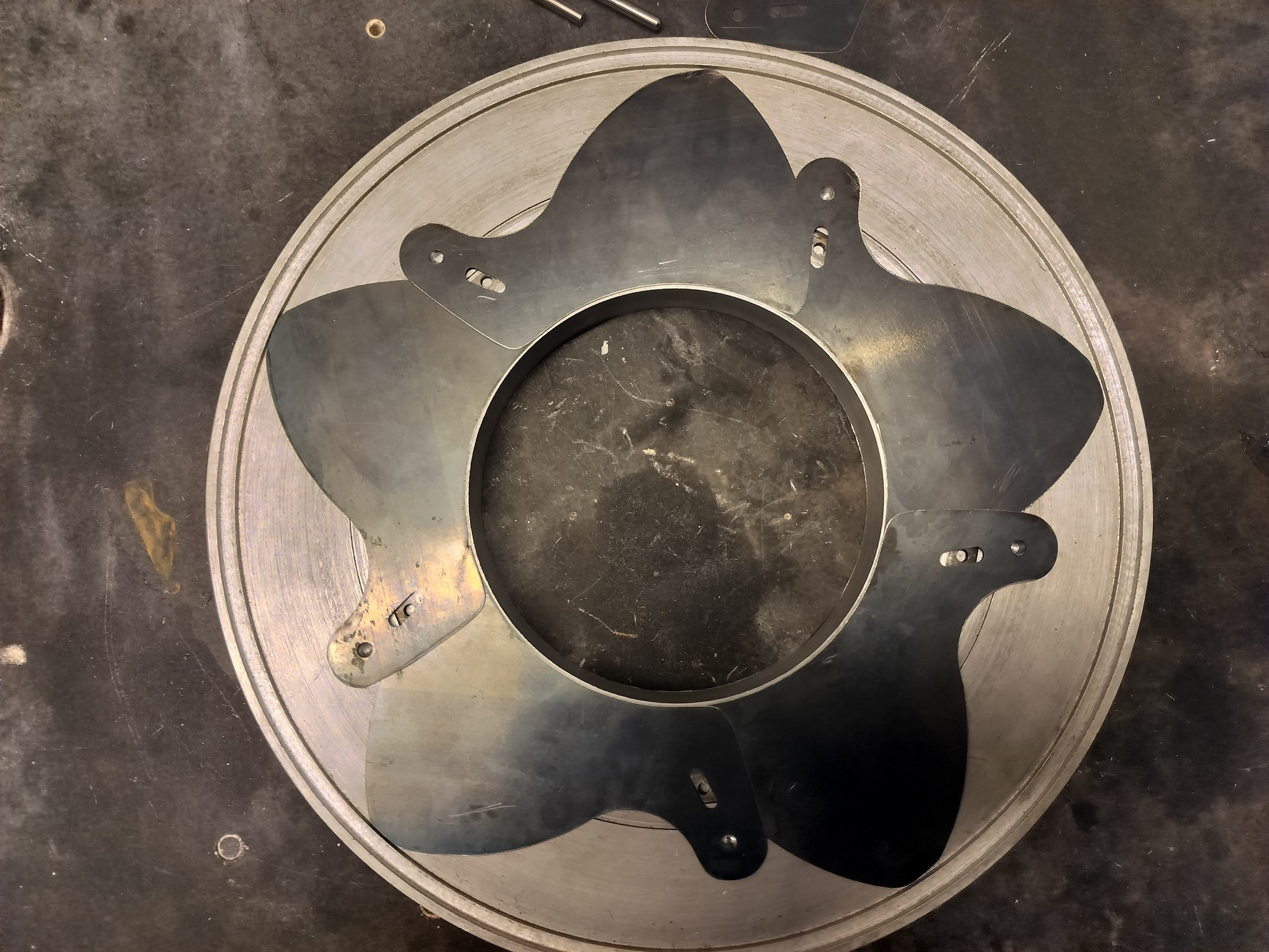

Here is some progress thats been made:
First picture, the ring part is embedded on its final place. Above the embedded ring part, there's another embedded feature, that is for the cover of the ring part. That will make the whole surface flat, for the leaves to glide against. The most outer features of the shutter body, are for centering and mounting the top piece, where the lens will be mounted. The top piece and ring cover piece will be next on to do -list.
2. and 3. pictures are just test fit, to see how it looks. I also made holes for the pins to the shutter body, but those are not good and I have to make those again. -luckily its easy enough just do another holes next to those failed ones.
New holes will go trough the top piece, all the way to the body. They will be very sturdy and also stiffen the structure.

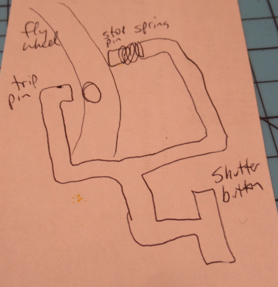

So, a mechanism like this?
This may work, and I like the idea of the shutter slowing down at the apex before the blades are completely open to reduce bounce and the forces on the leaf pins, as well as decelerating before closing. Linear springs would apply a lot of force to the pins and leafs especially when it bottoms out open and closed and shorten their lives. What I'm wondering about is whether you will be able to develop enough torque to get the speed you need. Also, what kind of holding/stopping mechanism would you use? This would have to be necessarily strong to take the force of stopping the piston arm/spring. I suppose the trip mechanism could be a simple pin holding the flywheel back which is pushed out of the way to trip the shutter. A spring loaded pin on the other side could catch the hole as it comes around 360 degrees. Or something like that. It's going to be a bit complex designing/machining...
You have a machine shop, right? So you should be able to machine the necessary parts to do this. I don't have access to a metal shop though I do have a 3d printer, but I'm sure 3D printed parts would not stand up to the forces in this system.
I think I would make the crankshaft, attach a spring to it, wind it up and see how fast it can make it spin 360 degrees when released. Most phones can do slow motion video so that'll give you an idea of how fast it is. If it has the necessary speed, then you could connect it to the shutter ring to see whether it has enough torque.
Yes, pretty much like that! I have not thought much about the stopping mechanism yet, but there needs to be one. Maybe something similar than dog box gearbox, like how the teeth mesh together. Maybe use just one teeth pair similarly ground than the gearbox. It can have even a slight negative angle, so it stays tightly latched, but then the solenoid needs to be stronger to pull it out of engagement. Maybe the another tooth can be in a crank and another mounted to some lever with spring.
If the forces are a problem, could the stopping mechanism be in the ring part itself? that has a big diameter, so far less torque, than small diameter crank.
Nice drawings btw! :D
