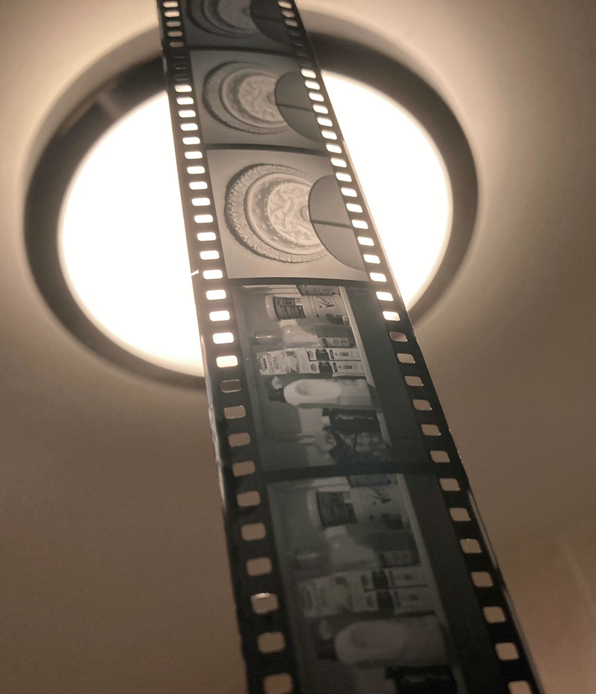

Latest results from today (not exciting scenery: test shots). These are the Fomapan 400 bleaching at 22C. I think I could have left them in a little longer (you can see dark mottling in the sprocket holes), but it works.

An update on my last roll with the V3 process. After drying down, it's clear that maximum density is much worse and minimum looks only slightly better. It's not worth the tradeoff. I don't think there is enough silver in this film to run any thiosulfate in the first developer. Might be time to break out the Silvermax for a test. First without any thiosulfate as a benchmark.
The release of O2 gas provides a powerful oxidizing agent in the mix which can cause the oxidation of the acetate ions to peracetic acid. This may take time so letting the solution sit overnight probably does increase the concentration of peracetic acid. All an oxidizing agent does is remove an electron, (or more than one), from a chemical. To form peracetic acid from acetate the acetate is oxidized so it will combine with the free O2 to form peracetic acid: O2 + CH3CO2H => CH3CO3H (not a balanced equation). There are probably plenty of halide ions around from trace amounts of the silver halide crystals AgCl, AgI, and AgBr, as well as common salts formed from trace amounts of Na and K ions. Also the O2 could have oxidized leftover halide ions like Cl- into free gas Cl2 which becomes trapped in the gelatin.
The reversals that relistan has posted look wonderful.

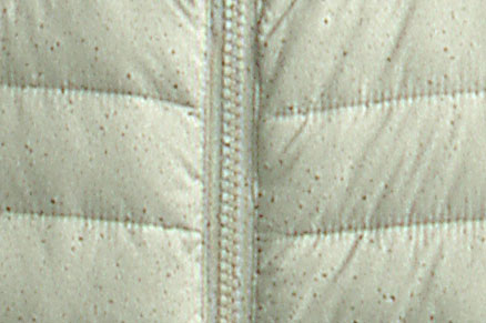

Close up scan of the result. See emulsion damage and staining.

I did run another Silvermax test and I got decent images, and full bleaching. However the black spots remain, as does the yellow/gold/green staining. This was run at 15C for 15 minutes in the dark, so speed of bleaching has nothing to do with it, apparently.
I am no longer sure what is causing the staining. I tried long rinses between steps, running the whole thing in the dark, bleaching slowly. Same outcome. The first few rolls I did had no staining. I tried fresh bleach but got staining. I tried new developers from scratch, got staining. Temperature, time, don't seem to matter. And then there are the black spots on the Silvermax...
I will give a little time to it tomorrow and then I may shelve this for awhile.
Anyone have any other theories about the staining or black spots?
